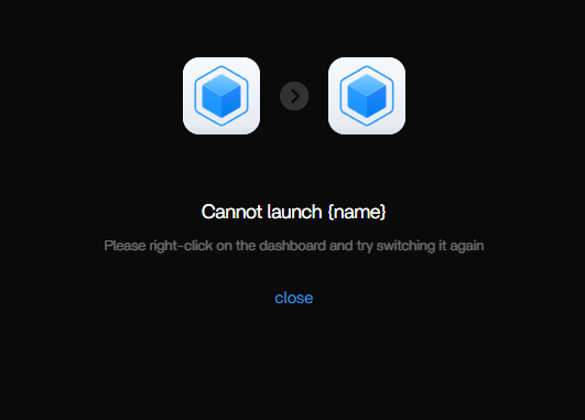

Cant Install Stable Diffusion on zimaOs with nvidia rx5060ti
Cant Install Stable Diffusion on zimaOs with nvidia rx5060ti, it install the , but on starup it shows alway an error?
Cannot launch {name}
Please right-click on the dashboard and try switching it again
close
What can i Do? ,

icewhale-stable-diffusion-webui | Loading weights [cc6cb27103] from /stable-diffusion-webui/models/Stable-diffusion/v1-5-pruned-emaonly.ckpt
icewhale-stable-diffusion-webui | Running on local URL: http://0.0.0.0:7860
icewhale-stable-diffusion-webui | To create a public link, set `share=True` in `launch()`.
icewhale-stable-diffusion-webui | Startup time: 10.2s (prepare environment: 2.5s, import torch: 2.4s, import gradio: 0.9s, setup paths: 1.5s, initialize shared: 0.3s, other imports: 0.7s, load scripts: 0.5s, create ui: 0.9s, gradio launch: 0.1s, add APIs: 0.2s).
icewhale-stable-diffusion-webui | Creating model from config: /stable-diffusion-webui/configs/v1-inference.yaml
icewhale-stable-diffusion-webui | loading stable diffusion model: RuntimeError
icewhale-stable-diffusion-webui | Traceback (most recent call last):
icewhale-stable-diffusion-webui | File “/usr/lib/python3.10/threading.py”, line 973, in _bootstrap
icewhale-stable-diffusion-webui | self._bootstrap_inner()
icewhale-stable-diffusion-webui | File “/usr/lib/python3.10/threading.py”, line 1016, in _bootstrap_inner
icewhale-stable-diffusion-webui | self.run()
icewhale-stable-diffusion-webui | File “/usr/lib/python3.10/threading.py”, line 953, in run
icewhale-stable-diffusion-webui | self._target(*self._args, **self._kwargs)
icewhale-stable-diffusion-webui | File “/stable-diffusion-webui/modules/initialize.py”, line 147, in load_model
icewhale-stable-diffusion-webui | shared.sd_model # noqa: B018
icewhale-stable-diffusion-webui | File “/stable-diffusion-webui/modules/shared_items.py”, line 128, in sd_model
icewhale-stable-diffusion-webui | return modules.sd_models.model_data.get_sd_model()
icewhale-stable-diffusion-webui | File “/stable-diffusion-webui/modules/sd_models.py”, line 531, in get_sd_model
icewhale-stable-diffusion-webui | load_model()
icewhale-stable-diffusion-webui | File “/stable-diffusion-webui/modules/sd_models.py”, line 658, in load_model
icewhale-stable-diffusion-webui | load_model_weights(sd_model, checkpoint_info, state_dict, timer)
icewhale-stable-diffusion-webui | File “/stable-diffusion-webui/modules/sd_models.py”, line 399, in load_model_weights
icewhale-stable-diffusion-webui | model.half()
icewhale-stable-diffusion-webui | File “/stable-diffusion-webui/venv/lib/python3.10/site-packages/lightning_fabric/utilities/device_dtype_mixin.py”, line 98, in half
icewhale-stable-diffusion-webui | return super().half()
icewhale-stable-diffusion-webui | File “/stable-diffusion-webui/venv/lib/python3.10/site-packages/torch/nn/modules/module.py”, line 1001, in half
icewhale-stable-diffusion-webui | return self._apply(lambda t: t.half() if t.is_floating_point() else t)
icewhale-stable-diffusion-webui | File “/stable-diffusion-webui/venv/lib/python3.10/site-packages/torch/nn/modules/module.py”, line 797, in _apply
icewhale-stable-diffusion-webui | module._apply(fn)
icewhale-stable-diffusion-webui | [Previous line repeated 1 more time]
icewhale-stable-diffusion-webui | File “/stable-diffusion-webui/venv/lib/python3.10/site-packages/torch/nn/modules/module.py”, line 820, in _apply
icewhale-stable-diffusion-webui | param_applied = fn(param)
icewhale-stable-diffusion-webui | RuntimeError: CUDA error: no kernel image is available for execution on the device
icewhale-stable-diffusion-webui | CUDA kernel errors might be asynchronously reported at some other API call, so the stacktrace below might be incorrect.
icewhale-stable-diffusion-webui | For debugging consider passing CUDA_LAUNCH_BLOCKING=1.
icewhale-stable-diffusion-webui | Compile with `TORCH_USE_CUDA_DSA` to enable device-side assertions.
icewhale-stable-diffusion-webui | Stable diffusion model failed to load
icewhale-stable-diffusion-webui | Applying attention optimization: Doggettx… done.
icewhale-stable-diffusion-webui | Exception in thread Thread-2 (load_model):
icewhale-stable-diffusion-webui | File “/stable-diffusion-webui/modules/initialize.py”, line 153, in load_model
icewhale-stable-diffusion-webui | devices.first_time_calculation()
icewhale-stable-diffusion-webui | File “/stable-diffusion-webui/modules/devices.py”, line 166, in first_time_calculation
icewhale-stable-diffusion-webui | conv2d(x)
icewhale-stable-diffusion-webui | File “/stable-diffusion-webui/venv/lib/python3.10/site-packages/torch/nn/modules/module.py”, line 1501, in _call_impl
icewhale-stable-diffusion-webui | return forward_call(*args, **kwargs)
icewhale-stable-diffusion-webui | File “/stable-diffusion-webui/extensions-builtin/Lora/networks.py”, line 501, in network_Conv2d_forward
icewhale-stable-diffusion-webui | return originals.Conv2d_forward(self, input)
icewhale-stable-diffusion-webui | File “/stable-diffusion-webui/venv/lib/python3.10/site-packages/torch/nn/modules/conv.py”, line 463, in forward
icewhale-stable-diffusion-webui | return self._conv_forward(input, self.weight, self.bias)
icewhale-stable-diffusion-webui | File “/stable-diffusion-webui/venv/lib/python3.10/site-packages/torch/nn/modules/conv.py”, line 459, in _conv_forward
icewhale-stable-diffusion-webui | return F.conv2d(input, weight, bias, self.stride,
Hi mate, this log shows the real issue:
Your RTX 5060 Ti = CUDA capability sm_120, but the Stable Diffusion container’s PyTorch only supports up to sm_90, so it can’t run CUDA kernels on your GPU:
sm_120 is not compatible with the current PyTorch installation
So this isn’t really a ZimaOS driver issue anymore — the built-in Stable Diffusion app image needs a newer PyTorch/CUDA build that includes sm_120 support.
What you can do now
  1. Best long-term fix: wait for IceWhale to update the Stable Diffusion app container to a newer PyTorch/CUDA build (so RTX 50xx works out-of-the-box).
  2. Quick workaround: run SD in CPU mode (slow but works).
  3. Best practical fix (works now): run a newer Stable Diffusion container using Docker Compose (with updated PyTorch/CUDA).
Working Docker Compose (Automatic1111)
In ZimaOS use Custom Install (or Compose Toolbox) and paste this:
services:
  stable-diffusion-webui:
    image: ghcr.io/ai-dock/stable-diffusion-webui:latest
    container_name: stable-diffusion-webui
    ports:
      - "7860:7860"
    volumes:
      - /DATA/AppData/stable-diffusion:/workspace
    environment:
      - WEBUI_PORT=7860
    deploy:
      resources:
        reservations:
          devices:
            - driver: nvidia
              count: all
              capabilities: [gpu]
    restart: unless-stopped
After deploying
  • Wait 2–5 minutes on first start (it downloads models + builds cache)
  • Then open:
    http://YOUR_ZIMA_IP:7860
hallo, I cannot get stable diffusion to work with an 5060 ti 16gb connected with the gpu dock… the rtx 5060 can be seen in zimaos and works normally with ollama and openwebui. can you please help me?
thats what i get
Hallo? Anybody?
That error tells us exactly what’s going on, your GPU is fine, but the Stable Diffusion app on ZimaOS is using an older PyTorch build that doesn’t support the 5060 Ti yet.
That’s why it works in Ollama/OpenWebUI but fails here. When it tries to run on the GPU, it hits that “no kernel image” error because your card (sm_120) is newer than what the container supports.
At the moment you’ve got three paths:
  • wait for the ZimaOS Stable Diffusion app to be updated (cleanest fix),
  • run it in CPU mode (will work but slow),
  • or use a newer Stable Diffusion container outside the built-in app, which already supports newer GPUs.
So nothing wrong with your setup, it’s just the app being behind your hardware.
