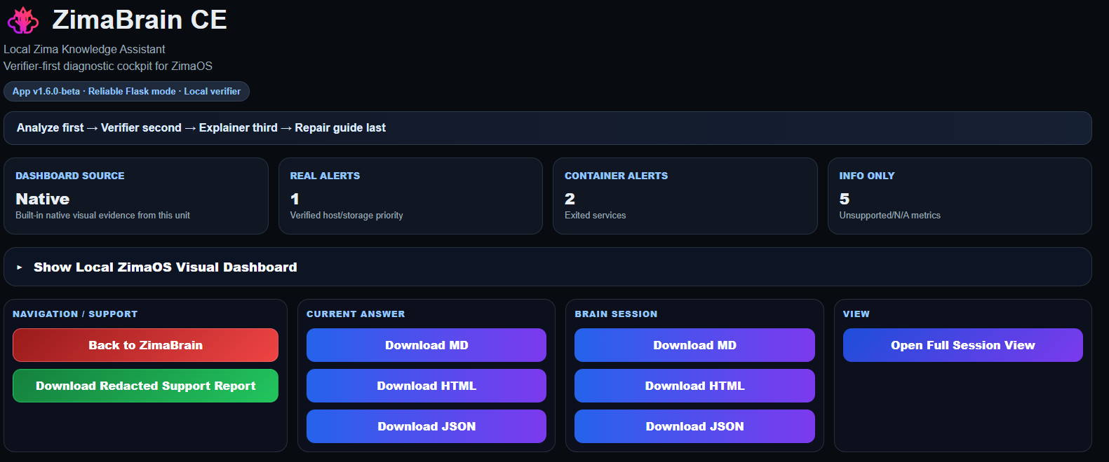

The basic principle is:
Analyze first → Verifier second → Explainer third → Repair guide last
That means ZimaBrain should first look at local evidence from the system, explain what it found, and then suggest the safest next step.

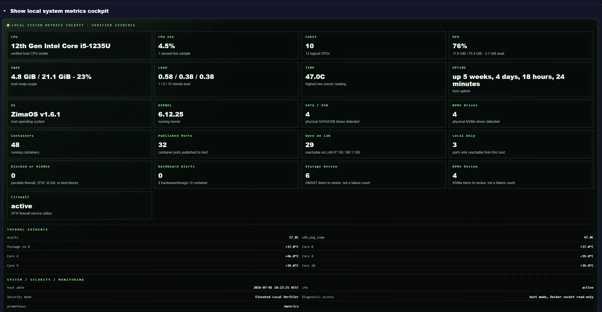

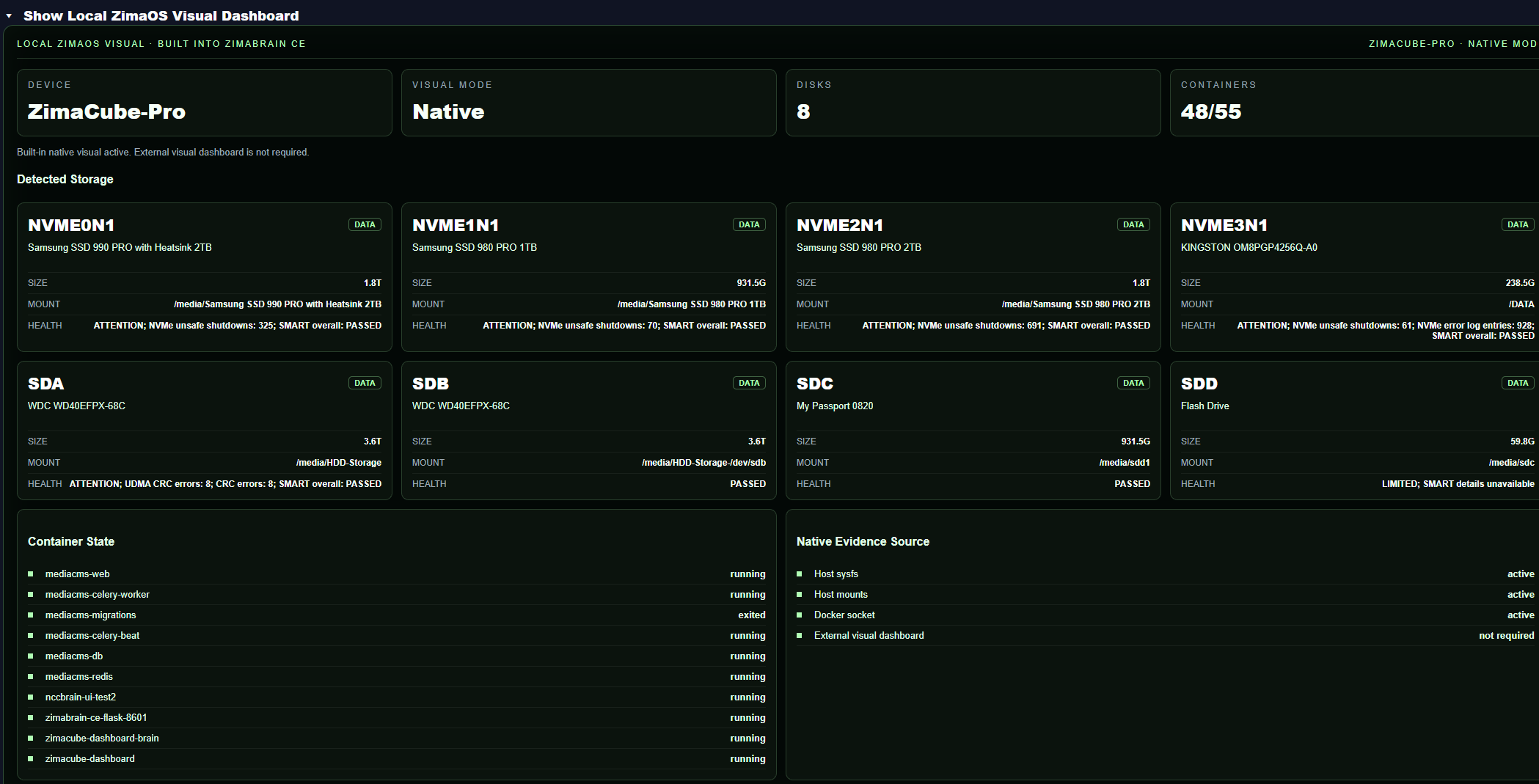

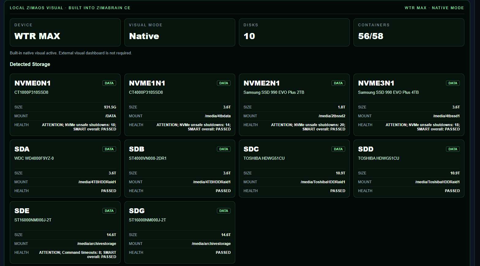

It also includes a built-in native dashboard, so you can quickly see detected disks, container state, and local evidence without needing a separate visual dashboard container.

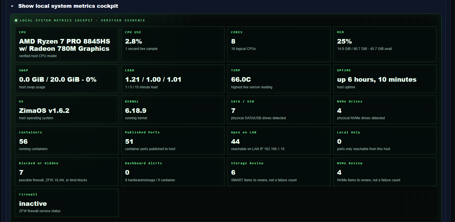

Feedback after testing ZimaBrain CE on my ZimaOS system
First of all, great work. I spent quite a while testing ZimaBrain CE on my production ZimaOS system and it actually helped me find several real configuration problems that had gone unnoticed.
Issues ZimaBrain helped me fix
  • Removed an old startup.service that referenced a missing /DATA/startup.sh.
  • Fixed my plex-delay.service, which still referenced an old Docker container name (plex instead of big-bear-plex).
  • Identified an auditd.service failure caused by incorrect ownership of /var/log/audit and audit.log.
  • Confirmed that my SMART data was healthy while still warning about CRC counters and NVMe unsafe shutdowns instead of relying only on “SMART PASSED”.
  • Correctly identified exited containers.
  • Correctly detected published Docker ports and firewall configuration.
These were real issues, not false positives.

Thanks mate, I really appreciate that.
That is exactly the goal. I am trying to make it easier for users to collect proper evidence first, instead of everyone guessing from screenshots or half the information.
One of the useful parts is the local Zima visual dashboard. You can see your own machine locally, including detected disks, container state, ports, and system evidence, without needing to rely only on the ZimaOS WebUI or separate screenshots.
The support report side is important too. If someone has a disk, Docker, port, firewall, app path, or SMART issue, ZimaBrain should help them ask the right question and share useful redacted data without exposing private details.

Wow, what a fantastic tool. It will help me further understand ZimaOS and how it works on my home server. What is present and what is gone. Just Pure GOLD !:1st_place_medal:
It didn’t answer any of my questions other than the 2 dockers I know are stopped, and I only run on demand. It couldn’t answer about the 1 Real alert, or the 5 Info.

## 5. What is the 1 Real  Alert Real Alerts

That is all it told me. Nothing about the 1 Real alert, or the 5 sensors
You are right. ZimaBrain detected the alert counts, but it did not identify the actual 1 Real Alert or explain the 5 Info Only items. It also treated your two on-demand containers as faults even though that is expected in your setup.
That means the current dashboard alert layer is incomplete. It can count alerts, but it is not yet reliably mapping each alert back to the exact disk, sensor, or condition that triggered it.
Thanks for testing it and posting the full output. This is useful because it shows exactly what needs fixing.
Hi everyone,
Thanks again for the testing. The report showing that ZimaBrain counted alerts but did not explain them properly helped expose a real gap.
I pushed an update today with these fixes:
