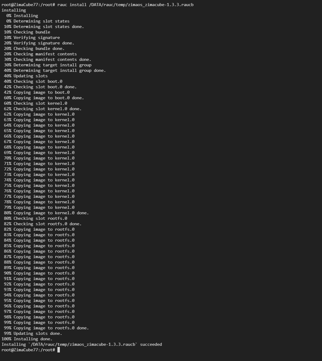

Here is screenshot of successful install [after reboot problem remains]
Can you show me the content of /etc/fstab?
Hows this?:
/dev/root / auto ro 0 1
/media/ZiMARRK /mnt/raid none bind 0 0
Please first remove the line “/media/ZiMARRK /mnt/raid none bind 0 0” from /etc/fstab and /mnt/overlay/upper_etc, then switch to the slot corresponding to version 1.3.3. When creating a RAID or mounting disks individually, try to use the Storage feature in the ZimaOS WebUI as much as possible.
Since version 1.3.2, the loading strategy has been adjusted, and the contents of /etc/fstab may affect the boot process.
