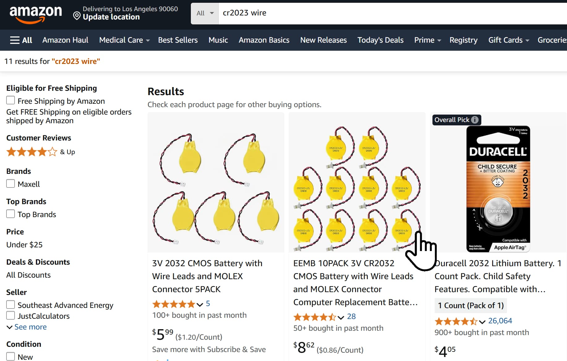

I have the same issue. If I power down the board, I can’t get it to boot unless I disassemble the zimaboard and disconnect the CMOS battery. How can I fix this? BIOS update?
I have an original kickstarter board.
I was going to replace the battery but it’s in a proprietary plastic wrap.
It is replaceable. Buy the wired version.
This might be helpful.
