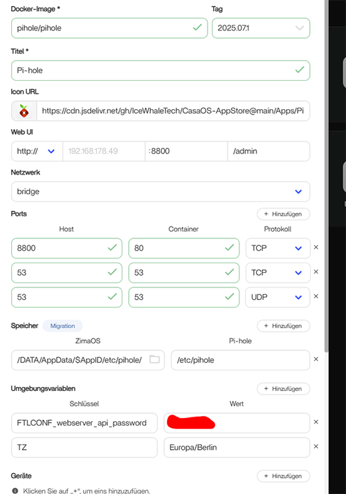

Do I perhaps need to enter something similar to what’s shown in the picture during installation?
I’ll take some photos tomorrow; basically, the settings are as you described. Nevertheless, it’s not working
You don’t need to enter anything like the screenshot.
In fact, that screenshot shows extra ports that Pi-hole should not expose on ZimaOS.
Only these ports should be mapped:
Port 80 > Pi-hole web UI
Port 53 TCP/UDP > DNS
Nothing else.
Please remove the following from your container:
Port 67 (DHCP)
Port 547 (IPv6 DHCP)
Port 8800 (unused unless you purposely changed the web port)
If any of those are present, Pi-hole will keep fighting with the system dnsmasq and DNS resolution will fail, even if DHCP is turned off.

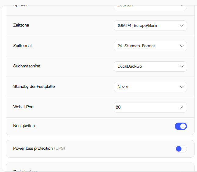

This is the web UI of Zima in use; can I change it?
You can modify the WebUI port of ZimaOS.
Can I just enter a different port there? Should I enter something specific, or just a number? Because that post says to use port 80. If I understand correctly.
Sorry, I’m a complete novice.

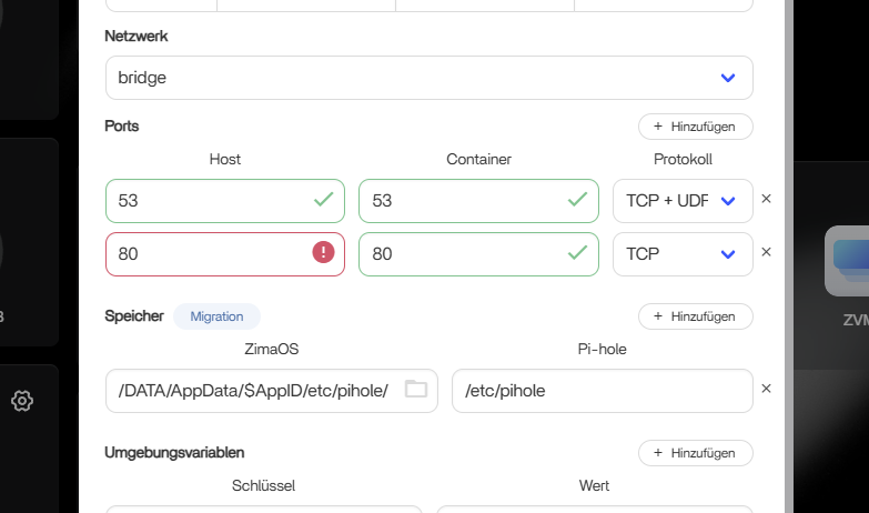

Because that post says to use port 80. If I understand correctly:
How to Manually Modify the Dashboard Port Number of ZimaOS
Port 80 is blocked because ZimaOS itself uses port 80 for the dashboard.
That’s completely normal. Pi-hole can only bind to port 80 if you free it first.
You have two options, and both work fine:
Option 1: Change the ZimaOS WebUI port
Go to Settings > WebUI Port and enter a different number (for example 8080).
Save > ZimaOS will restart the dashboard on the new port.
After that, Pi-hole is allowed to use port 80.

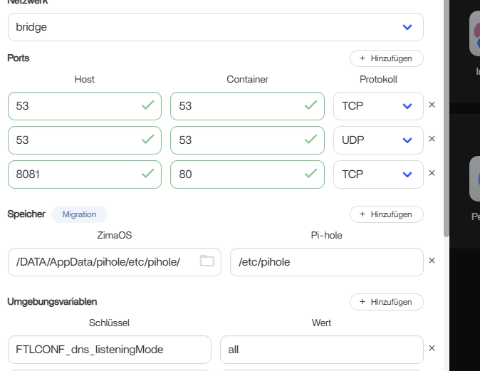

Option 2: Keep ZimaOS on port 80 and move Pi-hole’s web port
This is simpler for beginners.
In the Pi-hole container, map something like:
Host 8081 > Container 80 (TCP)
Pi-hole will then open at:
http://your-zima-ip:8081/admin
DNS still stays on 53/UDP and 53/TCP, nothing changes there.
I suggest option 2 because it avoids touching the system port.
I believe it is the easiest setup while you’re learning the layout.
I think it will remove the conflict instantly without breaking anything.

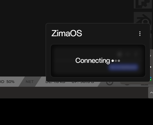

However, there’s also a problem with Zima OS itself; when I try to restart it, I get a black screen with no interface, and I can’t connect via the app. Before the power outage, I was able to restart the system without any problems.
Unfortunately, reinstalling Pi-Hole doesn’t work; when I try to access Pi-Hole, it doesn’t work.
So, every time I have to connect a monitor, keyboard, and mouse to the server PC, restart the PC, and first check if the boot order is correct in the BIOS.
Which isn’t really normal either.
The problem now seems to be that the boot order changes when restarting ZimaOS, which is very strange. As I said, everything worked perfectly before. Power outages can happen, of course. But having problems like this every time would be very bad.
I’ve now reconnected everything to the server and changed the boot order. I can now access Zima OS again.
And I’m reinstalling Pi-hole.The folder has been completely deleted. These are the settings:
Right now your issue is ZimaOS not booting cleanly after a power cut. Until the OS is healthy, Pi-hole and Docker will keep breaking.

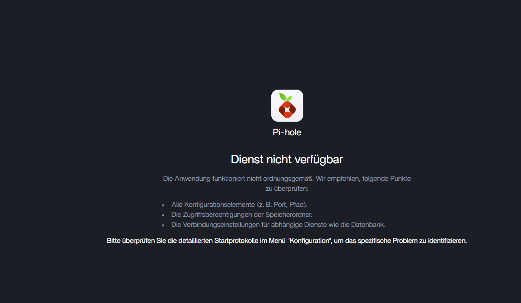

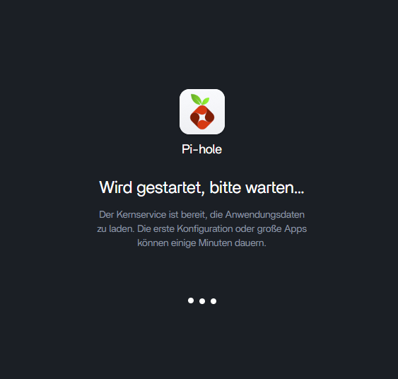

I’ve now reinstalled Pi-Hole, and I’m getting the following messages:
