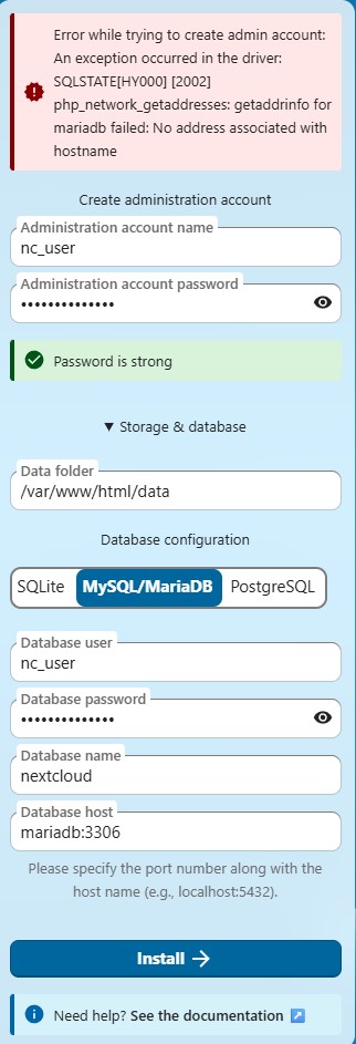

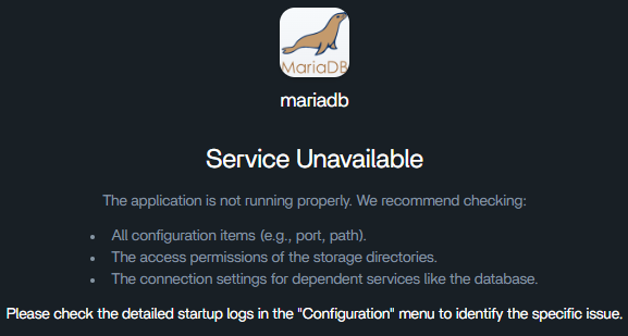

Hello, I also having problems, after struggling for about 6 hours trying several things from Bigbear Youtube etc, I tried above settings that [gelbuilding] shared. It is the closest I get to something that is almost working. I am a new user on ZimaOS v1.5.3
The error I get is:
mariadb
Service Unavailable
The application is not running properly. We recommend checking:
All configuration items (e.g., port, path).
The access permissions of the storage directories.
The connection settings for dependent services like the database.
Please check the detailed startup logs in the “Configuration” menu to identify the specific issue.

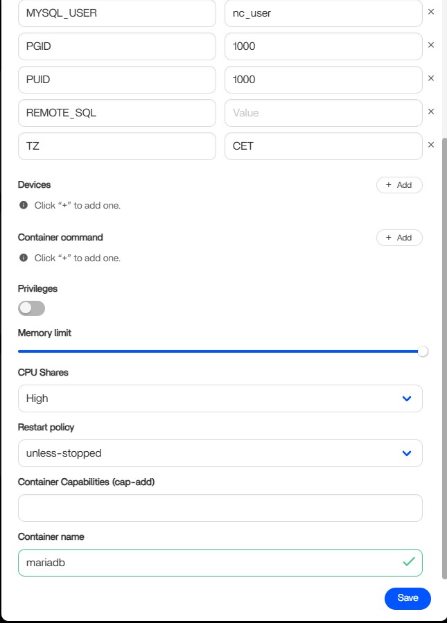

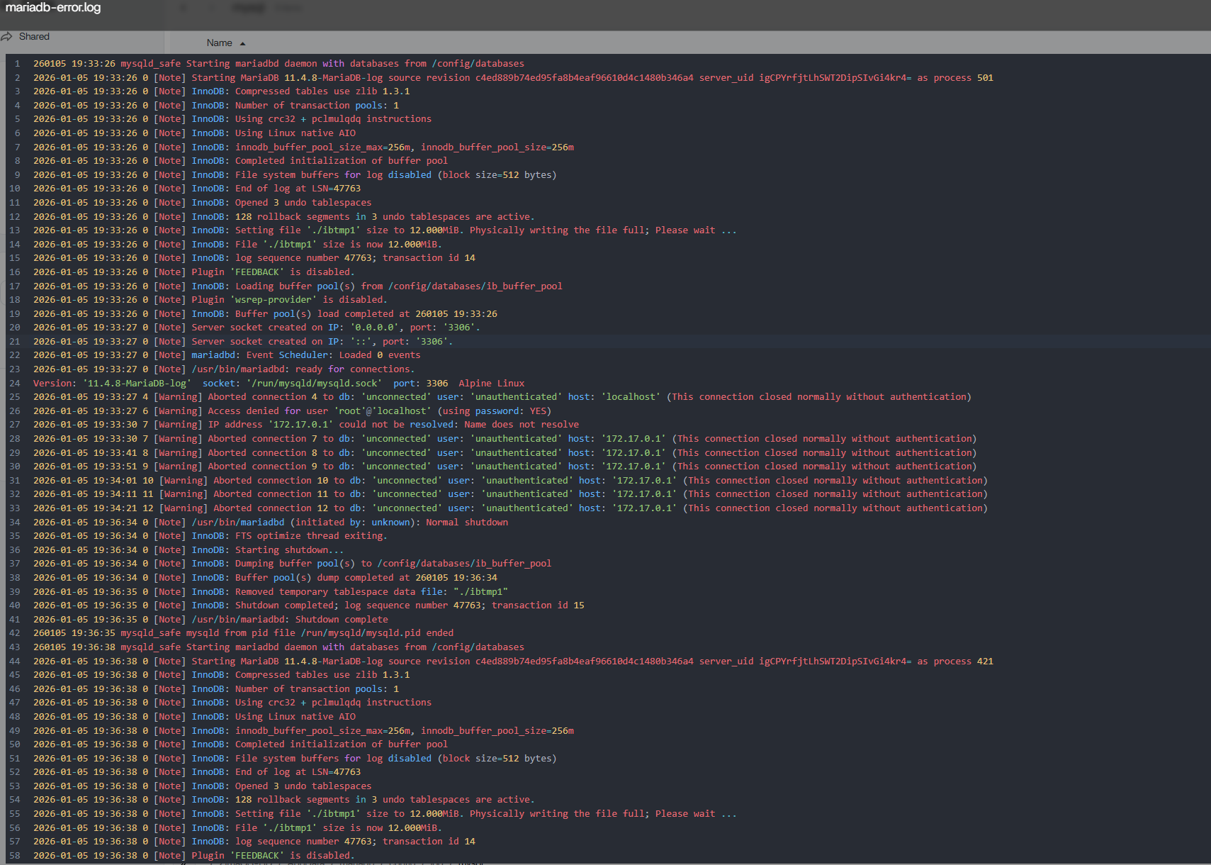

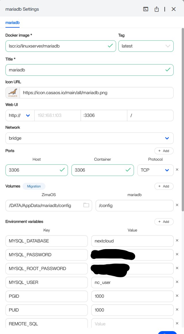

Just home from work, I can’t get it to work, sorry I only changed the user and passwords nothing else. I will share my error log and setup screenshots.
Thanks for the logs, the first screenshot is the key one.
I believe this shows MariaDB is actually starting correctly. The log reaches “ready for connections” and listens on port 3306, so the database itself is healthy. The warnings shown are not fatal.
What I believe is happening is a health-check mismatch: MariaDB starts and runs, but the app UI still reports Service Unavailable.
I suggest:
  1. Don’t change any MariaDB env vars or passwords again.
  2. Confirm the data volume mapping hasn’t changed since first start.
  3. Restart MariaDB only (stop > start).
  4. Continue the Nextcloud setup using:
mariadb:3306
If it still fails, I suggest removing only the MariaDB app (not the data folder) and reinstalling once with the correct values, then leaving them unchanged.
Nothing in the log points to a broken database.

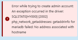

I tried before and tried it again just now, when I want to setup Nextcloud I get this:
This error is very specific and actually narrows it down well.
getaddrinfo for mariadb failed means Nextcloud cannot resolve the hostname mariadb at all. That’s a Docker networking / name resolution issue, not a database or password problem.
I believe what’s happening is that Nextcloud and MariaDB are not on the same Docker network, so the hostname mariadb doesn’t exist from Nextcloud’s point of view.

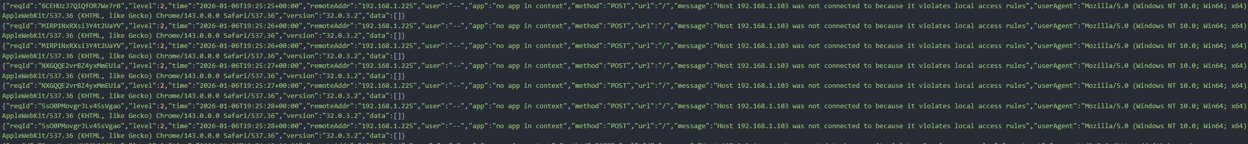

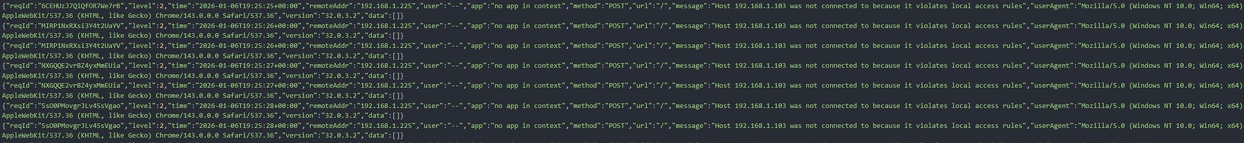

I think there is something wrong in Nextcloud, if I look at the logs I only get messages like: “message”:“Host 192.168.1.103 was not connected to because it violates local access rules”
See attached picture.
I searched on the internet and found something that looks like a similar problem: Host 10.0.17.6 was not connected to because it violates local access rules · Issue #188 · nextcloud/all-in-one · GitHub
But if I try the mentioned solution my Nextcloud won’t start up anymore. But since this is new to me it could be that I’ve made a mistake. Given solution is: Add [‘allow_local_remote_servers’ => true,] outside the pool in the config file.

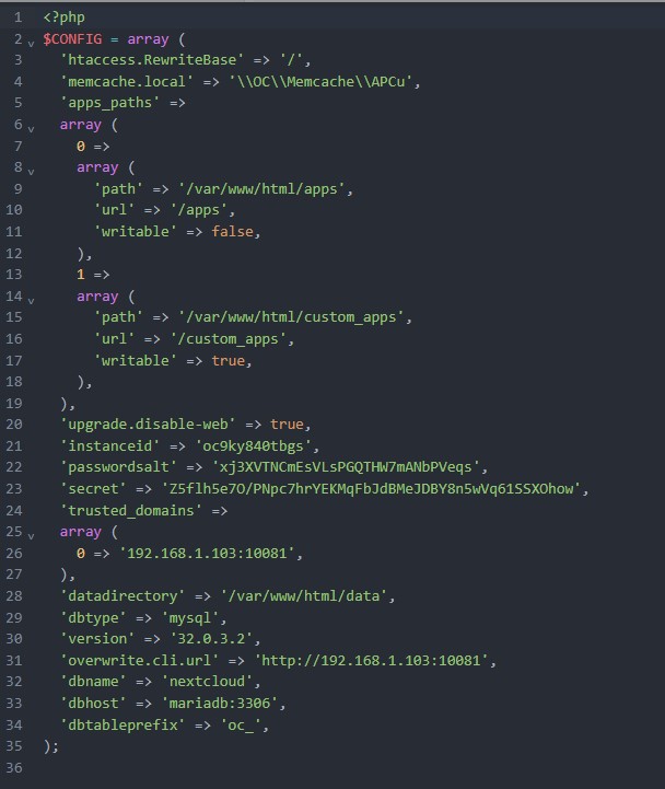

Edit: Adding my Nextcloud config file:
Good find, that GitHub issue is related in general, but I don’t believe it’s the root cause here.
The message
“Host … was not connected to because it violates local access rules”
appears after Nextcloud starts handling HTTP requests. Your main blocker still happens earlier during setup:
php_network_getaddresses: getaddrinfo for mariadb failed
That error means Nextcloud cannot resolve the hostname mariadb, which points to a Docker name-resolution issue rather than a Nextcloud security or config problem.
Regarding the suggested fix you found:
'allow_local_remote_servers' => true,
This setting is only relevant after Nextcloud is fully installed and running. Adding it during initial install, or placing it incorrectly in config.php, can prevent Nextcloud from starting, which matches what you observed.

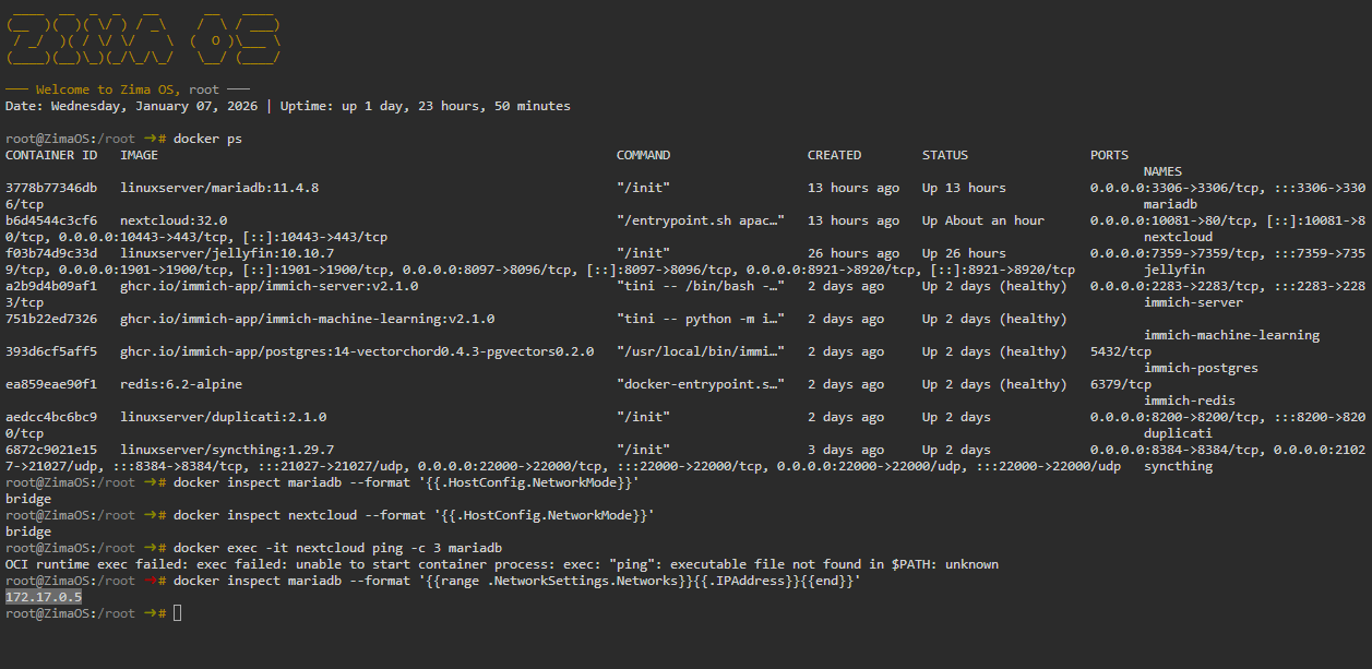

To understand this better, could you please run these checks via SSH and share the output:
  1. Confirm both containers are running
docker ps
  1. Check what network MariaDB is actually on
docker inspect mariadb --format '{{.HostConfig.NetworkMode}}'
  1. Check the network used by Nextcloud
docker inspect nextcloud --format '{{.HostConfig.NetworkMode}}'
  1. Test name resolution from inside Nextcloud
docker exec -it nextcloud ping -c 3 mariadb
  1. As a comparison, test via IP
docker inspect mariadb --format '{{range .NetworkSettings.Networks}}{{.IPAddress}}{{end}}'
Then temporarily try:
<that-ip>:3306
as the database host in Nextcloud.
If the IP works but the hostname does not, it confirms this is a Docker DNS issue, not a Nextcloud configuration problem. Once we see these results, we’ll know exactly where the break is.
Thanks for your help and swift reply!
Okay, using the resulting IP, Nextcloud is now installing.
SSH results are in the attached picture:
Great, that confirms it
The issue is not Nextcloud or MariaDB. Both are working correctly.
The problem is that container name resolution (mariadb) is failing on the default bridge network, while direct IP connectivity works. That’s why:
  • mariadb:3306 fails
  • 172.17.0.5:3306 works immediately
Fix:
Use the MariaDB container IP as the database host in Nextcloud:
172.17.0.5:3306
This is a valid and safe workaround and explains why Nextcloud installs successfully as soon as the IP is used.
You didn’t misconfigure anything, this is a Docker DNS edge case. If name-based resolution is needed later, it would require using a user-defined Docker network, which isn’t fully exposed in the ZimaOS UI yet.
