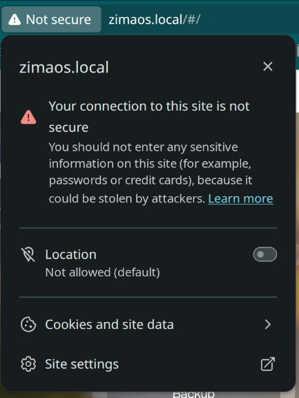

dont know if https is the same thing but i just dont like having to click advanced and continue or looking at that thing that says your connection is not secure. is there a way to fix that on zimaos login and also all the apps inside zimaos

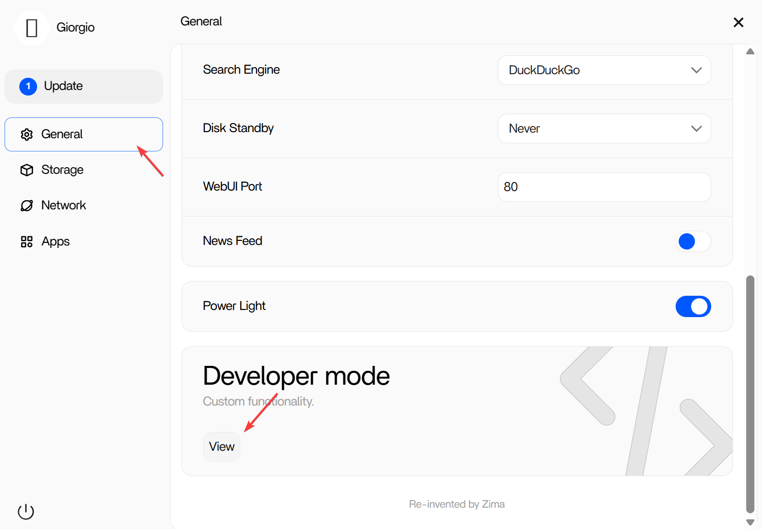

It can be turn off in settings panel.

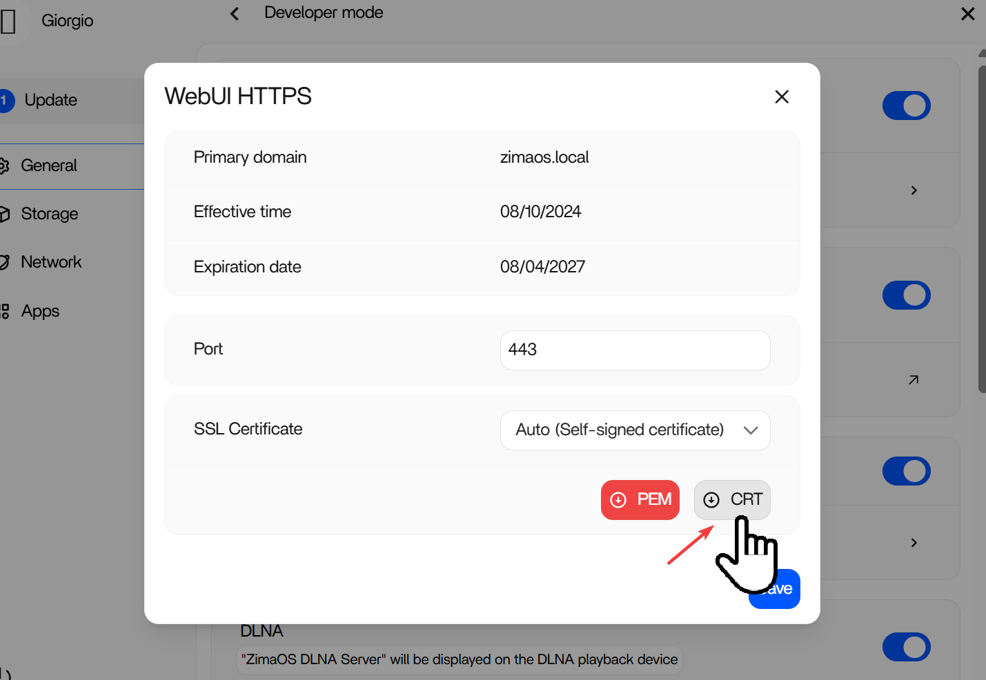

Or, you can download the generated CRT file and make the Chrome trust it.
After importing the crt file, use https://zimaos.local to visit ZimaOS dashboard.
Regarding how to import crt file in Windows, refer to this guide:
To trust the “ZimaOS Local” certificate in Windows for use in a browser, follow these steps:

Hey appreciate the guide but I have Pop OS linux, i managed to import it to my browser and the main zimaos.local including files etc works fine, but all the other apps like plex, emby, jellyfin, is not showing this secure connection.

This is expected behaviour.
The certificate you imported only applies to ZimaOS at:
Apps like Plex, Emby, and Jellyfin run as separate services and expose their own ports (e.g. :32400, :8096). They use plain HTTP by default and do not share the ZimaOS certificate.
So nothing is wrong, importing the .crt only secures the main dashboard, not the individual apps.
If you want full HTTPS everywhere, you’d need a reverse proxy (like Nginx Proxy Manager or Caddy) in front of the apps with proper certificates.

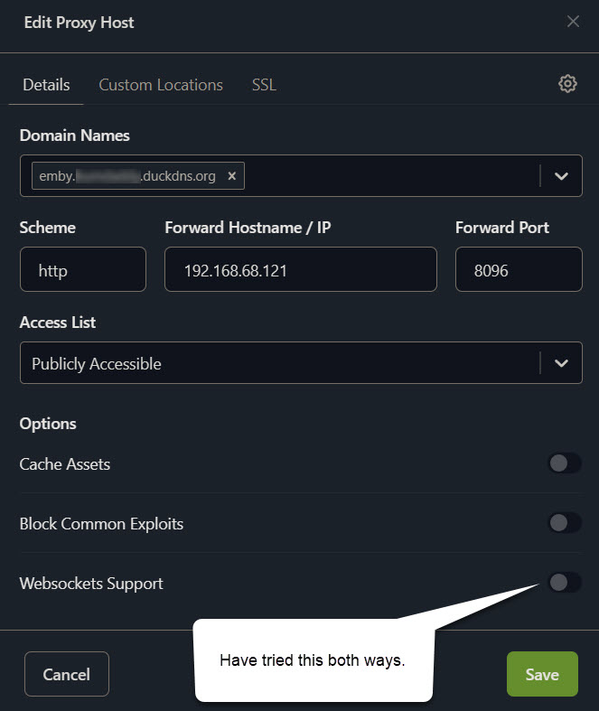

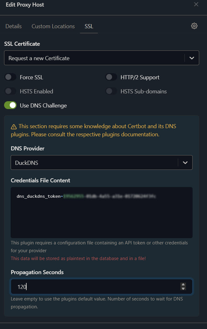

Was able to get domain from DuckDNS and have connected it to NPM, but I’m still not quite there yet. If I go to emby.myname.duckdns.org it doesn’t take me to emby it takes me to the NPM login. So I’m thinking it’s got to be something in my configuration in NPM. I was able to create the proxy for emby but I’m unable to create the SSL certificate. When I try I get “Internal Error” or, on occasion, “Failed to Fetch”. I feel like I have tried all the possible configurations, but I’m still missing something. I’m forwarding emby.myname.duckdns.org to my internal IP address for ZimaOS (also same IP as emby) to port 8096 (emby). The “Scheme” is HTTP and I have tried both ways with Websockets enabled/disabled.
On the SSL tab under the “Request a new Certificate” box there are toggles.
I tried with none toggled and tried with “Use DNS Challenge” toggled, where I chose DuckDNS and added my API key to the config box there, and added a 120 second delay, but this didn’t work either.

Second issue is your SSL setup.
You are mixing two different methods:
HTTP challenge
DNS challenge
You only need one.
Since you already opened ports 80 and 443, do this:
Do not enable “Use DNS Challenge”
Just request a normal certificate

Third, your proxy host config actually looks fine:
Domain
emby.yourname.duckdns.org
Forward IP
192.168.68.121
Port
8096
Scheme
http
That part is correct.
Websockets setting won’t block this, so don’t worry about that.

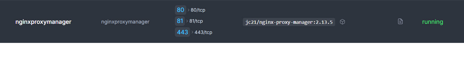

Unfortunately, I am still unable to create the SSL certificate. Keep getting “Internal Error”. I have checked for port conflicts. Dockpeek shows that NPM is using ports 80,81, and 443, and I don’t see those ports being used anywhere else.
If I run sudo ss -tunlp it shows those three ports used by “docker-proxy”

Hey mate, honestly you’re a lot closer than you think, and you’ve actually done the hard part already.
The proxy working externally proves your setup is basically correct. Domain, routing, NPM, all of that is good. This is now just the SSL step failing, not the whole setup.
Also just to clear your mind a bit, what you’re seeing with docker-proxy on ports 80, 81 and 443 is exactly what we want. That means NPM has successfully bound those ports. So no issue there at all.
The reason your certificate is failing is almost always one of these two things:
  1. The domain is not resolving correctly from outside
  2. Let’s Encrypt cannot reach your server on port 80
Since your proxy is already working externally, we can rule out most of the big problems. So this is likely something small.
A couple of key points based on what you said:
You do not need DNS challenge here
Turn OFF “Use DNS Challenge”
Just use the normal method
Request certificate
Agree to terms
Done

I’m not using the “Use DNS Challenge” option. I only tried that once just be sure that wasn’t what was tripping me up. I just mentioned it so you were aware of the things I had already tried.

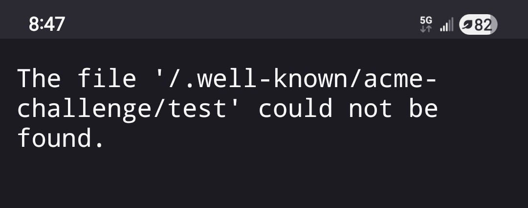

My domain is correct and DOES connect to Emby from outside of my network. This works with my phone (WiFi off) and though my laptop connected via VPN (Chicago).
One thing I DO want to mention is that, in the course of all of this troubleshooting, I have uninstalled NPM and deleted the App Data folder on 2 occasions. The first time, because I was getting nowhere and thought maybe that would help. The second time because I think I broke NPM and it would not load. I had tried using the “Latest” release instead of the “Stable” but I would just get the “Loading” circle and finally “The API is not healthy” screen. I also noticed that on occasion when NPM was trying to load that it was not showing my “Admin” account, but rather “Standard User”
So I’m wondering, Do you think that there may any lingering residue from previous installations that may be causing these problems? Just wanted to mention it, in case.
Thanks again for your help with this. I am certainly learning a lot.
I just reread what your wrote…
Make sure you are testing from outside your network when requesting or verifying

Let’s test that properly
On your phone with WiFi OFF, open:
http://emby.yourname.duckdns.org/.well-known/acme-challenge/test
You don’t need it to load anything meaningful, but it should NOT:
Redirect somewhere weird
Show a different service
Timeout
If that path isn’t reachable cleanly, Let’s Encrypt will fail.
One more thing I want you to check in NPM
Edit your proxy host and make sure:
Block Common Exploits = OFF
That setting can sometimes interfere with the challenge.
Final small but important detail
When requesting the cert:
Do NOT enable Force SSL yet
Request the cert first
Once it succeeds, then enable Force SSL

Here’s what that that url returned.
Perfect mate, that result is actually exactly what we want.
“The file could not be found” means:
The request is reaching your server correctly
NPM is handling the request
Nothing is blocking the path
So this confirms 100 percent:
DNS is good
Port forwarding is good
NPM routing is good
That rules out all the usual problems.
So now we focus on the actual issue, which is inside NPM when requesting the cert.
At this point, the failure is almost always one of these:
  1. Email not set correctly in NPM
  2. Let’s Encrypt rate limit from too many attempts
  3. Temporary NPM / container issue
Next steps, clean and simple:
  1. Go to NPM settings
    Make sure you have a valid email set under SSL / Let’s Encrypt
    If it’s blank or invalid, it will fail silently
  2. Try requesting the cert again
    Keep everything simple
    No DNS challenge
    No Force SSL
  3. If it still fails
    Wait 10 to 15 minutes before retrying
Let’s Encrypt will temporarily block repeated failed attempts, and that gives “Internal Error” exactly like you’re seeing
One more quick check
When you request the cert, only use:
Nothing else added
Where you are now
This is actually the best place to be
All networking is confirmed working
You’re down to the final certificate request step
You’ve basically already won, this is just the last bit being picky.
If it still fails after waiting, next step we go straight to NPM logs and pinpoint it exactly
