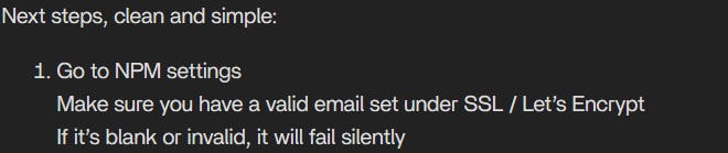

I checked both the NPM container settings and UI settings and don’t see anywhere that asks for email address other than under “Users” in the UI which is the login email (admin@example.com). Where do I find this? There’s a SSL tab in Proxy configuration, but no email area?
If I don’t know what this is then I bet this is the problem. :wink:

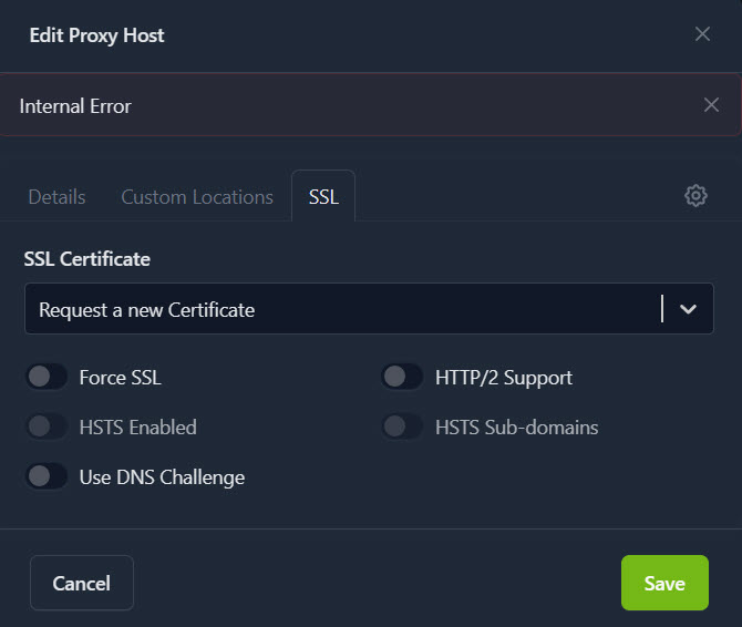

Still getting the error. Just to be clear, this is where i should be requesting the certificate?
Hey mate, yep that is exactly the right place to request the certificate
Your setup there looks correct, so don’t second guess that part.
The important detail here is this:
You are selecting “Request a new Certificate” and immediately getting “Internal Error” before anything else happens.
That tells us NPM is failing before it even properly talks to Let’s Encrypt, which is why you’re not seeing the email prompt.
At this point, this is not a config issue anymore, it’s either:
  1. NPM container issue
  2. Let’s Encrypt temporary block from too many attempts
  3. Missing dependency inside the container
Let’s keep this simple and clean:
  1. Wait 10 to 15 minutes before trying again
    This avoids Let’s Encrypt rate limits
  2. Try again exactly as shown
    No DNS challenge
    No Force SSL
    Just Request Certificate and Save
If it STILL instantly throws “Internal Error”, then we stop guessing and check the real cause.
Next step is logs, because that will show the actual error:
Run this:
docker logs nginxproxymanager
Look for anything mentioning:
letsencrypt
certbot
error
One more thing I want you to confirm
Make sure your container image is:
jc21/nginx-proxy-manager (stable)
Not latest or anything custom, since you mentioned that caused issues before.
Where you are now
You are doing everything right
Your config is correct
Your network is correct
This is now just a container level issue or rate limit, not your setup
Send the log output if it still fails and we’ll pinpoint it straight away

Yes, you were right on about the email address. It was that suggestion that had me looking in NPM for anywhere to put my email. I had read that you must login with admin@example.com email and default password the very first time you go in, and that you should change your password, but it doesn’t say anything about that same email address being used to validate your certificates. I thought the default address was like logging in as root or something. I planned to change it once I had things running.
Once I entered a valid email it took a little while for my email address to update as I was basically watching the logs in real-time, and the logs were flagging the default password until eventually it didn’t and it was there in the logs were I actually read and found out that the certificate had been issued successfully. :clap:

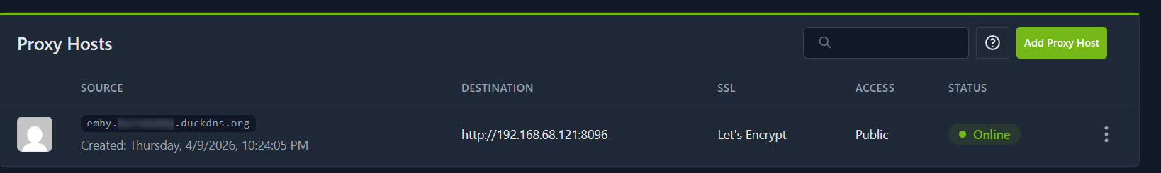

I have successfully added more proxies and been issued certificates for them so I think everything is running smoothly now.
I know for a lot of users this would have been a walk in the park, but I really appreciate you taking the time to get me through it, and hopefully future users like me, who want to do this but are unsure quite how, will also be helped by this information. Like you said, “This is exactly what the community is here for.” and I am glad to know this because not all communities are the same. Had this been the TrueNAS community I would have been eaten by the sharks in minutes. So I thank you and Icewhale for this helpful, friendly community.
