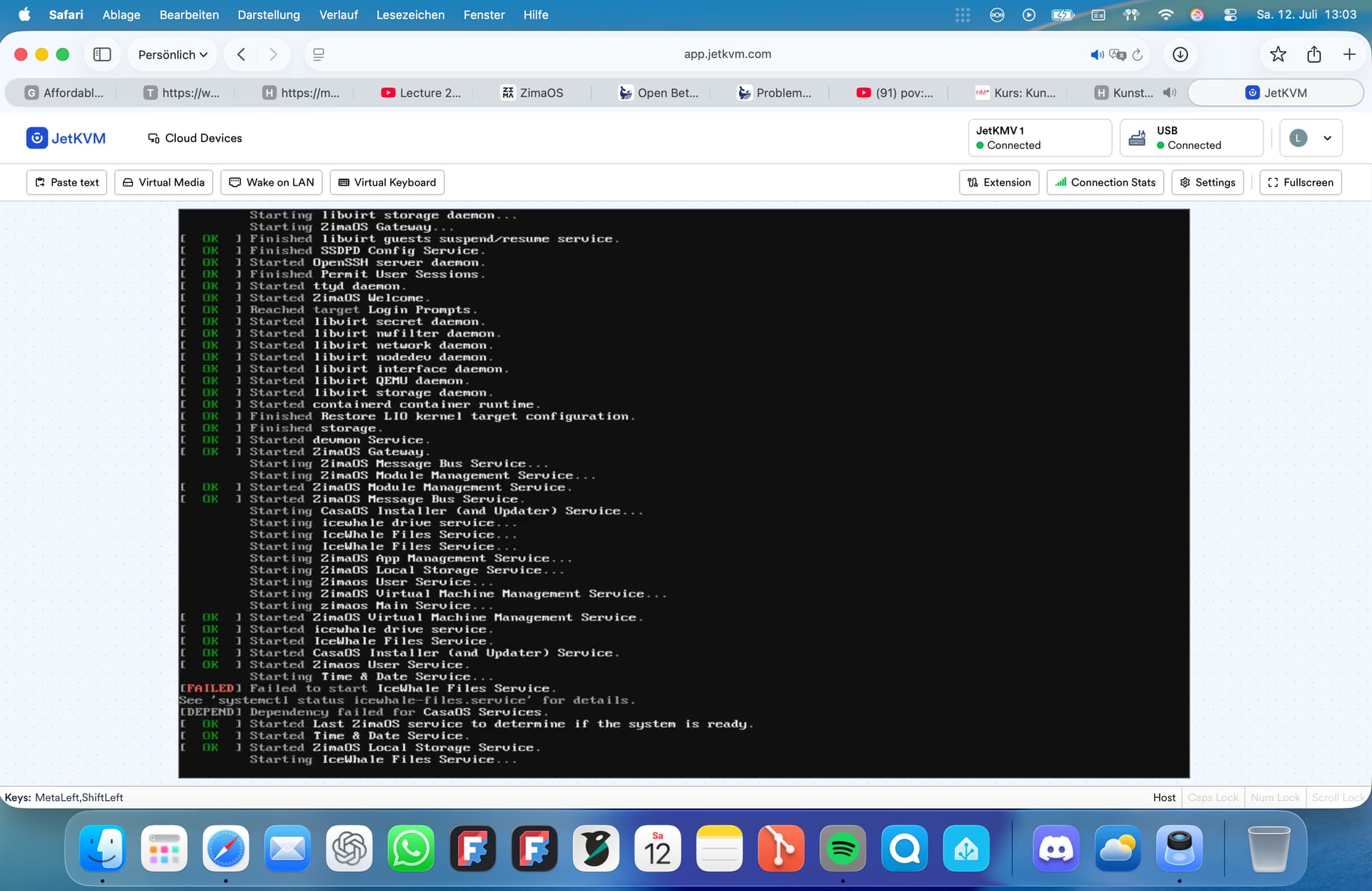

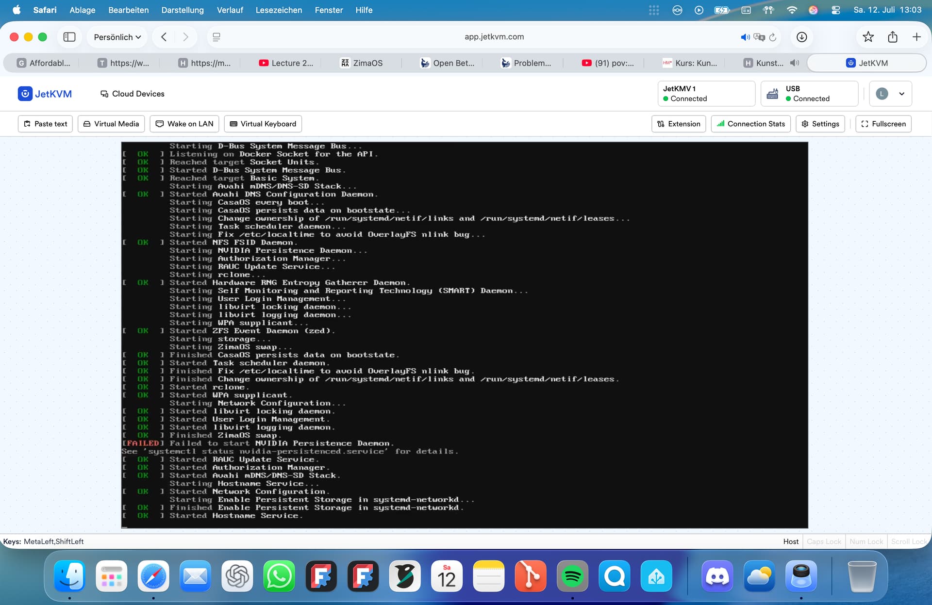

i have a nvidia 1060 in my cutom build server and it won’t initialize.
this are screenshots form startup

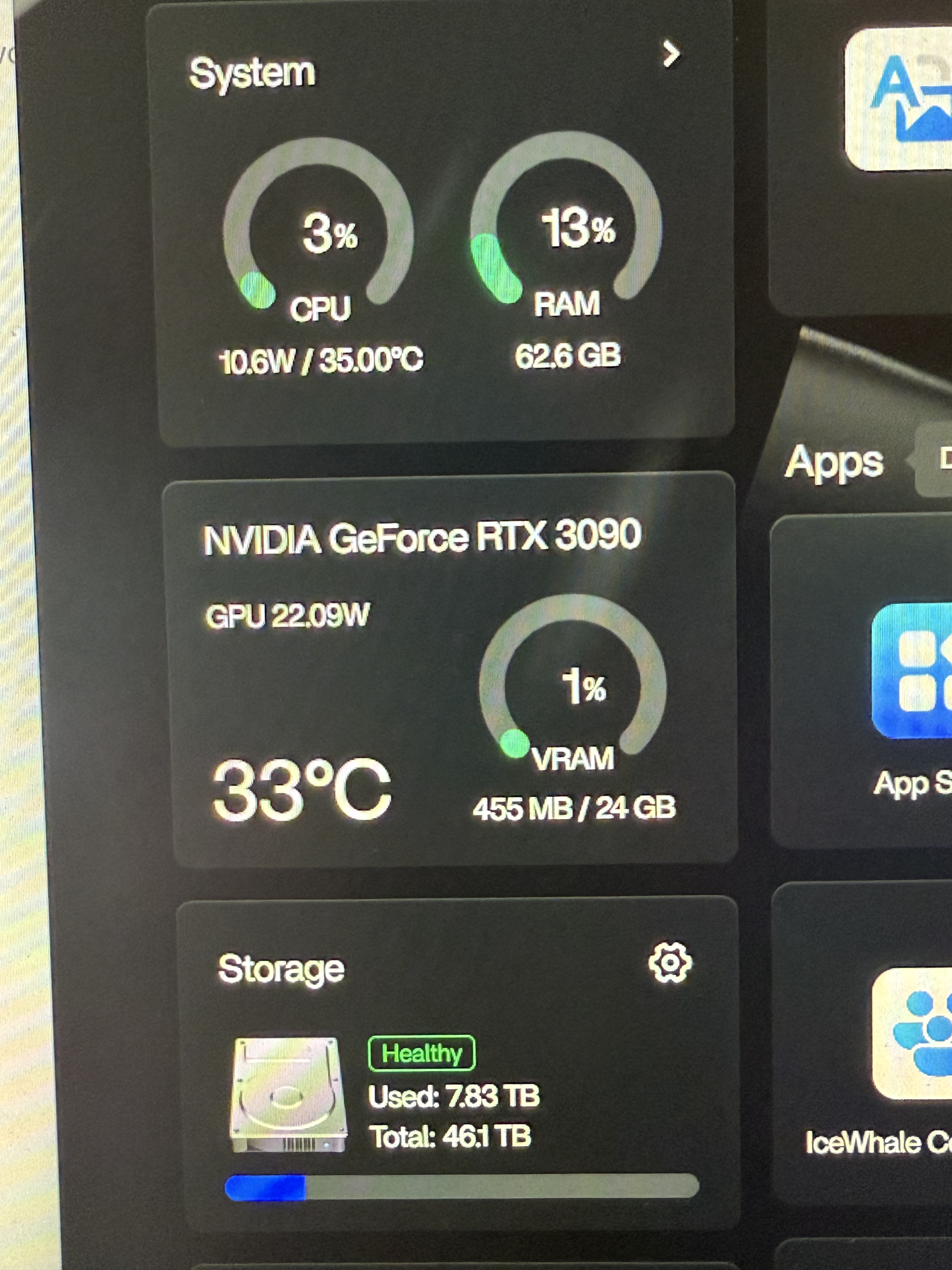

same here rtx 3090 zima lets see the rtx but it does not work any more

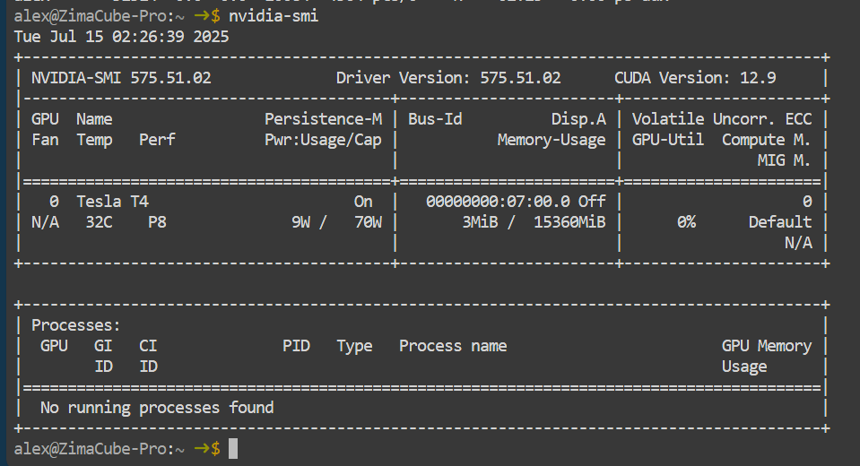

Tesla T4 seems ok

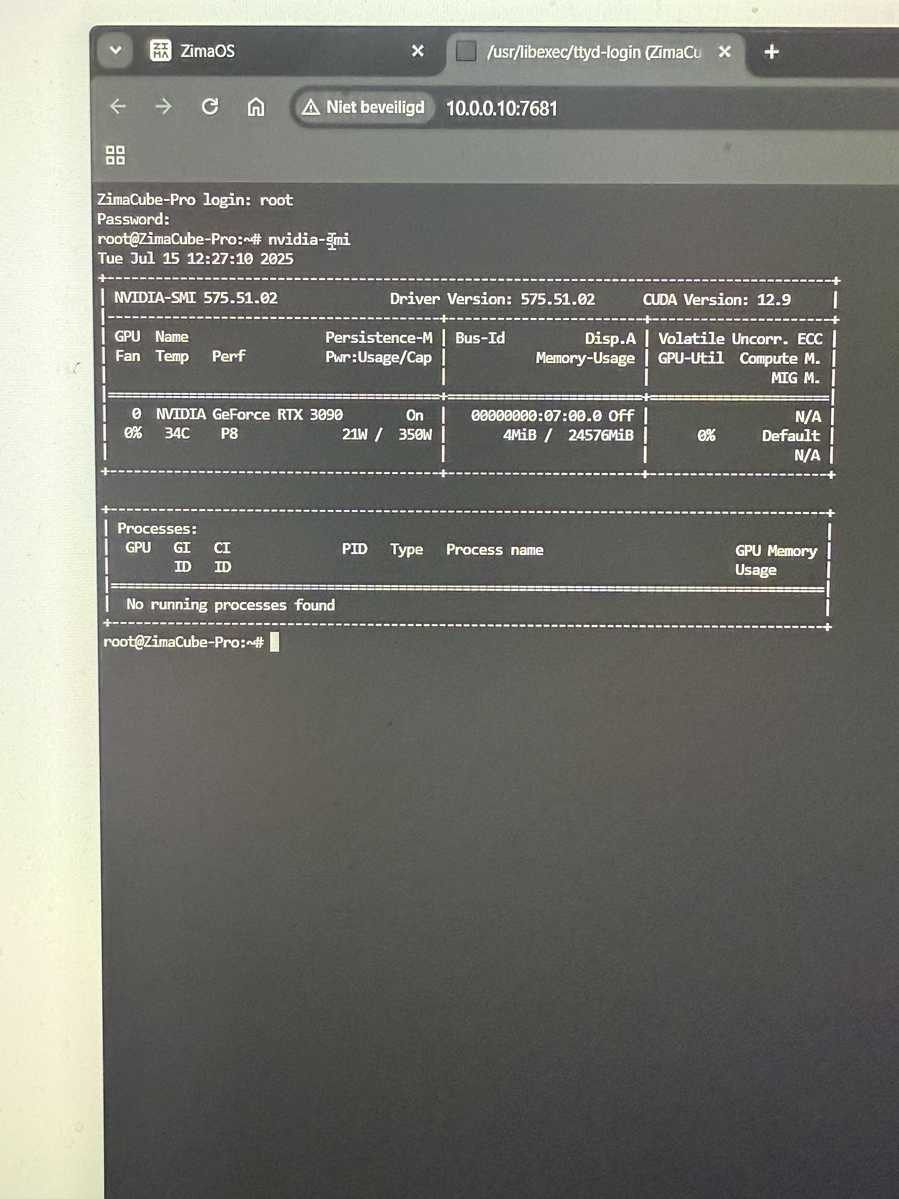

Could you help confirm whether the nvidia-smi command fails to display graphics card information (nvidia 1060)?
Could you help confirm whether the nvidia-smi command fails to display graphics card information (rtx 3090)?
Lukas@ZimaOS:~ ➜ $ nvidia-smi
NVIDIA-SMI has failed because it couldn’t communicate with the NVIDIA driver. Make sure that the latest NVIDIA driver is installed and running.

systemctl status nvidia-persistenced
systemctl restart nvidia-persistenced
nvidia-smi

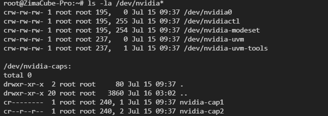

1. First check if hardware is recognized
lspci | grep -i vga # If there’s output, proceed to next step
2. Load modules (no reboot required)
modprobe nvidia
modprobe nvidia_modeset
modprobe nvidia_drm
modprobe nvidia_uvm
3. Immediately check the results
ls -la /dev/nvidia*
nvidia-smi

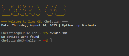

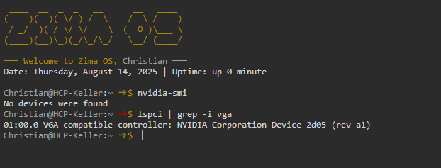

I have the same issue and performed the steps mentioned in this thread
Running the nvidia-smit command returns “no devices were found”
However, when running the lspci command it does how my Nvidia graphics card
Can you please provide guidance as to what I need to do to get this going.
