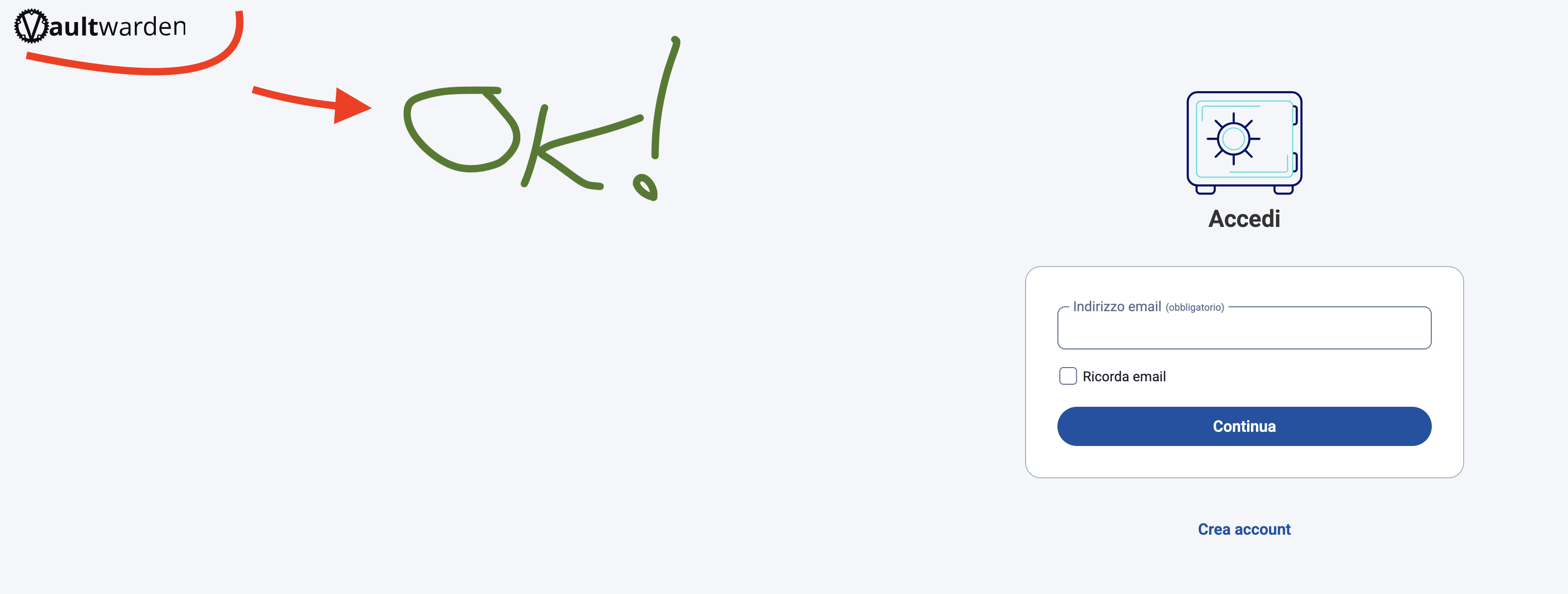

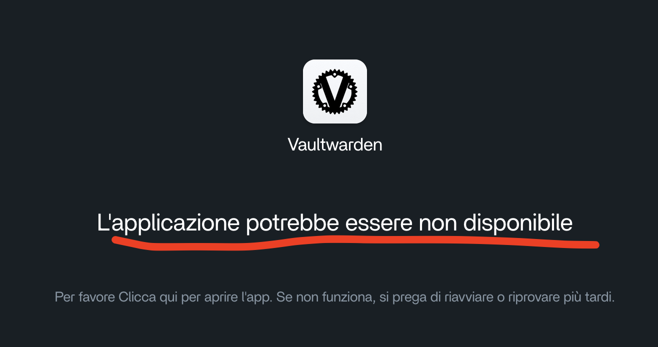

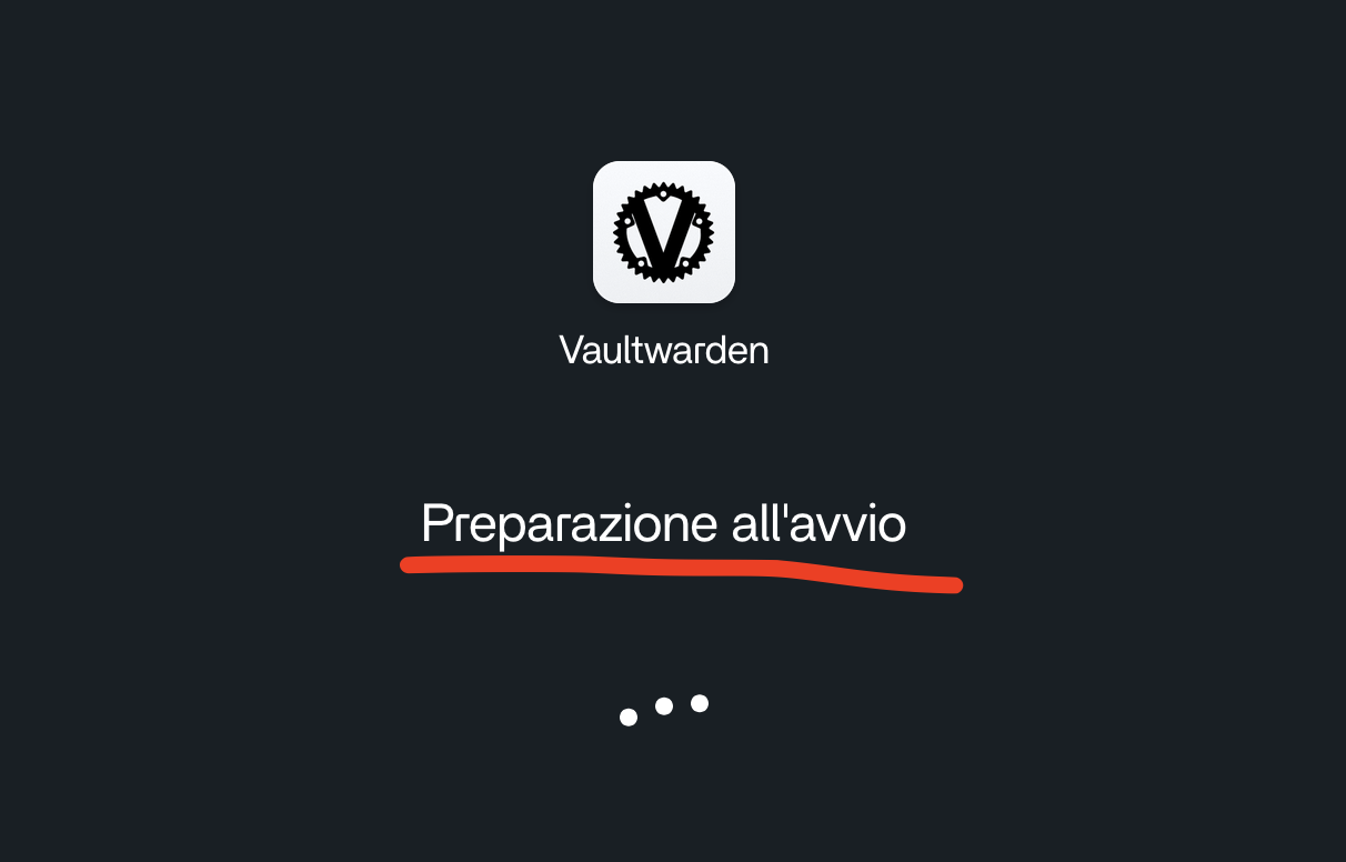

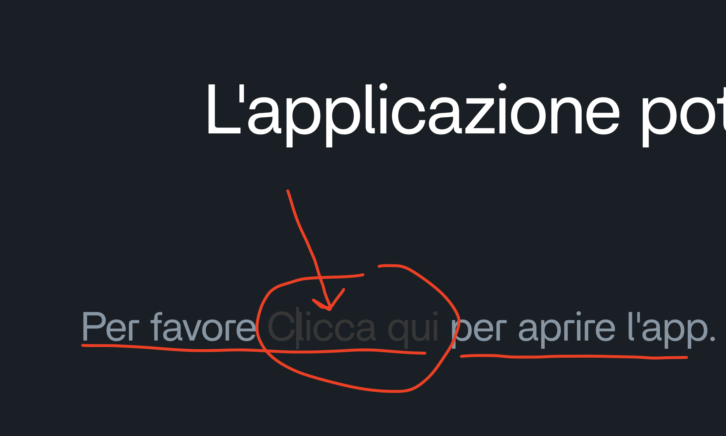

To me, this is not an error related to the app startup. Instead, it seems that after the 1.4.2 update, ZimaOS is unable to load the container apps correctly. On my ZimaBoard 832, all the apps correctly maintain their on/off status, but the GUI is unable to launch them properly, even after restarting the system and the apps.
If I launch the app prom ZimaOS dashboard the GUI follows this steps:
  1. app startup screen (as if it were off, even though it is actually already on)
2. The process seems stuck, and the message appears: (line 1) "The application might be unavailable" (line 2) "Please click here to open the app. If it doesn’t work, please restart or try again later." 3. If I click the suggested link, a new window opens 4. The new window correctly displays the application, which is working properly. It is worth noting that **if I paste the app’s web interface address into the browser’s address bar, it opens immediately without any issues**, whereas the ZimaOS GUI is unable to open it, even though the address and port are correct in the app settings. Please note that this happens with all the apps except the pre-installed ones (Files, App Store, Backup, etc.).

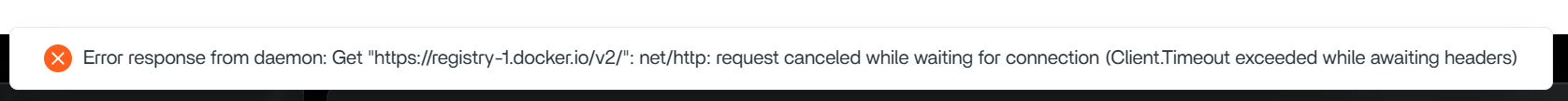

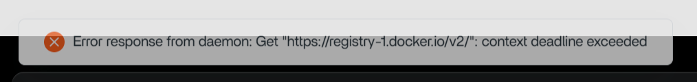

This is error I get when updating Radarr.
Error when updating Sonarr.
These errors are only 1 s in view, then they are gone.
Claude / Antrophic says that there is a problem with a chinese docker registry mirror that is configured to block all non-chinese IP-adresses.

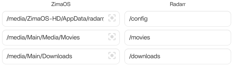

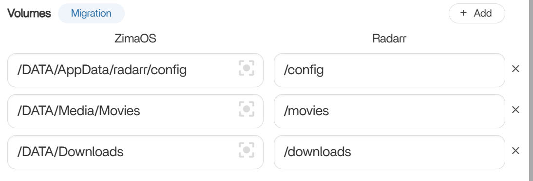

This is my folder settings for Radarr:
Also, this may be helpful:
I have solved it now by changing the mirrors to https://mirror.gcr.io en https://quay.io.
Now I can change the settings again.

These are my radar folder settings.
