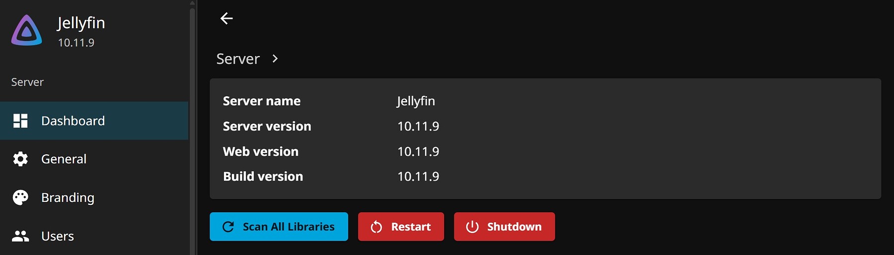

Hi James, and thanks for your post.

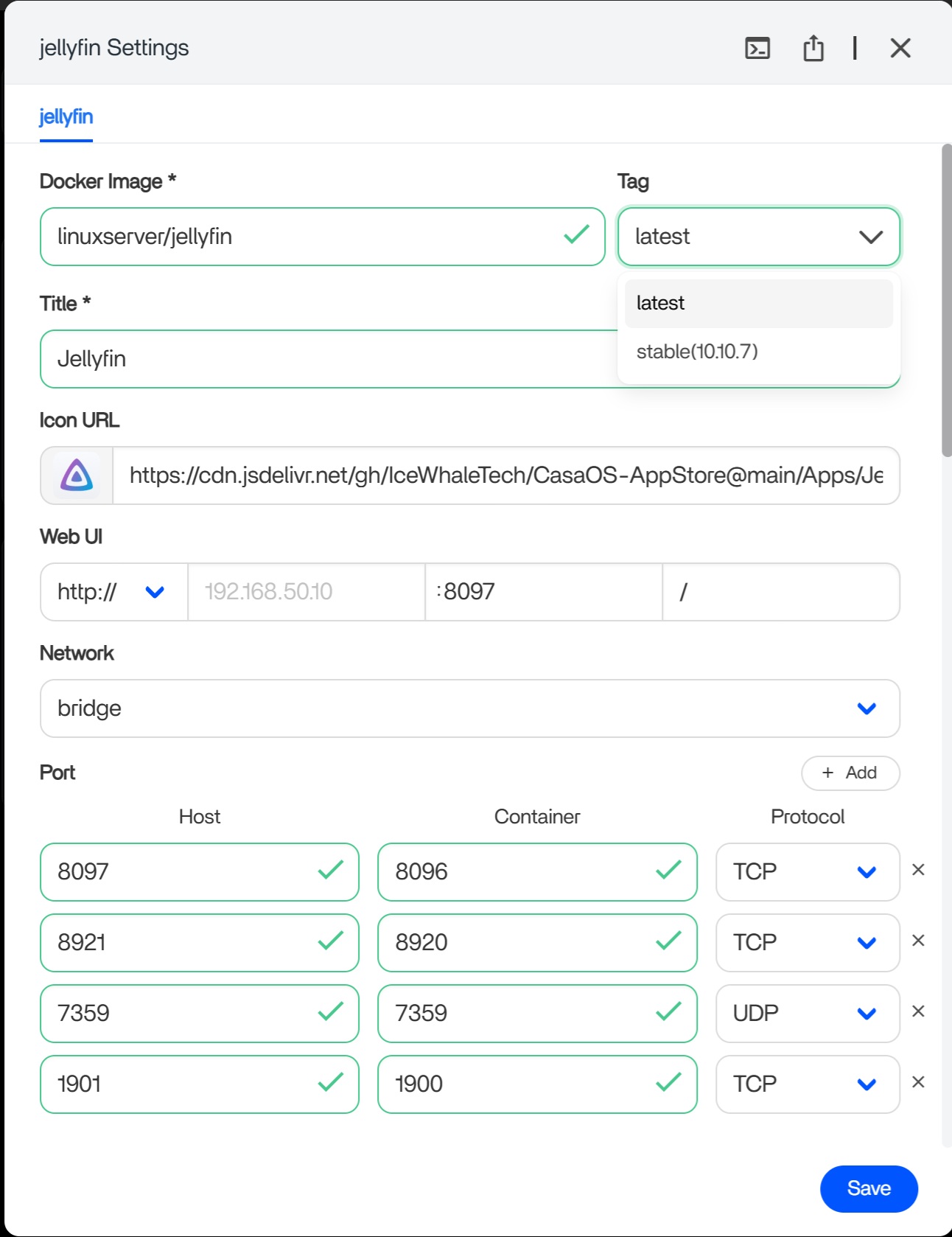

How do you perform the upgrade in Docker?
If you haven’t already updated in the last day then you should find an update notification on the top left of ZImaOS settings menu.
just check you have chosen latest on the jellyfin docker settings. and you can look at the jellyfin dashboard to check if it has been updated.

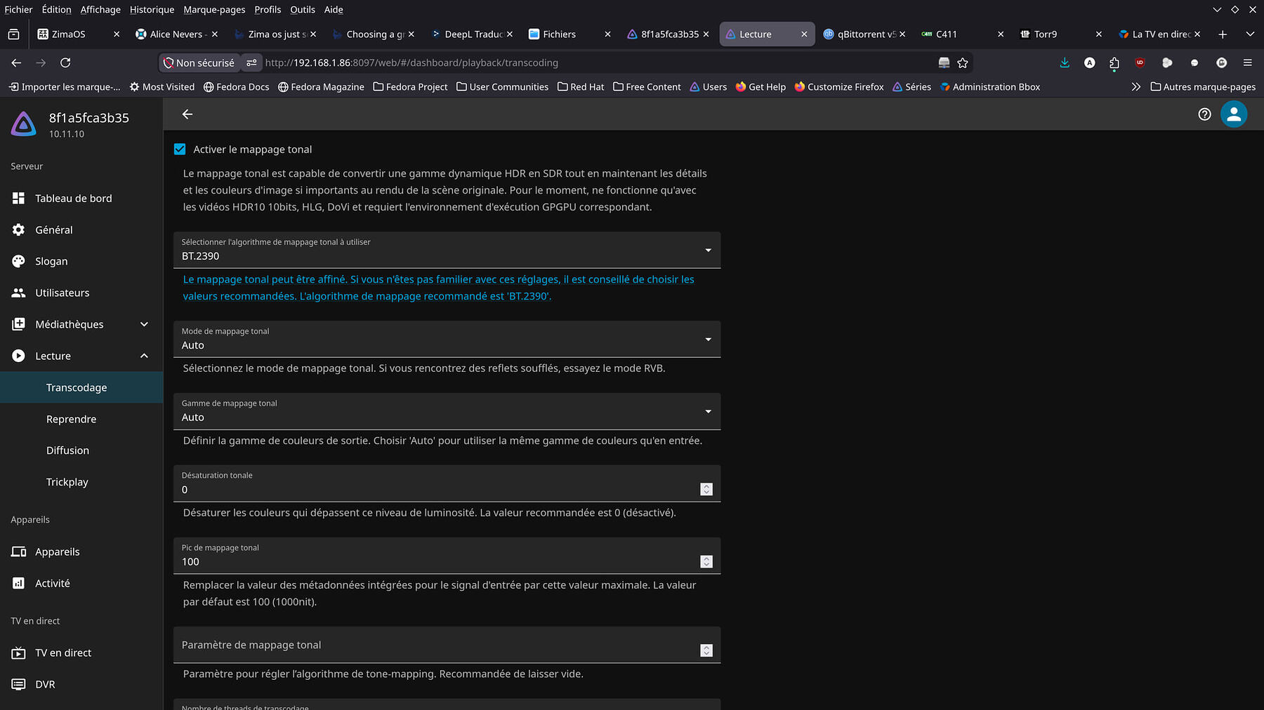

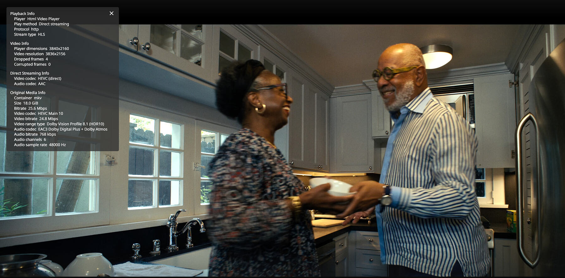

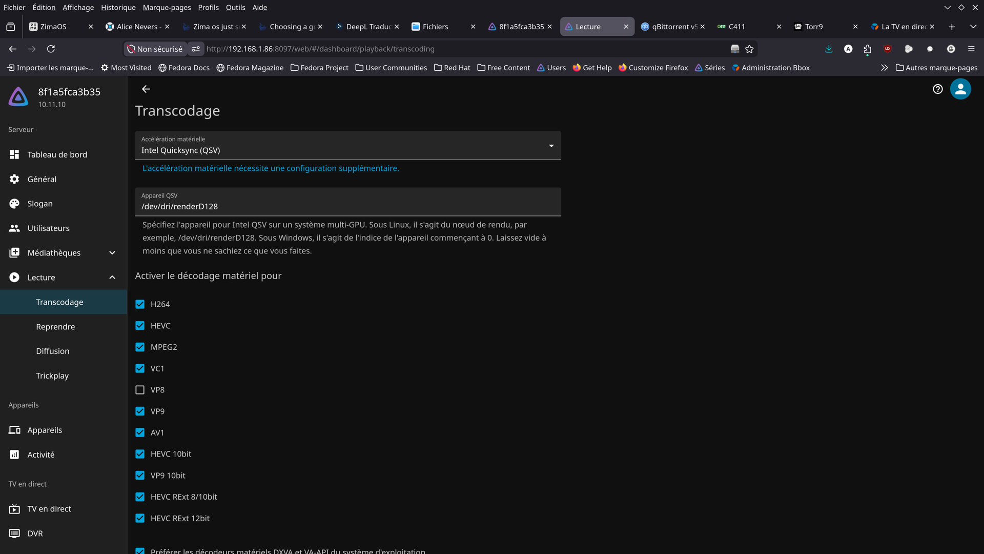

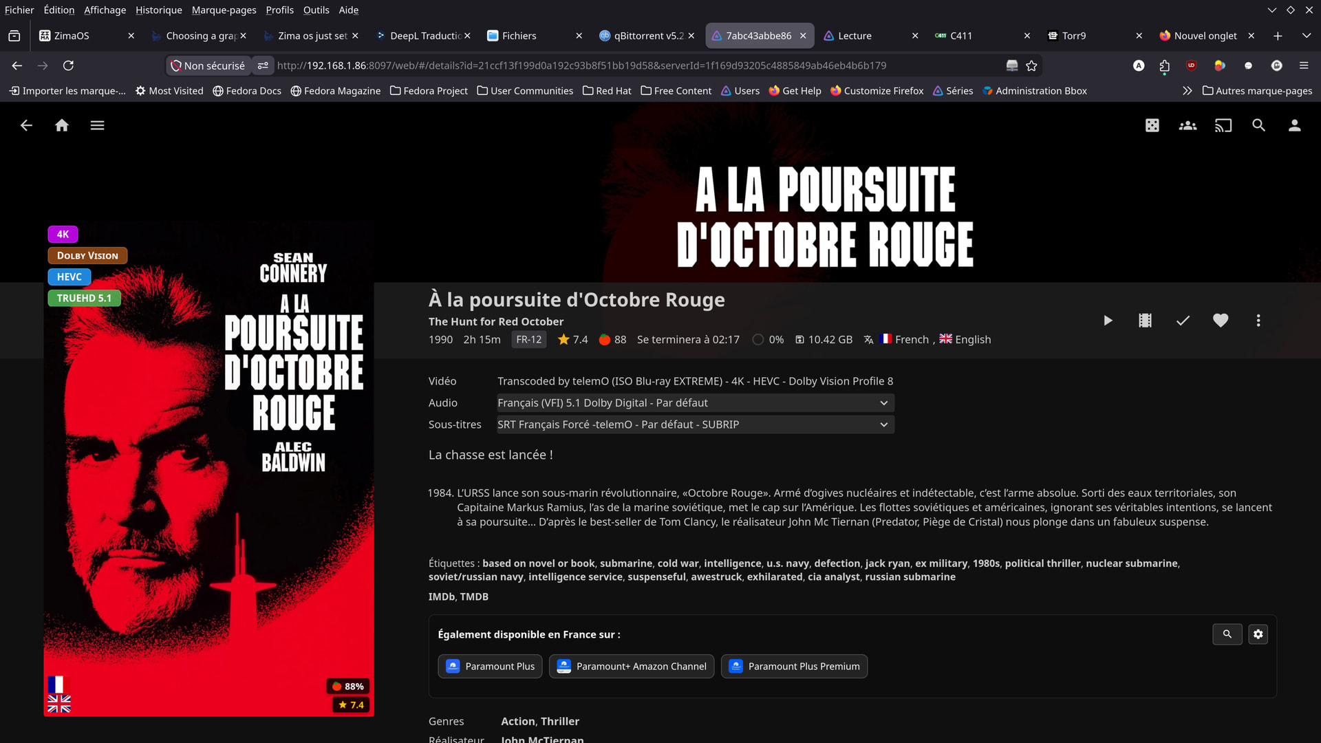

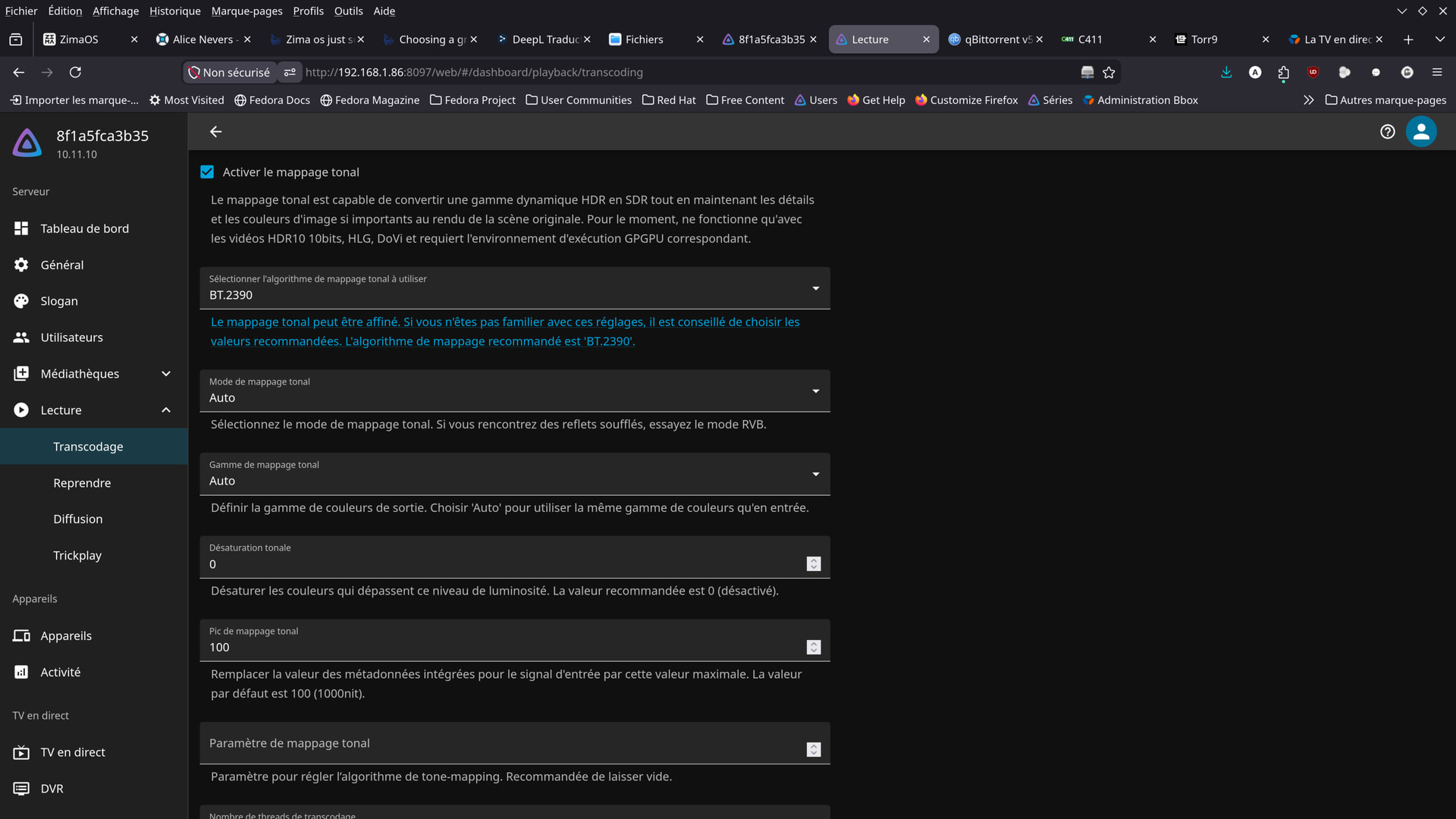

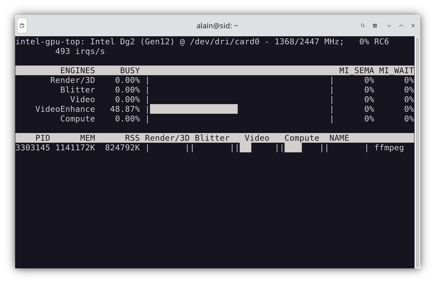

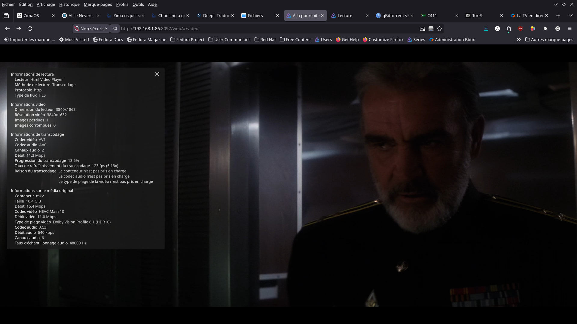

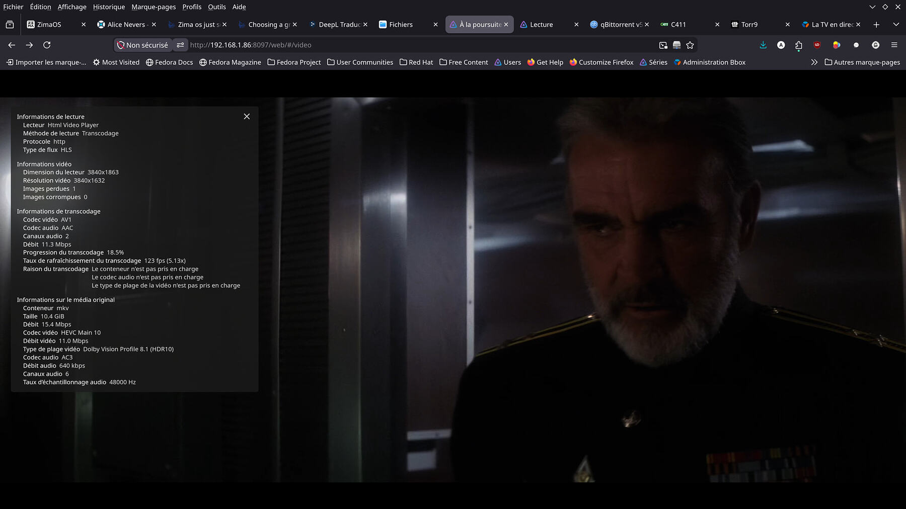

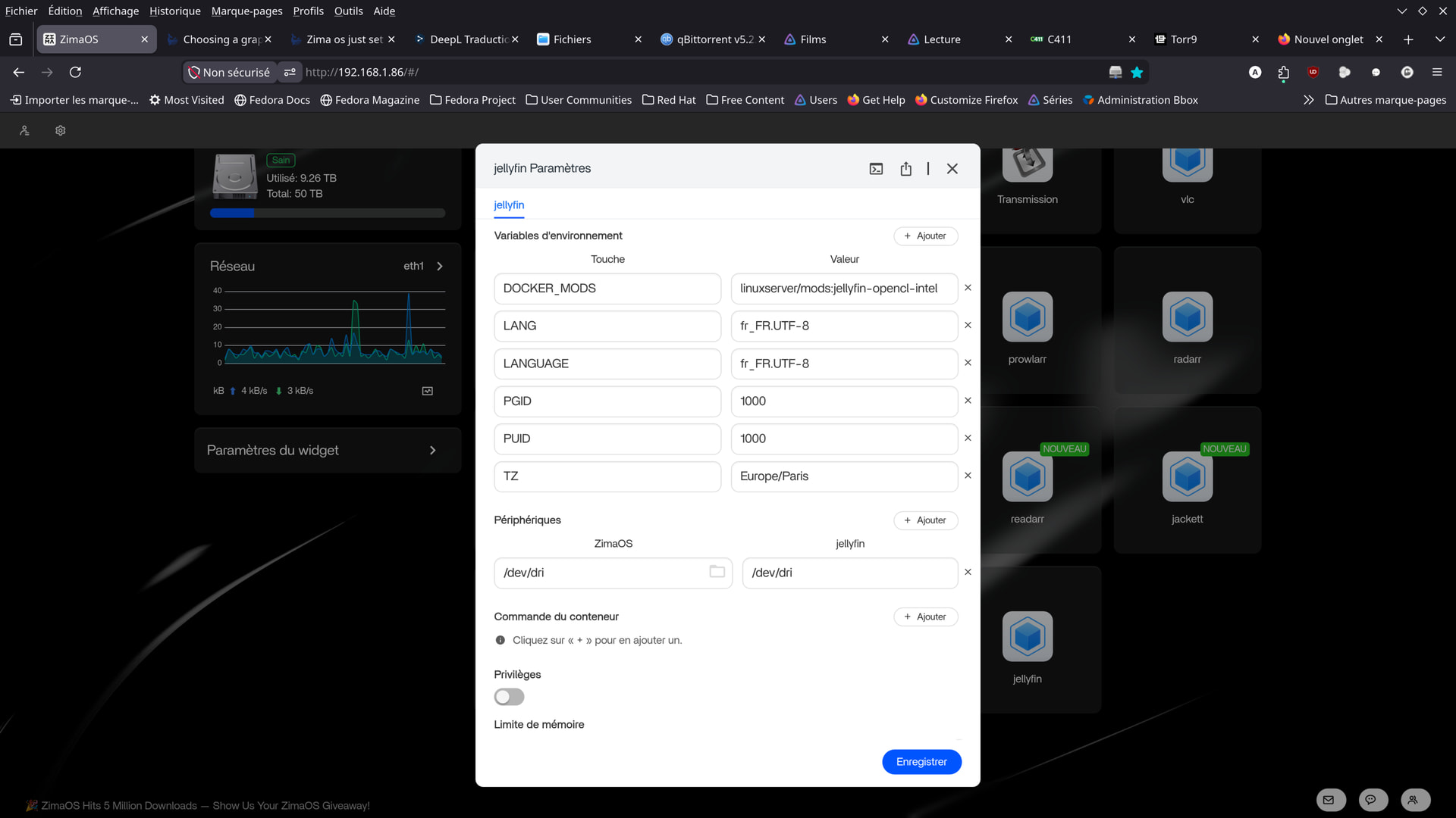

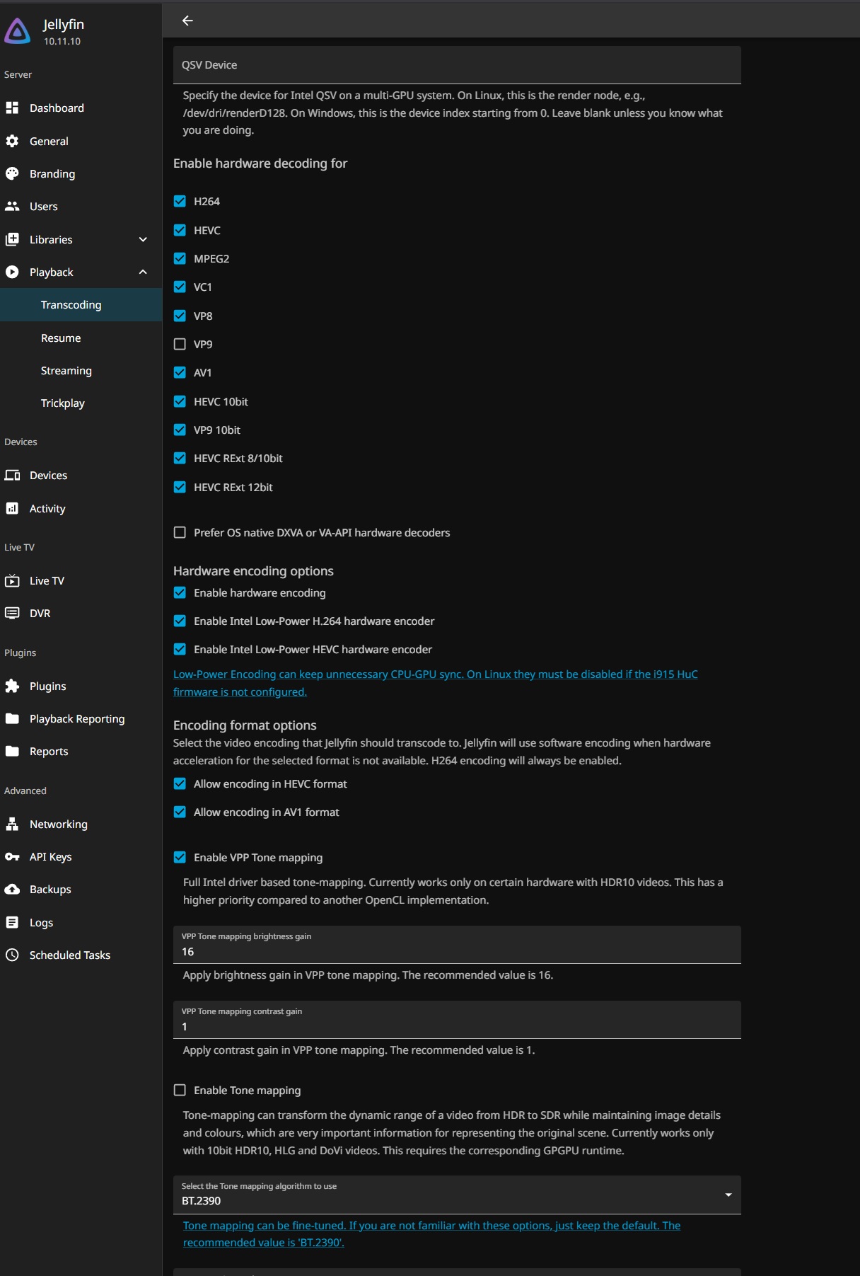

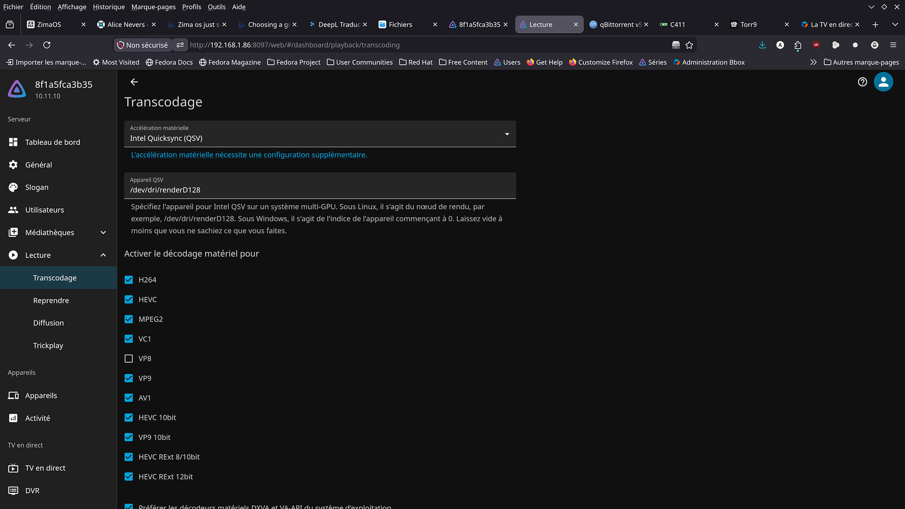

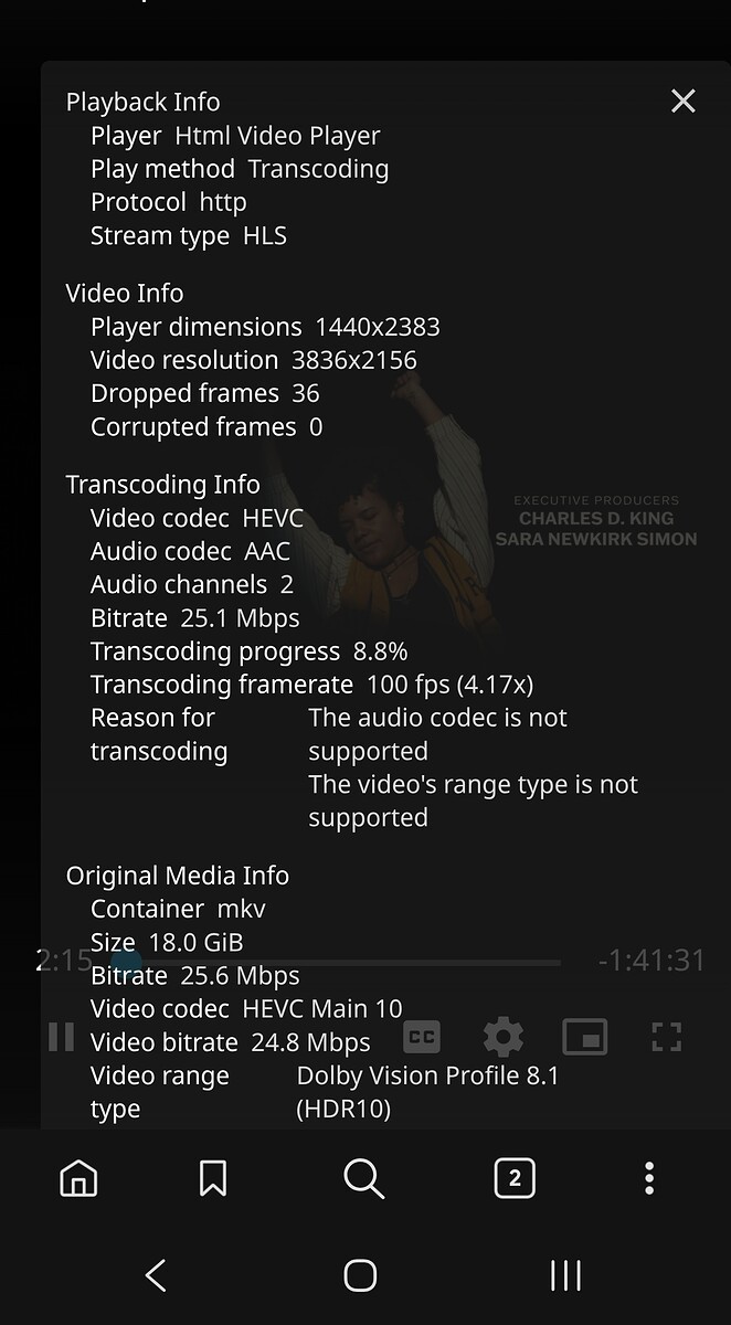

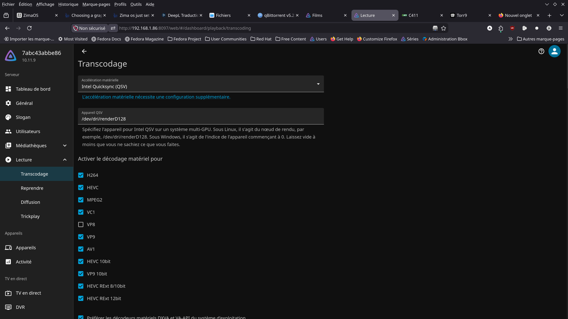

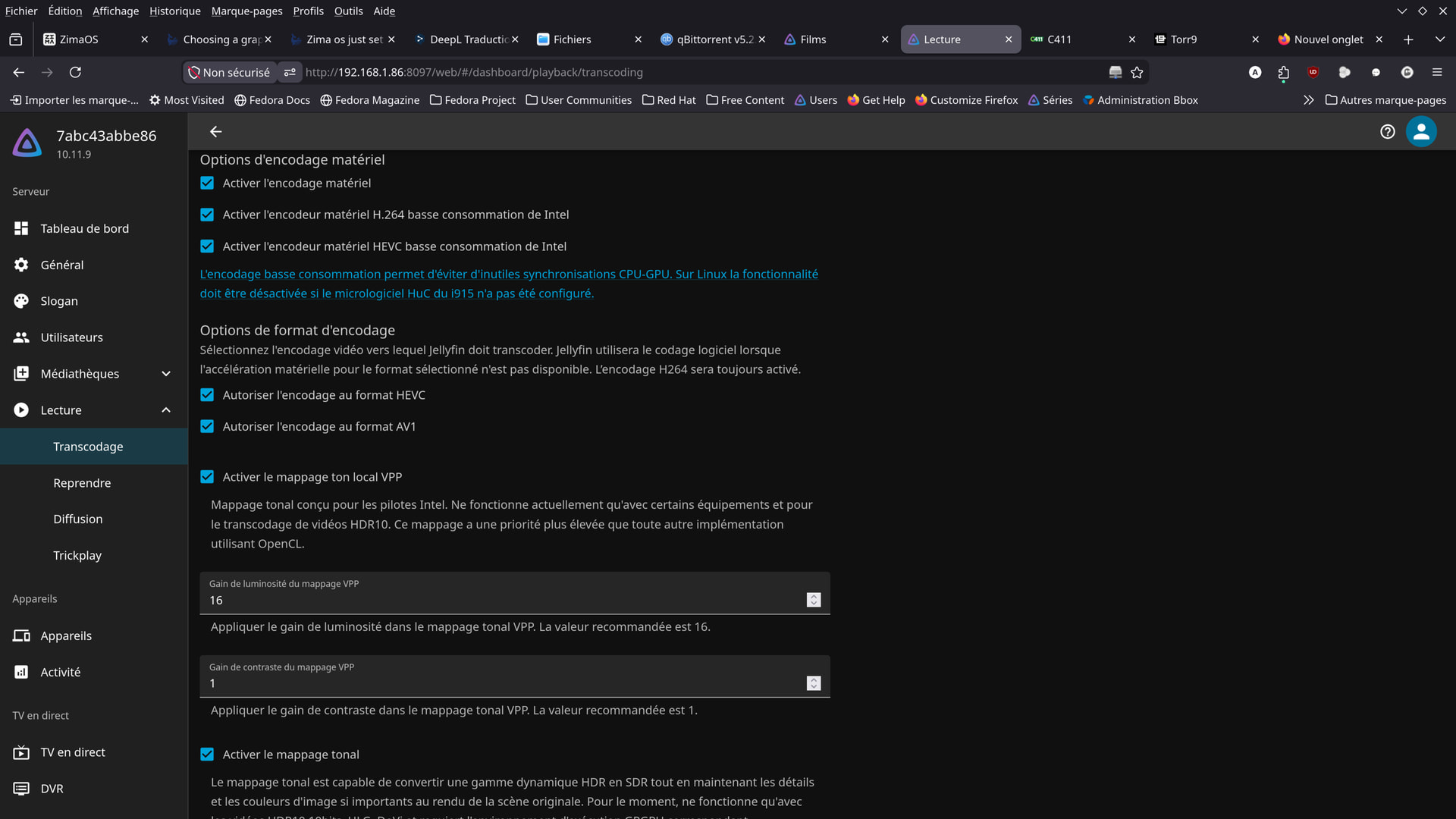

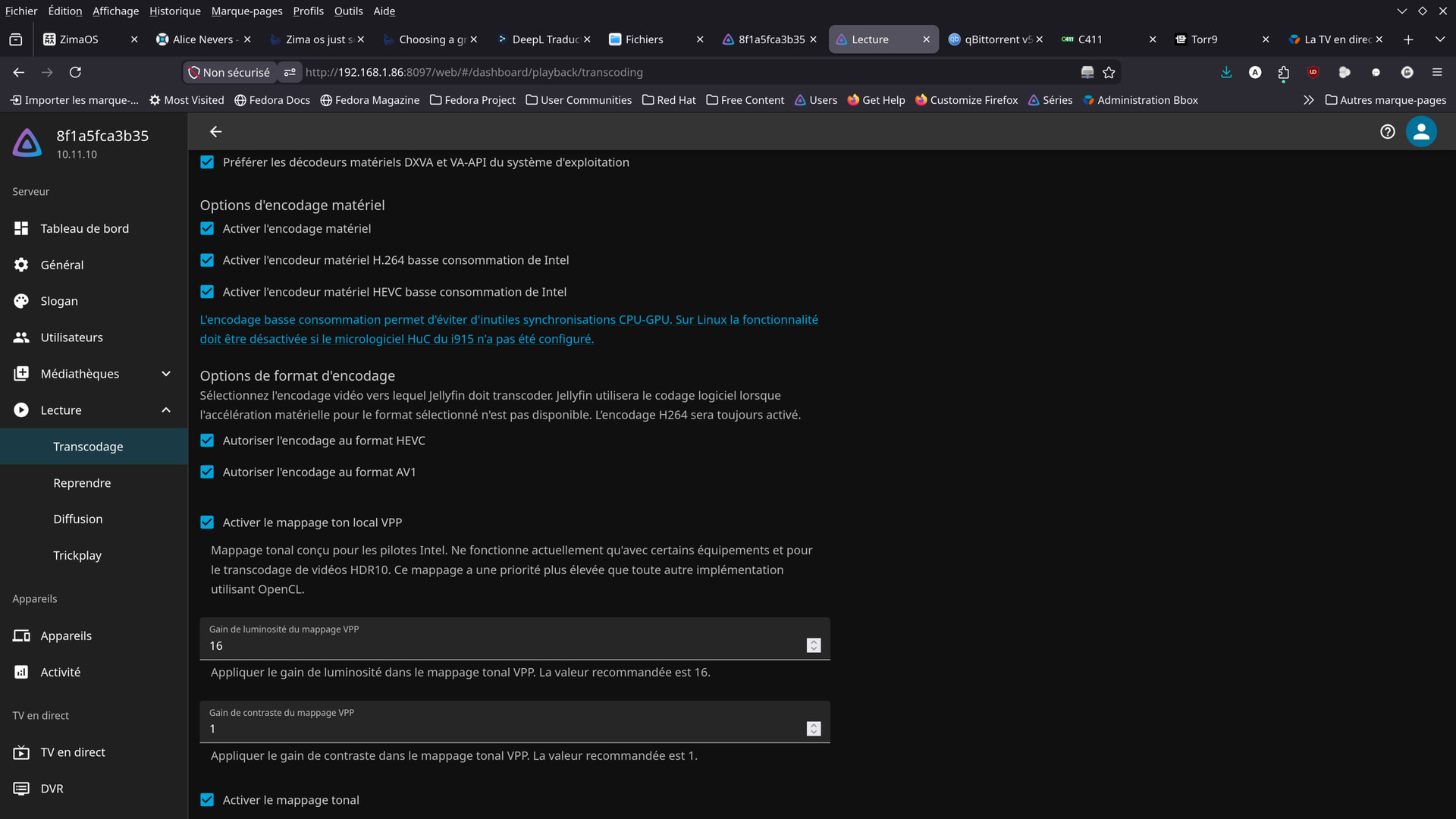

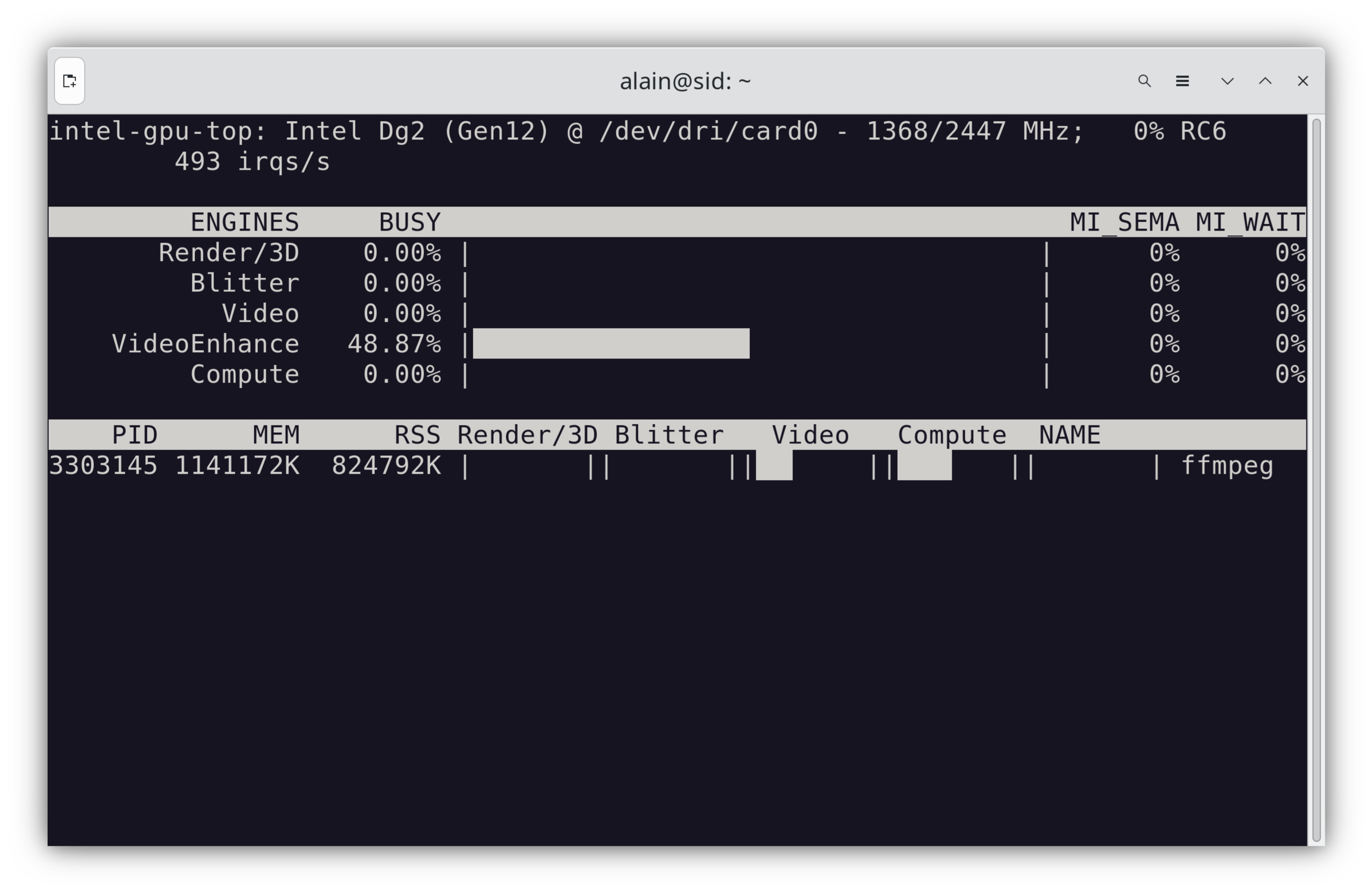

Due to the default configuration of Jellyfin on Zima OS,

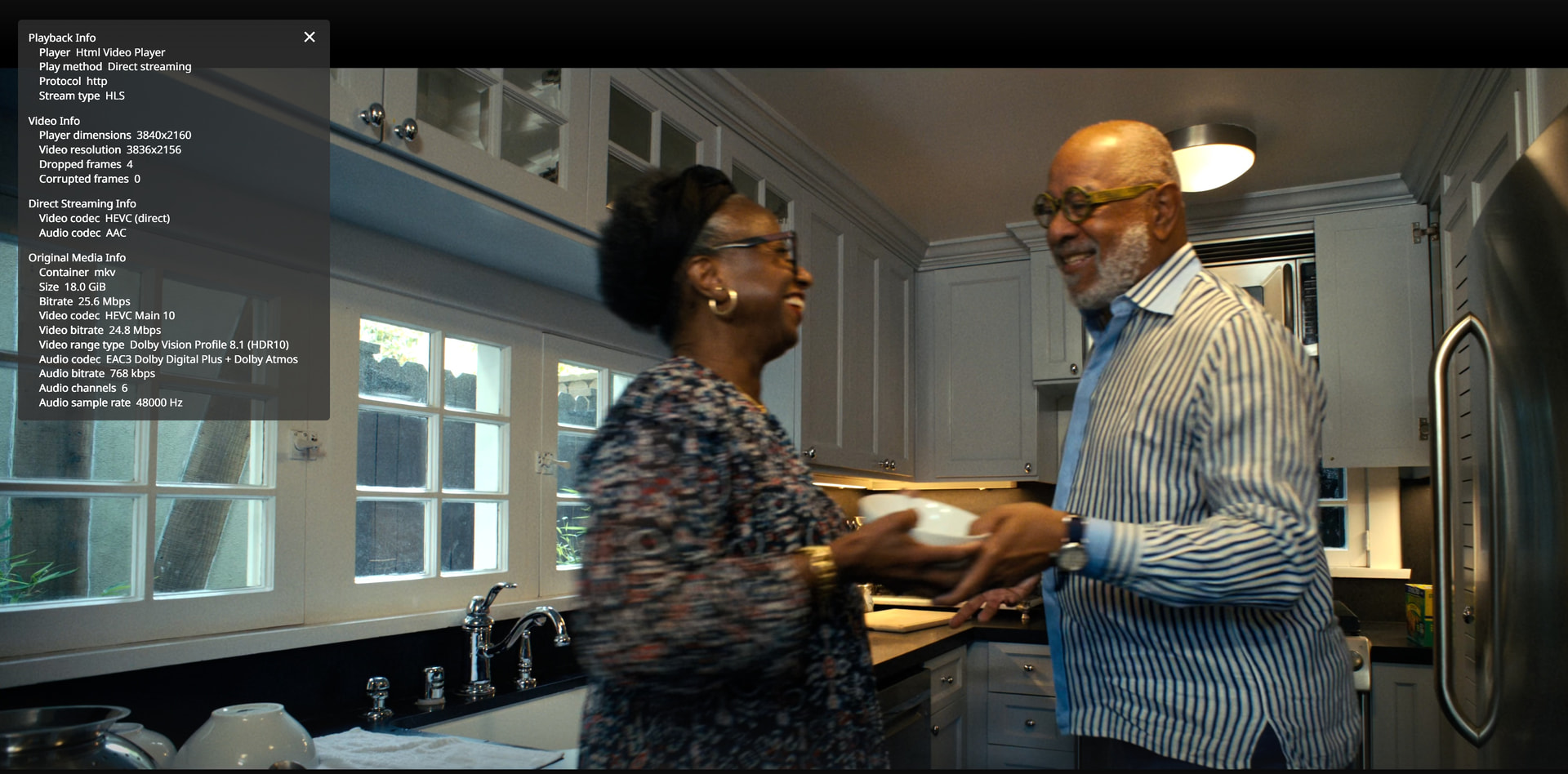

tone mapping wasn’t working on a video (the only one I have) encoded in QSV (Intel A310) and filmed in 4K UHD HEVC Dolby Vision.
I had to install Intel OpenCL.
And now, tone mapping works, and I can finally play my 4K UHD HEVC (Dolby Vision) video.
Here are a few photos:

I found the Jellyfin reports.
I’ll show you the output.
You’ll see an FFmpeg error 237.
Claude IA suspected an OpenCL error.
Apparently, he was right.

I use these settings for my arc A380
HDR playback is fine
And converting from hdr to sdr using tone mapping
So I can only say I don’t really know what the problem you are having is, I’m hoping George will be able to pick up something from your logs provided.

I’ll try to summarize.
Since tone mapping isn’t working on my setup
(I had to disable it)
I checked the Jellyfin logs.
An FFmpeg error 237 appeared.
According to Claude IA, this error is caused by the absence of OpenCL (my interpretation).
So I looked for a way to add it.
I only found this mod (the easiest one) or a modification to Docker Compose using this mod, which amounts to the same thing.
Now, tone mapping works perfectly.
But I can remove this mod whenever I want.

Yes, I had a lot of trouble with tone mapping.
At first, it would work sometimes and not others.
I did some digging in the logs.
And that’s when the infamous FFmpeg error 237 popped up.
An error that Claude IA diagnosed as a break in the OpenCL-tone mapping software chain (at least I think so).
So I concluded that the OpenCL driver was missing.
This was confirmed by Claude.
So I looked for a way to fix this issue.
And, lo and behold, now everything works. Perfectly.
The first log excerpt shows the appearance of error 237 and its consequences.
The second log excerpt shows the situation after the fix.
The following posts show the commands executed to confirm that the fix was successful.

maybe the issue is enabling both VPP intel driver based tone mapping and openCL tone mapping. I just use the VPP intel tone mapping since they added the VPP tone brightness and contrast gain options. before that there was no ability to change those and some videos would appear too dark. often referred in AI without the recent changes.
