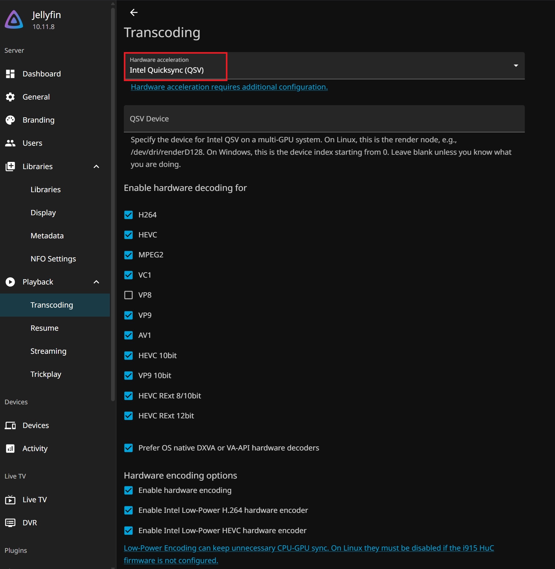

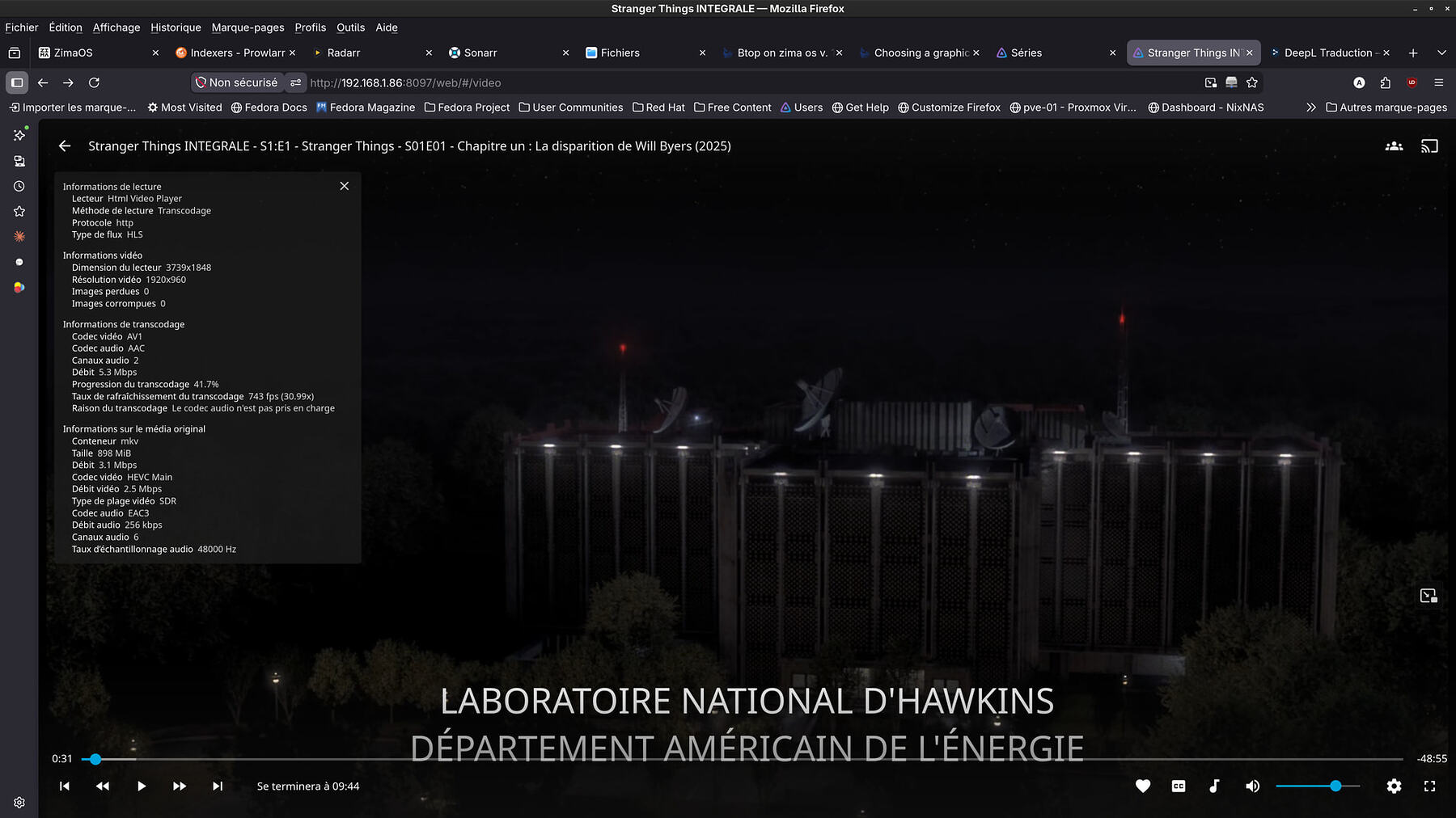

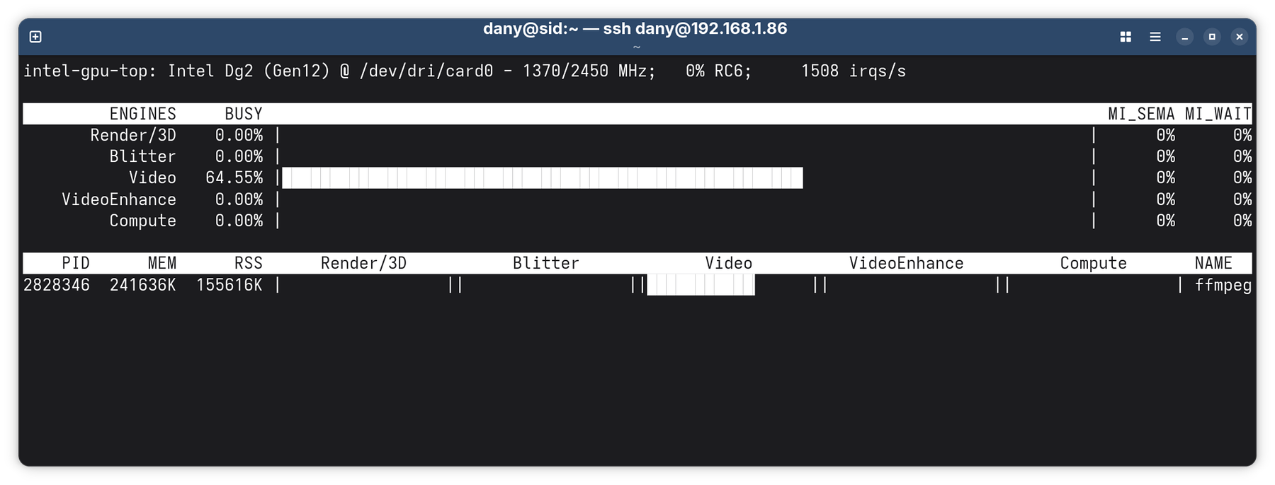

The reason why you wouldn’t have seen any activity on the intel card while playing a video on your pc is that it didnt require any transcoding and could play directly on your pc. in the screen i was showing was a video being transcoded to mobile phone over 5G. if you direct play over your lan there is no need for the card to do any work.

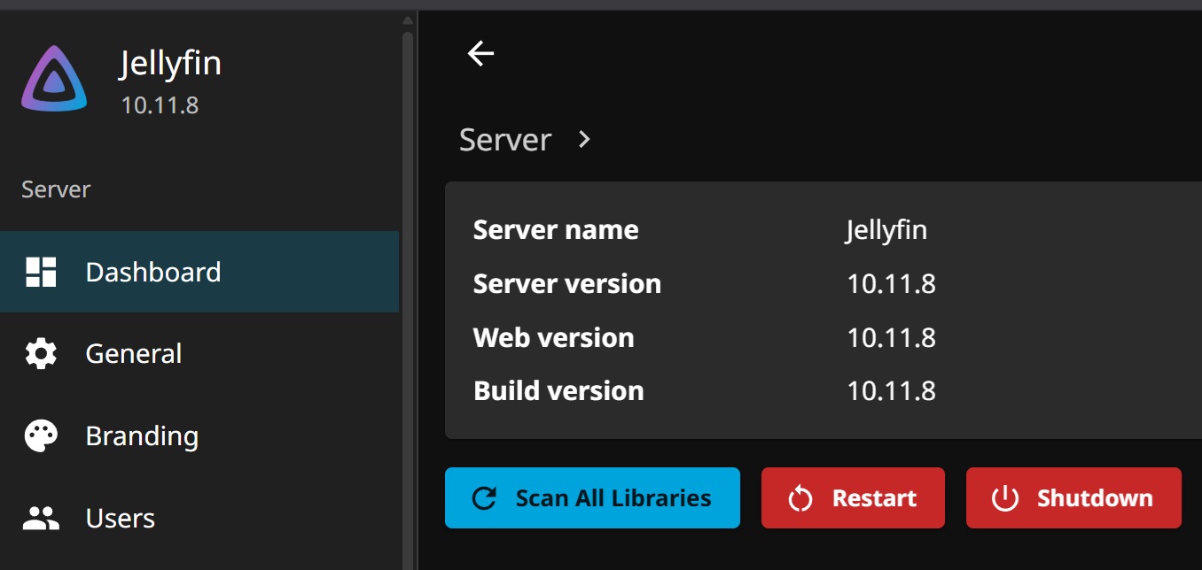

also you need to restart jellyfin from the jellyfin dashboard when you make changes so they are applied.

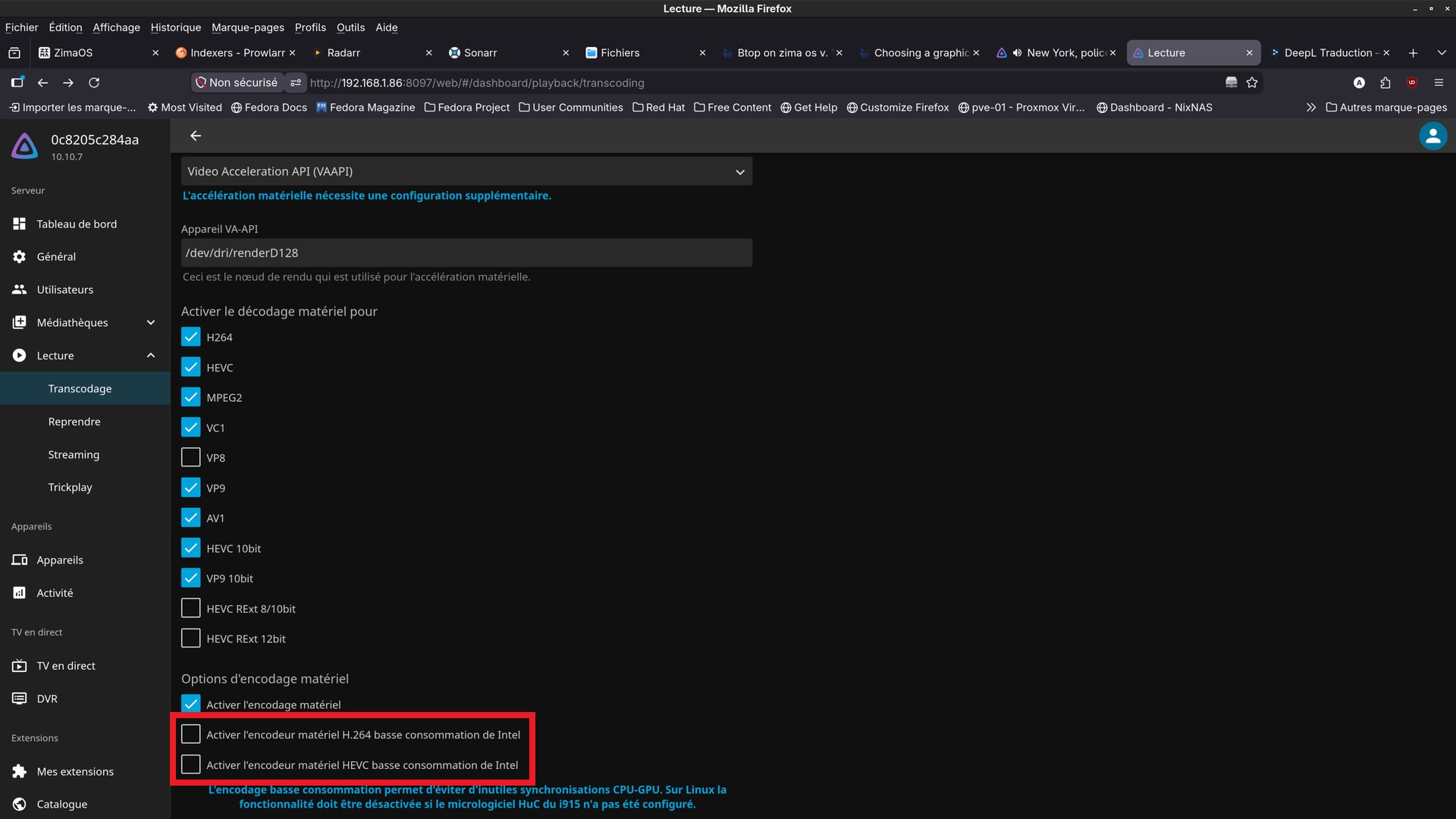

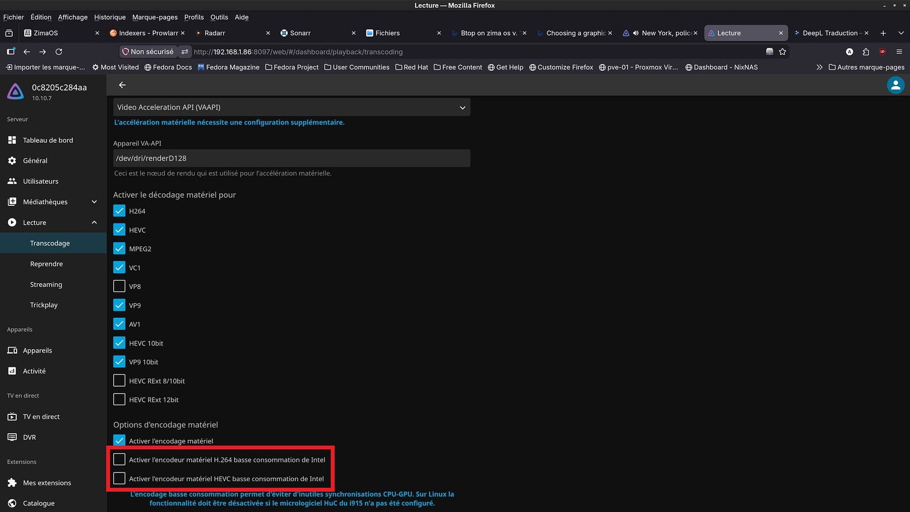

also enable these intel hardware encoders and restart the jellfyfin server from jellyfin dashboard

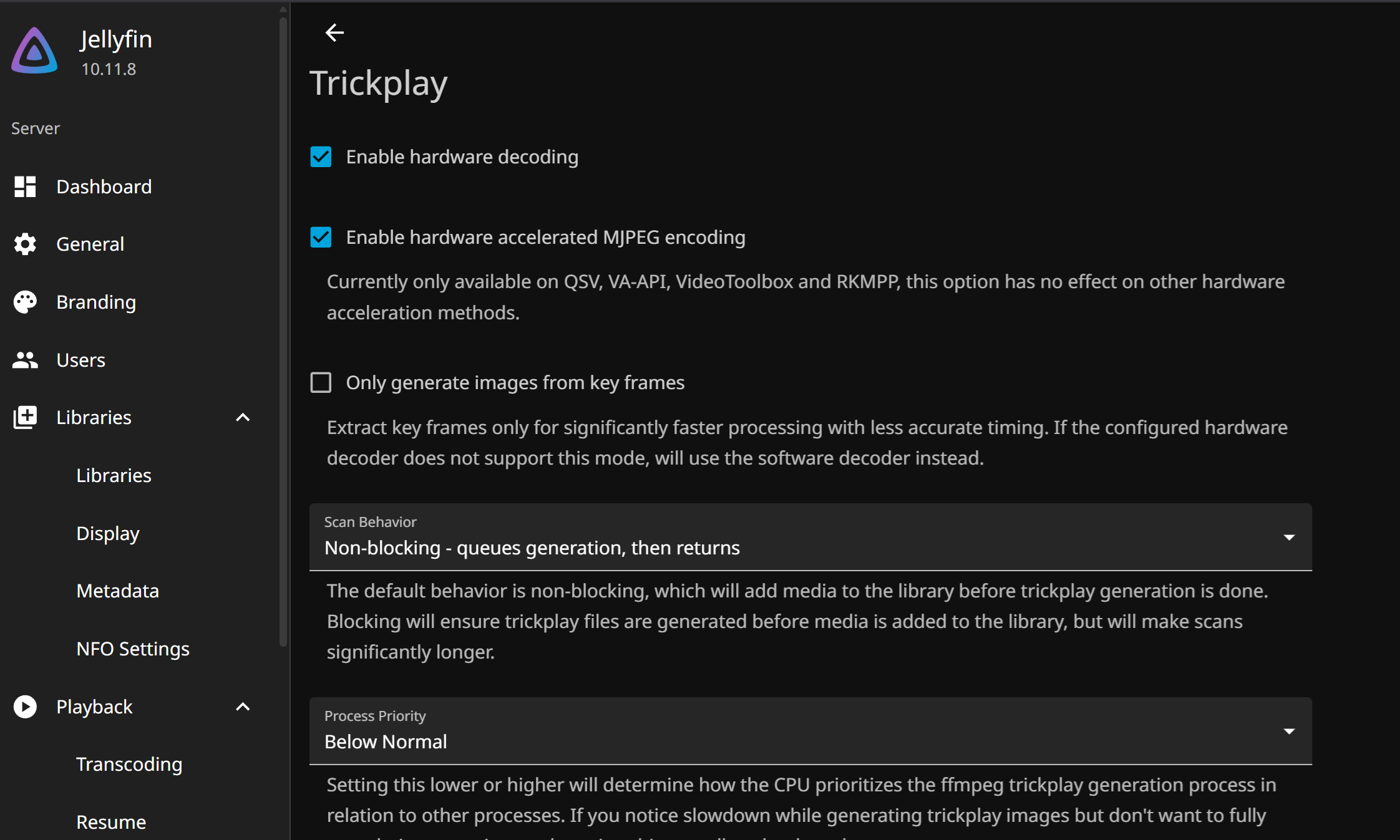

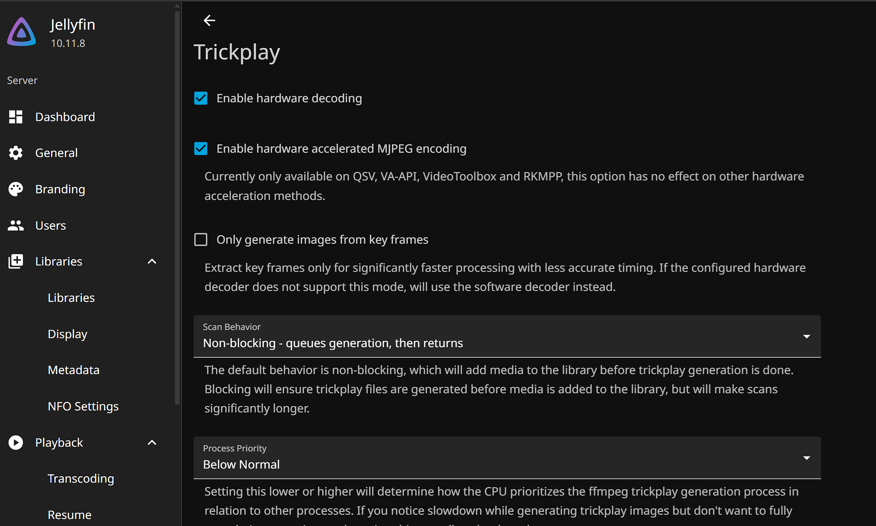

also enabling hardware acceleration in trickplay settings could speed up the image generation during scans

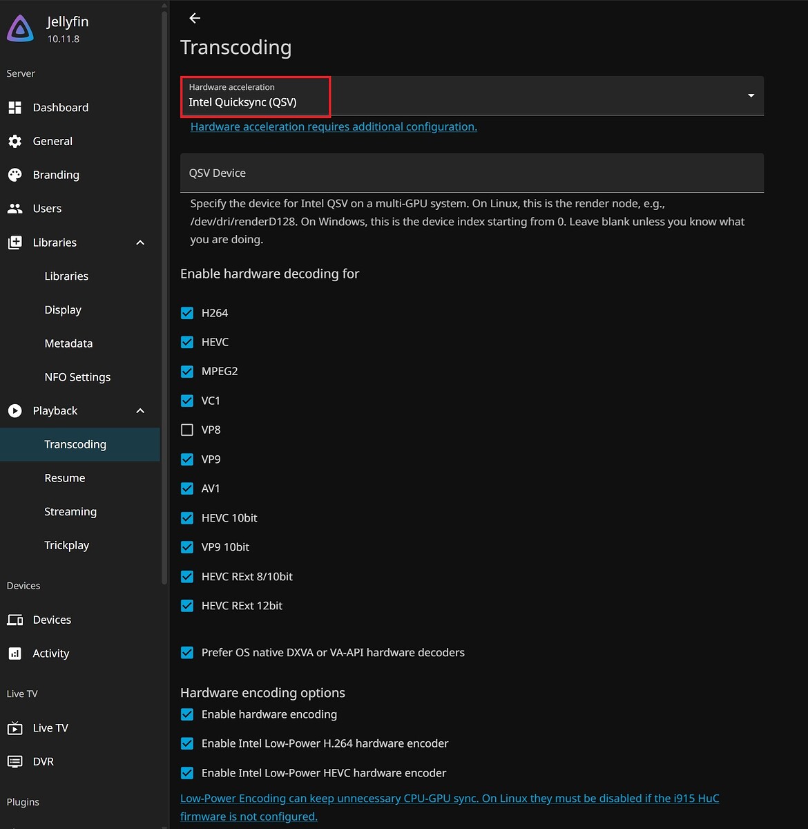

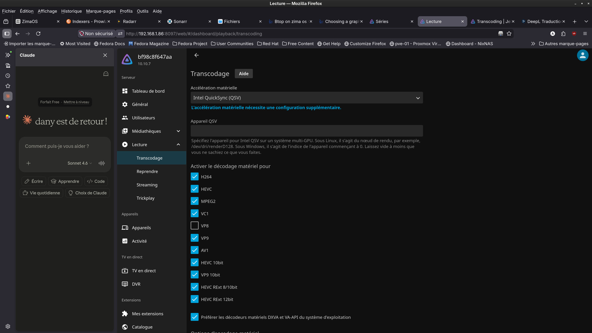

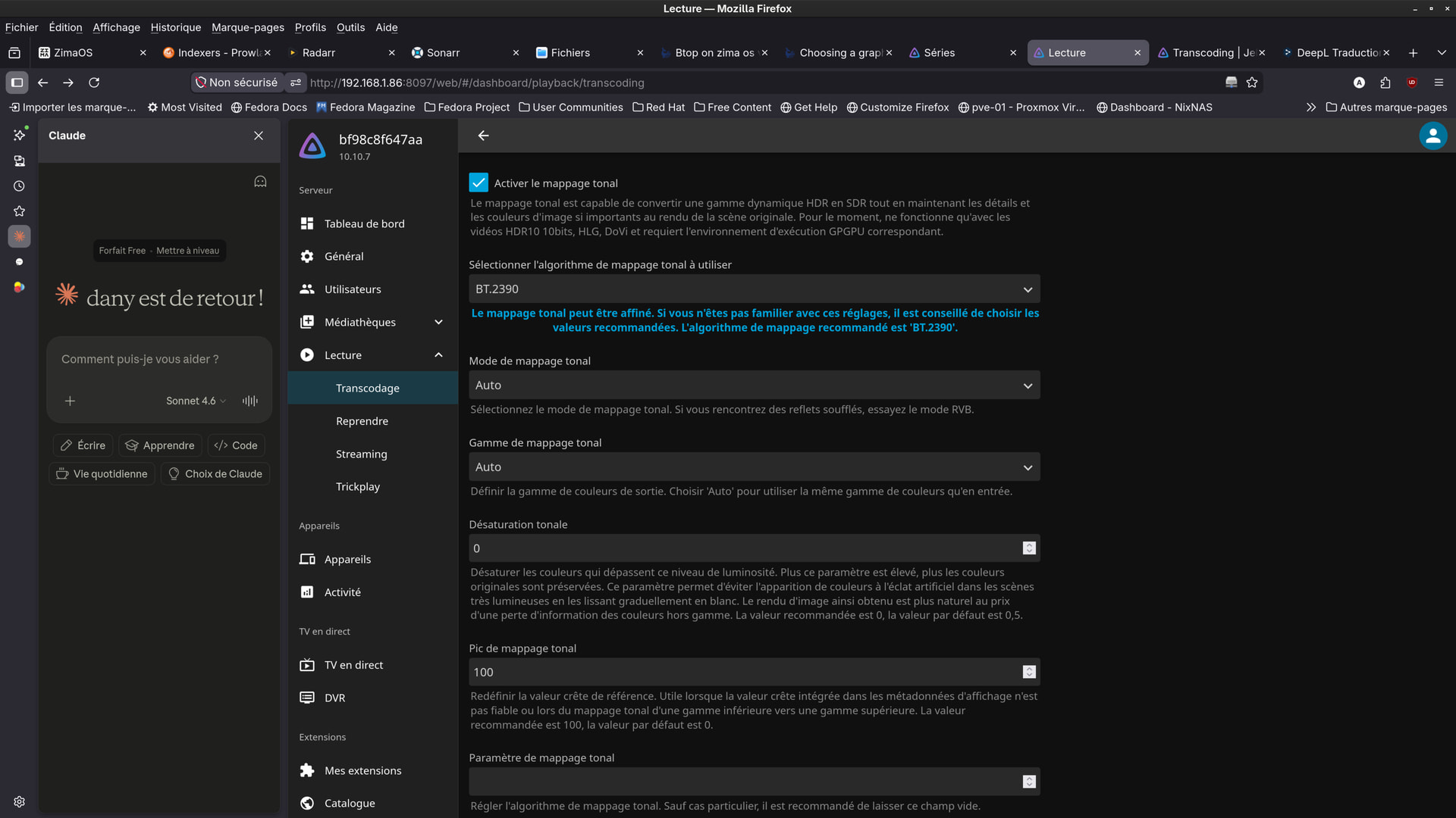

I looked a little closer and noticed you have another few changes in the transcoding settings. you need to enable intel quicksync QSV rather than the VAAPI and leave the box below blank. it should autodetect QSV device when you restart the jellfyfin server.

Isn’t Vaapi more stable than QuickSync?
I’ve yet to encounter a stability issues with qsv, intel qsv is quicker and better optimised for intel hardware so generally preferred on intel based media servers for encoding tasks.

vaapi can be more stable on older hardware, For newer Intel hardware (such as Arc GPUs), Quicksync is now recommended because Intel has deprecated the old media SDK in favor of OneVPL, making VA-API less efficient on these specific platforms.
if you encounter any artifacting or other issues you could try falling back to vaapi.
and you can just copy those settings for your intel a310

hi james , i’m back .
here are some photos :
my vaapi :

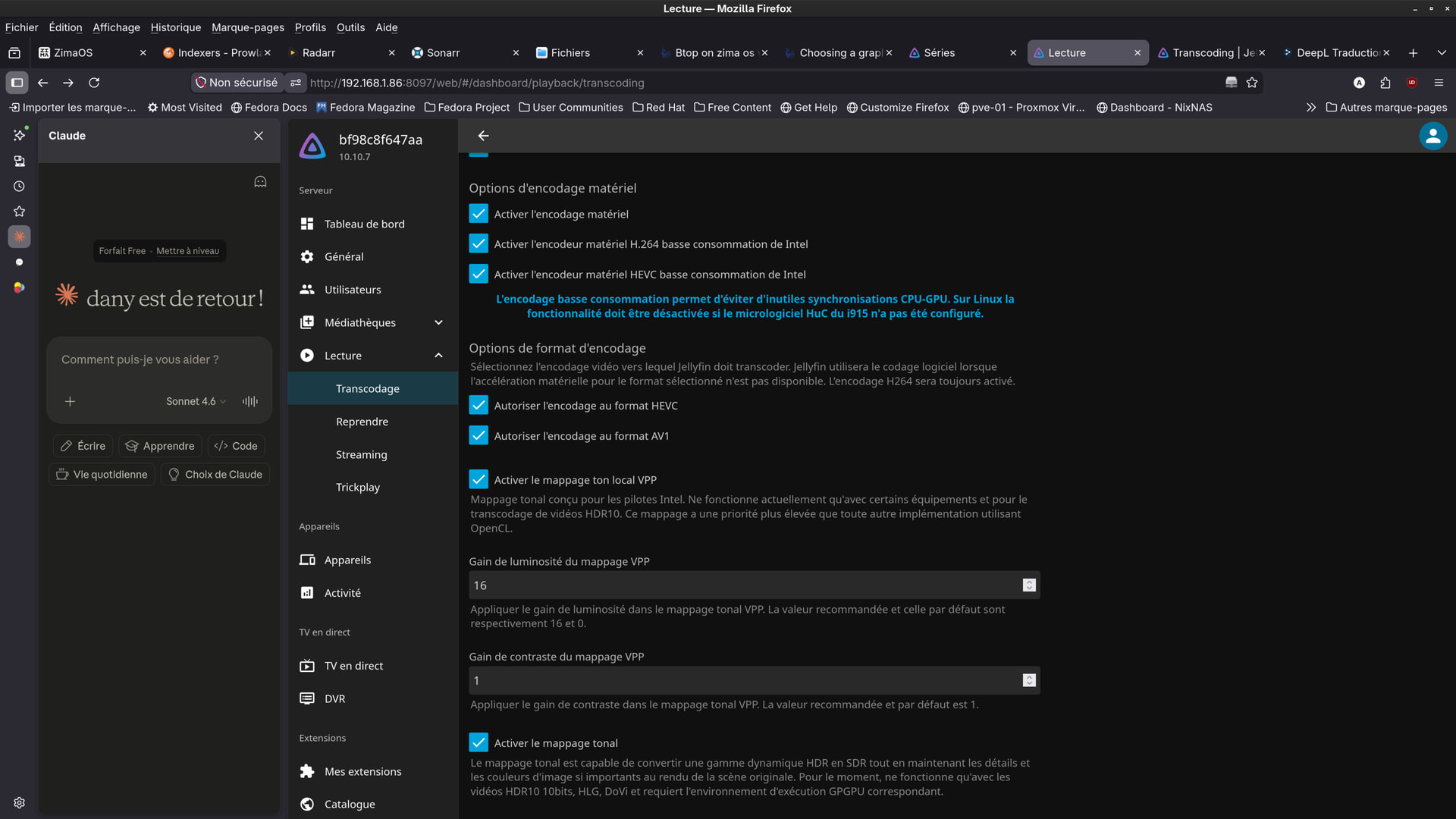

my hardware presets :
like you see , after restarting jellyfin , the quicksync device do not appear .
do i have to go back to vaapi ?
what have i to do ?

I don’t think you need to do anything, I have always left the box blank by default during installs, it seems regardless of the box saying qsv device like mine that it appears to have detected the arc card and is functioning correctly, so its just cosmetic really. are you having any issues with transcoding?

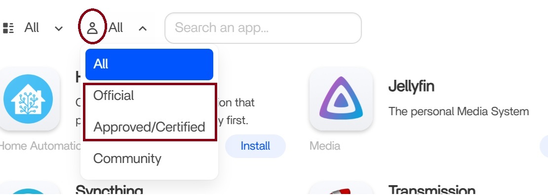

Most times you will find that apps from app store require very little configuration unless they are from a different repo like the big bear casa os or linux server repositories, where you found the version of btop that gave you hassle rather than using the built in version ZimaOS has. then they fall out of the official or approved/certified category. and you can find problems installing and using them out the box without some extra user input and tinkering.

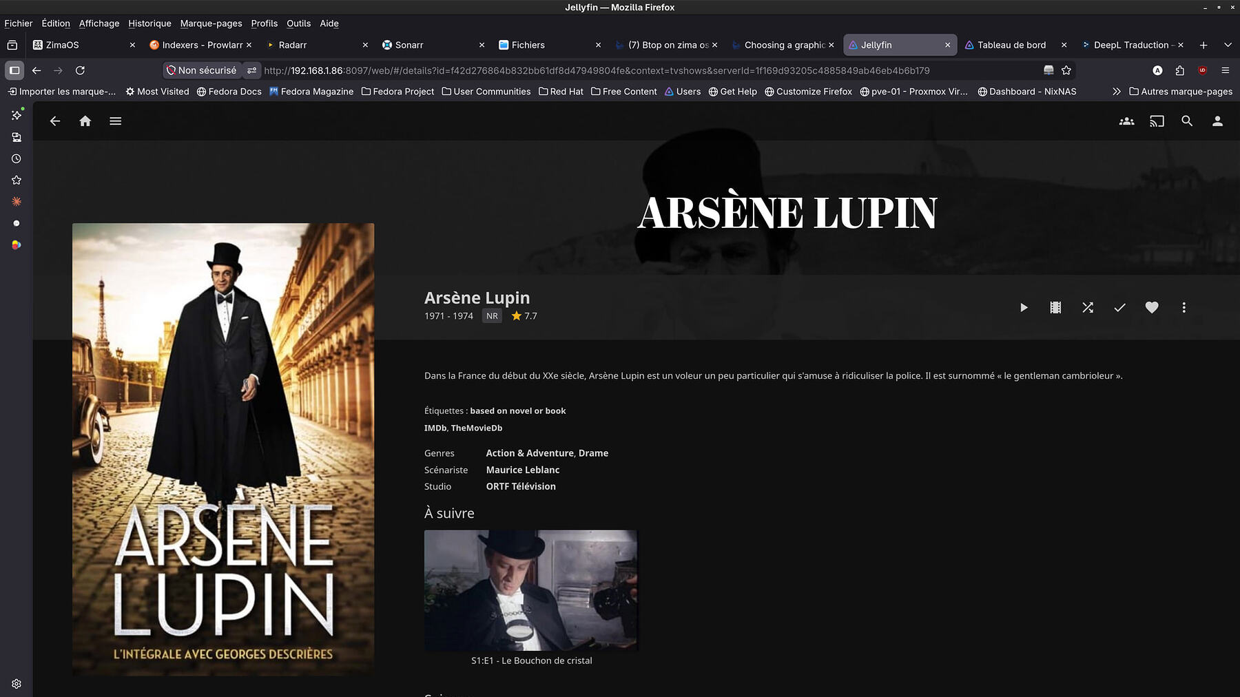

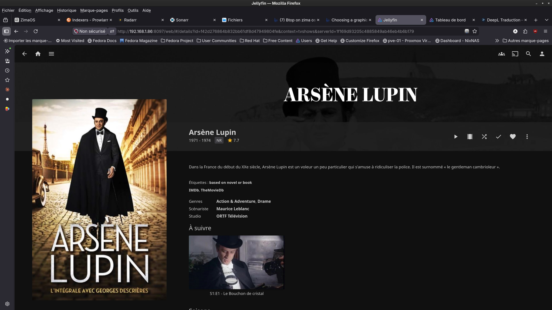

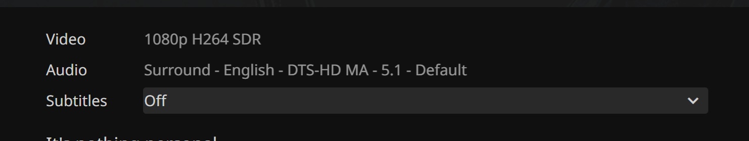

Tell me, do you have an extension in Jellyfin Stable (10.10.7) to display the specifications (MPEG-2/4, AAC/AC3/DTS, HDR/SDR, 720p/1080p, etc.) in the video listings?
do you mean like that? I’m not sure i understand. I cant remember if 10.10.7 does that. I updated to the latest version (10.11.8) after setting up my libraries etc a little while ago now.
A good start, but that’s not what I had in mind…
I was thinking more along the lines of small thumbnails here.
(for example)
yes , thats what i mean .
nearly .
I think i get what you mean I think the movies category displays the media info by default but shows category does not, there may be an option somewhere for it in library settings. I haven’t looked to be honest.
