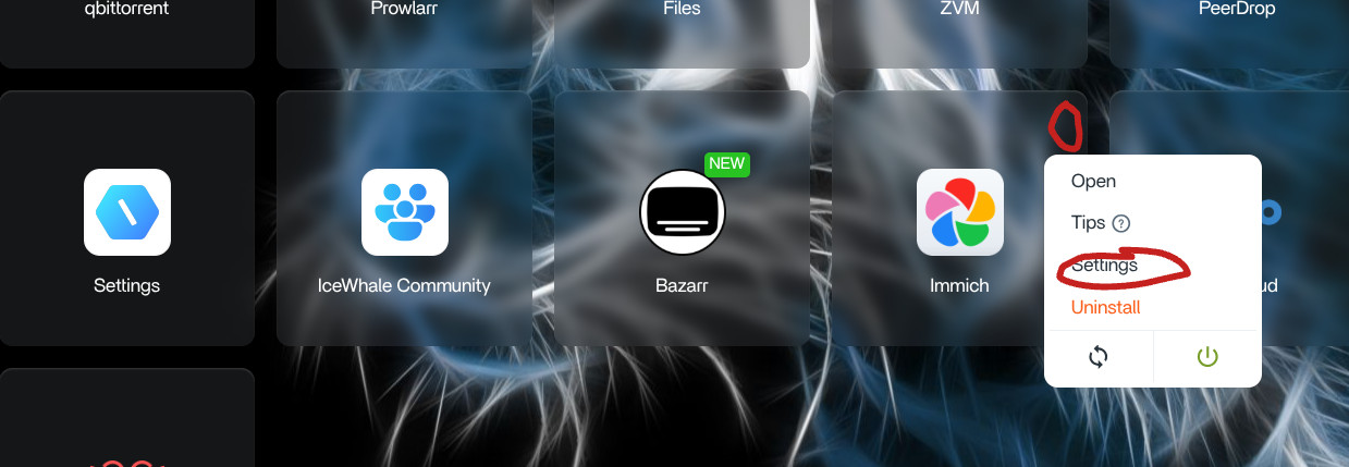

When installing Immich, make sure to select “Custom Install” or if it’s already installed, click the 3 dots, then “Settings”.

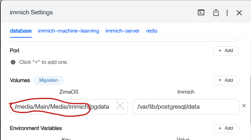

There’s 4 “tabs” along the top of the settings page. The first one is “database” and here you change the ZimaOS “volume” to where you wish Immich to be. In my case it’s /media/Main/Media/immich/ so change this to your destination but leave the ending as /pgdata but do not touch the volume on the right “Immich” side.

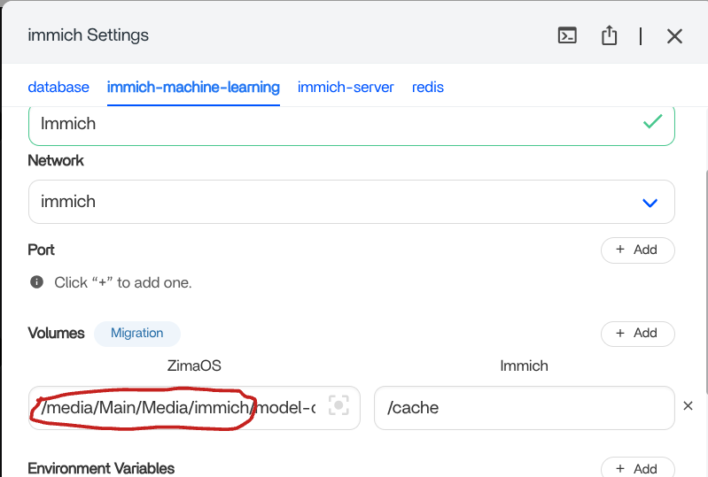

The next tab along the top is immich-machine-learning and here again change everything before /model-cache to your desired directory. Leave the volume entry for Immich alone again.

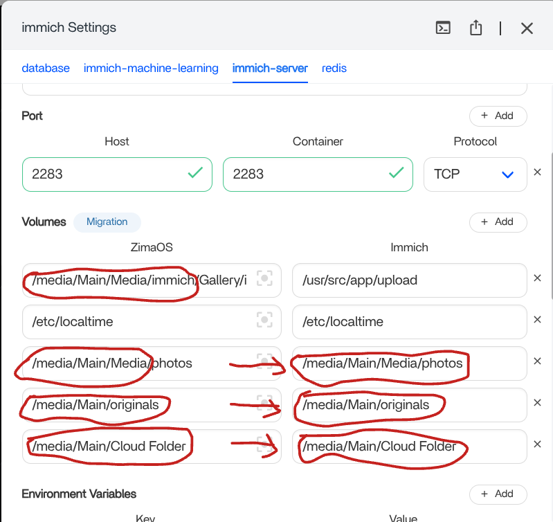

The third tab, immich-server is where I kept tripping up. You have to change SOME of the Immich volume entries to be the same as the ZimaOS volume entries. Follow the screenshot below and you can see the arrows where you need to make the changes.
