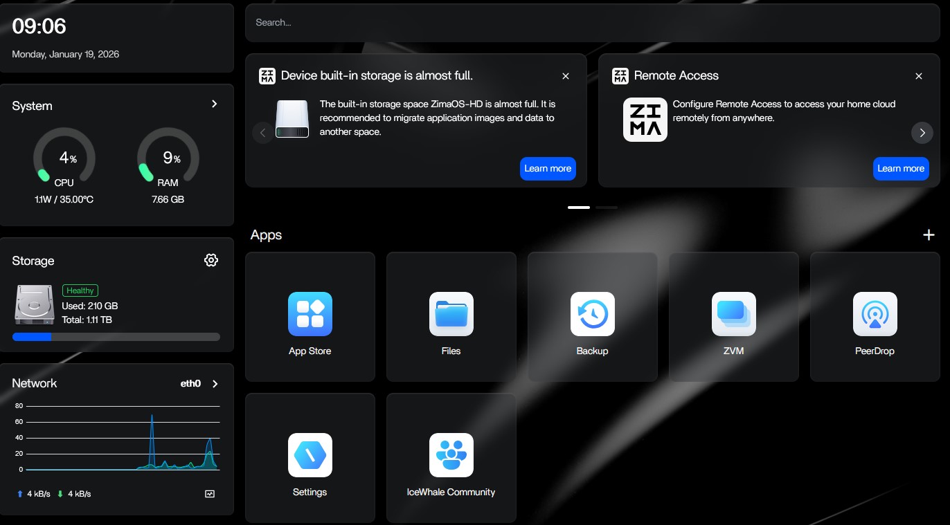

2 zimaOS boxes experiencing similar if not same issues with remote login
I can still access my files, just not get to the dashboard, and the files app is no longer working.

I’m back in the dashboard finally. SSH was turned off, I turned it on and this is what the results are:

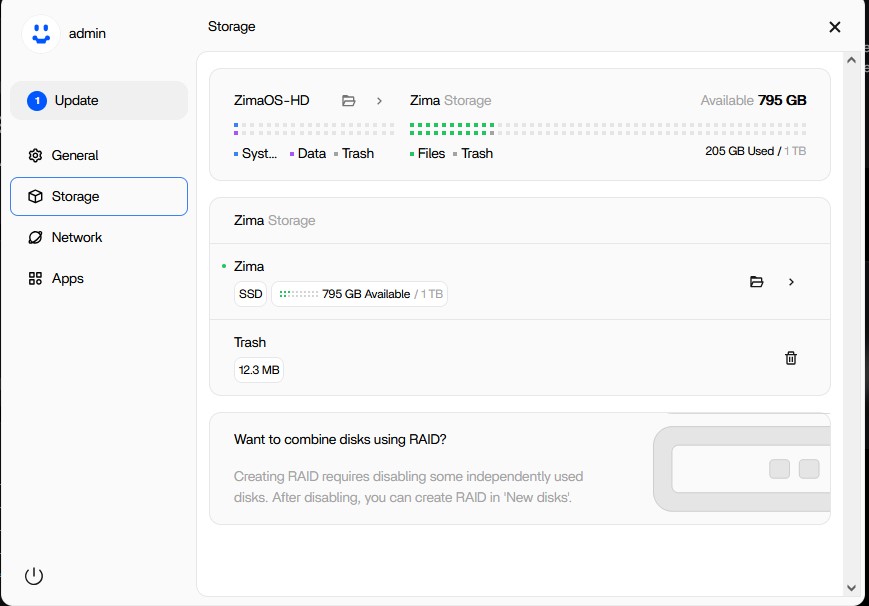

Is there a way to empty the trash using the command line? Or do I have to go into said folders as su and rm individually or recurringly? That sounds pretty dangerous to do as su

Thanks for running those commands, I believe this output clears things up.
1) What is actually using space?
I believe the space is not coming from Apps at all.
Your results show:
  • /media/Zima = 190G (real data: Applications, backups, personal folders, etc.)
  • .trash = only 150M (small, not the issue)
  • /media/ZimaOS-HD = basically empty
So I believe your β€œstorage problem” is mainly just the actual files stored on your Zima disk (Applications folder alone is ~57G).
2) Is the backup NAS mount being counted as disk usage?
I believe yes, /media/192.168.0.81 is a mounted share, so it appears in /media/* scans and some dashboards.
But important: I believe this does not mean it is filling your internal disk. It just means the mount exists and has data on it.
Emptying trash safely (CLI)
Yes β€” I believe it’s safe to empty the .trash folder from command line as long as you only target .trash.
I suggest doing this (safe + specific):
sudo rm -rf /media/Zima/.trash/*
sudo rm -rf /media/Zima/.trash/.[!.]* /media/Zima/.trash/..?*
Then confirm:
sudo du -sh /media/Zima/.trash
That removes only trash contents, not your real folders.

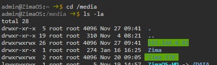

Interestingly, I lost SSH access again and for some reason the machine is going into a migration loop. Sometimes the dashboard works, sometimes I get the migration in progress screen. When the dashboard came back I still couldn’t log in to ssh in windows command prompt but I think that might just be my syntax. I was able to get a temrinal window open through the dashboard though.
mount | grep 192.168.0.81
prints out a red cursor but no actual results, if i type in ls -la is prints out the results of the current folder, wherever i am.

So there seems to be something with how the internal backup works and how it looks at memory on connected samba drives.
I’ve left my nas at 192.168.0.81 unplugged from the power and the zima box still sees it in /media/192.168.0.81 even though there is nothing on the network powered on at that address
So it looks like it is actually filling up some kind of internal storage for some reason because I still have
I believe what you’re seeing is normal, /media/192.168.0.81 is just a local mountpoint folder, not proof that the NAS is still connected.
That’s why:
  • mount | grep 192.168.0.81 returns nothing = not mounted
  • but /media/192.168.0.81 still exists = local folder remains
So if your NAS is powered off, it’s not actually mounted, ZimaOS just doesn’t remove the mountpoint.
If you want to remove it completely (only if it is not a real mounted share):
If nothing prints (not mounted), then you can safely remove the mountpoint folder:
sudo rmdir /media/192.168.0.81
If it won’t delete because it’s β€œnot empty”, then:
sudo rm -rf /media/192.168.0.81

For unmount: yes, you often won’t see output if it succeeds. You can confirm with:
If nothing prints, it’s unmounted.
I’ve removed 192.168.0.81 and did a hard reboot and i’m in. For some reason it’s still giving the main drive out of diskspace error at the top
but in storage everything is fine
So my last question for my zima box then is how do I back up without it taking up space on the main drive? Do I have to use another app rather than the internal backup function or is there a flag I can set for it to not take up β€œinternal storage” like this?

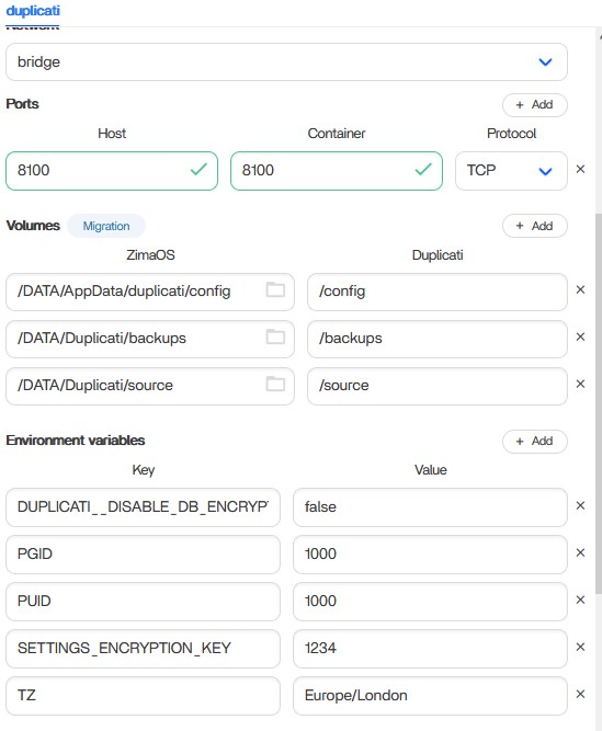

My lack of understanding for docker is going to show here but I’ve installed duplicati and tried running it but it’s not opening.
It’s β€œrunning” but when I try to open the app it sits and eventually goes to an error page
I checked the logs and it says no encryption key found. Ideally I’d like to disable the encryption key and followed the instructions
DUPLICATI__DISABLE_DB_ENCRYPTION=true: This setting disables encrypting data in the database, which should be stored on the host system.
found here: duplicati/duplicati - Docker Image
by adding it to the settings - didn’t work. So I tried adding an encryption key using this
Set DUPLICATI__DISABLE_DB_ENCRYPTION=false and SETTINGS_ENCRYPTION_KEY=<key>: This will enable database encryption using the supplied key and reduce the risk of leaking credentials from the database. Note that the SETTINGS_ENCRYPTION_KEY is not the password used to connect to the UI.
from the same page. I used 1234 as the encryption key which I used as a placeholder just to test. Still didn’t work
Note that I had to change the port because I was trying to do this in terminal as well and I think I inadvertently setup a docker of duplicati on 8200 while testing which also doesn’t work.

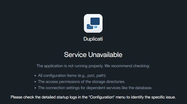

So it got installed, but trying to go to the page doesn’t do anything and it times out. This is somewhat confusing to me. I have some basic understanding on unix and linux but more familiar with mac and windows.
Should the web interface update with app icons when you manually install a docker through the terminal? If not, how do I get rid of that duplicati that I installed in the terminal?
Hi mate, no stress at all, I believe you’ve run into two separate issues at once, which is why it feels confusing.
1) I believe you now have TWO Duplicati installs
  • One from the ZimaOS App Store
  • One you created manually in terminal with docker run
ZimaOS will not automatically show icons for containers you start manually via terminal. Those are β€œoutside” the App Store UI.
So I suggest we clean this up and keep only one Duplicati.
2) I believe your manual docker command is mapped wrong
You used:
-p 8200:8200
But Duplicati container listens on 8200 inside the container only if configured. Most default images expose 8200, but you must confirm.
Also: your ZimaOS App version shows port 8100, so now ports may conflict.
What I suggest (safe cleanup plan)
Step A: list all duplicati containers
sudo docker ps -a | grep -i duplicati
Step B: remove the manual one (safe)
Pick the container name/ID from above and remove it:
sudo docker rm -f <container_name_or_id>
This does not delete your backup data unless you mapped it somewhere else. It only removes the container.
Step C: remove any leftover port conflicts
sudo ss -tulpn | grep -E "8100|8200"
If you want Duplicati working FAST (best option)
I believe the simplest path is: use only the App Store Duplicati and remove the manual one.
Then fix only the encryption key setting.
In the ZimaOS Duplicati App settings, I suggest:
  • DUPLICATI__DISABLE_DB_ENCRYPTION=true
  • remove SETTINGS_ENCRYPTION_KEY entirely (don’t set it)
Then restart the app.
3) Why the web page times out
I believe the timeout happens because the container is either:
  • not running properly (crashing due to config/db issue)
  • or bound to a different port than you’re opening
  • or conflicting with the other duplicati container
So the key thing is: don’t troubleshoot encryption until we confirm only one container exists and the port is free.

I followed your steps but still getting service unavailable unfortunately, here’s the print out
