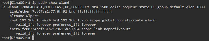

My ZimaOS is successfully connected to my Wi-Fi network and has correctly obtained the static IP address I set: 192.168.1.50. I’ve confirmed this via SSH using nmcli device and ip addr show wlan0 commands. The nmcli device output clearly shows wlan0 as connected.
However, on the physical ZimaOS server screen, I still see the warning “Searching for network address”.
When accessing the web interface (via http://192.168.1.50 in my browser), the situation is even stranger:

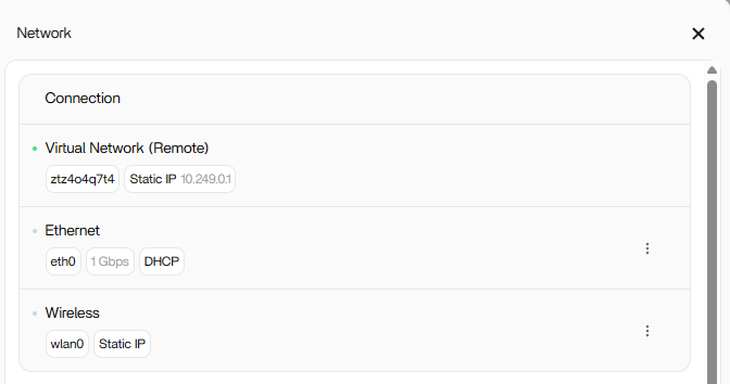

  • On the “Settings > Network” page, the Wi-Fi (wlan0) section is not showing as green/active as it should be.
  • Furthermore, when I try to change the IP address settings in the web UI, even after switching from DHCP to manual and entering 192.168.1.50, these changes don’t seem to be correctly reflected or saved in the interface.
  • Currently, only “Virtual Network (Remote)” (ztz4o4q7t4) is actively listed on the “Network” page; the status of my Wi-Fi connection is still not being accurately displayed in the web UI.

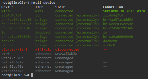

  5. Service Restarts (via SSH):
  • sudo systemctl restart NetworkManager
  • sudo systemctl restart zimaos-gateway.service
  • sudo systemctl restart zimaos.service After running these commands, I cleared my browser cache and refreshed the interface, but the situation remained unchanged.
  1. System Update Attempt: Since the apt command was not found, I used apk update and apk upgrade commands. The update was successful, and I rebooted the system, but the incorrect display in the interface persists.
