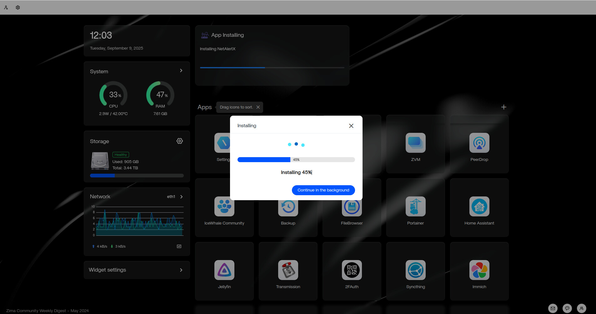

I have upgraded from ZimaOS v1.4.4 beta to ZimaOS v1.4.4. However after upgrade it takes really long time for app installation. It stays “Installing…” for nearly 30min for each app. I have 100Mbps fiber line, so no issue with internet connectivity. so far following apps faced the issue.
  1. Navidrome
    2.. Jdownloader2

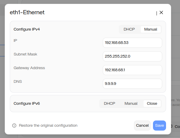

  • Did you change your network or notice any changes before or after installing the current version? On 1.4.4 beta I set Quad9 DNS since Adguard Home blocks network traffic to server. It worked fine with beta version.
  • Have you made it work successfully at the end? App installation is very slow. But after 20-30 min it will install successfully
    this is the current netowrk setup

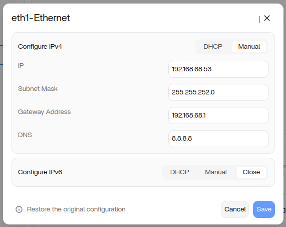

Thanks for the detailed feedback. I think DNS is a big issue here. Try disabling any DNS-related apps and using DNS servers like 1.1.1.1 or 8.8.8.8. Looking forward to your feedback.
Hi,
Thanks for the clarification.
I also had my doubts about the situation you clarified.
So, I switched to google dns (8.8.8.8) and disabled all apps related to DNS.

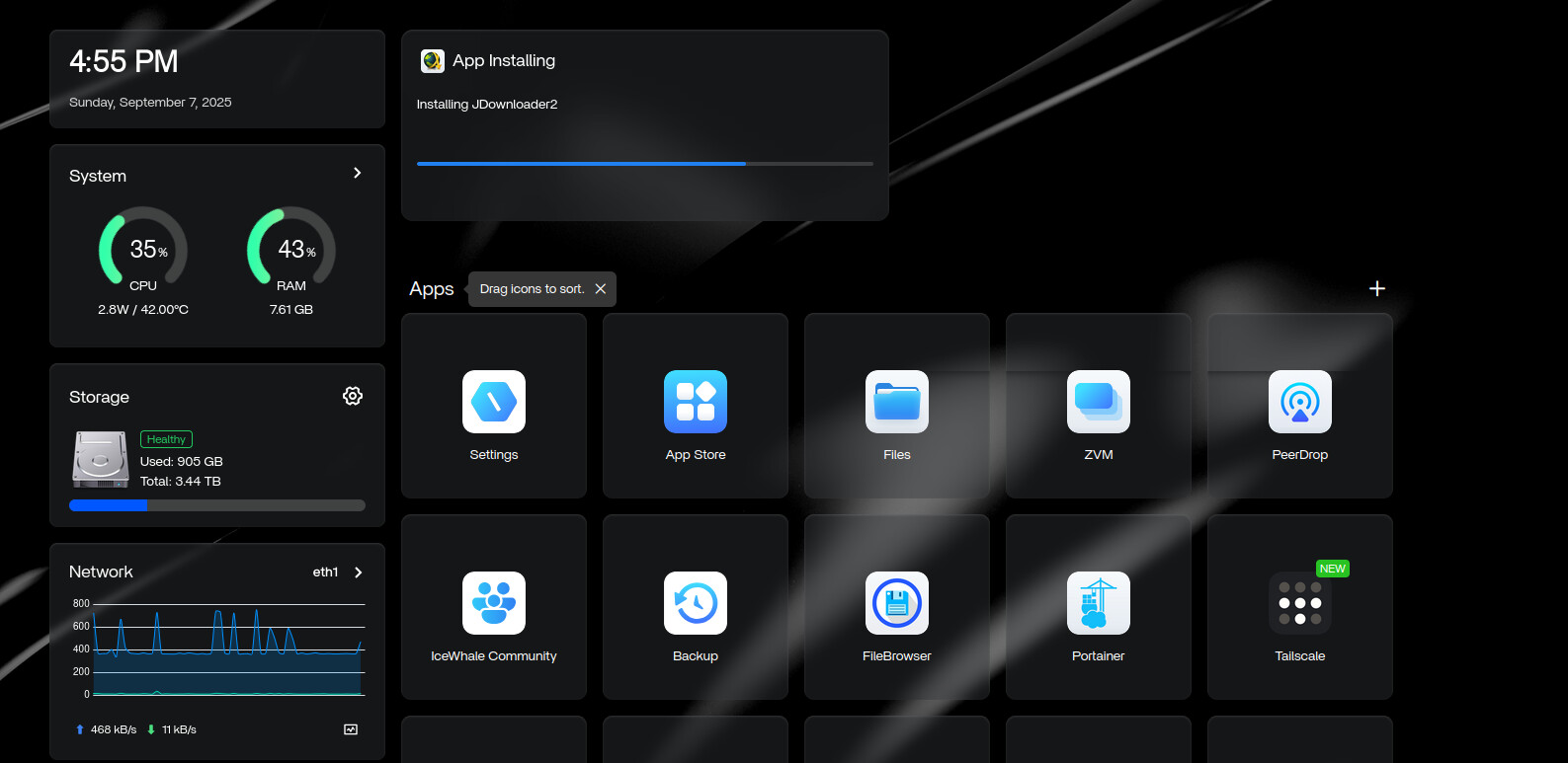

But still app installation takes really long time.
As you can see installation going on with KB/s speed even with 100Mbps fiber connection.

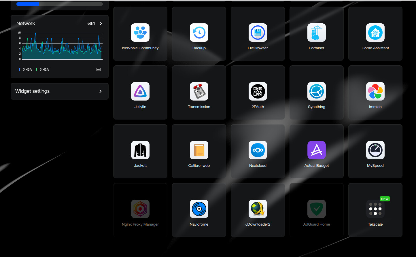

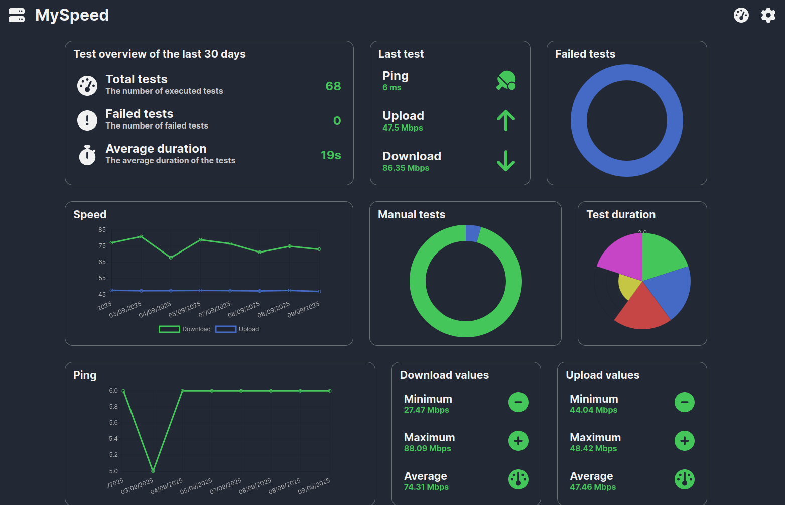

Here are some additional info. I was running myspeed in the same server with all DNS related apps and configurations enabled (Quad9 DNS, Adguard Home, Nginx). Following is the speed check history.

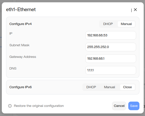

I changed dns to 1.1.1.1 then restarted the server after updating to v 1.4.4.4-1. Now apps are installing without an issue. I think problem is fixed.
