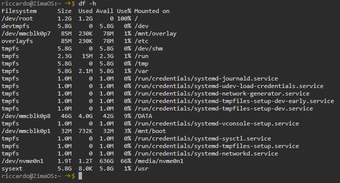

Disk Space: The command df -h / shows: /dev/root 1.2G 1.2G 0 100% /

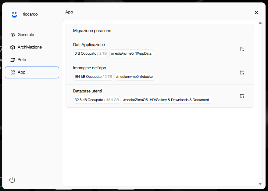

First of all, thank you for answering. I followed your guide exactly: I performed a fresh install of the OS on the eMMC (64GB) of my Beelink Mini. Before installing any apps, I migrated both AppData and Docker Images to my 2TB SSD.

Immediately migrated both AppData and Docker Images to my secondary 2TB NVMe drive.

Since I explicitly moved the storage to the NVMe, the eMMC should barely be touched. It feels like either ZimaOS “forgot” the migration path after a reboot, or something is writing massive logs/data to the system partition bypassing the configuration.

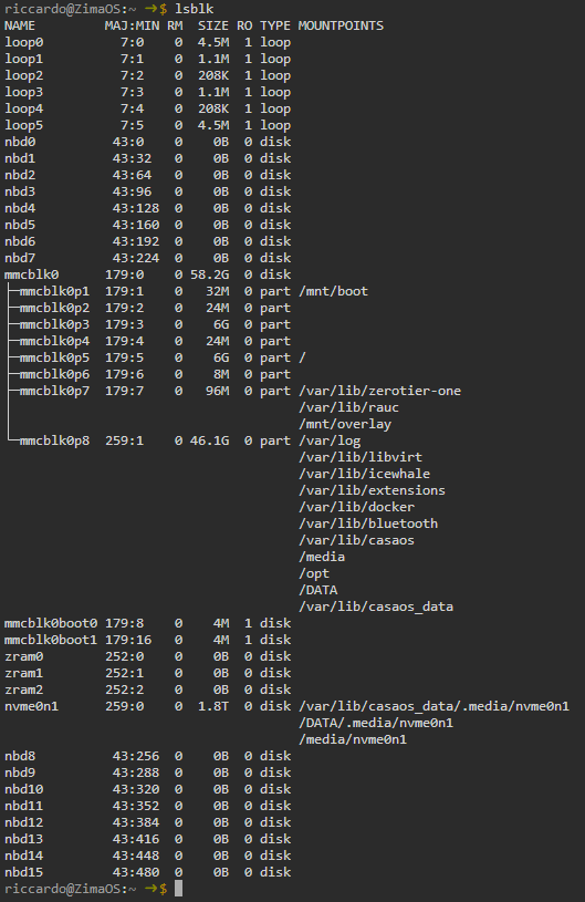

Your question looks like partition 8 (the actual user data partition) is not scaled up and does not require a system reset, can you provide the return result of these commands?
I’ll try to explain everything again so you (and others facing similar issues) can understand my problem better.
Hardware Setup: I bought a Beelink Mini Me with an Intel N150, 12GB of RAM, 64GB eMMC, and a 2TB NVMe SSD.
The History: I originally installed ZimaOS (version 1.4.x, I believe) on the eMMC. It worked smoothly for about 5 months with apps and data stored on the eMMC (I still had about 25-30GB free, so space wasn’t an issue back then).
The Problem: About a week ago, I tried to open my Overseerr container to request a movie for my Plex server. The application wouldn’t work properly; posters and metadata failed to load. I tried restarting the container, but it didn’t help. After some troubleshooting with AI assistance, we discovered a persistent TLS/SSL handshake error. The NAS cannot perform HTTPS requests (though HTTP works fine). This explains why Overseerr fails (it can’t fetch metadata via HTTPS) and why I cannot install new applications from the App Store (connection to Docker Hub fails due to TLS errors).
Attempted Fixes:
First Reinstall: I followed the instructions provided by @gelbuilding using my original installation USB. I left the Ethernet cable plugged in during installation, but the problem returned immediately, which was weird.
Second Reinstall (Quarantine Method): I used the latest ISO and kept the Ethernet cable unplugged for as long as possible during the setup (I only plugged it in when necessary to access the UI). This seemed to work initially! I migrated AppData to the 2TB NVMe immediately.
Current Situation: Despite the “clean” install and migrating data to the NVMe, the problem returned after just a couple of days. I am now back to square one with the TLS errors. In both reinstall attempts, I installed the OS on the eMMC and did not wipe the 2TB SSD (just remounted it).
I am still fighting this issue that keeps reappearing in a very short period of time, which is extremely weird. I will certainly open a ticket with the support desk because I’m stuck.
