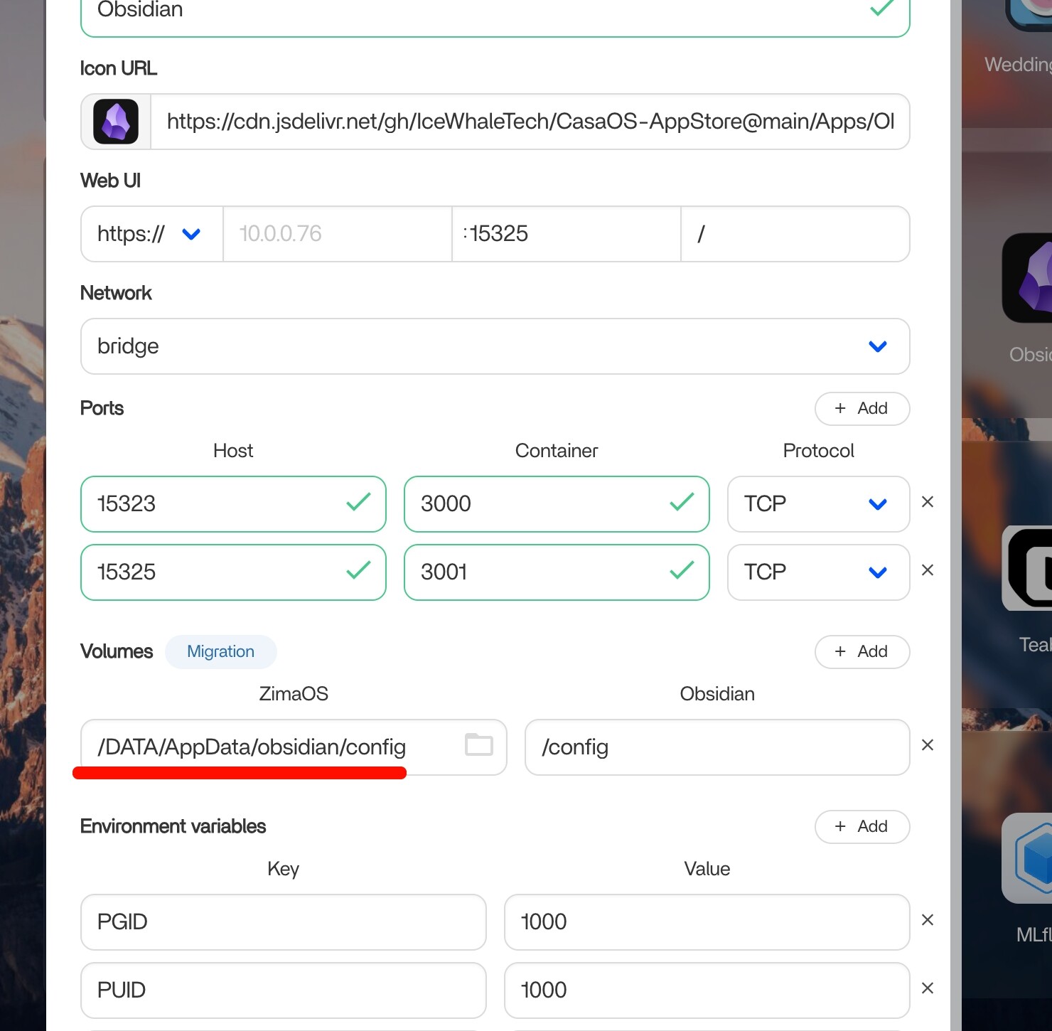

After uninstalling an application, some data may remain because the mapped storage path is not automatically deleted.
You can manually remove the remaining data by deleting the corresponding mapped directory on your storage.
Once the mapped path is cleaned, reinstalling the application should start with a fresh configuration.
Like this,
