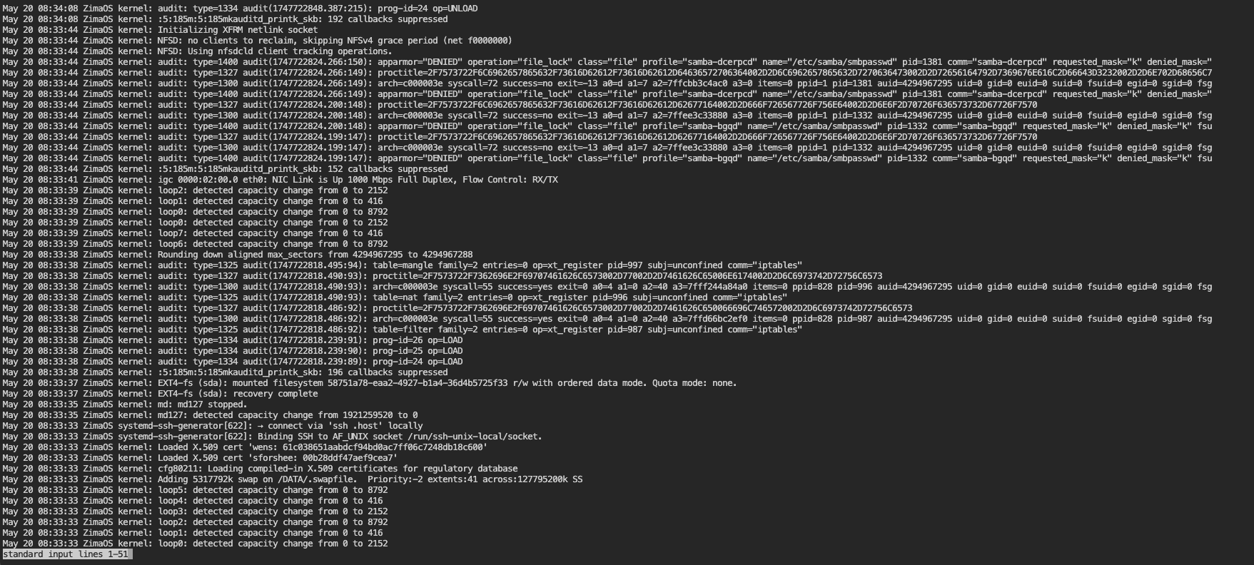

  1. For the problem of restarting, we need to capture more information. You can go to the SSH console and use ‘journalctl -k -r -b -1’ to get the kernel logs before the reboot and send them to us.

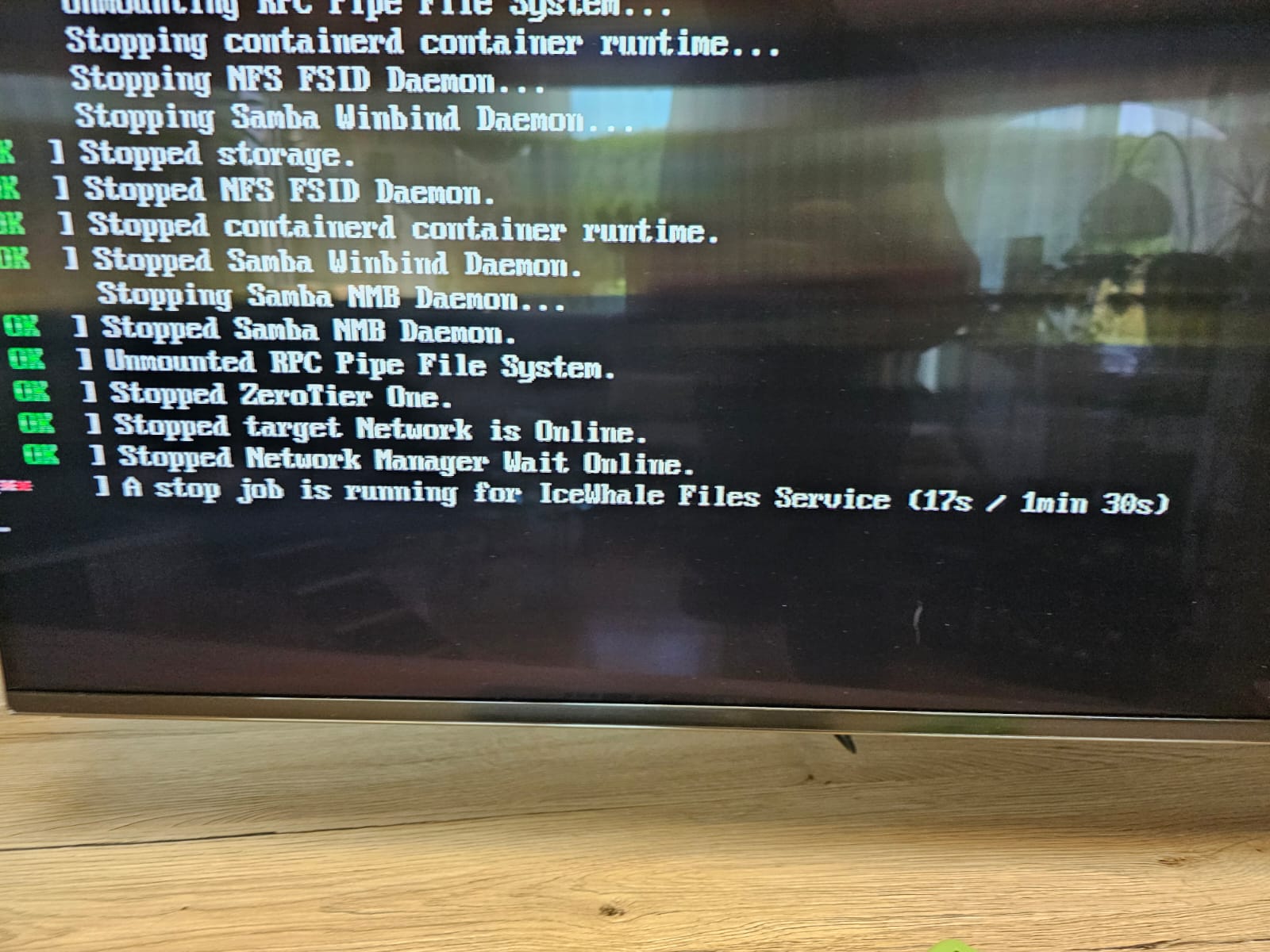

So I connected the NAS to the TV, and after booting, the following message appears below the welcome message for about half a second: Device “bonding-masters” does not exist.
The desired log file is attached in the picture.

I don’t see an issue with bonding-masters in the kernel logs, but this issue has recently appeared in other people’s feedback as well. I will continue to monitor this issue.

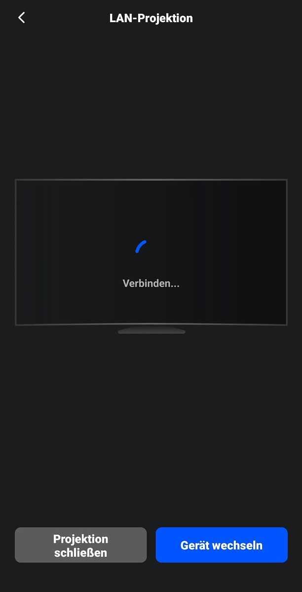

I made a video for you so you can see it with the “Bonding Master”

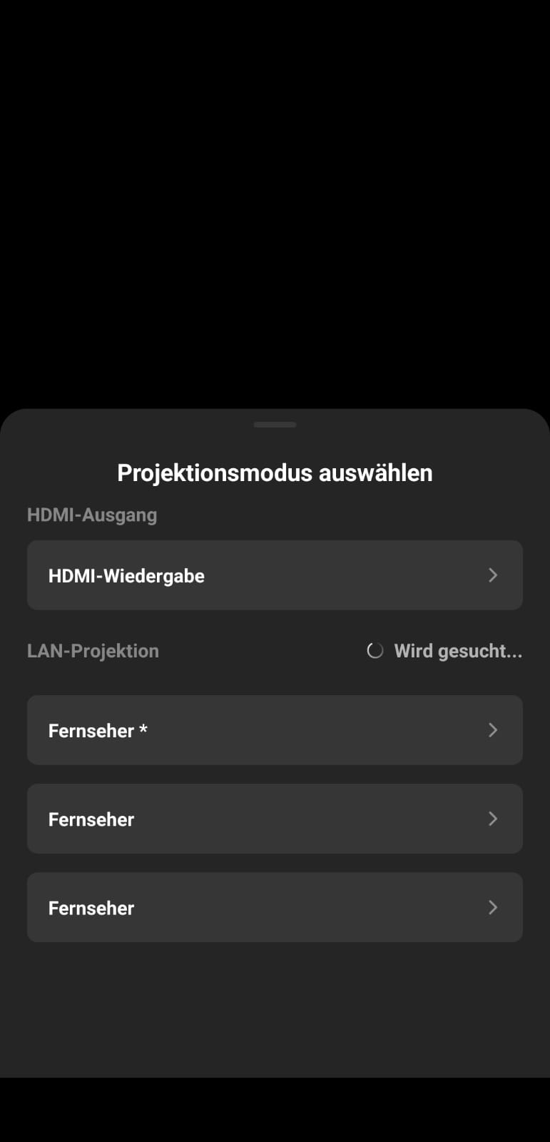

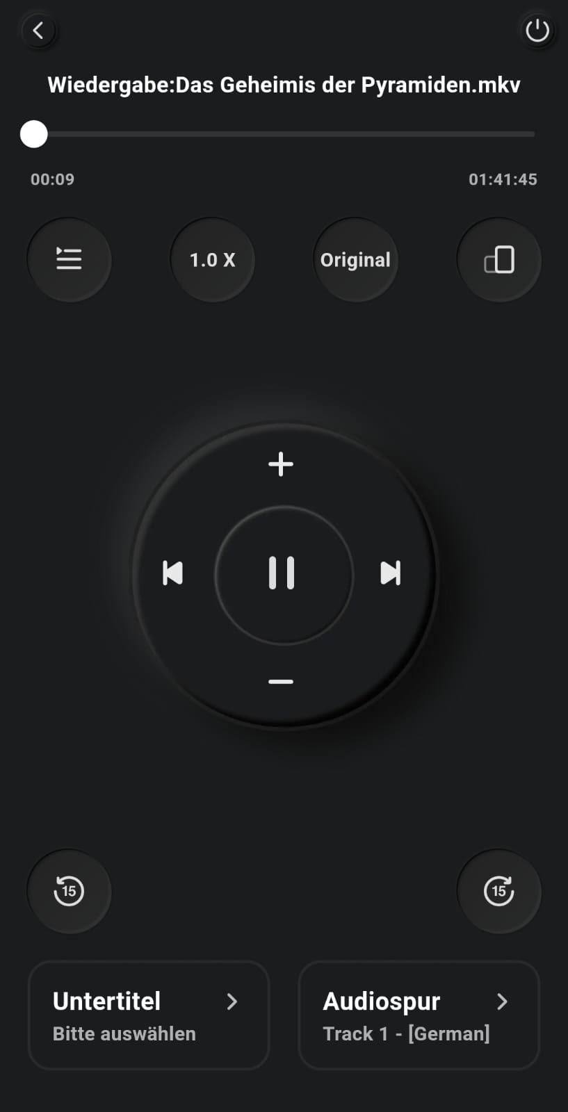

HDMI is already implemented by default on Ugos, so you don’t need to do anything extra.
If you have a movie, series, or other video file, all you need to do is click on the file on the NAS interface on your phone and press HDMI Play. The phone then acts as the remote control.
I’ve also noticed that shutting down the NAS doesn’t always work; you have to repeat it two or more times under Zimaos.
I saw the video and I suspected that some kernel drivers might be the cause, so I removed them in the next release of the official system.
At the same time, the restart or shutdown problem you mentioned has been fixed, and you just need to wait for the new version to be released. It will be released soon.
