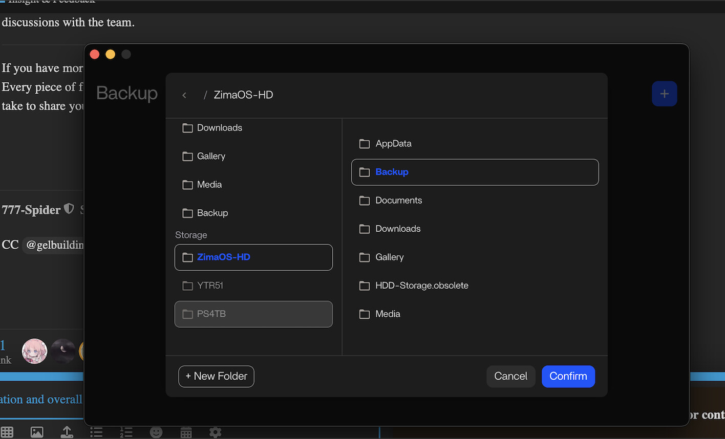

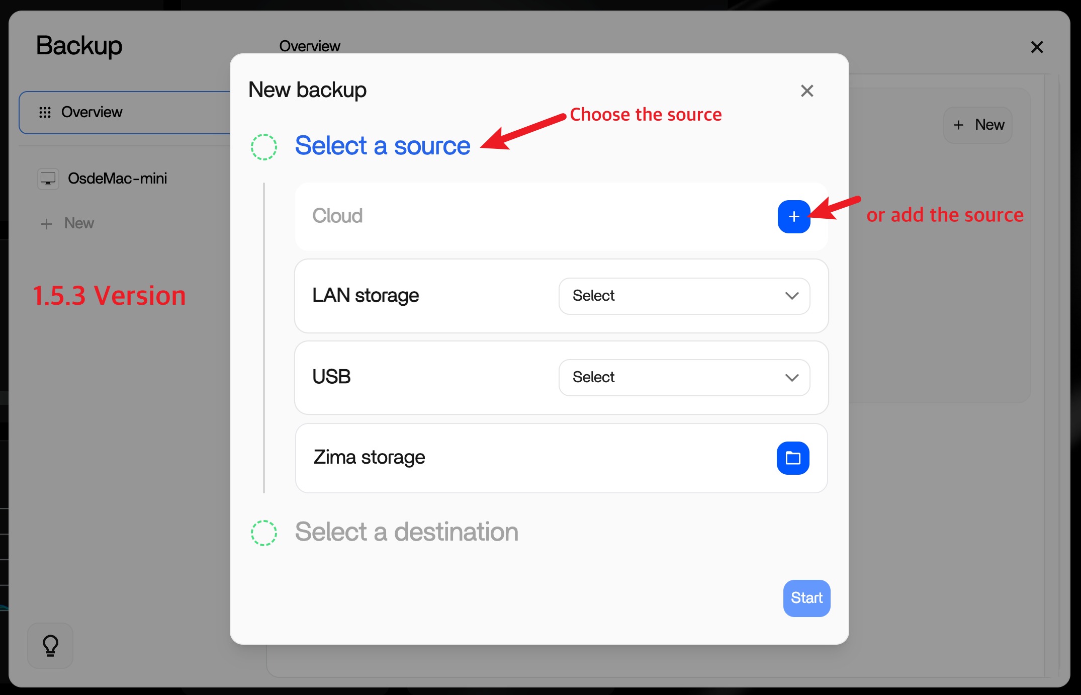

At the moment I am on 1.5.3, when using the Desktop app for backup, choosing a local target is no problem. When choosing destination of the backup the connected drives are greyed out and not available to choose:
When going about the same flow from the browser client it is not possible to choose a local folder (by local I mean on a device other than ZimaOS, in this case a laptop).
When choosing a target destination the behavior is the same as with the desktop client, drives connected to my Zimablade through Usb are not possible to choose/greyed out.

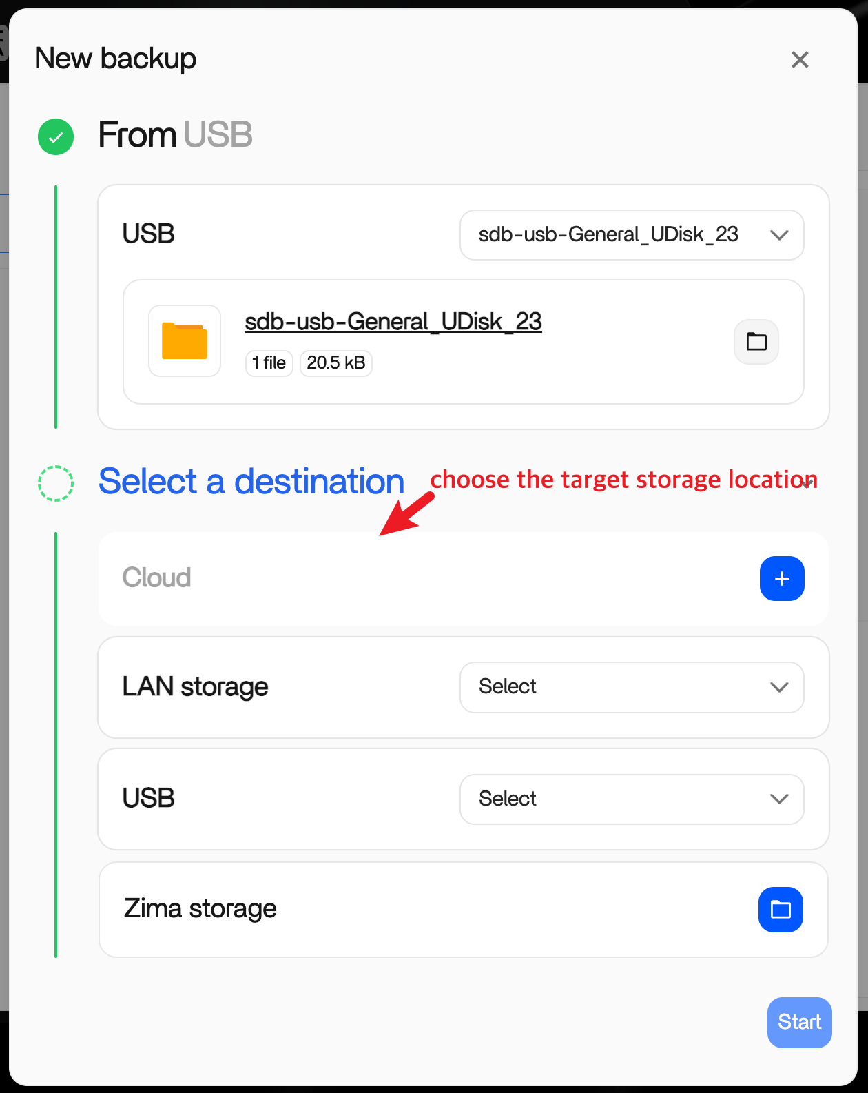

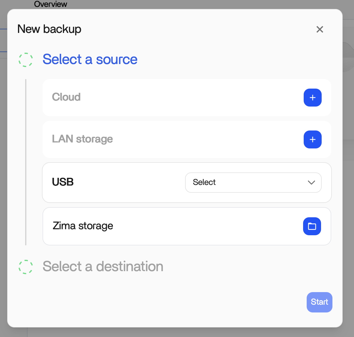

Thanks for the detailed follow-up — this is a very good question, and I realize we haven’t explained this architecture clearly enough before. Let me clarify how backup is currently designed in ZimaOS.
The key point is that Web, Client, and Mobile have different responsibilities in the backup system.
Web (Dashboard / Browser)
The backup module on the Web is primarily a management and visibility layer, not a data-source client.
Its main purpose is to:
  • Provide a unified view of backup status across devices (PC, mobile, Zima itself)
  • Show progress, history, and error states
  • Give users confidence that their data is protected
For security and technical reasons, the Web cannot directly access local files on your computer or phone, so it does not create backup tasks from local devices.
Zima Client (PC / Mac)
The desktop client is responsible for initiating backups from your PC, because it can safely access local file systems and create backup tasks.
Mobile App
Similarly, the mobile app is responsible for backing up phone photo libraries.
In other words:
  • PC files → Zima Client
  • Mobile photos → Mobile App
  • Web → Manage storage targets and monitor all backup tasks

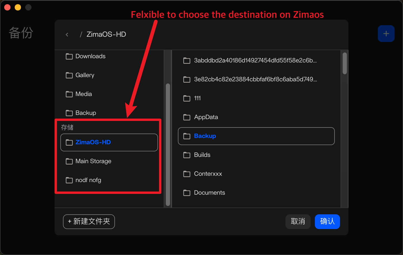

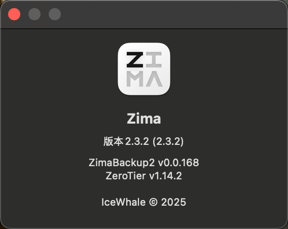

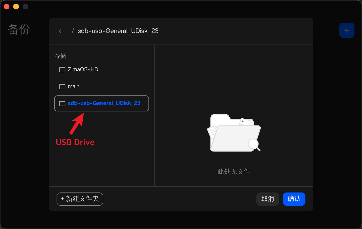

On Dec 15, we released ZimaClient 2.3.2, which already supports using USB drives as backup destinations.
ZimaClient updates automatically, but if the version hasn’t refreshed yet, please try quitting and reopening the app.
Your feedback and the MURAL board are extremely valuable, especially around making these roles and capabilities clearer in the UI. We’ll continue improving both functionality and communication here.
Thanks again for the thoughtful input — it genuinely helps us improve ZimaOS.
Hey and thanks for clarifying, makes perfect sense to me.
I was on 2.3.1 and just updated to 2.3.2 and I just want to say THANK YOU! Love it!

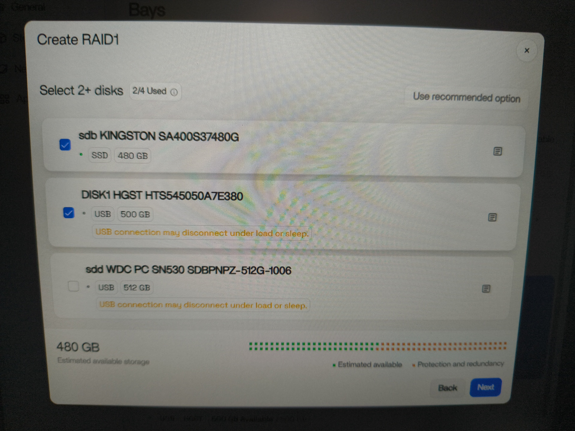

From which version are usb disks supported? I am on 1.7.1 and have no option to place usb disks in RAID.
You can configure USB storage for RAID starting in ZimaOS 1.6.
please send a screnn shot on storage setting, thanks!

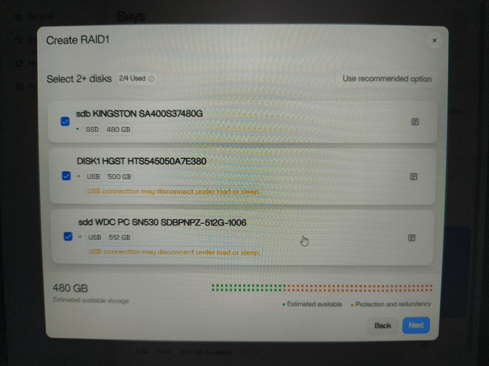

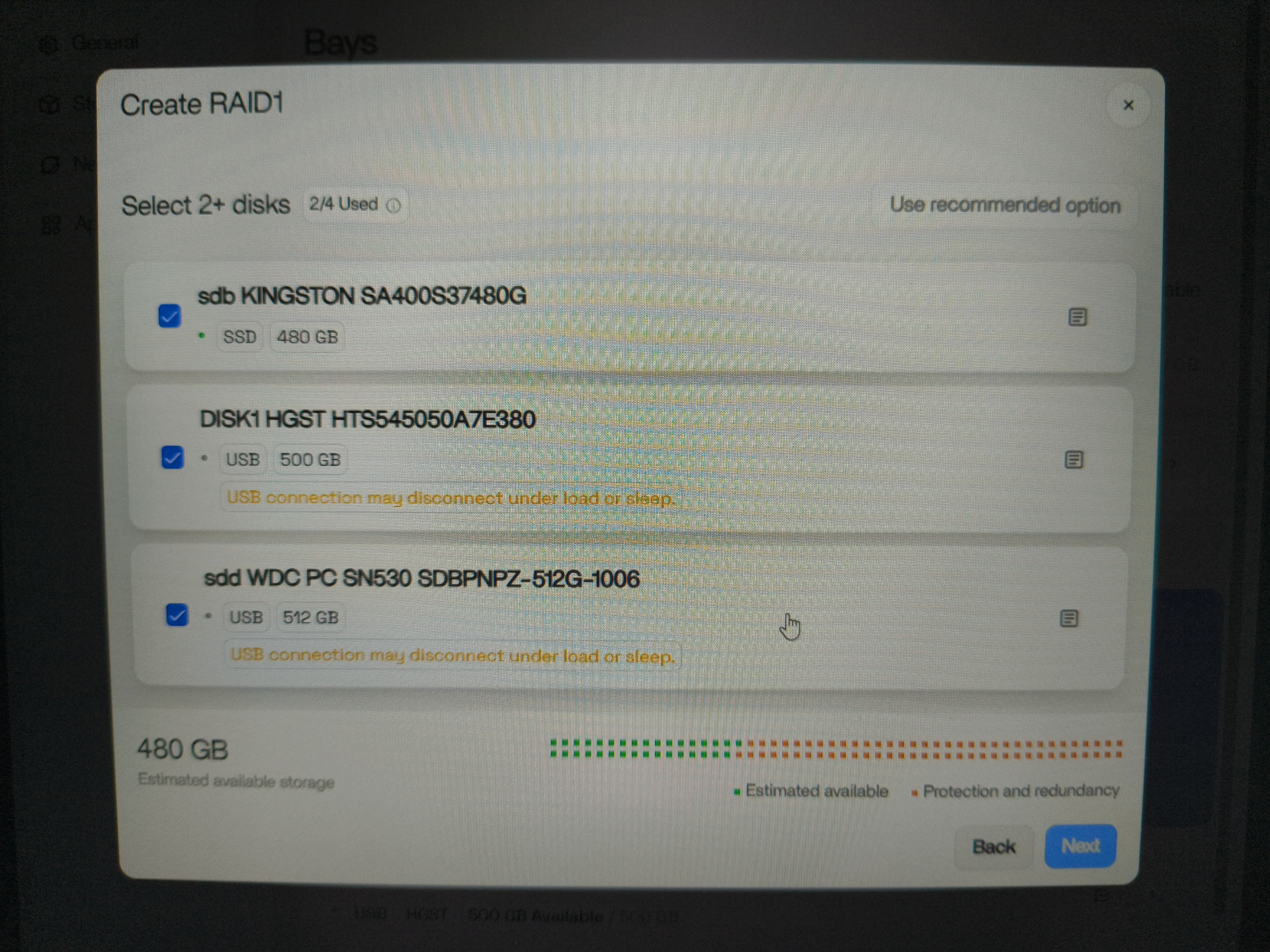

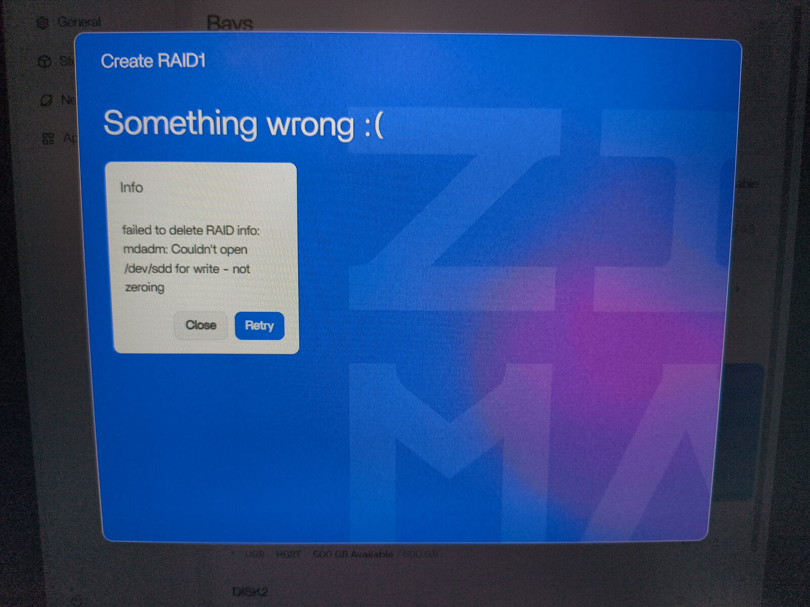

Ok. Problem is when you want to RAID1 more than 2 disks. If I select more than 2 disks the Next button goes grey.
RAID5 doenns’t work as a result, because you need at least 3 disks.

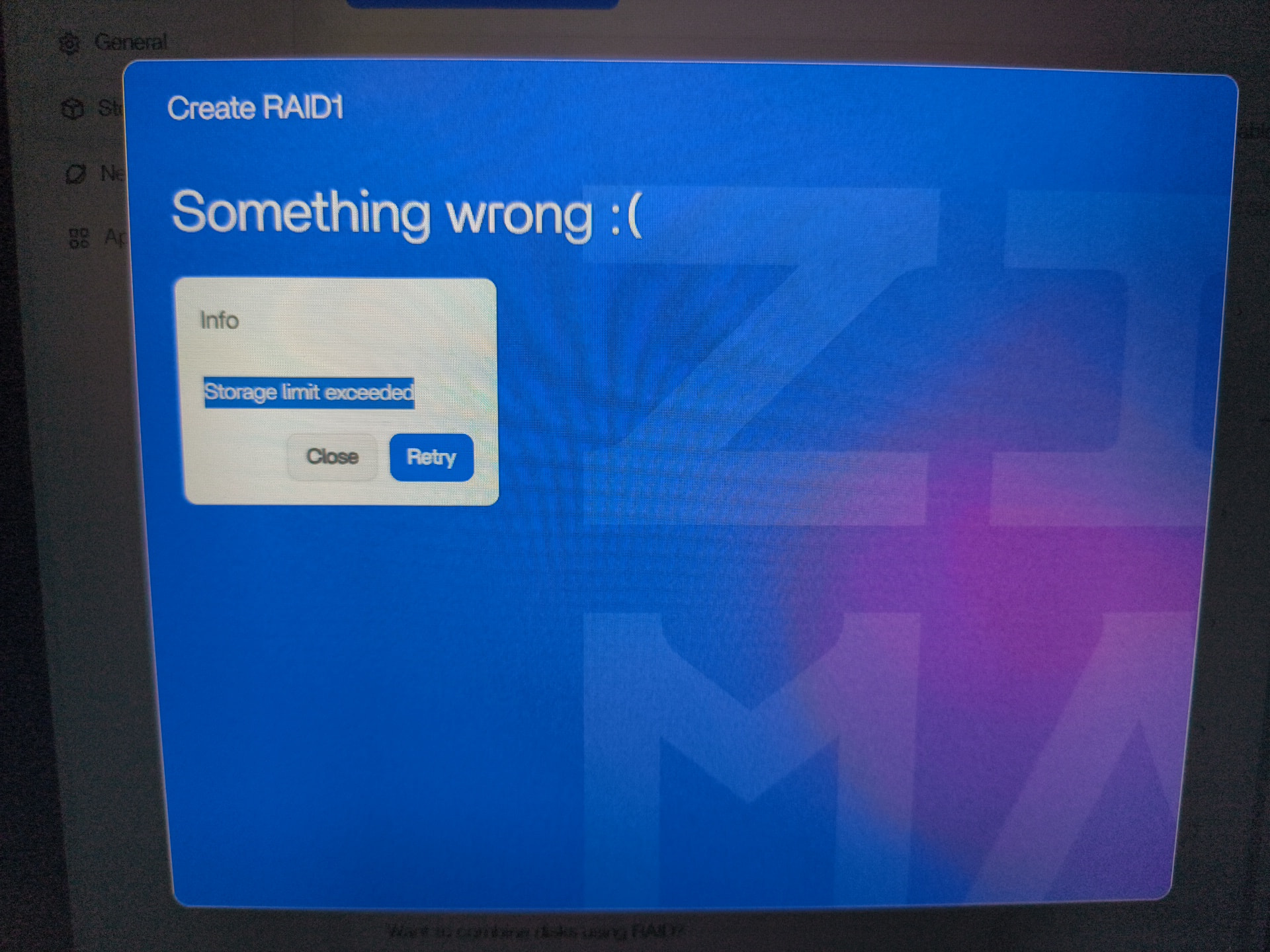

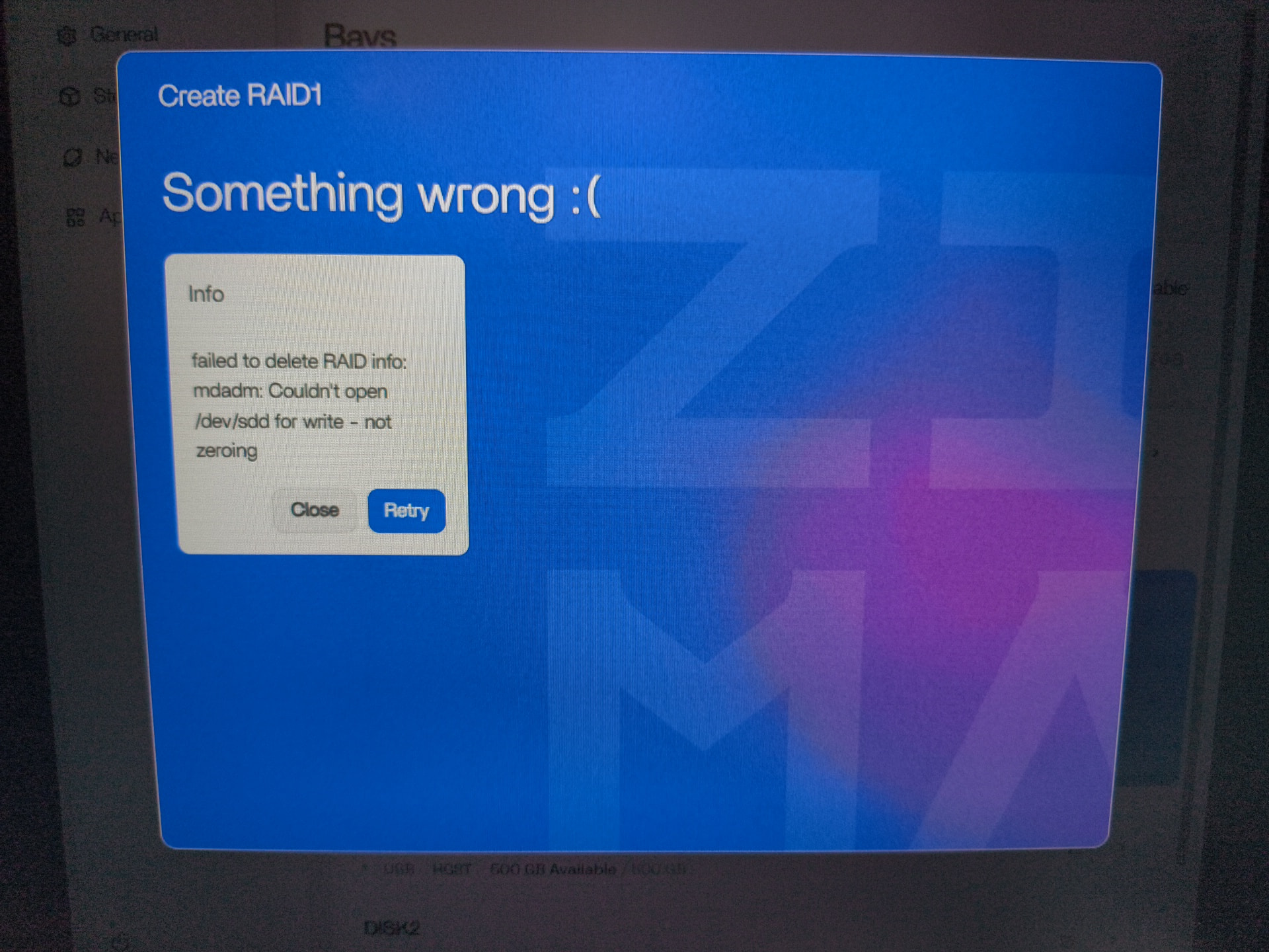

And then…
Also this
