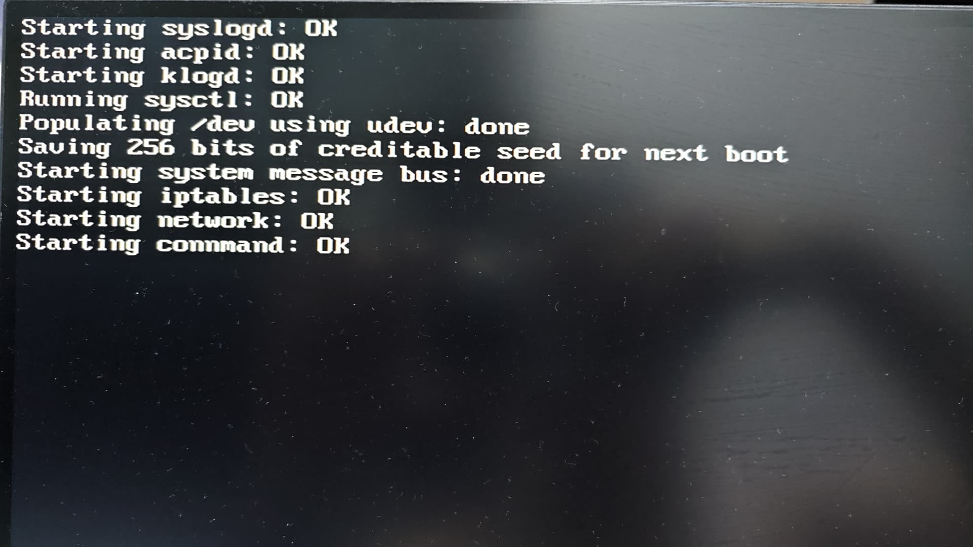

ZimaOS installer not booting on Maiyunda M1S N100CPU
I try to use Zima 1.41 img usb to install OS to the device (Maiyunda M1S N100 all Nvme drive). I had enable UEFI boot for USB drive and enable the AHCI and Disable Secure Boot. But keep waiting installer running just like freeze screen. Can not go to next step to install system.
It’s Zima OS do not support my device?
How can i install the os?

It looks like there are no issues with your hardware configuration.
Can you provide a screenshot or video of the startup time?
keep this page freezeing
just show saving 256 bits of creditable seed for next boot.

Thanks for your reply. I have been used github image and zima releases and changed 3 usb drives to flash v1.3/1.4 and boot same issue.
When i using the zimo os.xz (zimaos_zimacube-1.4.1.img.xz) to run the system is fine but very slow. thanks again.
I find the problem can not using frontside usb hub. When I using the backside the problem is gone. Thanks All.
That’s great news getting it sorted. It’s frustrating when it’s as simple as using a different usb port!
yes that’s great. But when i using the zimo os.xz (zimaos_zimacube-1.4.1.img.xz) to run the system in front port is fine. So i don’t know why. :melting_face:
Because Installer and ZimaOS are two operating systems, the purpose of the installer is to flash zimaos into your hard drive.
It may be caused by the lack of some drivers in the installer system, and we will update the driver support of the installer system as soon as possible.
Thank you for your feedback.
