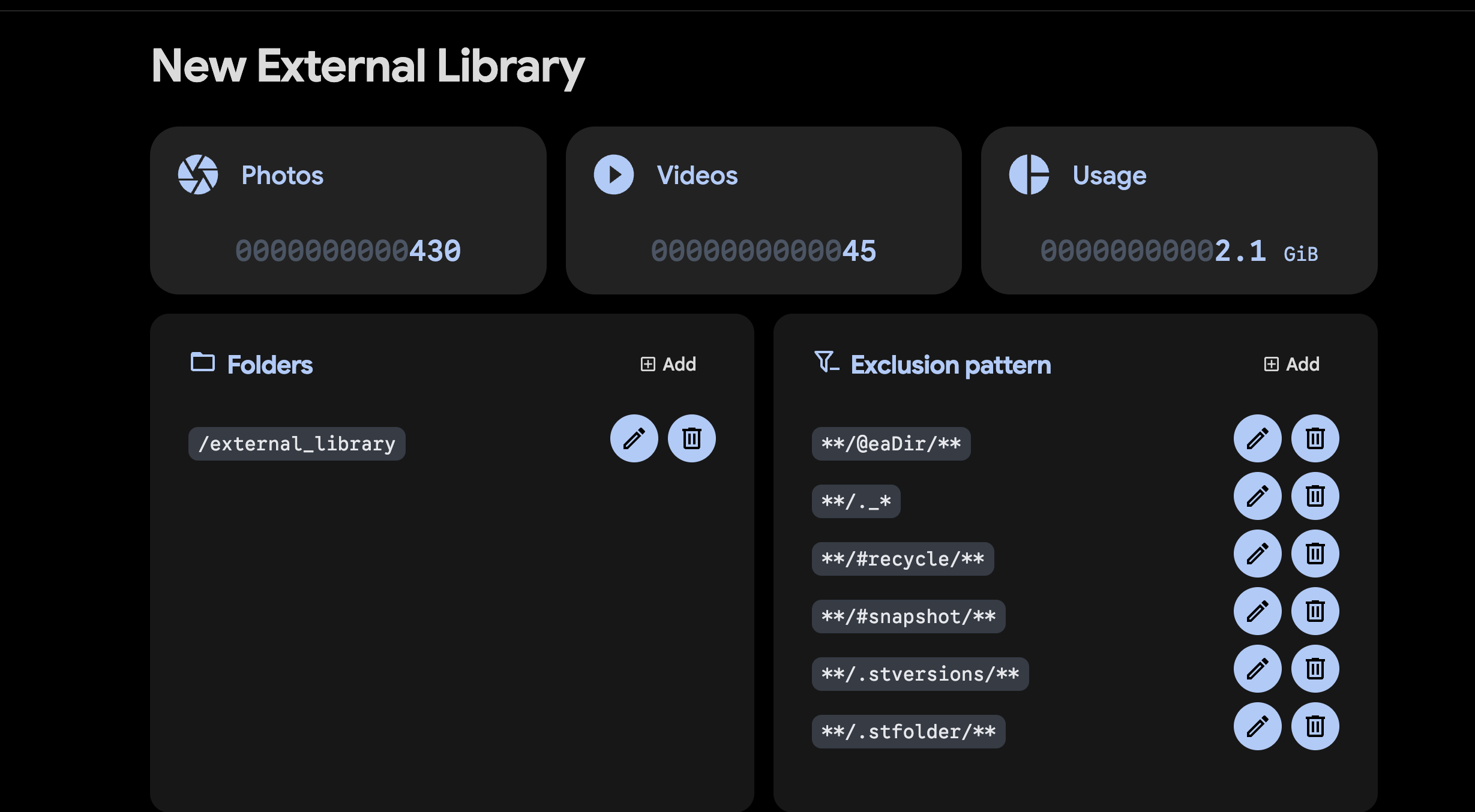

Dude, thanks a lot for solving my problem! You’re great, thanks for giving your time, I really appreciate it. One more thing, will this issue happen again? Sometimes when I save repeatedly, it takes time to load, so I click save multiple times. Could this be causing the problem?
