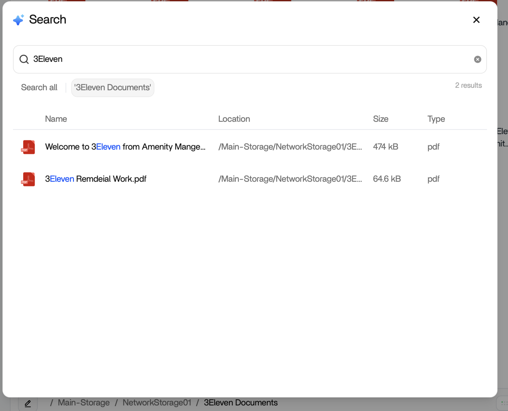

Note I get no AI results in my search of files.
Would you please give us these info?
The specs of your machine
The version of ZimaOS
The screenshots of the search panel
Look forward to your feedback.

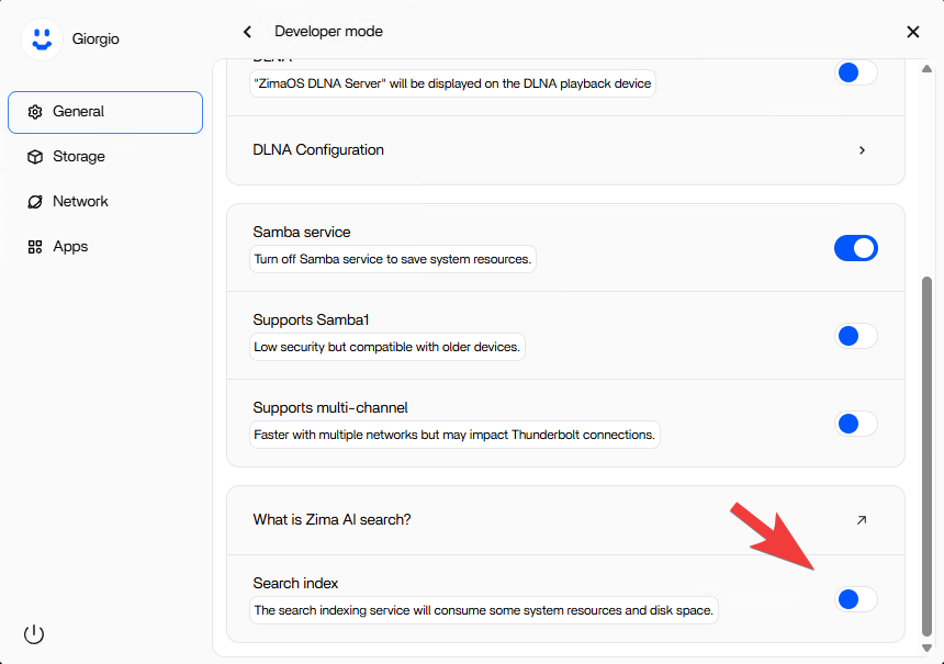

Could you please check the search setting in Settings → General → Developer mode → scroll down → Search index?
responded in pm, also attached screens and other captures of files etc.
