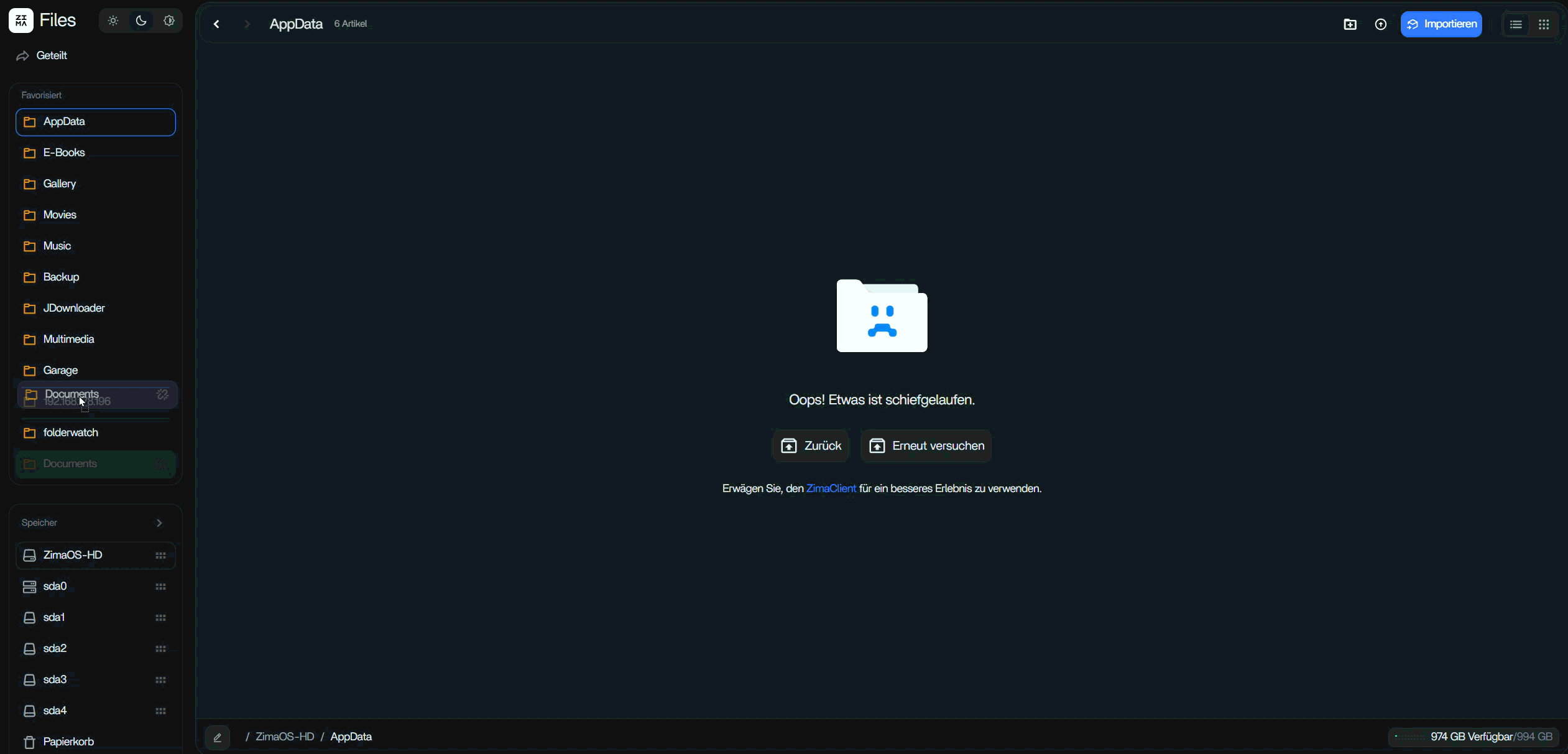

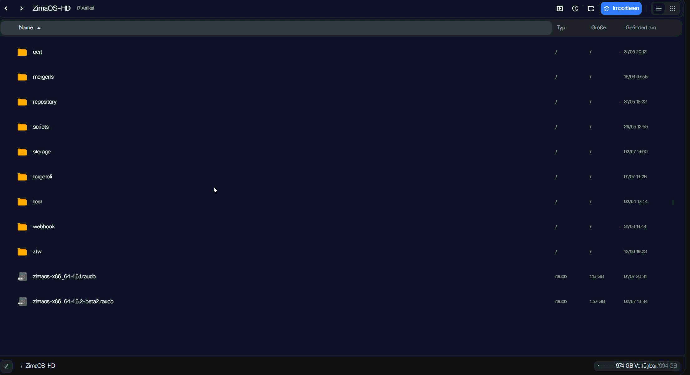

Here are the exact steps:
  1. I open the ZimaOS-HD folder.
  2. I click the Back button (top left) to go to the parent directory.
  3. In previous versions, this took me to a view where I could see all of my storage drives.
  4. In Beta 2, instead of opening that view, the Files app shows “Oops! Something went wrong.”
I’m not trying to access /media directly. I’m simply navigating back from the ZimaOS-HD folder, and this worked correctly before.
I’ve attached a screenshot showing the location before pressing Back.
Aufzeichnung 2026-07-03 073332
Aufzeichnung 2026-07-03 075535
We will fix this issue in the next version. Thanks for your feedback
You can try it first: go to the ZimaOS-HD directory, then reorder the favorites list to see if this happens. I want to understand the specific steps to address this issue
I found the exact trigger.
The issue occurs when I try to reorder the Favorites list. As soon as I drag a favorite to a different position, the operation fails with the following error:
“This request was blocked by the security policy.”
Because of this, I cannot reorder my Favorites.
Thans for your feedback. We have reproduced this issue because this version has made security optimizations to prevent path traversal, which caused some Favorites lists to fail to sort. We will fix this issue in the next version.
Thanks for the explanation and for reproducing the issue. That makes sense. I’m glad the cause has been identified, and I appreciate the quick response. I look forward to the fix in the next version.
