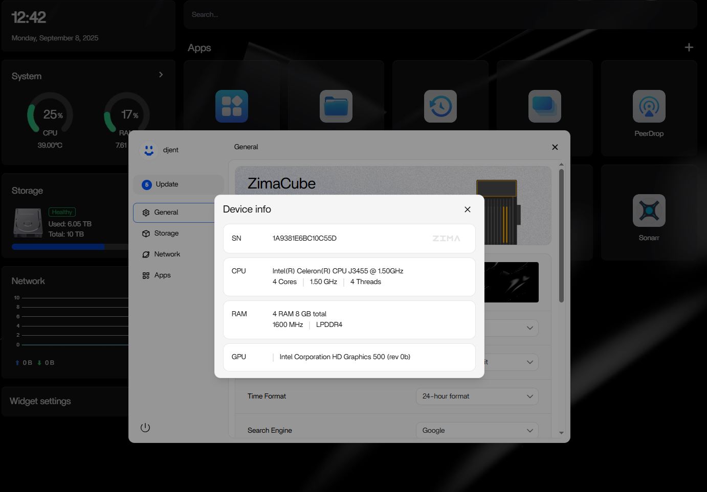

Always attach the specs of your hardware. Photos of your device would be helpful. Videos are better. These are all for locating the issue. Look forward to your feedback.
I live in Kuwait using a 5G plan from an ISP company called stc. Using an ethernet connection with my Zimaboard 832 using Zima OS, not using VPN my firewall is Malwarebytes and no other admins envolved.

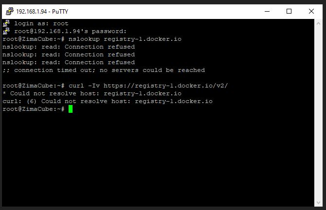

Checked the unifi UDW and firewall all ok after followed first 3 step there’s a problem
Perfect, that screenshot tells the story: DNS on the board isn’t working at all. Both nslookup and curl fail to resolve registry-1.docker.io, which means the App Store error is just a symptom—fix DNS and the downloads will come back.
On the Zima board, check what resolver it’s using with resolvectl status. If you see no DNS servers, set one on the active interface (usually eth0/enp*) like: resolvectl dns eth0 1.1.1.1 8.8.8.8, then resolvectl flush-caches. If /etc/resolv.conf isn’t pointing to systemd’s stub, re-link it: ln -sf /run/systemd/resolve/stub-resolv.conf /etc/resolv.conf.
Since you tweaked UniFi earlier, also set explicit DNS on the LAN in the UniFi Network app (e.g., 1.1.1.1 and 8.8.8.8 instead of “Auto”), and temporarily disable any DNS filtering/Family/Ad-block/IDS rules that might be intercepting port 53. Quick sanity checks: ping -c1 1.1.1.1 (IP reachability) and resolvectl query registry-1.docker.io (name resolution). If that resolves, the App Store should work immediately. If it still doesn’t, try a brief phone-hotspot test to rule out the ISP’s 5G DNS.

Says resolvectl command not found!
Can you please show me step by step how to configure the resolve because i’m not that advanced like you lol copying and pasting commands makes it easy on me.
This is DNS on the board.
Here’s exactly what I ran to get the ZimaOS App Store talking to Docker Hub again.
Backup and set working DNS (run as root)
cp -a /etc/resolv.conf /etc/resolv.conf.bak.$(date +%s) 2>/dev/null || true
test -L /etc/resolv.conf && rm -f /etc/resolv.conf
printf ‘nameserver 1.1.1.1\nnameserver 8.8.8.8\noptions timeout:2 attempts:2 rotate\n’ > /etc/resolv.conf
Test name resolution and HTTPS reachability
nslookup registry-1.docker.io 1.1.1.1
getent hosts registry-1.docker.io
curl -Iv https://registry-1.docker.io/v2/
|| true
If those show an IP or a 200/401 from curl, the App Store should work straight away.
If it still fails (router side)
In UniFi, set your LAN DHCP “DNS Server” to 1.1.1.1 and 8.8.8.8 (not Auto), apply, renew the ZimaBoard’s lease or reboot, and make sure no DNS filtering/Threat-Mgmt rule is intercepting port 53. As a control, a quick phone-hotspot test rules out 5G ISP DNS quirks.
My guy you’re a SUPERSTAR!!! it worked FINALLY!!! :rofl: :smiling_face_with_three_hearts:
