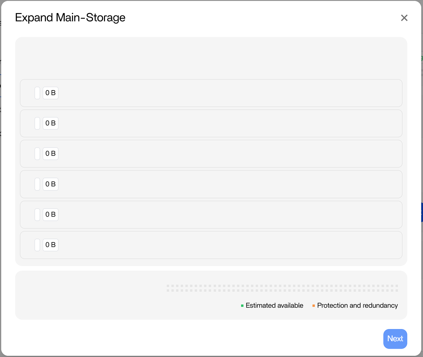

ZimaOS 1.4.1-beta Trying to expand a RAID 5 gives a list of blank disks with 0 bytes capacity

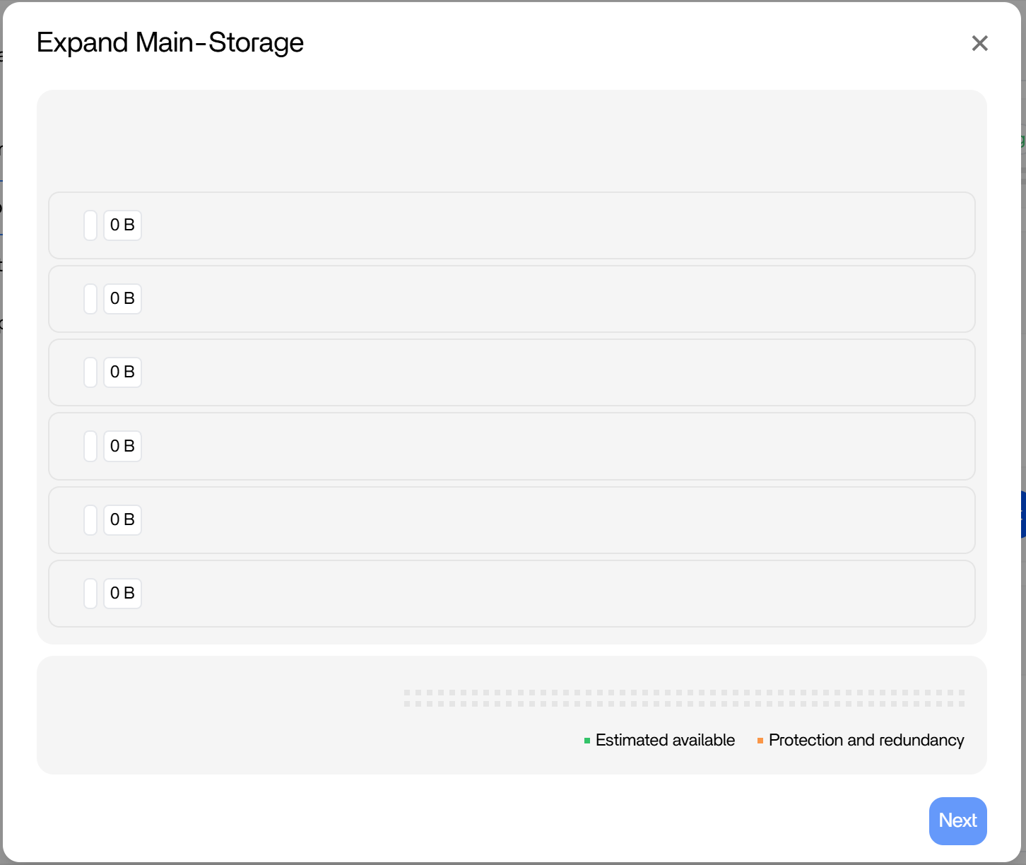

I’m running ZimaOS in a Proxmox VM and I have an existing RAID5 array with 3 disks. When I try to expand the array the disk selection window is broken. (See below)

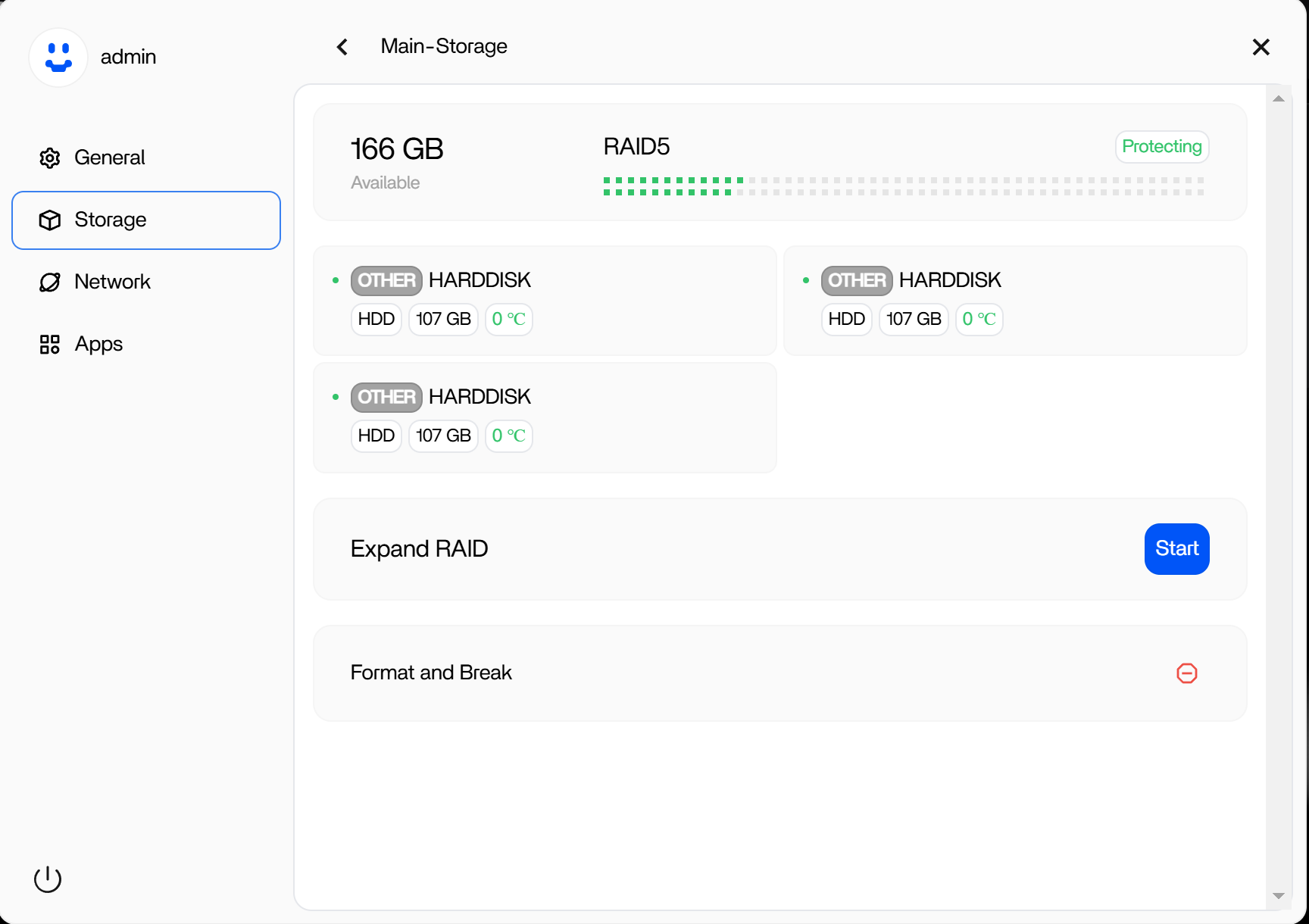

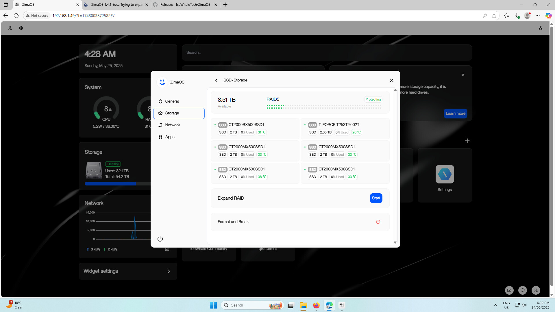

Here is how the current RAID array is shown. This is ok.

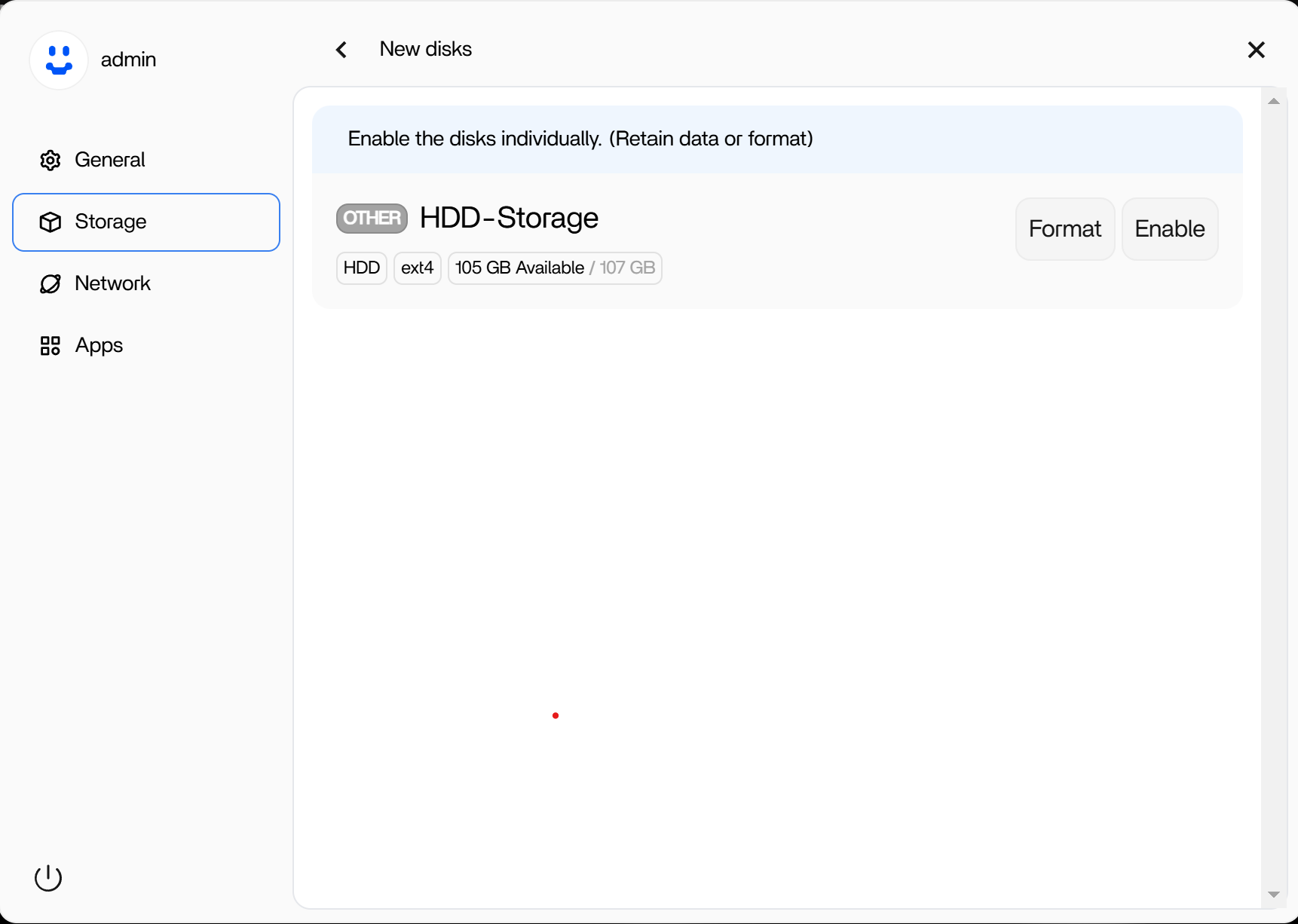

And I have a new disk as follows:

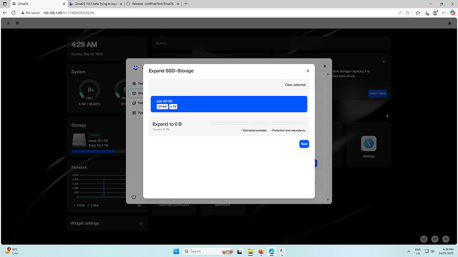

To ensure I didn’t do something stupid I just recreated the array again from scratch. i.e removed the disks from the VM and then added 3 disks again. I created a RAID 5 array from those 3 disks (this works perfectly and shows the complete list of disks and their capacities for me to choose from). Then after the array was in sync I closed the OS down. Added another disk to the VM. Went to storage, where it shows me a new disk has been added, and then I selected the array I just created and choose Expand and then the list of disks is shown as above (i.e. just the 0 in the box representing each disk). Also I think the list should only have 1 disk in it so I don’t know why it is trying to show so many disks. There is only one free disk to be used to expand this array.

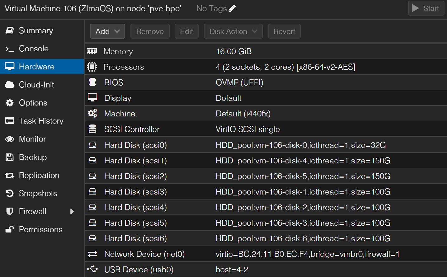

Here is the VM characteristics:

A little bit more information. For some reason the Expand arry shows a disk list with 10 disks of 0 B, however there are only 7 disks (including the OS disk) attached to the VM.

I can confirm the exact same result as I first got. The initial drive creation with 3 drives is perfect and shows all disks and correct capacities but when select the “Expand RAID” → Start button to extend the RAID5 array, I get an “Expand storage” window which seems to be listing 10 disks (but this system has only 7 disks in it) with no information and then with “0B” showing. Exactly the same as the first screen shot I sent you.
There is definitely a bug here somewhere .

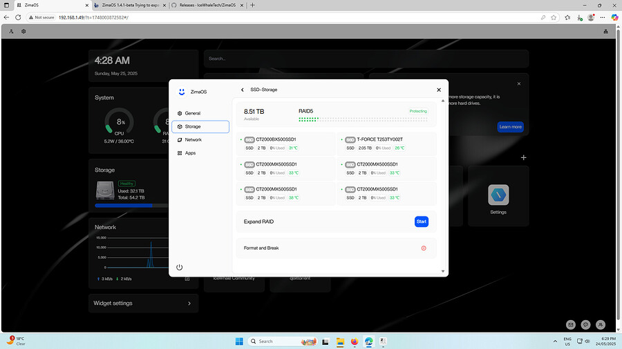

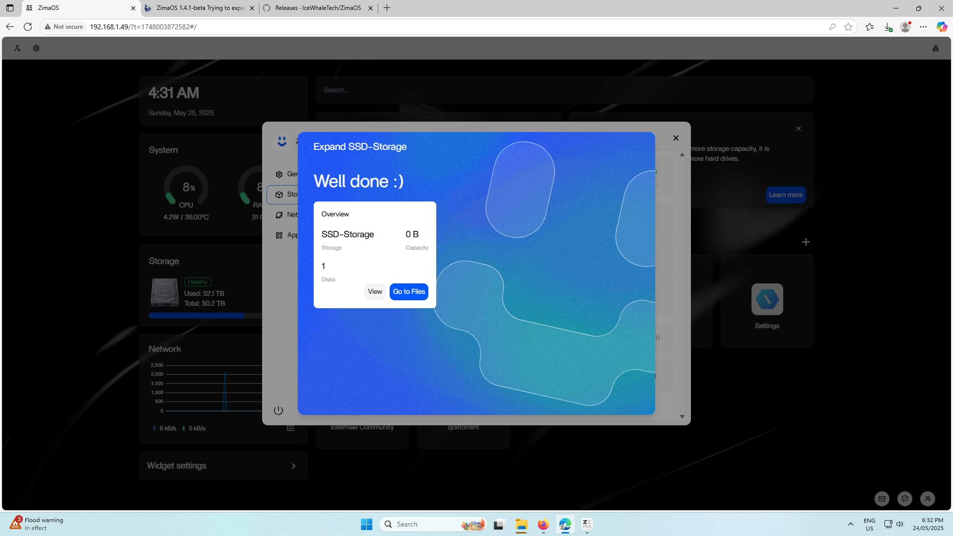

The official 1.4.1 has fixed this … thanks!!

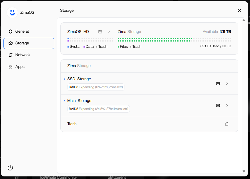

Here is the display when expanding storage in 1.4.1 I’ve just upgraded, note my display is 14h out before upgrade it was showing Asia time now showing correct Sydney EST
