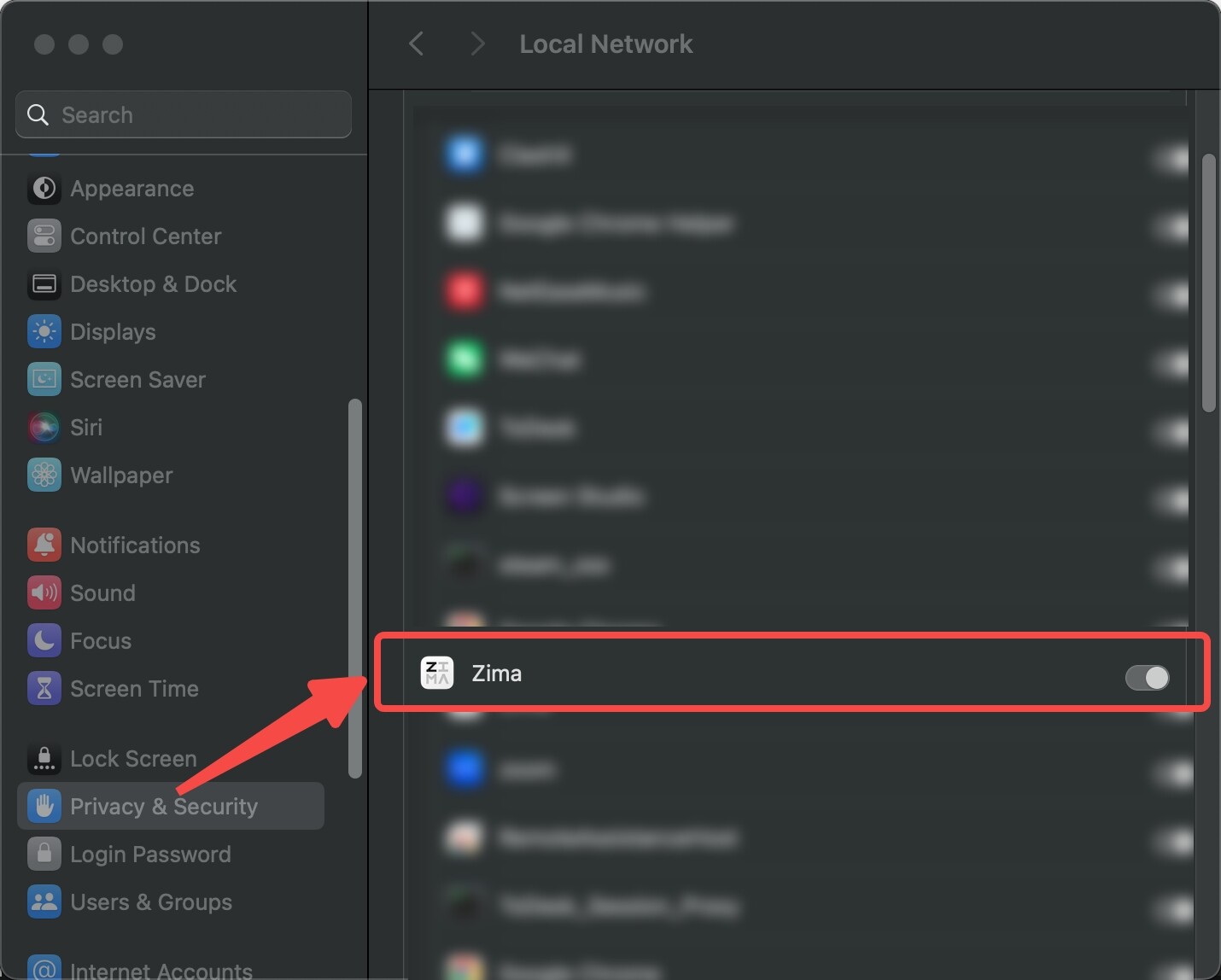

Please check if this is open?
That was it. Thanks!
As it worked before, I guess this setting was not needed before or it has changed (although I wouldn’t know how).
its work now?
Yes, it does. That’s why I marked your answer as the solution to my problem. Thanks again!
