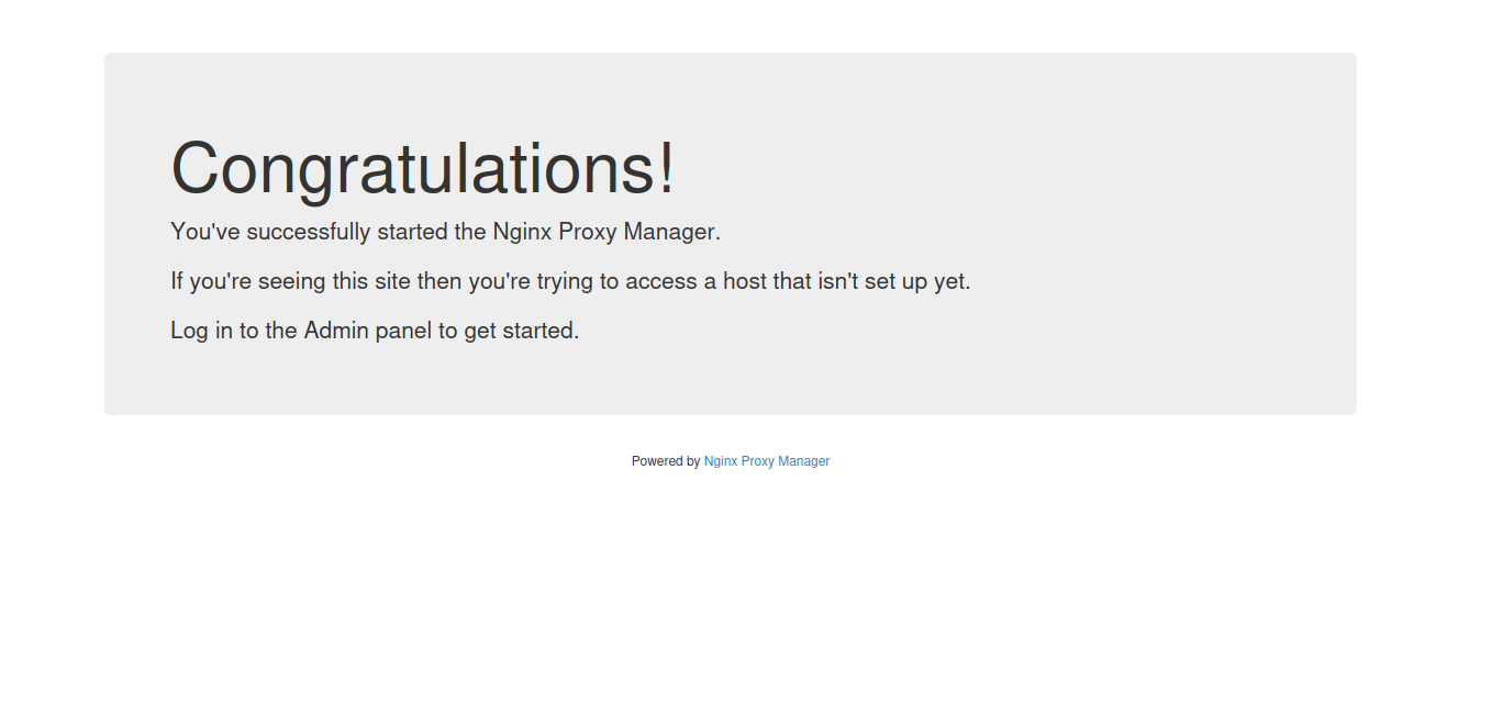

When I type the http://ip_address of my zima box in the web browser on my desktop computer I see this:
My zimaOS login is at https://zima.sdak on my network.
