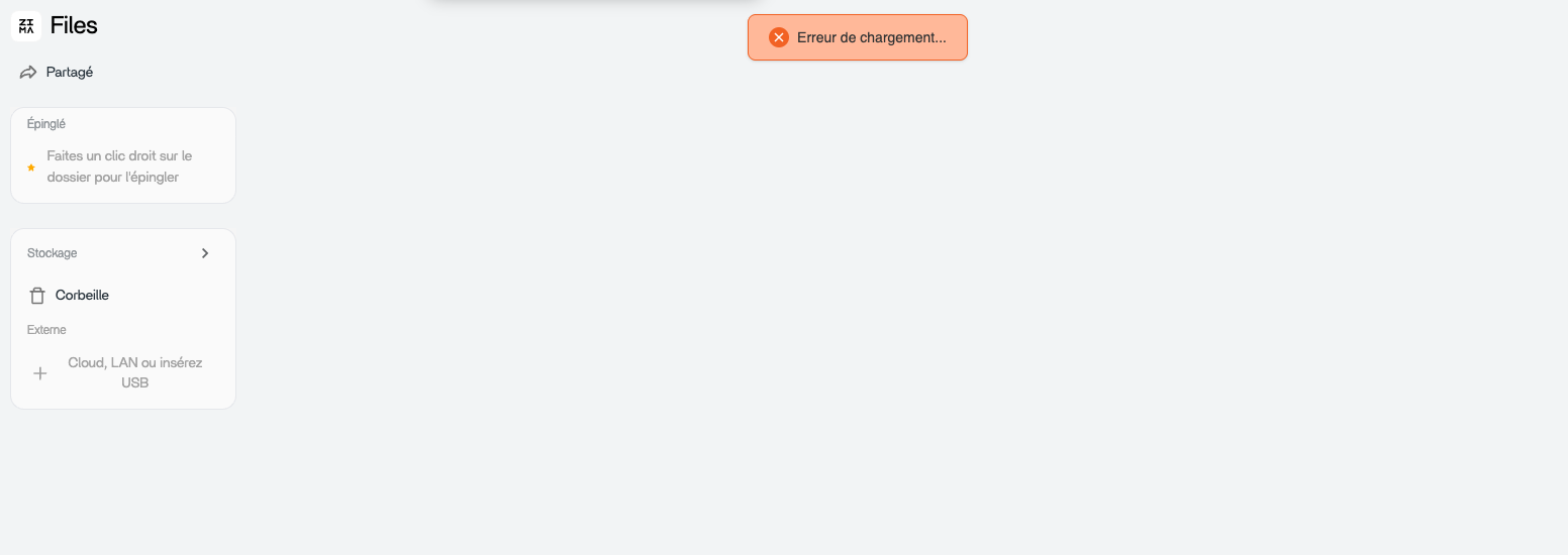

I upgraded my Zimaboard 2 from software version 1.4.3 to 1.5.4 (Stable) and I am now unable to access any files on the ZimaOS-HD drive (it returns an “error” and “fails to get files”. / error loading message.
The OS drive is NOT full and shows approx 41GB of 47.7GB capacity.
The left hand panel of the files app is empty and no folders are visible in the main panel. I am unable to add network storage (the “connect” button does not work and when I try to enable SAMBA from the settings menu it returns an error box with no visible text. My aim is to use the board as a hardware video transcoder with a Synology NAS mapped as the data source (I am now unable to add this), this worked perfectly before.
I have restarted the machine in software, tried three separate browsers, turned off browser security settings and cleared cache multiple times, I have also conducted a power reboot (unplugged and replugged in) and nothing will seem to fix the issue, I have also tried to revert to multiple previous software versions (including back to the original 1.4.3 and nothing will fix the issue. I have also performed a software reset multiple times from the settings menu.
I have no additional HDD / SSD or external storage attached.

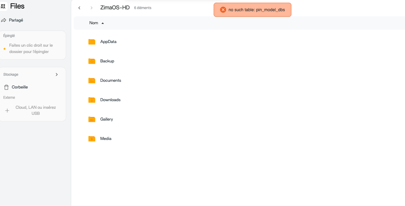

Hi, I have exactly the same problem, plus I can’t even pin my folders, I tried a factory restore, but it didn’t work.
What’s more, I wanted to delete EVERYTHING and ZimaOS doesn’t allow it, because it keeps (and I don’t know why I can’t delete them) the Storage arrays, User files and App data files folders. It should be possible to do a REAL factory restore (like on MacOS, for example).

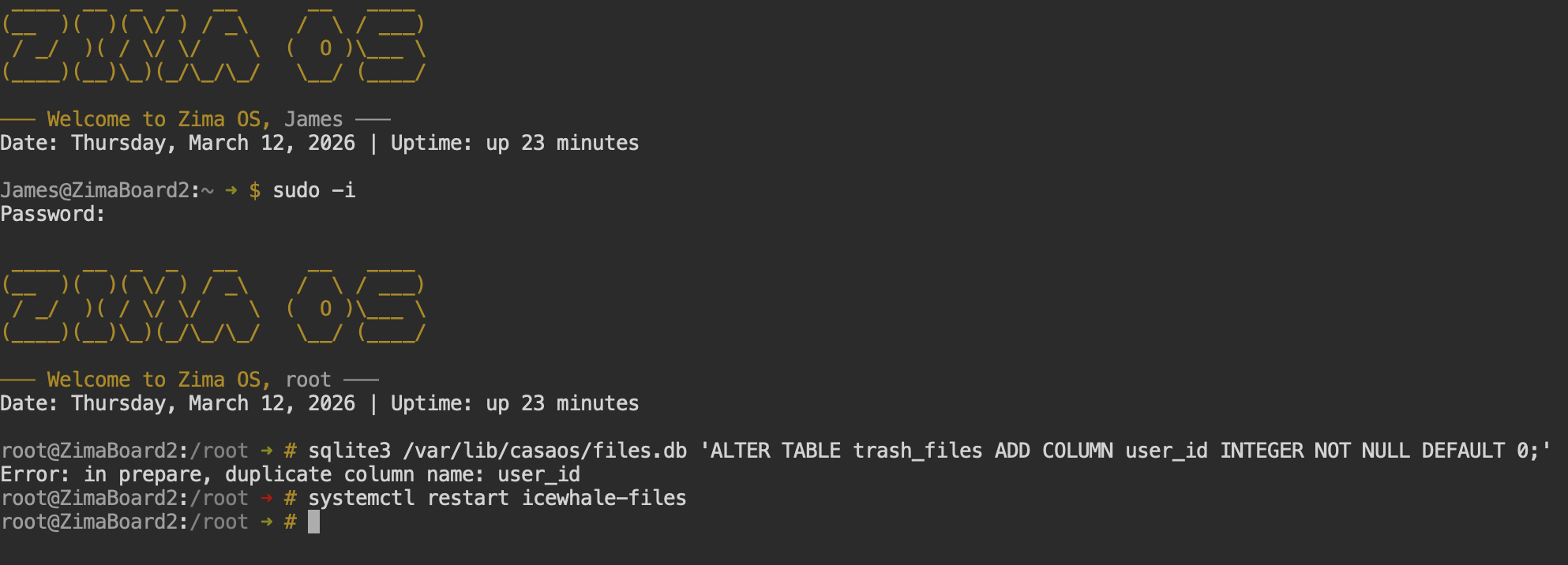

root@ZimaBoard2:/root ➜ # sqlite3 /var/lib/casaos/files.db ‘ALTER TABLE trash_files ADD COLUMN user_id INTEGER NOT NULL DEFAULT 0;’
Error: in prepare, duplicate column name: user_id

A contextualised solution (assume generic because you’ve provided a single code box on multiple posts with this issue) will also help other users with the same issue that encounter this issue in the future and save resources WRT dingwen@icewhale.org
sudo -i
systemctl restart icewhale-files
Yes — these are three separate commands.
:one: First run:
sudo -i
Then enter your password to switch to the root user.
:two: Next run:
sqlite3 /var/lib/casaos/files.db 'ALTER TABLE trash_files ADD COLUMN user_id INTEGER NOT NULL DEFAULT 0;'
:three: Finally run:
After executing these three commands, the issue should be resolved.
If you encounter any problems, please take a screenshot of the command output and share it here so I can take a closer look.
Hey 777-Spider.
Once again, thanks for your swift reply - solution does not seem to be working for me, second line of code returning an error.
It feels like I’m either missing something (very likely) or the line of code is not quite correct?
Please see attached screen grab for details.
