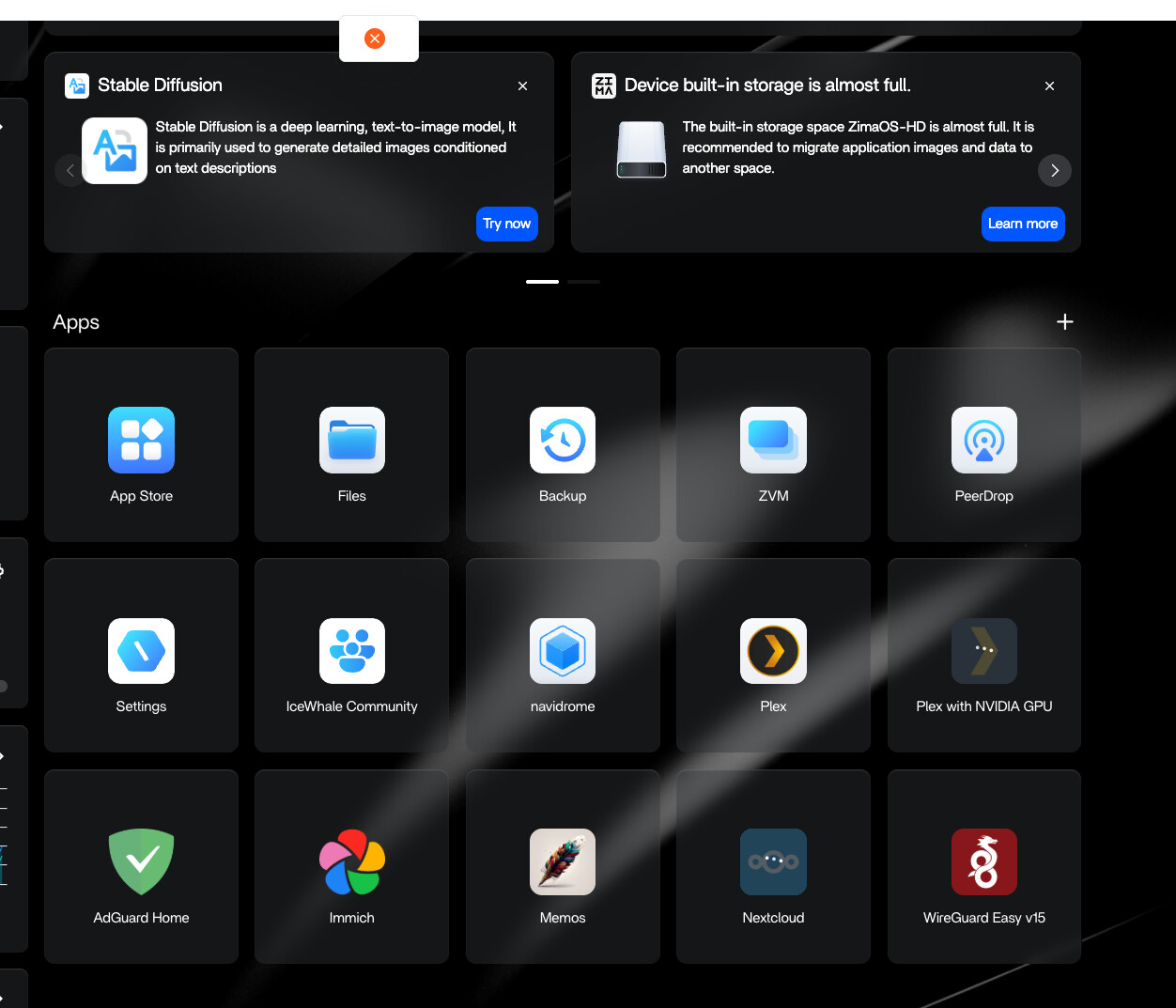

Zimaboard 2 1664 - Problem STUCK can't add apps, cant run docker , cant delete anythign
Hi, I am a little frustrated with my device, I installed
* adguard, immich, memos, nextcloud, wireguard easy, plex.
before they were running, now, when i try to run them they dont work, if i try to uninstall I get a red “X” in the middle of screen below the http:// address.
I am not sure what to do at this point, i have a SATA drive 8TB, SATA1 drive 2TB, and USB 5TB drive external.
How can i make this a fresh start, and have all the containers, and files saved where they should be, should i do a factory reset ? if so, how should i do that ?

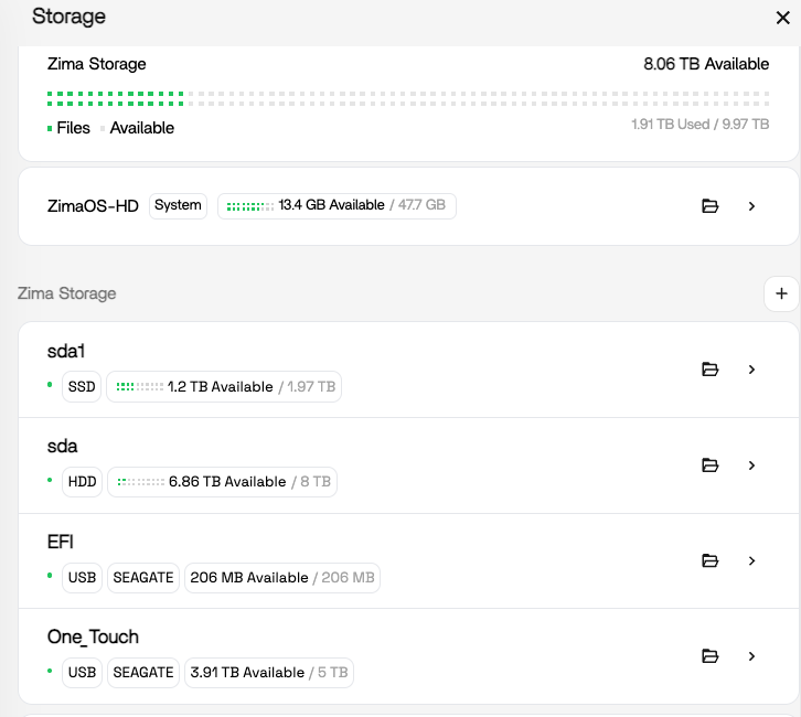

I am not sure why i have only 13.4 GIgs available in the zima-os drive ? i think I should have more space, not sure what i should do,
thanks
thanks
my intention has been to run this as a file server, where i can organize all my files. BUt, although this works, I can’t run the programs I installed. I am running zimaos v1.6.1,
Zima-OS is stored on the internal eMMC “drive”. By default, most of the useful apps are stored un sub-directories of there, with very limited space.
AFAIK you need to migrate these to one of your “external” disks, preferably the SSD for VMs but NFI for the rest (it depends on how hard you will hit them; for example, media files probably (?) don’t need SSD speed).
If you go to Settings, Apps, there are options there for moving some directories to new locations - do this.
IME not all directories under Zima-OS are moved like this though. I logged into the ZimaOS shell then moved them manually, specifically the VM and Media subdirectories. Just make them symlinks to the new directory. Reply if you need more details instructions.
And sorry, IDK if you’ll need to redo your install nor how to do that (Google should know), but personally I would to avoid lingering hard-to-diagnose problems (running out of disk is rarely handled well by linux apps).

Also, your screenshot shows:
  • ZimaOS-HD system partition: only ~13.4 GiB free out of 47 GiB
  • multiple additional drives available with lots of free space
So the cleaner long-term solution is usually:
  • keep the OS on eMMC
  • move AppData / Docker data to the SSD
  • keep large media on HDD/USB
But I’d verify the current state first before migrating anything.
