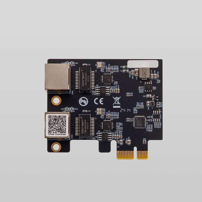

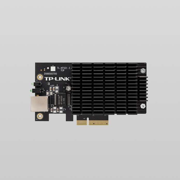

After some testing, it appears that plugging in too many items at once causes power issues. The ZimaBlade can not power up and remains bricked. The only way to solve it was to take out both the RAM and CMOS battery for a while. Insert the RAM and then the CMOS battery. Wait another few minutes. Connect a smaller amount of things and power up again. (I did have to get replacement CMOS batteries but that’s fine.)
The setup that worked was:
ZimaBlade, PowerCable, Ethernet, no PCI-E card!, one bay featuring two 4TB SSDs (2SATA+power cable).
The setup that didn’t work: Same as above but a network card in the PCI-E slot. I tried both of these.

However, after reading your subsequent feedback, is the problem likely caused by an incompatible network card?
Since those network cards were part of the ZimaBlade network bundles, I doubt it. While I am having a couple of issues trying to improve my setup, I now have both servers running and doing the minimum essential tasks I require of them.
