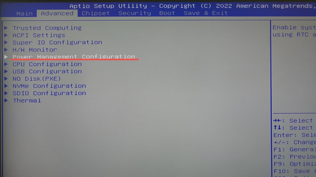

At the same time, is the document you mentioned about remote wake-up ours? If so, I think we should fix the content.
Yeah here is the document I’m referring to
But thank you. I will give this another go
This document is about the setup method for ZimaBoard + CasaOS. ZimaCube + ZimaOS is already enabled by default, so there is no need for separate setup or installation of ethtool.
