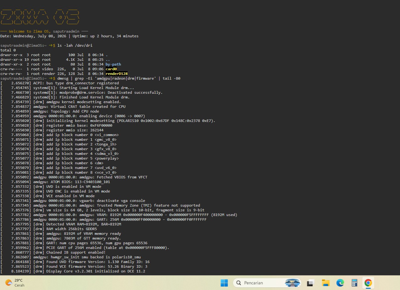

The RX 580 should normally use the Linux amdgpu driver, but ZimaOS is not a normal desktop Linux distro, so we need to first check if the card is detected and if the driver loads.
Can you SSH into ZimaOS and post the output of:
lspci -nn | grep -Ei 'vga|3d|display|amd|ati|radeon'
dmesg | grep -Ei 'amdgpu|radeon|drm|firmware' | tail -80
ls -lah /dev/dri
That will show whether the issue is GPU detection, missing AMD driver/firmware, or the app/container not getting GPU access.

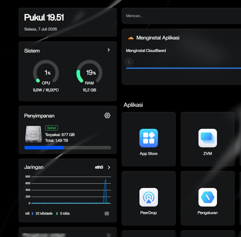

Nothing is showing up on the dashboard screen either.

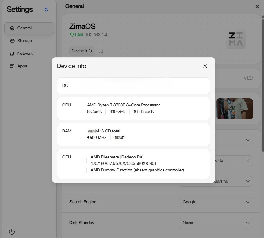

From the screenshot, ZimaOS does appear to detect the RX 580 at hardware level, which is a good sign.

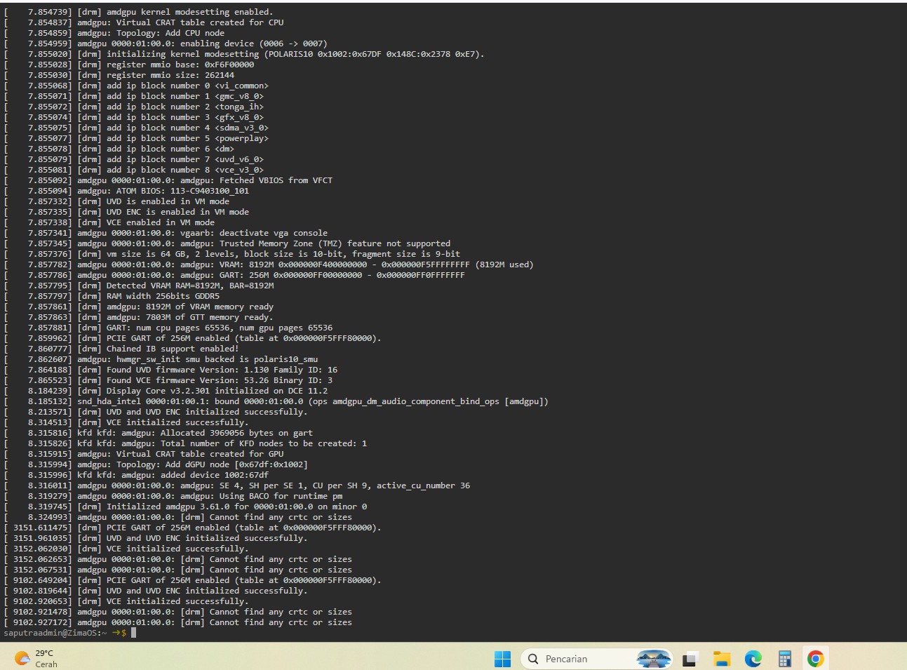

Sorry, the video isn’t clear.
Here’s the photo.
Hi Saputra,
Thanks, that output helps.
Your RX 580 is detected and the AMD driver is loading correctly.
I can see:
/dev/dri/card0
/dev/dri/renderD128
And the logs show:
amdgpu kernel modesetting enabled
UVD and UVD ENC initialized successfully
VCE initialized successfully
So this does not look like a basic driver detection problem.
The message:
Cannot find any crtc or sizes
usually points more toward display/output detection, for example no monitor/EDID/display mode being detected, rather than the GPU not loading.
