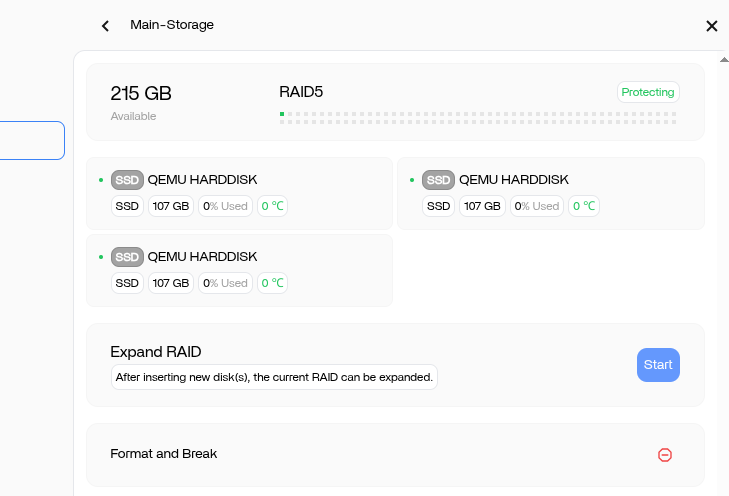

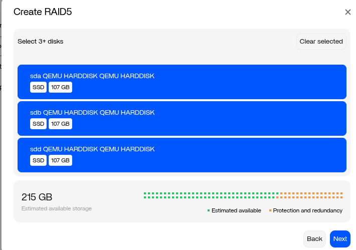

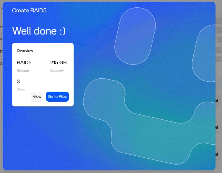

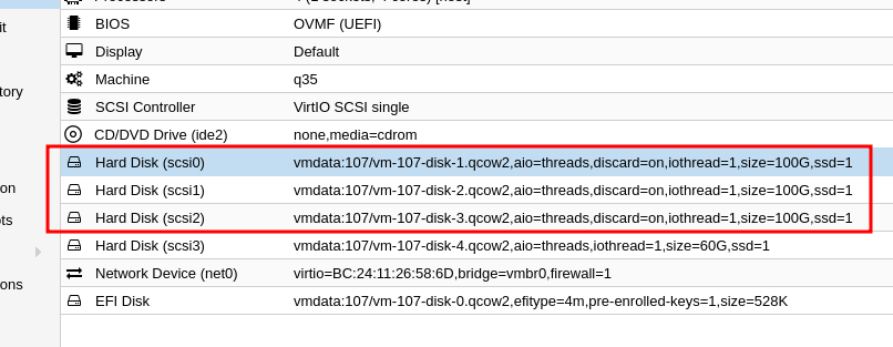

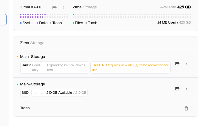

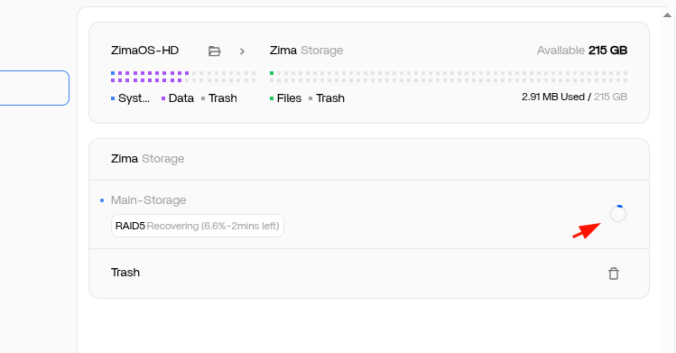

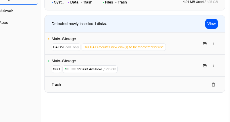

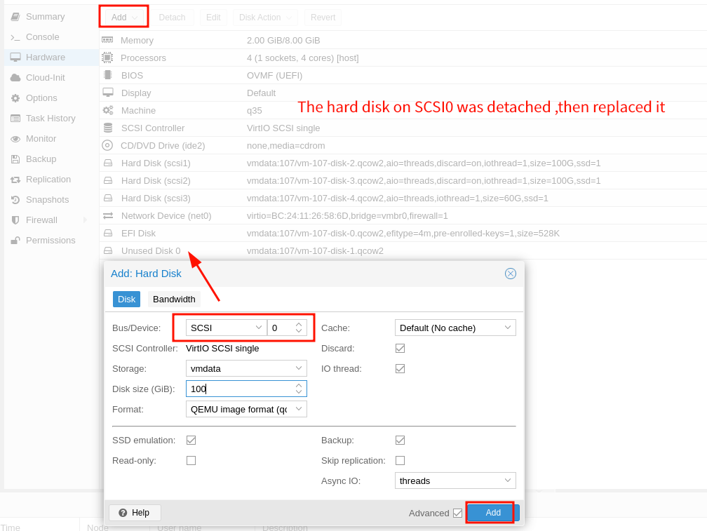

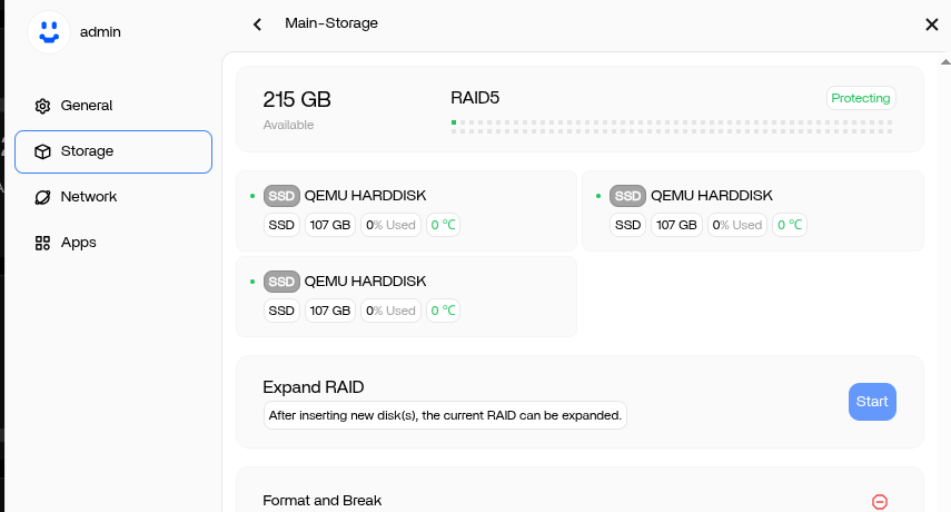

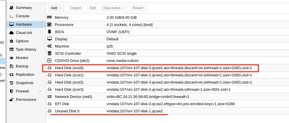

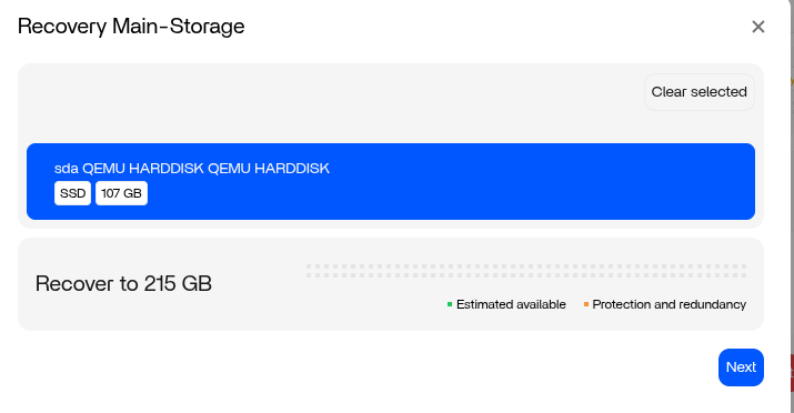

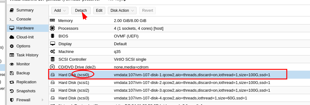

Simulate disk failures on a RAID 5 configuration (comprising three disks) using Zimaos 1.4.1 on Proxmox VE 8.4.1.

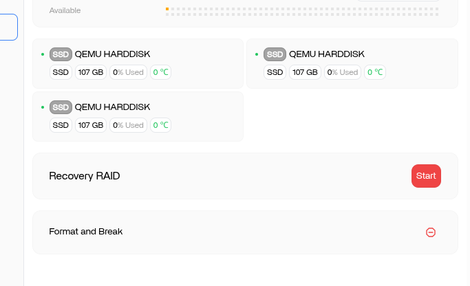

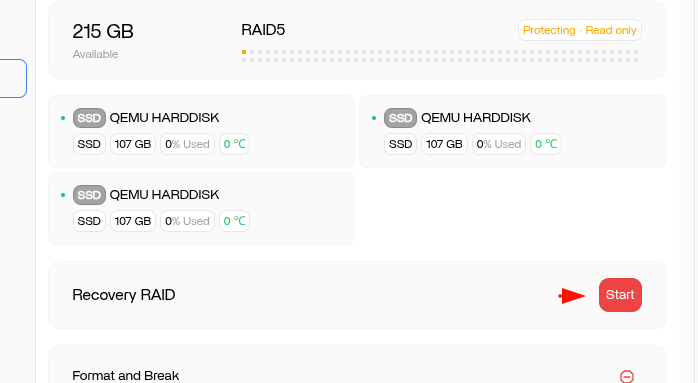

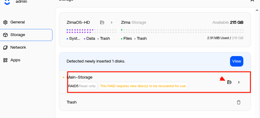

Shut down and then detach a disk. Replace with another disk
Power on

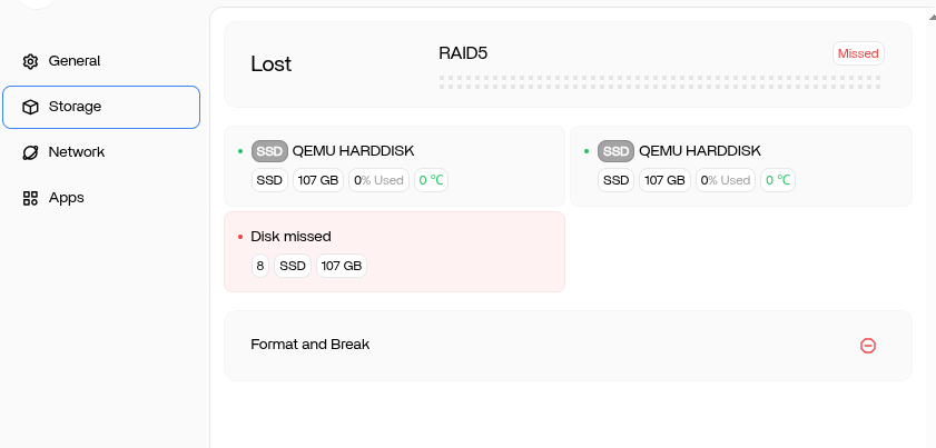

That’s all. This is damage, not missing. If it were missing, the data might be lost forever

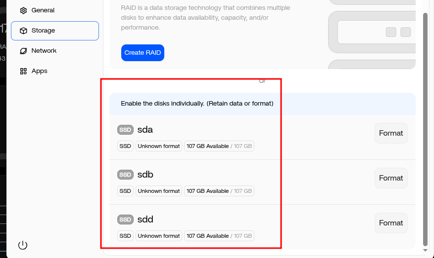

It seems that you simulated a missing instead of a damage. And it succeeded. Right?
damage ok,missing no.

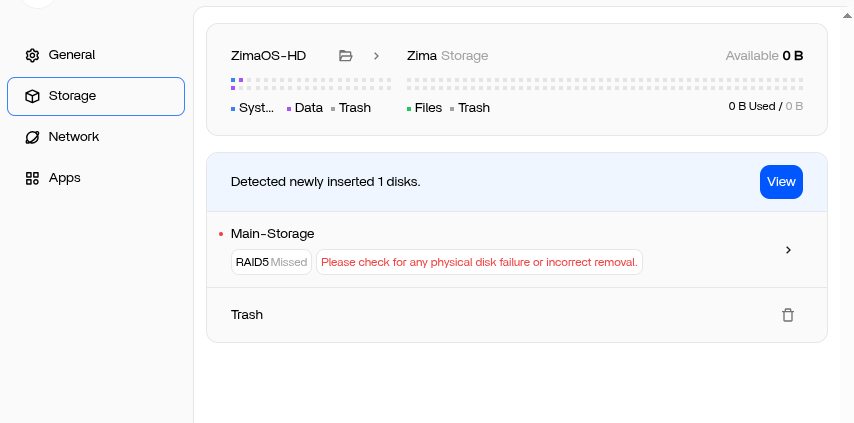

How did you damage it specifically? What I saw is you detached the old one and reconnected a new disk. This is what I called simulating a missing.
Yes, you’re right. What was just simulated was the damaged one. At first, I removed it directly, and then “missing” appeared. Or if the scsi channel is directly changed, it will also appear. This seems inevitable ~_~

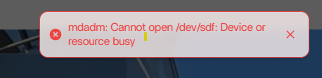

I am trying to follow these steps but get an error message
Can you please let me know what my mistake is.
Thank you very much
