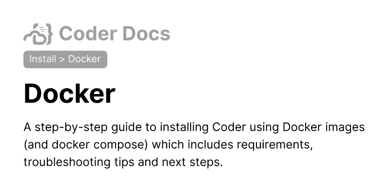

I think you need provide more info both for this post and your installation process.
You need modify this file according to your machine: coder/docker-compose.yaml at main · coder/coder · GitHub
The detailed guide is here: Install Coder with Docker: Step-by-Step Guide | Coder Docs
