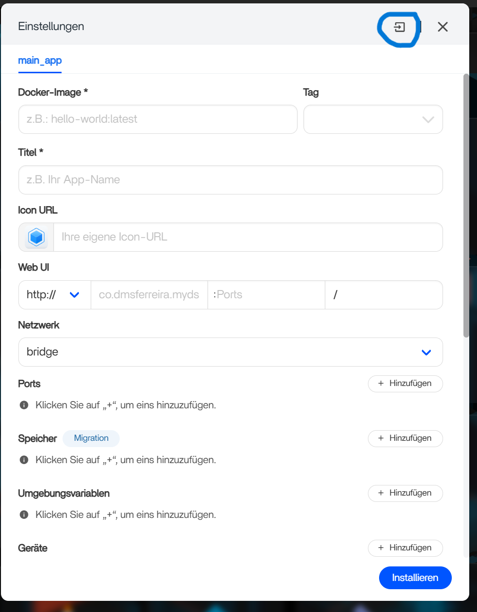

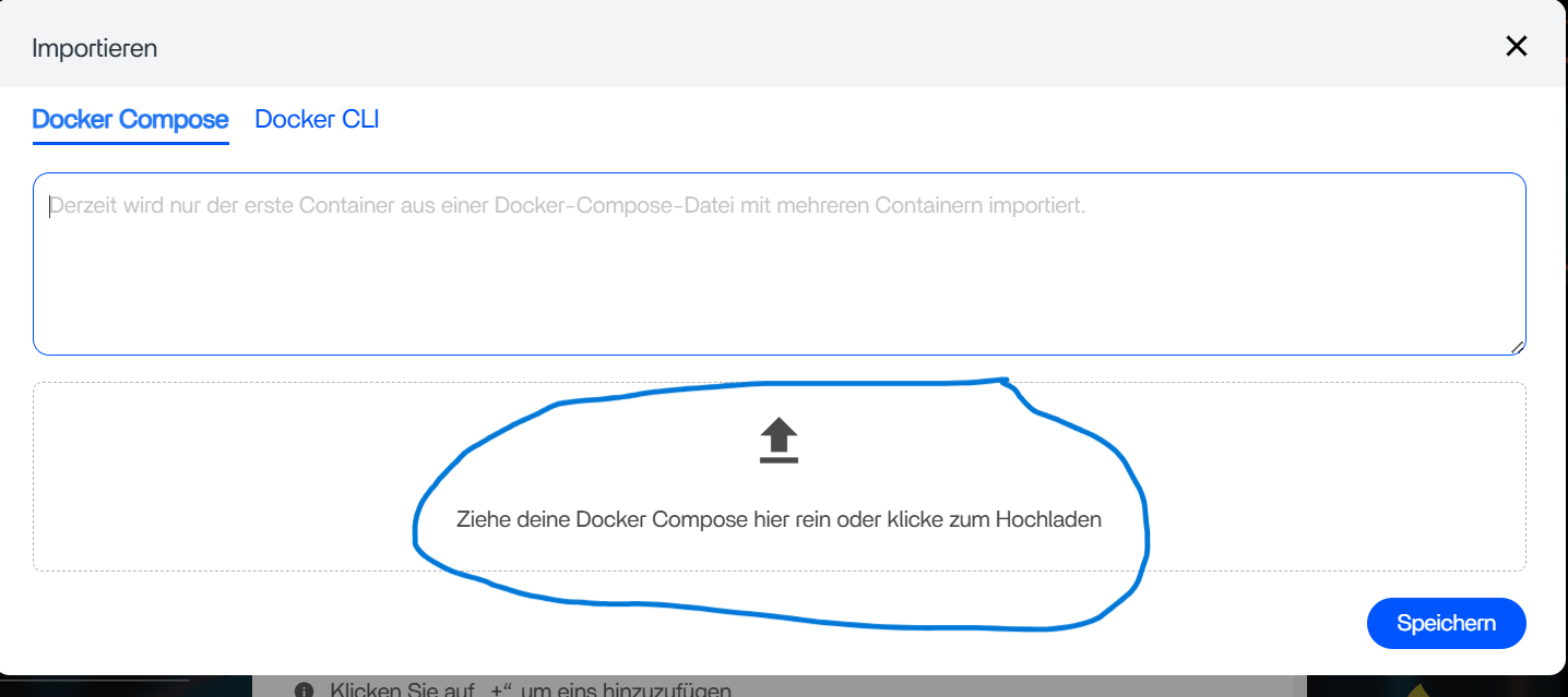

Thank you to all that have replied. I can download the YAML. After re-installing how do you upload the YAML?
Thank you all very much for the support. I’m good to go!
