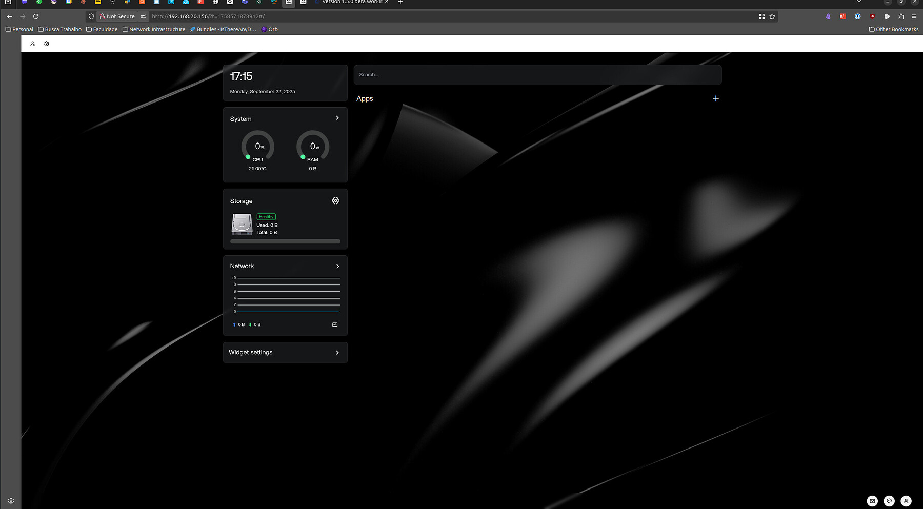

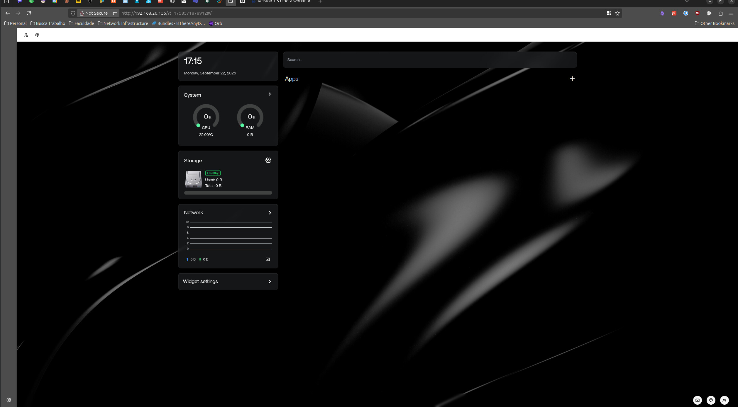

I just got the update to the version 1.5.0 beta, and I have some problems, like the icons from the apps section were missing, also information about RAM and storage are missing.
Here is the screenshot. It’s seems the update was broken, and I don’t know what command to use to reforce the update.
I said that because I have to ZimaBoard 2 and the first one that I put to run, updated offline to 1.4.4-1, and then updated to 1.5.0-beta1, updated ok. The first one where I had installed the zimaos_ai package, broke during the update. I can’t even reset it.
I had the same occur with my original zimaboard. Thoughts on this???

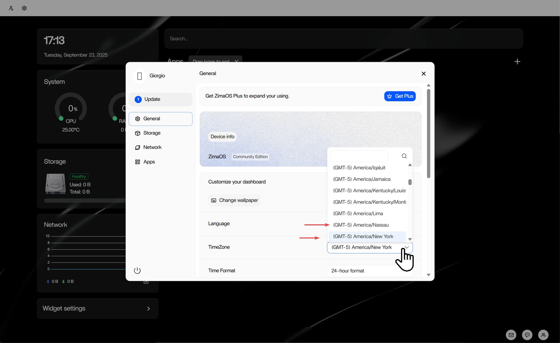

The info missing issue may have something to do with the time-zome issue.
The temporary fix is here:
Look forward to your feedback.
