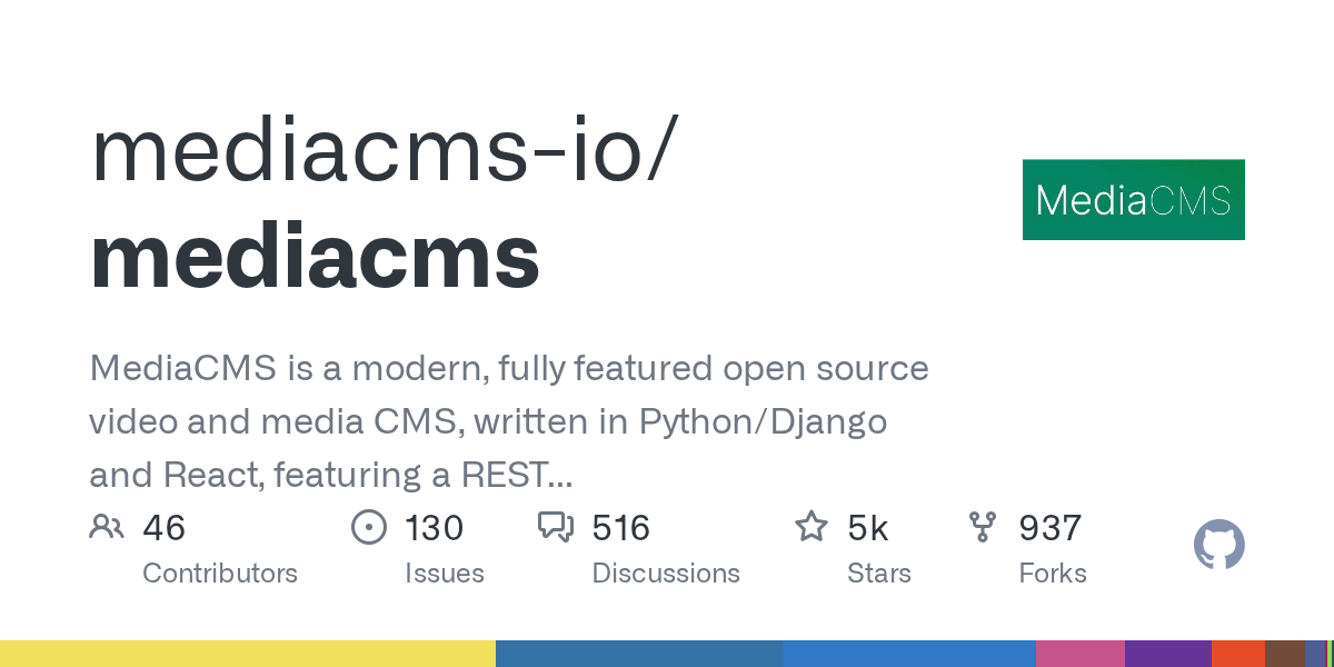

@morgyann Did you manually execute docker compose up to start MediaCMS? You try to execute docker compose ls-a to see if the docker-compose yaml file is in the correct location.
For this application to work correctly you must clone the repository. It works poorly with a simple YAML.
To deploy this application, you must therefore go through the SSH Terminal.
A developer, WisdomSky, offers us a single command line installation that compiles the cloning of the folder and its YAML specially adapted for CasaOS/ZimaOS.
I just deployed MediaCMS on my test machine. The application works normally. But does not appear as a tile, nor in the listing of my applications in the new app store.
