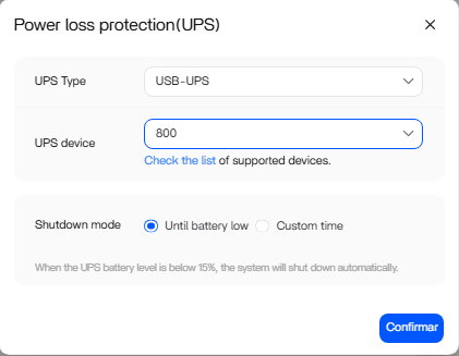

UPS in ZimaOS v1.5.4 does not show device list
When Power loss protection (UPS) is activated, only “800” is displayed when UPS device is displayed.
If I select them, the server appears as Disconnected
To fix it I had to disable Power loss protection (UPS)

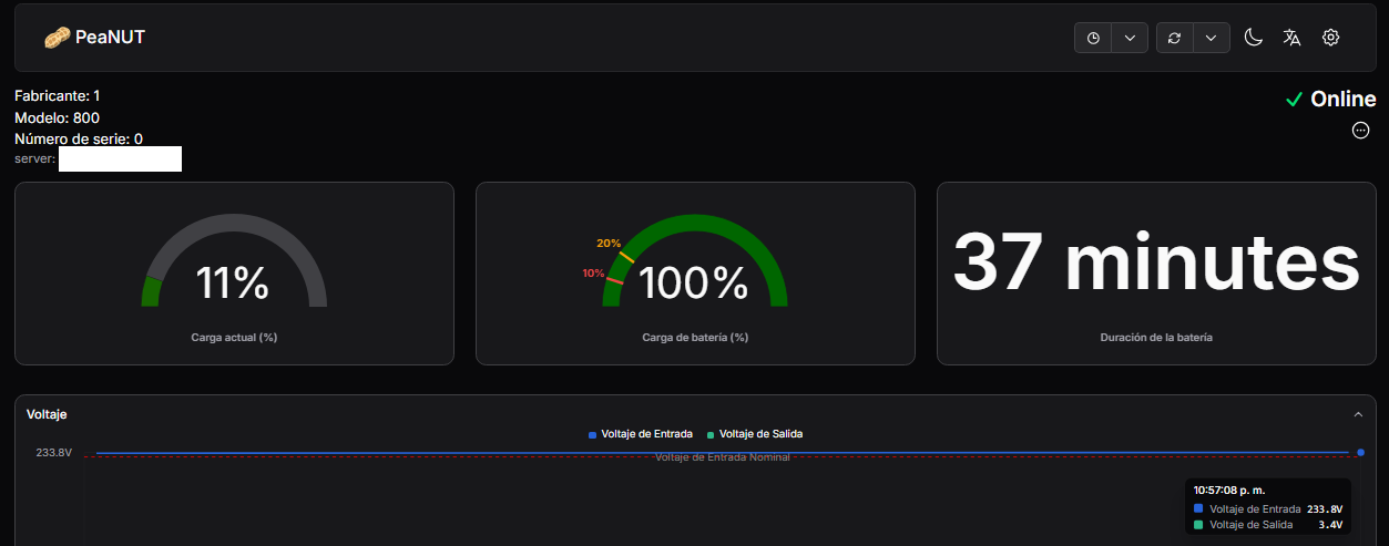

➜ # lsusb
Bus 003 Device 002: ID 0764:0601 Cyber Power System, Inc. PR1500LCDRT2U UPS
Clean processes:
pkill usbhid-ups
pkill upsd
Write configuration:
echo -e “[ups]\n\tdriver = usbhid-ups\n\tport = auto\n\tvendorid = 0764\n\tproductid = 0601\n\tdesc = “CyberPower EPYC”” > /etc/ups.conf
USB permissions:
chmod -R 777 /dev/bus/usb/
Start Driver y server:
upsdrvctl start
upsd
I can now connect, but I don’t have the option to shut down the NAS in a controlled manner.
If anyone knows how to fix the ZimaOS configuration problem, I would appreciate it.
