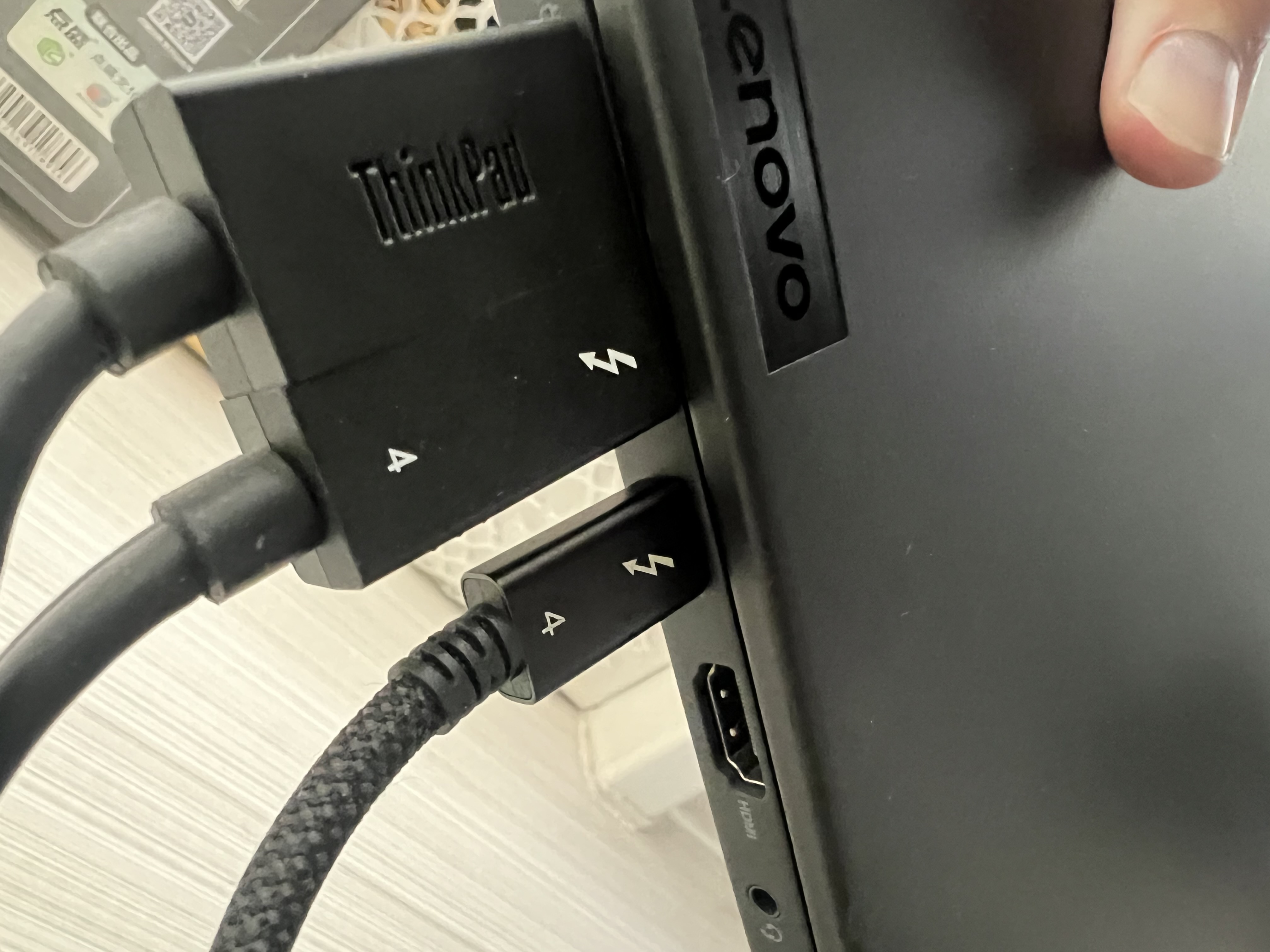

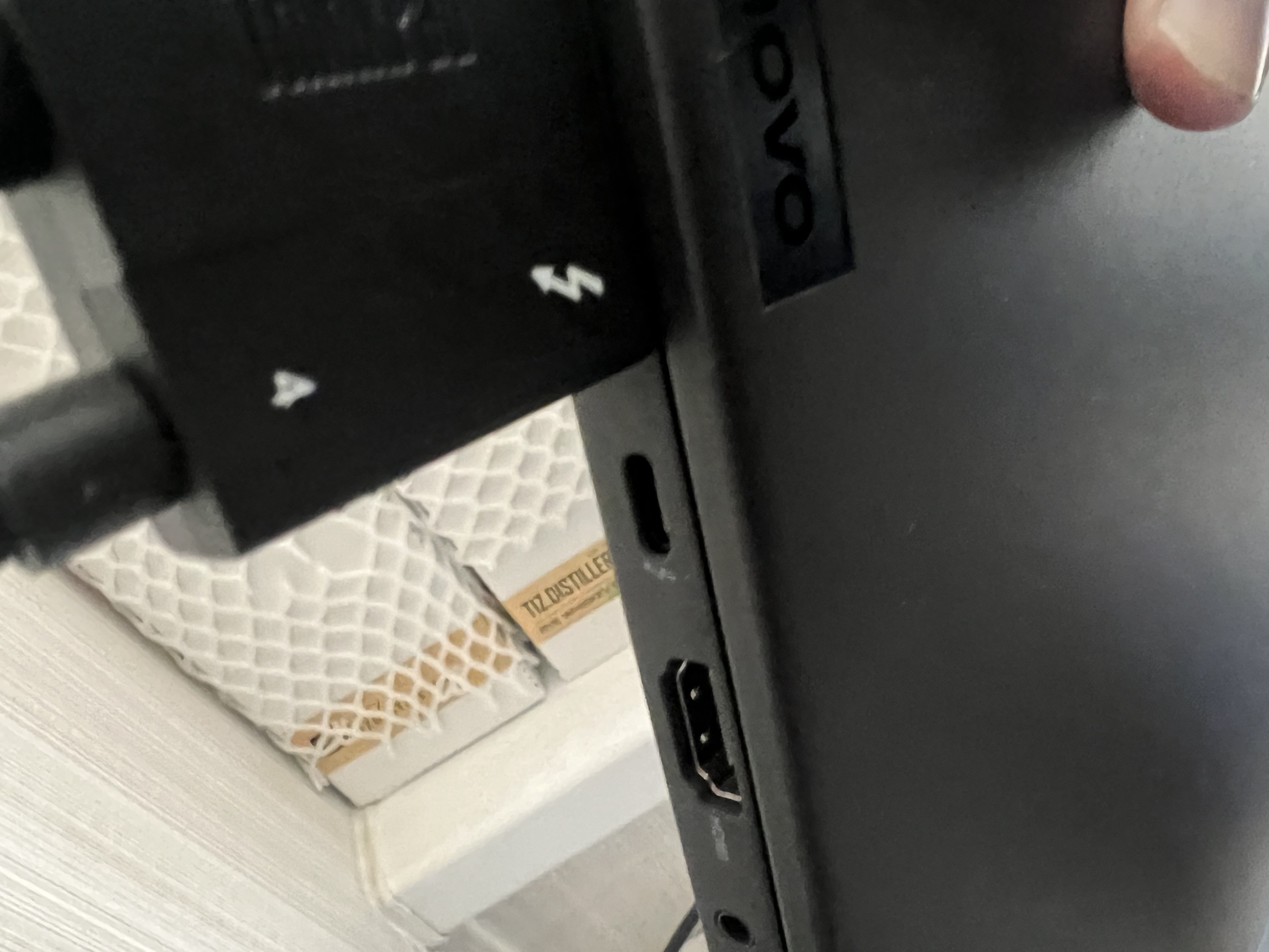

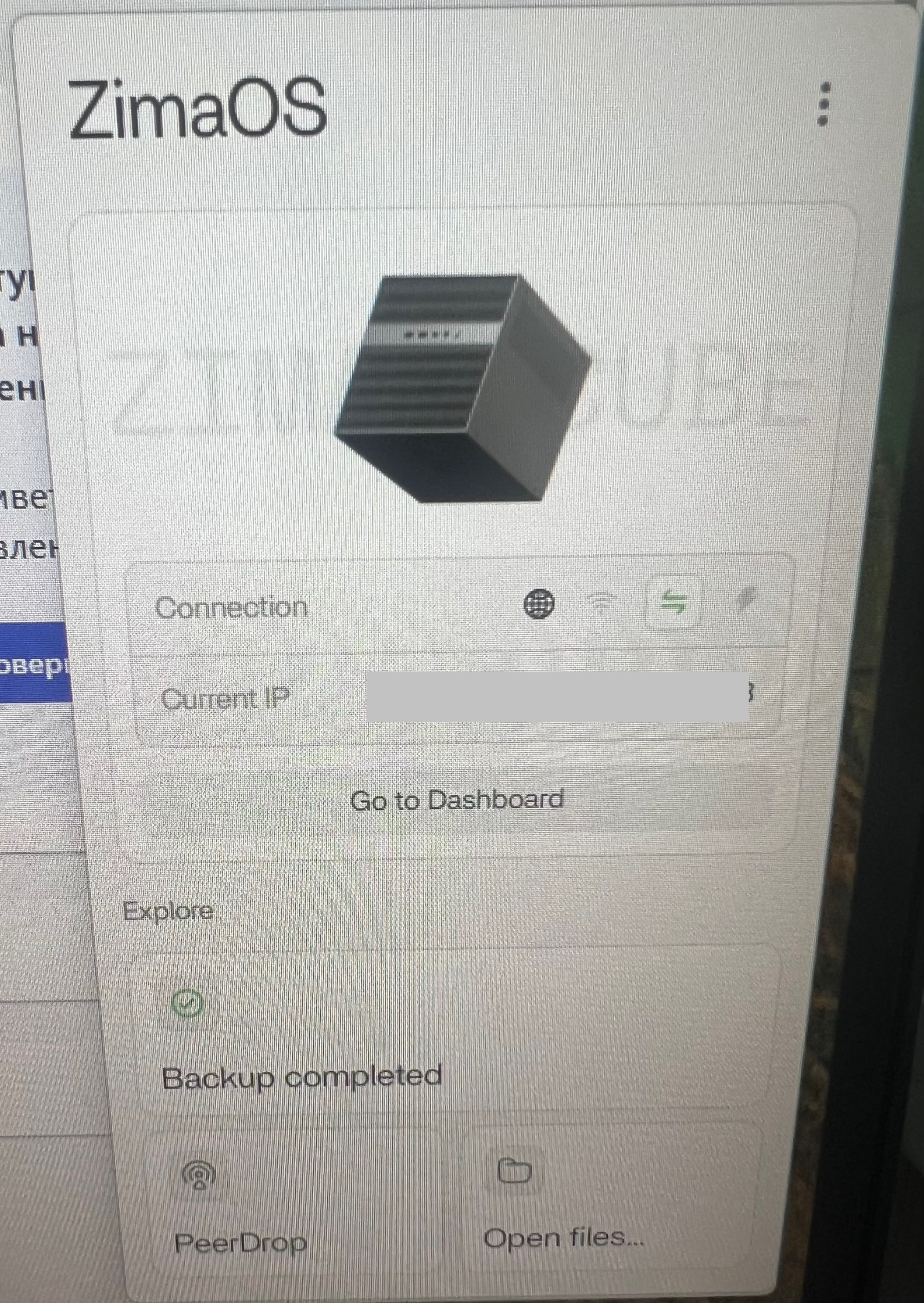

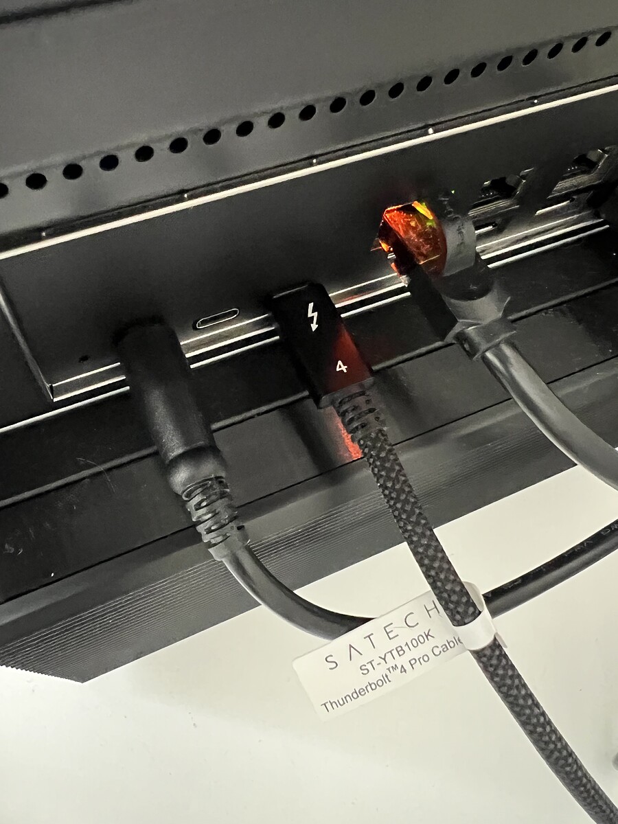

Also, if convenient, would you show us the photos of your connection methods and the screenshots of the ZimaOS dashboard and the Zima Client on Windows/Mac when you connect them?

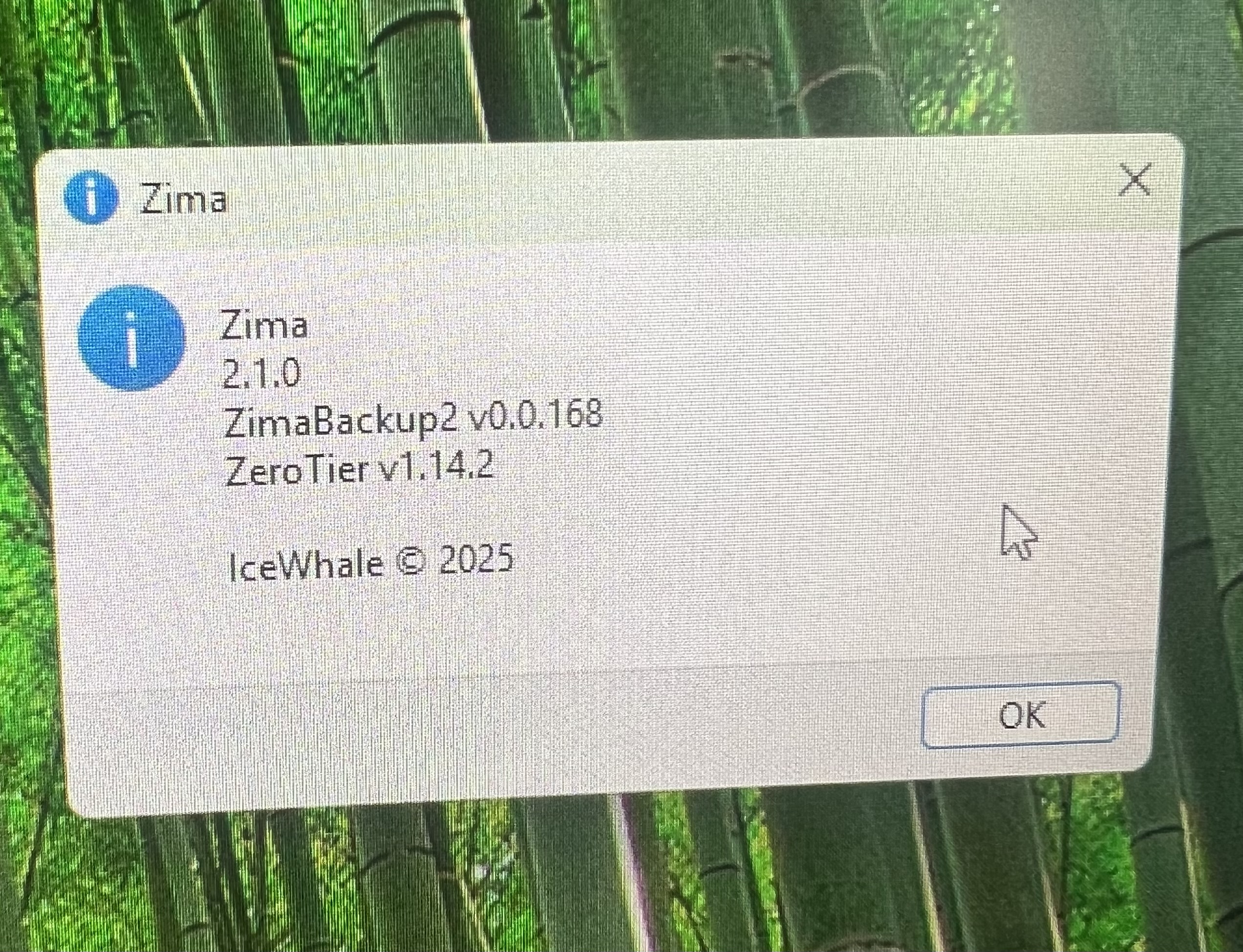

Hi, thank you for your reply.
  1. Yes.
  2. Yes.
I have attached the photos.

  1. The photo of your computer port. (You have provided the ZimaCube one.

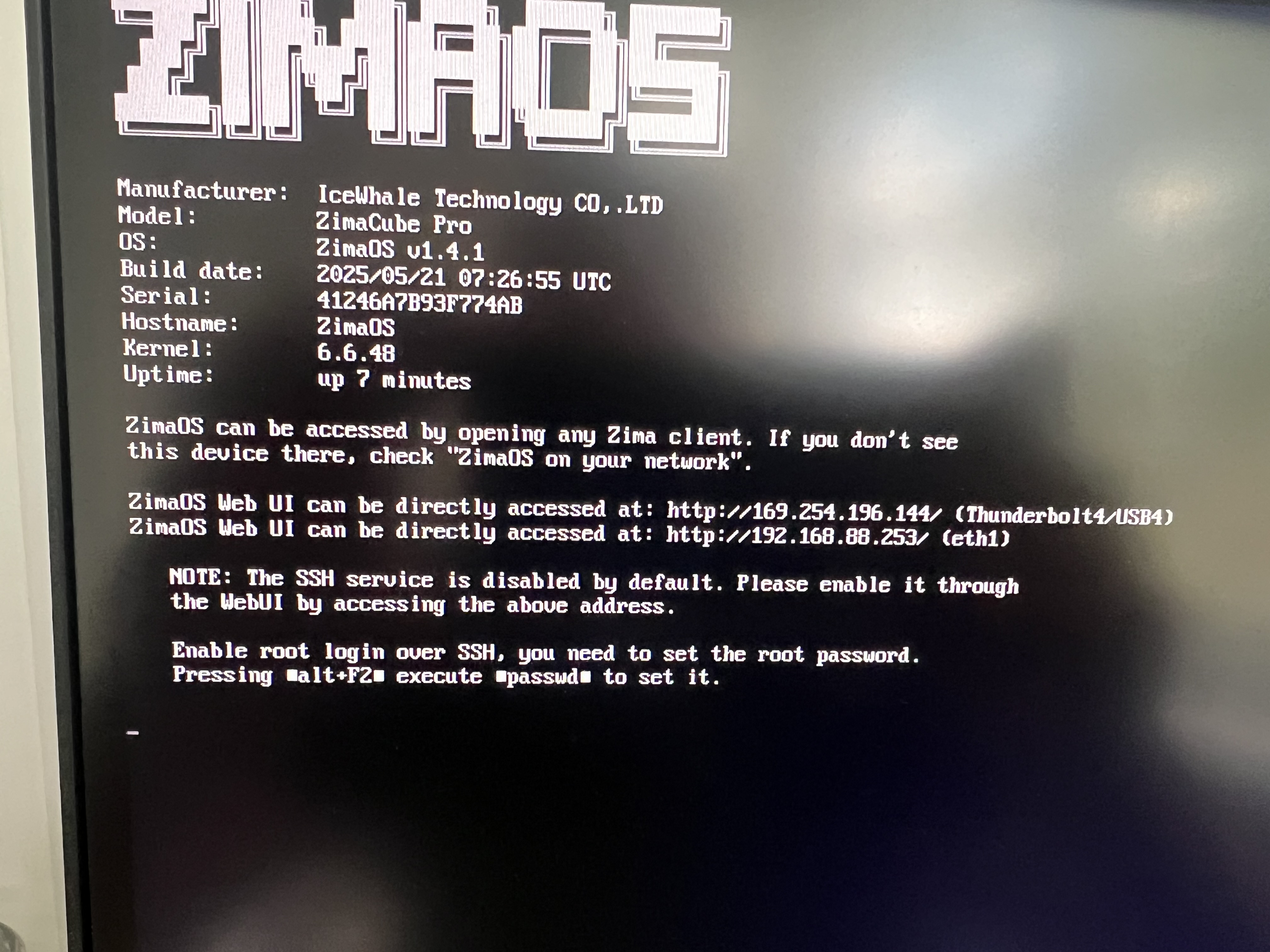

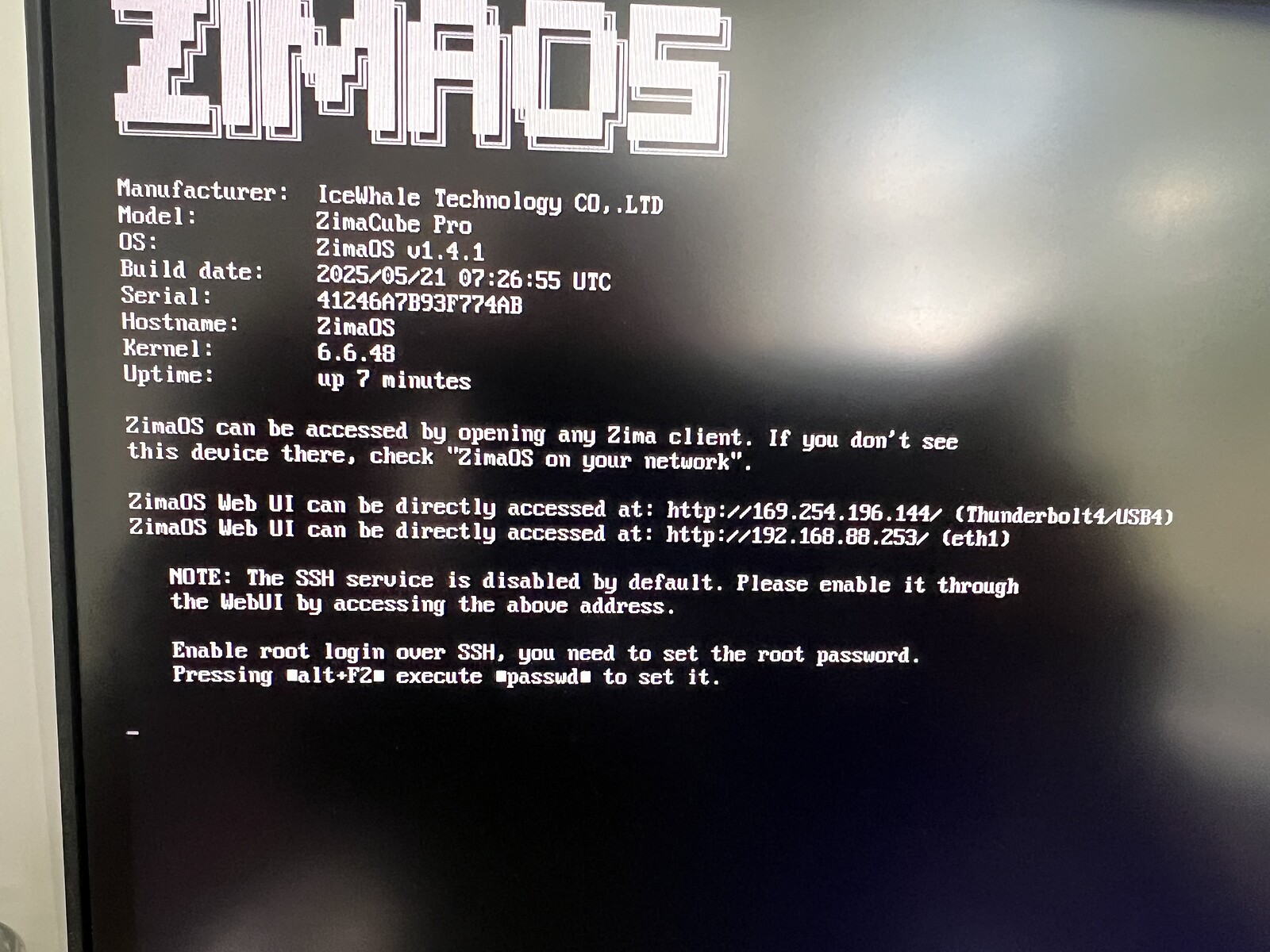

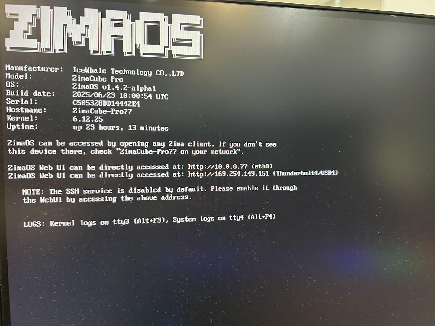

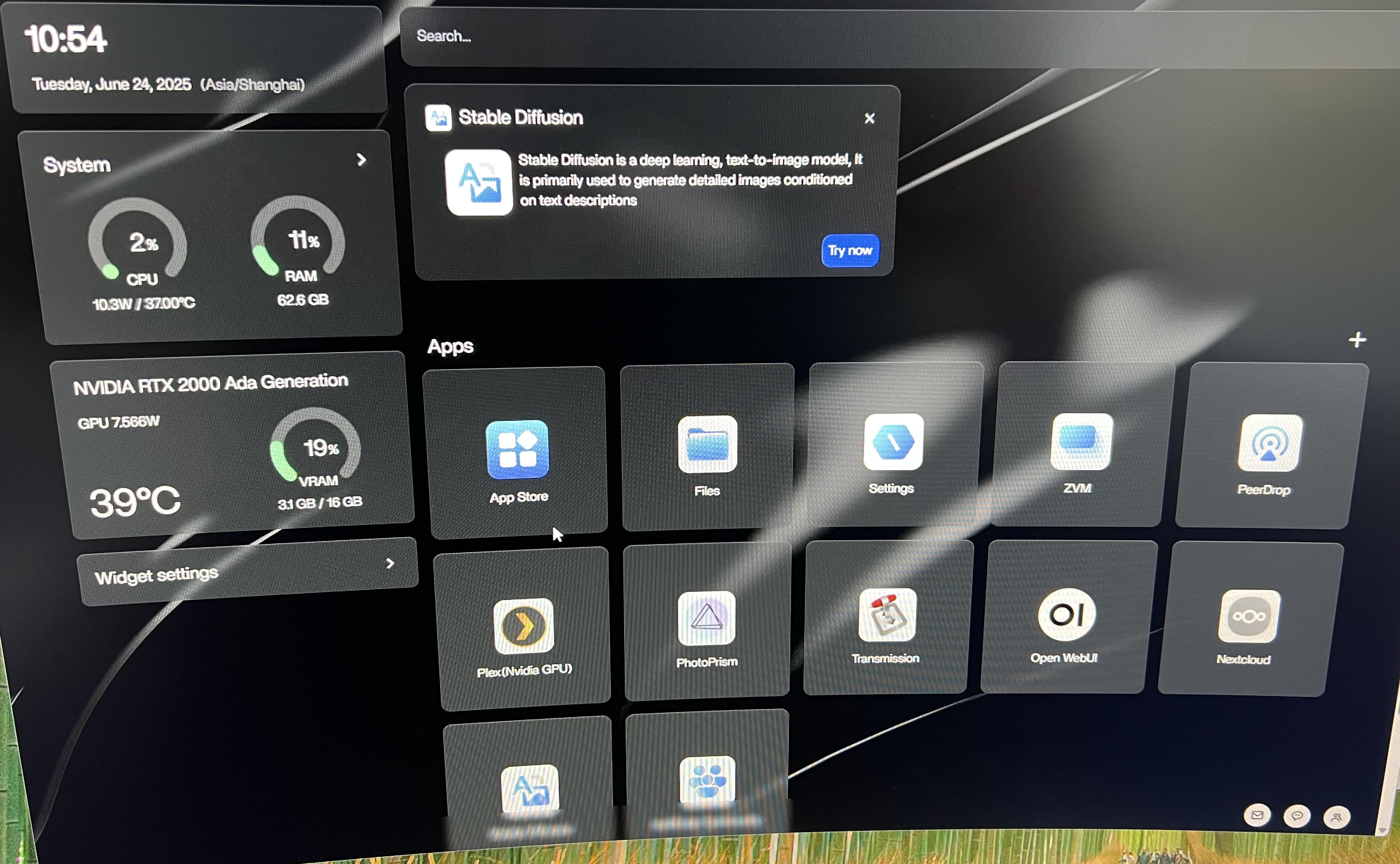

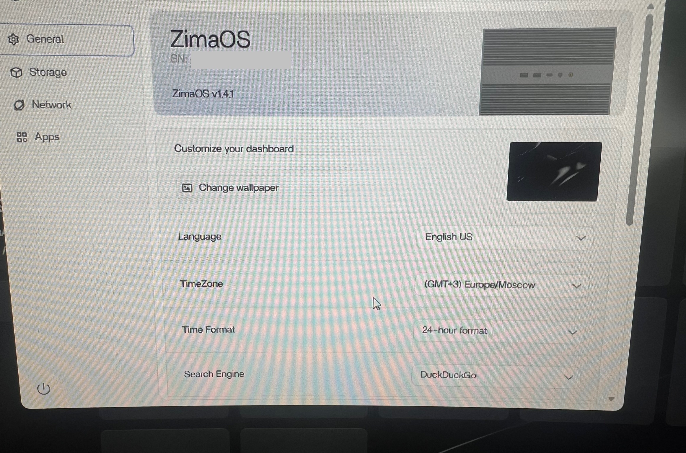

Can you plug in a monitor for your ZimaCube Pro and check if the thunderbolt ip shown in the image below appears?

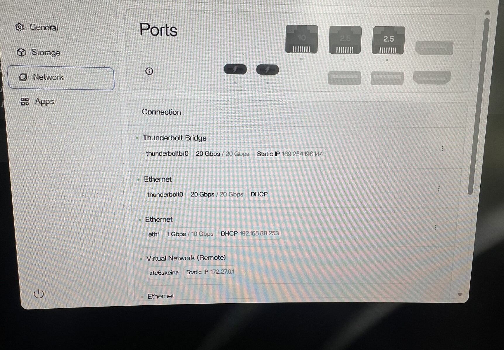

Can you see the Thunderbolt Bridge as shown in the following figure on the network management page after connecting to Thunderbolt?

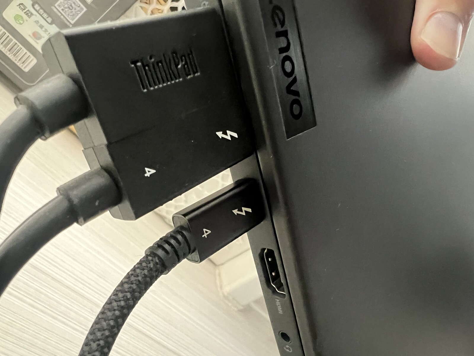

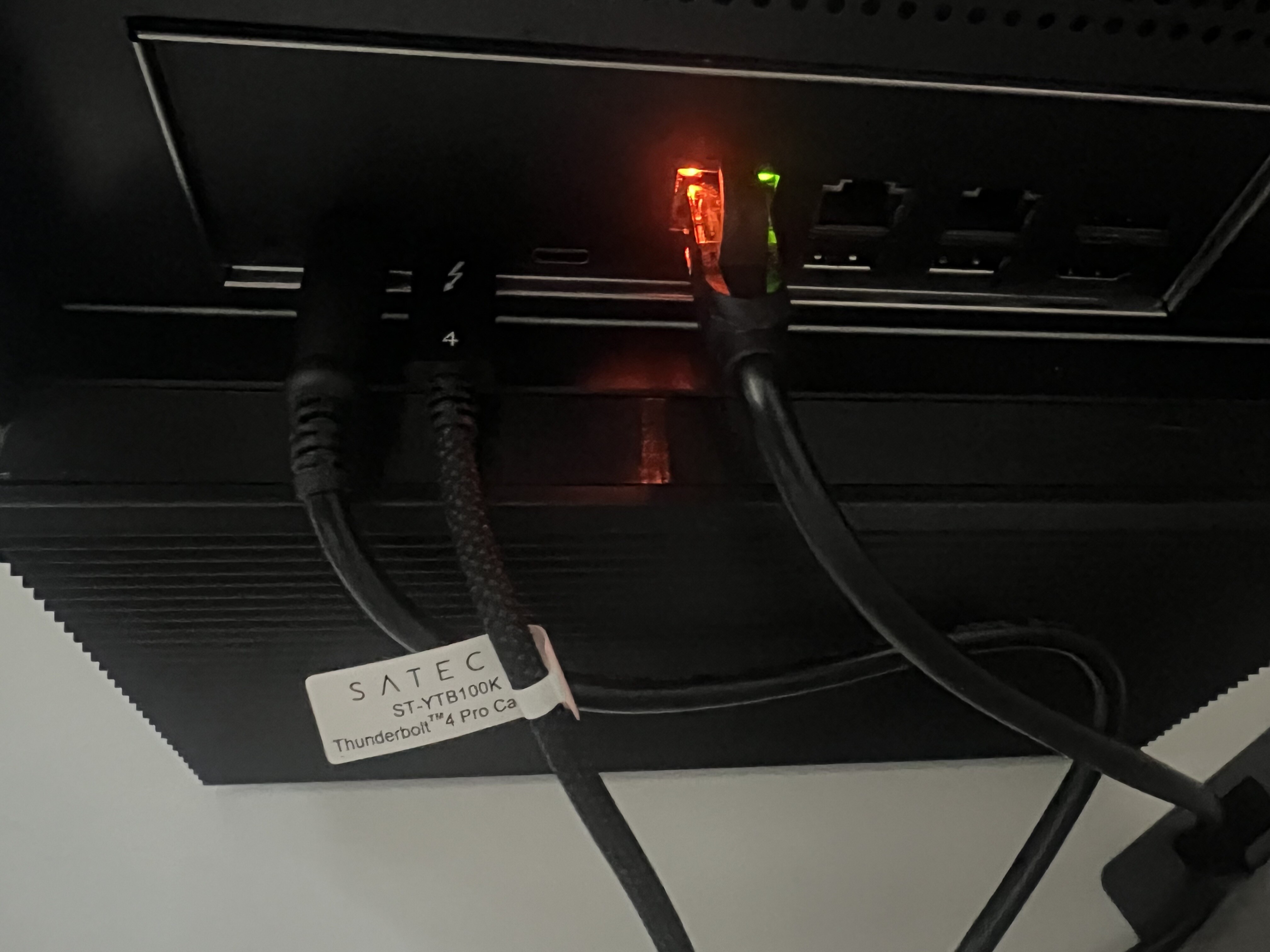

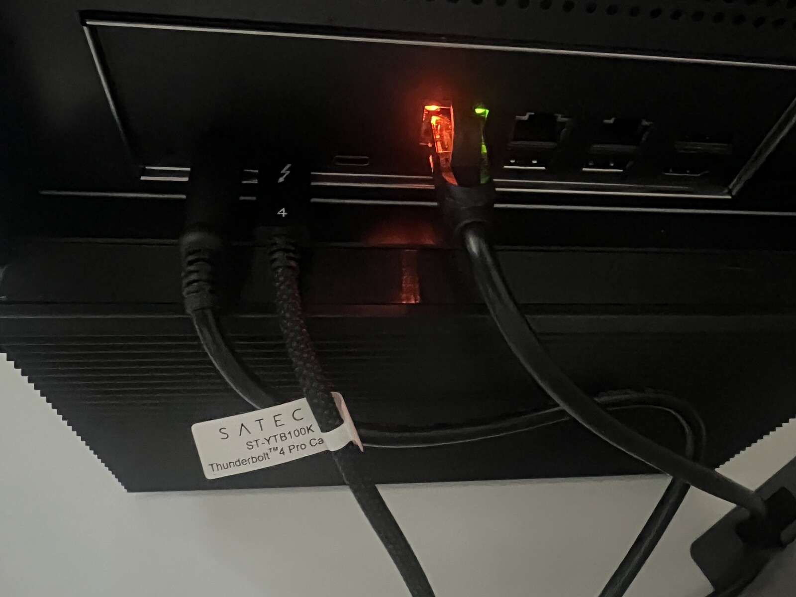

Hi,
  1. More photos
  2. I tried to go through different ways, but its only LAN connection
Hi,

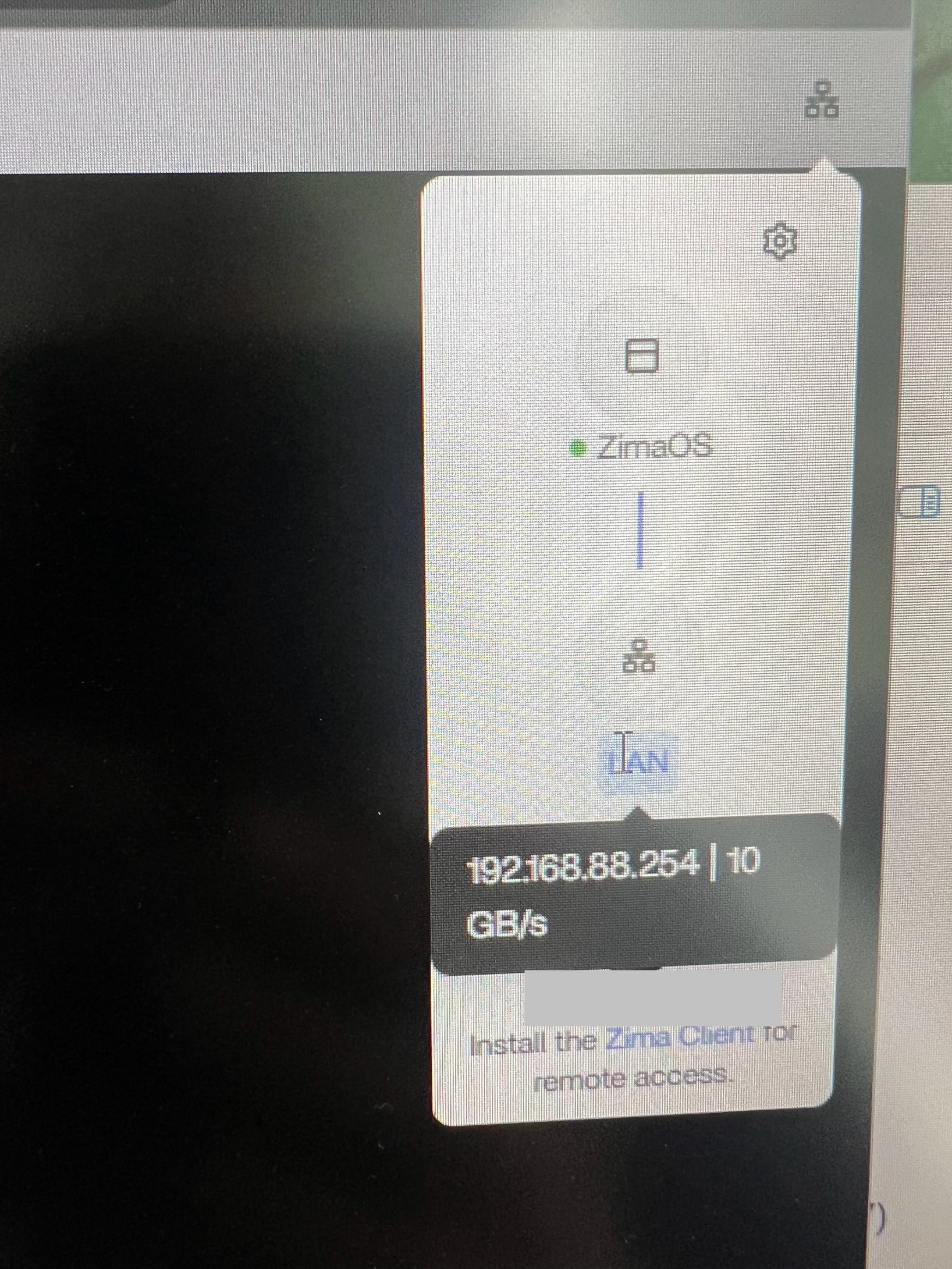

I have such connections

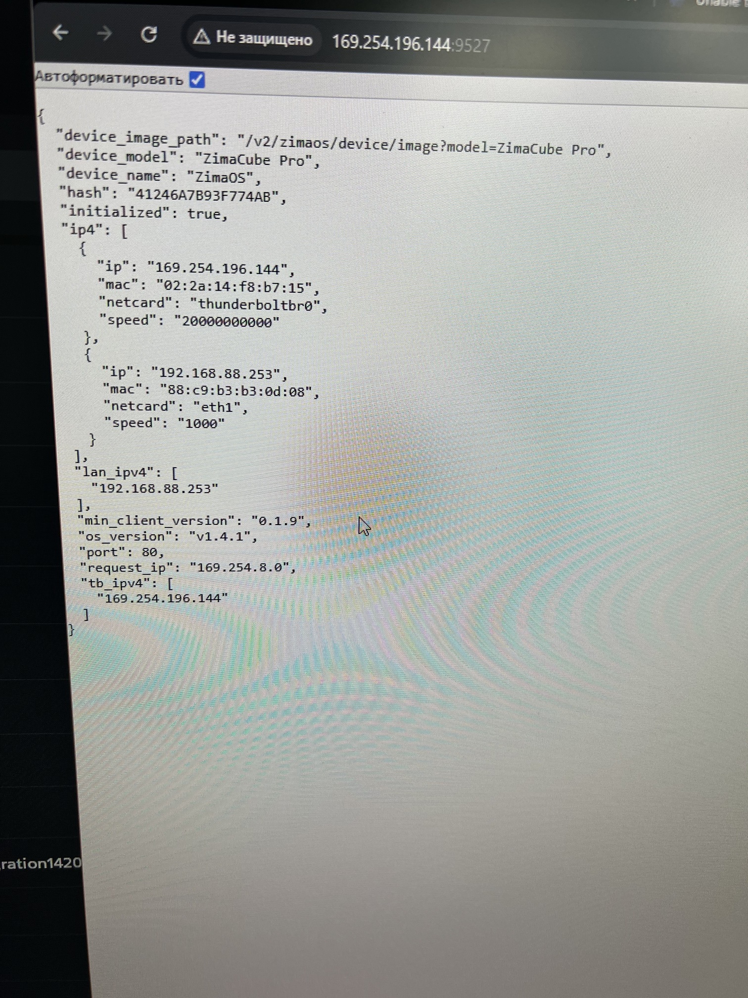

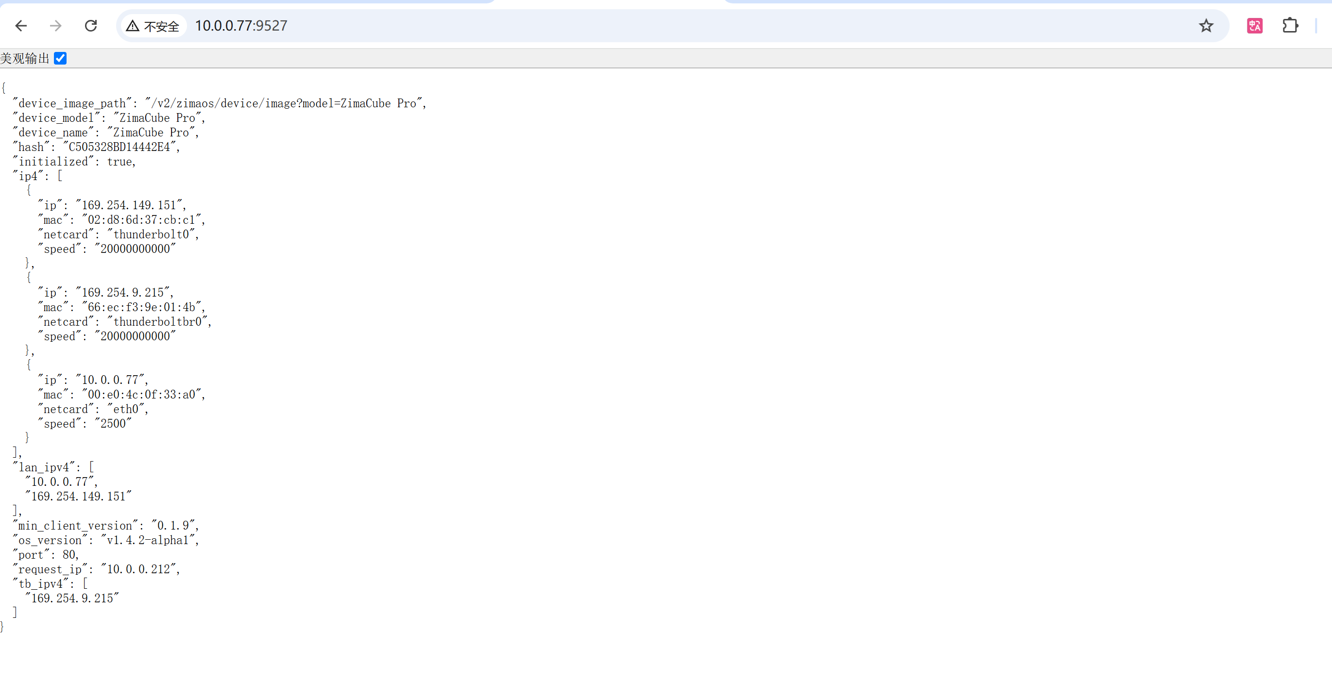

Can you try accessing with 169.254.196.144?
At the same time, you need to return the information of 192.168.88.253:9527, as shown in the following figure
Yes, I see it, but it only shows up here.
Э

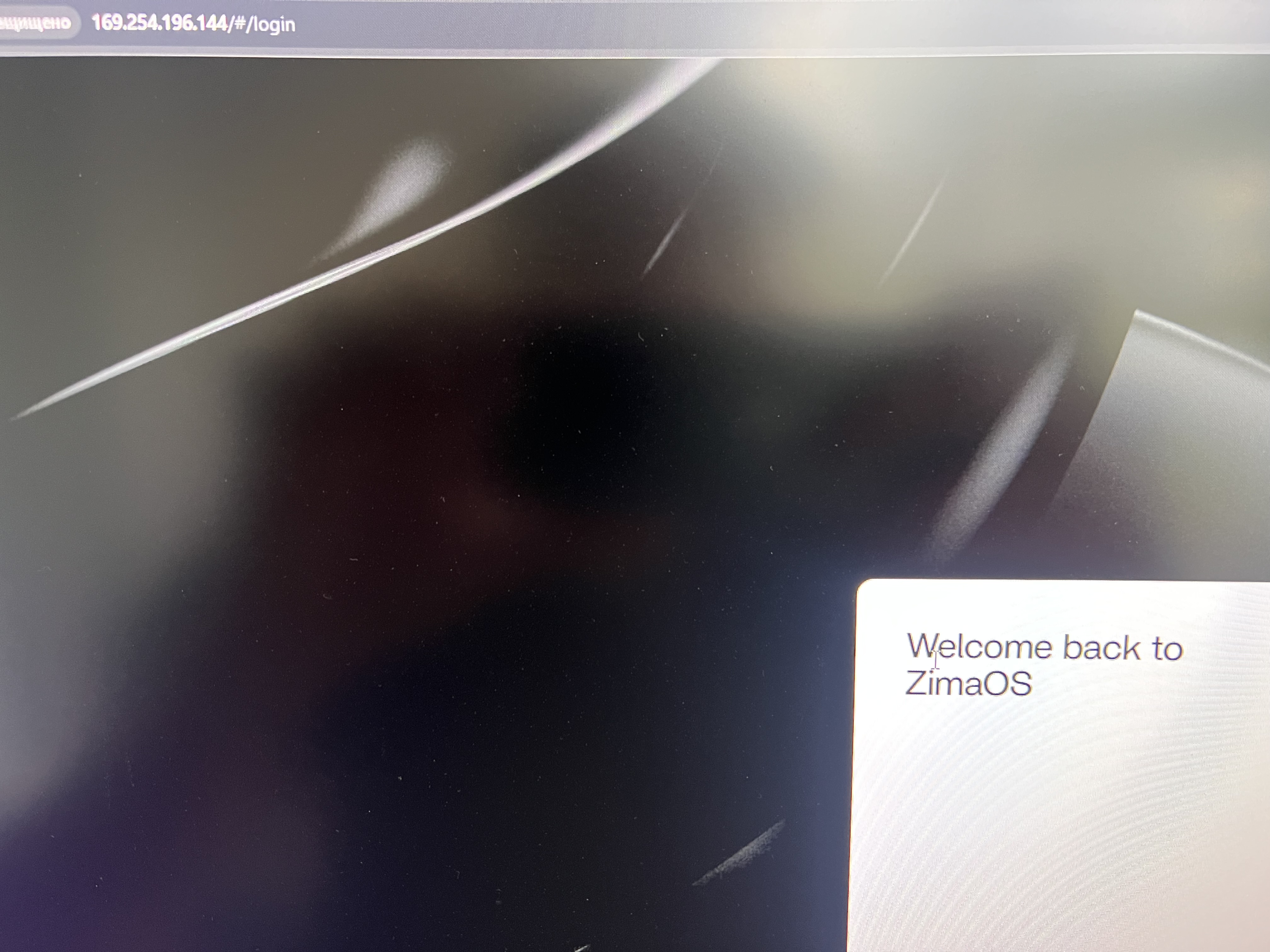

Can you try accessing directly through IP with your browser 169.254.196.144?
I also found another issue: your network devices are displayed incorrectly. You need to modify your configuration file as shown in the image below. Set ETHS and THUS to empty, then run systemctl restart zimaos.
Its login page
I connected via the second port and everything is fine.
But when we use the first one, the IP address disappeared.
Its OK.
Thank you very much, now everything works perfectly
The other one you said doesn’t show up is that you waited for a few minutes and still didn’t show up?
Hi.
Yes, nothing happens. No IP for thunderbolt is assigned as in this picture
