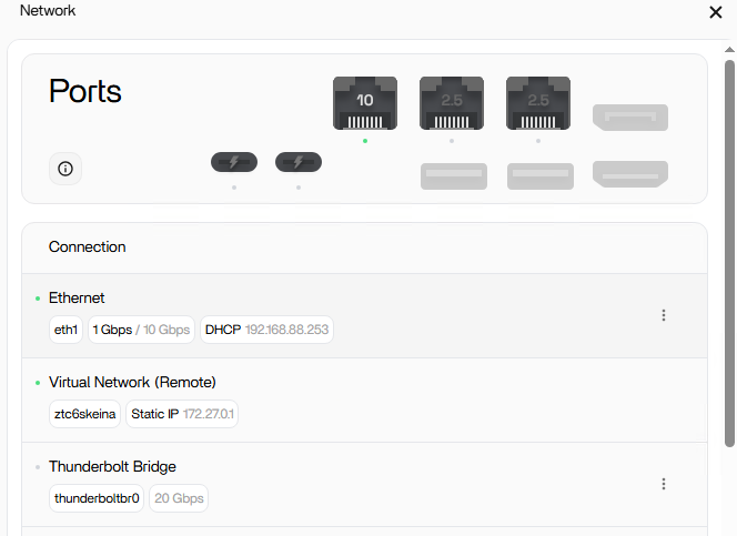

If convenient, would you provide more screenshots of your desktop and the Zima machine?
The Zima machine can be connected to a dedicated display to show its IP.

Here are the screenshots and logs

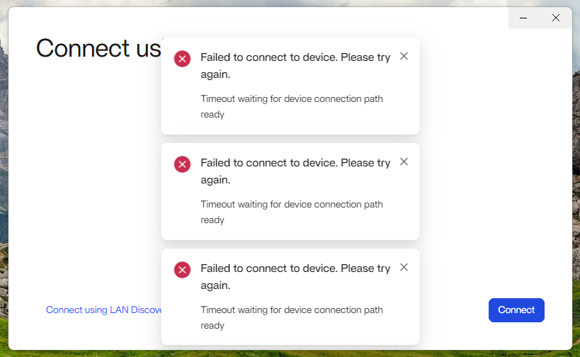

I try to connect to it through the local area network and get such issues

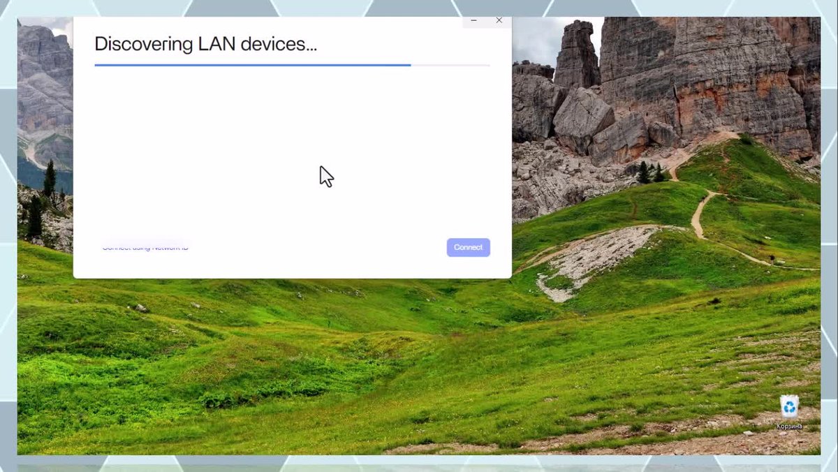

If possible, could you provide a screen recording of your operations to help us accelerate the problem identification?

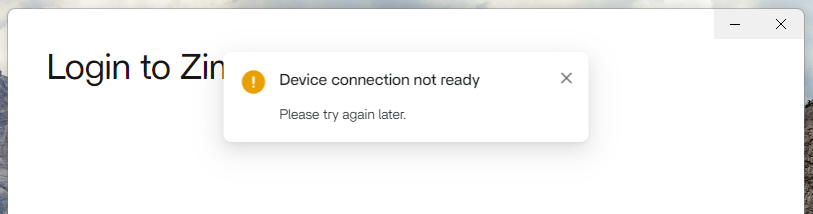

This message appears when I connect via LAN and I’m just trying to log in, to open UI.
I just recorded a video

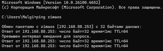

Can you try to ping the ip of this zimaos directly with the cmd of the PC?

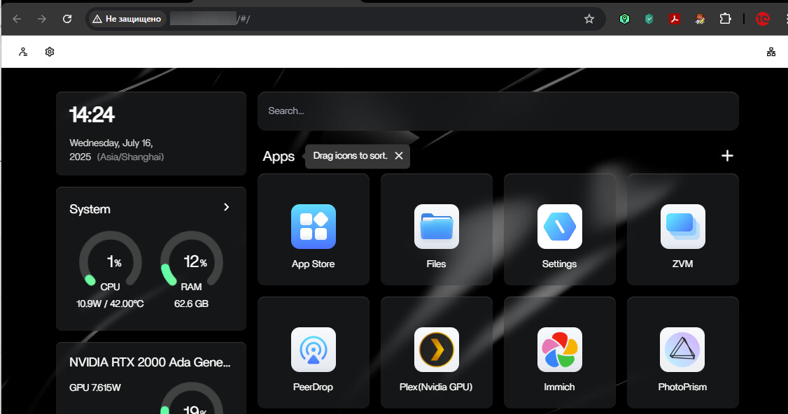

I try to ping it, its OK and I connect to UI

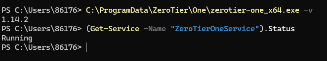

Could you try the following commands in PowerShell?
C:\ProgramData\ZeroTier\One\zerotier-one_x64.exe -v
(Get-Service -Name "ZeroTierOneService").Status

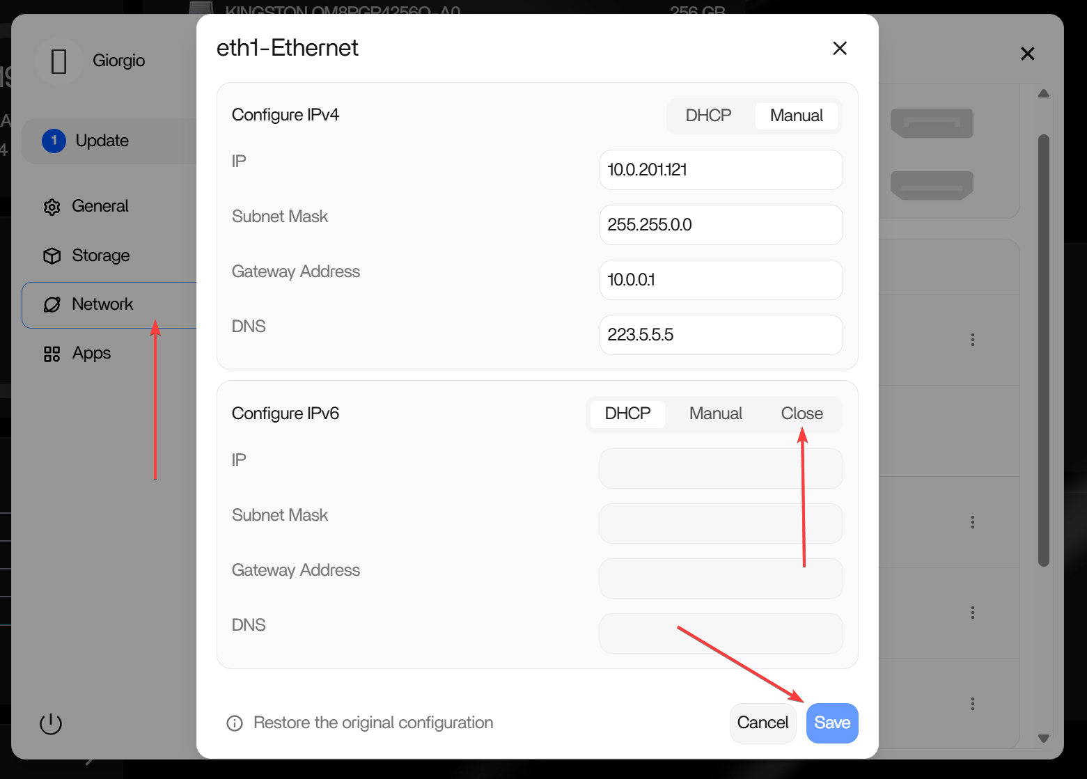

How i can disable IPv6?
