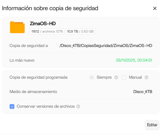

I think it would be a good idea to do the same thing HomeAssistant does with its backups; it’s very simple.
I’m currently backing up all of ZimaOS, and I’d like to migrate the folders to a USB drive, but it won’t let me. Is this correct?
Or should I uncheck the option to keep file versions?

The Backup app doesn’t allow moving the destination to a USB drive because it only supports internal ZimaOS-managed disks for versioned backups. USB storage isn’t treated as a managed data volume, so migration is blocked.
Unchecking “keep file versions” won’t change that, it still won’t let you move the backup target to USB.
If you want a USB-based backup of the system, the correct method is the System Restore tutorial above (dd + gzip). That creates a full, consistent OS image and doesn’t rely on the Backup app.
So yes, what you’re seeing is expected behaviour.

  • These disks are not backed up with dd
  • After restoring the OS disk, ZimaOS will auto-remount DATA, and apps usually reappear immediately
Why this is ideal
  • Backups complete in minutes
  • Restores are fast
  • Low risk (no chance of cloning TBs)
  • Designed around how ZimaOS separates OS vs DATA
So in short: your result is expected because your NVMe boot disk currently contains much more than “just the OS”. The USB restore method works best when the OS lives on a small dedicated system disk.
Thanks for this comment, I fully agree, and I believe it’s important to clarify this so nobody misunderstands the goal of the guide.
This tutorial is ONLY for system-level recovery (OS disk)
The purpose of the USB dd backup method is:
  • bare-metal recovery of the ZimaOS system drive
  • fast restore after a bad update / corruption / failed boot
  • restoring the OS without touching DATA drives
It is not meant to replace proper backup of user data.
Important clarification: users MUST also back up DATA
I believe this is a critical point for new users:
This USB dd method protects the system drive only.
It does not protect you from DATA loss.
DATA backups are still essential because:
  • drives can fail without warning
  • accidental deletion happens
  • corruption/ransomware is possible
  • RAID improves uptime, but RAID is not a backup
The DATA pool is where the important items live:
  • personal shares / files
  • AppData (containers, configs, databases)
  • media libraries
  • downloads and documents
So the correct mindset is:
  • OS backup = fast bare-metal recovery (this guide)
  • DATA backup = proper backup strategy (external + versioned + ideally encrypted)
Why OS-only backup still matters
Even if DATA backups are perfect, OS failures still happen and can stop everything quickly.
This system restore method gives you:
  • a clean OS rollback in minutes
  • minimal risk of accidentally wiping DATA
  • quickest way back to a working dashboard + apps
After restoring the OS disk, ZimaOS typically re-mounts the DATA pool and apps reappear.
DATA Backup Best Practices (suggestion to add to the tutorial)
I believe the best way to describe this in the tutorial is to recommend a simple, realistic approach:
1) Follow the 3-2-1 rule
I suggest using:
  • 3 copies of your data
  • 2 different storage types
  • 1 copy offsite
Example:
  • Primary DATA pool in ZimaOS
  • Secondary backup to USB HDD / second NAS
  • Offsite backup to cloud (or another physical location)
2) Back up AppData separately (containers / configs / DBs)
I believe AppData is the most overlooked risk area. Even if your media can be re-downloaded, losing AppData often means:
  • losing settings
  • losing databases
  • breaking apps
I suggest ZimaOS eventually provides a built-in “AppData backup/export”, but today users can still protect it using either:
  • scheduled backup app
  • rsync-based sync to another disk/share
  • versioned backup to cloud
3) Encrypt backups by default
I strongly agree with your encryption point.
I believe:
  • local USB backups should support encryption
  • cloud backups should support encryption
  • restore should be guided and simple
I suggest this becomes a first-class feature in ZimaOS because encrypted backup should not require advanced Linux knowledge.
Strongly agree with your feature request
I believe ZimaOS needs integrated backup + recovery options, ideally:
  1. System drive bare-metal backup
    • local USB / NAS target
    • cloud target (OneDrive/Google Drive/etc)
    • encryption
  2. DATA drive backup
    • local + cloud
    • encryption
    • incremental + versioned backups (not always full copy)
  3. Easy recovery tools
    • guided restore
    • clear disk safety checks
    • prevention of wiping DATA disks
That combination would make backup/recovery “pro-grade” and remove a lot of risk and stress for users.
