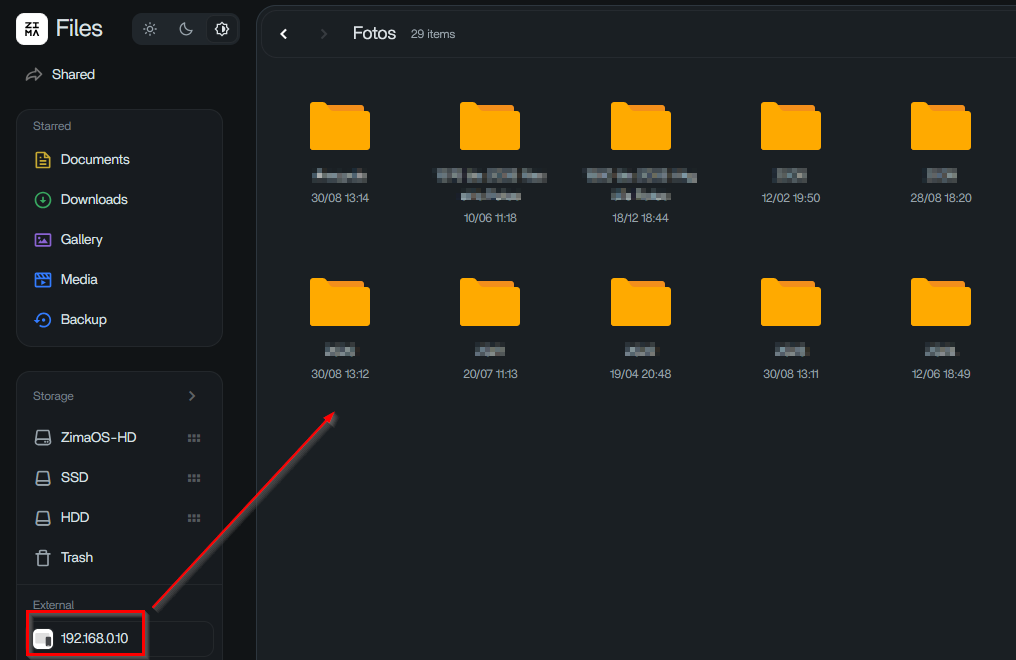

I can easily access the SMB share and the local hard drive using the zimaos file browser.

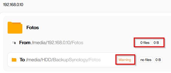

Then I recreated the backup, and I noticed that when it calculates the source, it shows “no files 0 B.”.

The warning appears above the local drive.
What’s strange is why it lists the source as 0 bytes (the source directory contains only folders, no files).

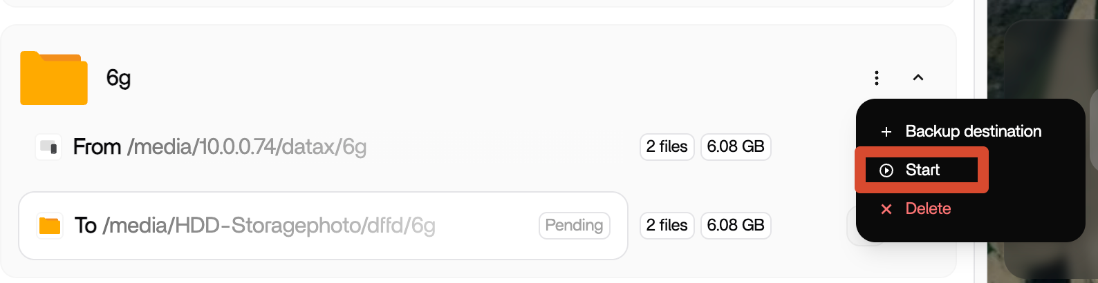

Can the “Start” button be used to perform a backup successfully? Currently, we are measuring file sizes, not the size of empty folders.

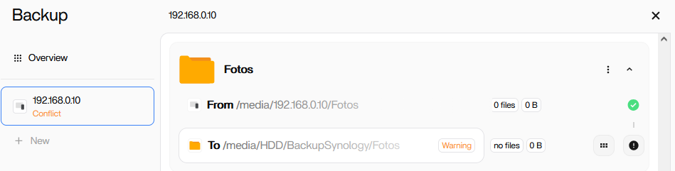

Nothing has changed since the last update to version 1.71. I recreated the backup job; here’s what it looks like now:
There’s a warning above the target drive.
Please check you network or device connection.

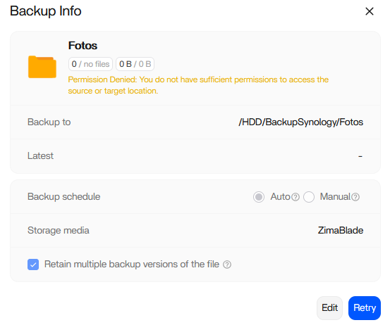

You can find this information in the device details:
Permission Denied. You do not have sufficient permissons to access the source or target drive.
The Source drive is a network folde, as you can see i have read write access to it:
The target is a local HDD Drive, ive also read write access!

I just made an account to reply to you cuz I was having the same problem and looked in this thread but nobody seems to help, lol
Just change it from “Automatic” to “Manual” and start it again. Haven’t tried setting it to automatic again but maybe it works too. (Also I don’t remember if I activated the “maintain multiple versions”)
Hi, thanks for your reply.
I tested it with the latest version, and it works now when set to “manual.” That’s a decent workaround for now.
