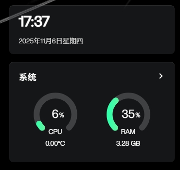

The temperature and power detection are on ZimaOS v1.5.1 didn't work
After I updated my zimaos to version 1.5.1, the temperature that used to show up is gone now and showing 0 degrees Celsius. The power consumption detection hasn’t worked at all since the old version; it just keeps showing and 0 watts. By the way, my CPU is an AMD A6-5200.

I know about that, but for version 1.5.0, it can display normally and the temperature can also be read normally on the motherboard. So it seems that there is a problem with the compatibility of the new version’s driver. And in zimaos, the corresponding driver cannot be installed with one click. So I’m afraid that installing an incompatible driver will cause my data to be lost
