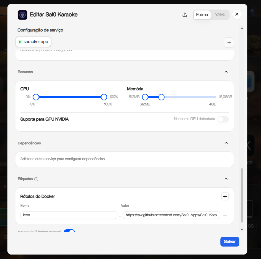

The system stops the availability of RAM for APPs in beta 1 of 1.7.0
As can be seen in the image this is the limit of RAM allocation that the sitema is leaving for apps in the installation preventing updates
Hi, the area shown below can be dragged to modify RAM allocation
I can’t drag it—that’s the problem. I need to manually change everything in the YAML to a whole number. This might be happening because my memory is being detected with non-integer values, but this didn’t happen before this version.
Can you provide a compose file when you can’t drag RAM? After you modify in YAML, can you drag them into the Form?
If I try to update an app, it won’t let me due to the RAM limit; the same happens if I try to install one. The only workaround is to set the limit to 15GB in the YAML editor; the bar turns completely white in the visual editor, but if I tap it, it reverts to 500MB, forcing me to edit the YAML again to proceed with the installation.

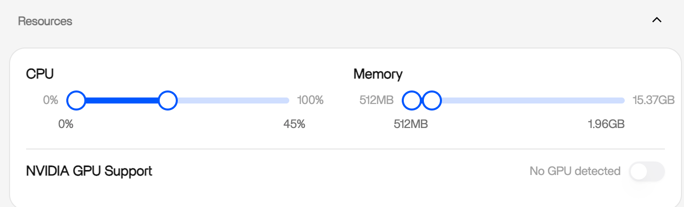

Just an update, Victor. I have now tested the same RAM control on my own 1.7.0-beta1 system.
I increased the allocation to the full 15.37 GB, saved it, reopened the app editor and the value remained correctly.
This means the problem is not affecting every 1.7.0-beta1 installation, so it may be specific to your compose configuration or how the visual editor is parsing the memory value on your system.
I also noticed your interface displays 15,06GB with a decimal comma, while mine displays 15.37GB with a decimal point. This may be relevant, but it is not confirmed.

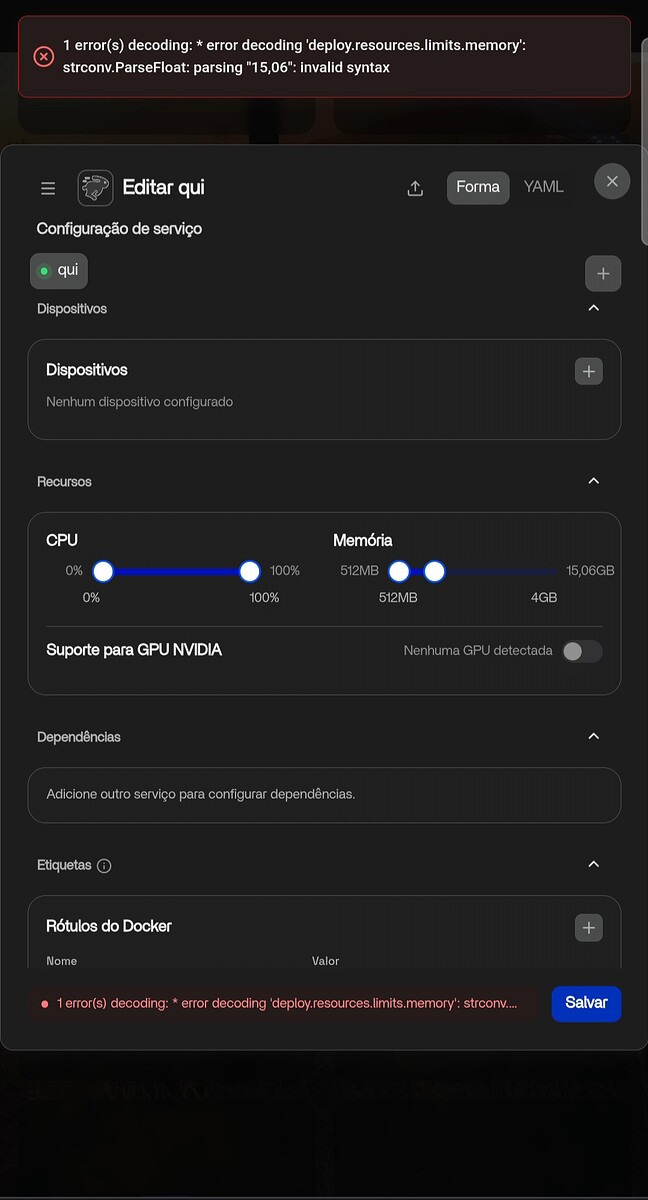

It might be a translation issue; I use the Portuguese version, and most items are separated by commas. I’ve never encountered this problem before, so it’s just a guess. I’ll try to record it when I’m home, but I noticed this error when saving—maybe it indicates what the problem is.

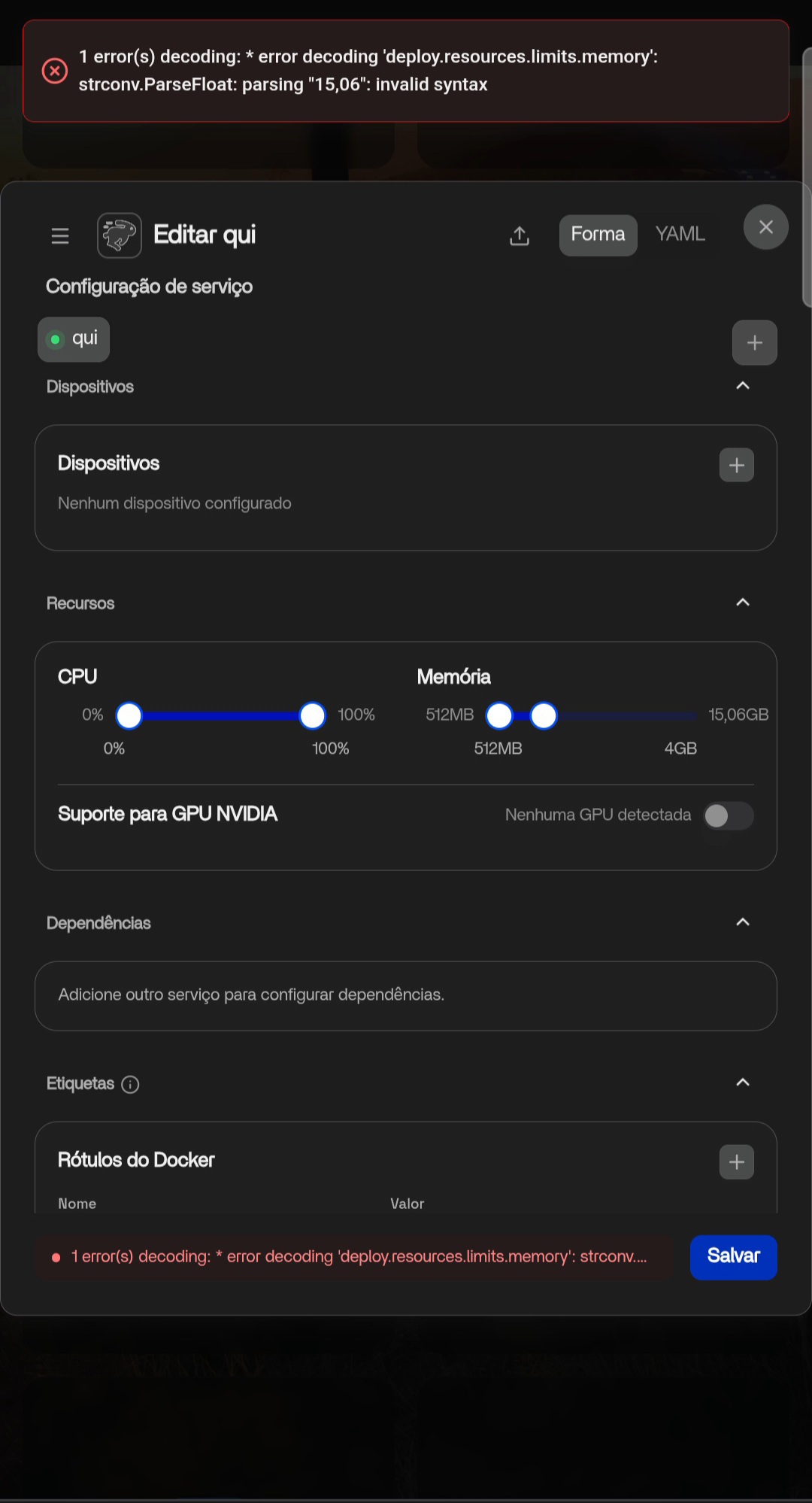

Victor, that error confirms your suspicion.
The important part is:
strconv.ParseFloat: parsing "15,06": invalid syntax
The Portuguese interface is formatting the memory value as 15,06, but the backend expects 15.06. Your RAM is being detected correctly. This is a locale/number-formatting bug in the visual editor.

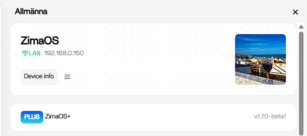

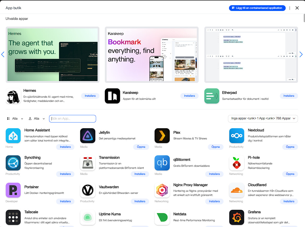

I have/had the same problem on Swedish settings. Somehow I got back the old App Store after rebooting

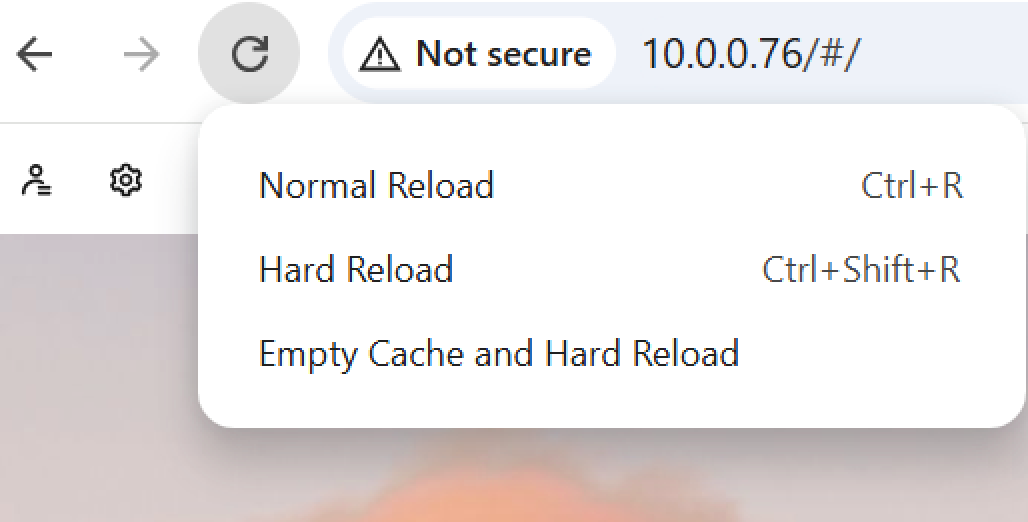

Thanks for your feedback. After refreshing the page, does the new App Store appear?
If it still does not show up, you can press F12 in your browser to open Developer Tools, then long-press the refresh button in the top-left corner of the page and select Hard Reload.
Thanks for your feedback. We will fix this issue in the next version
