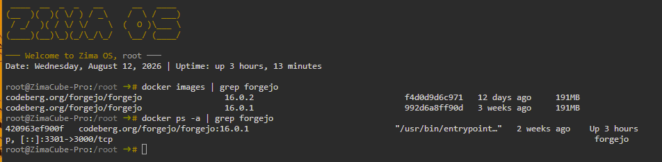

It is evident that a new image is downloading, but the update does not take place.
Please send a video. Thank you!
Update for two apps
Let me see what the reason for the failure of the reconstruction container is.
journalctl -u zimaos-app-management.service --no-pager | rg -i 'failed to update compose app|failed to start|container.*start|error|unhealthy'
logs.txt (15,8 КБ)
I think the key question should be
Error response from daemon: Conflict. The container name \"/forgejo\" is already in use by container \"420963ef900fff48b737c50a3c0d2b47f87cb61a4475e25dd6f96f3a8b72856e\". You have to remove (or rename) that container to be able to reuse that name.
Can you try to delete the container_name: forgejo field and save it?
