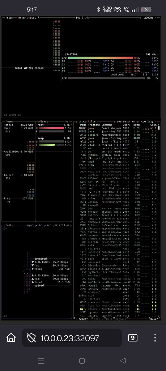

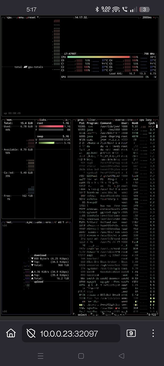

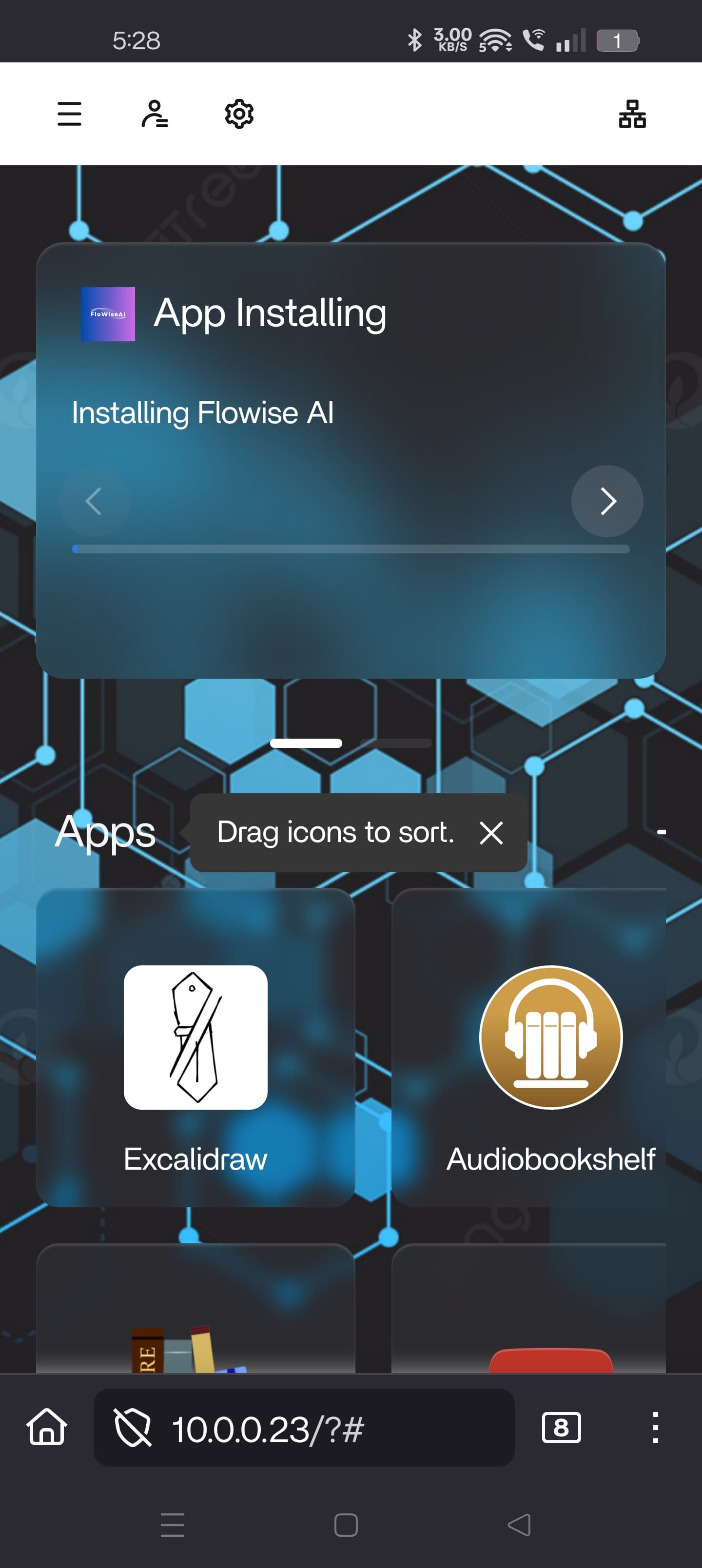

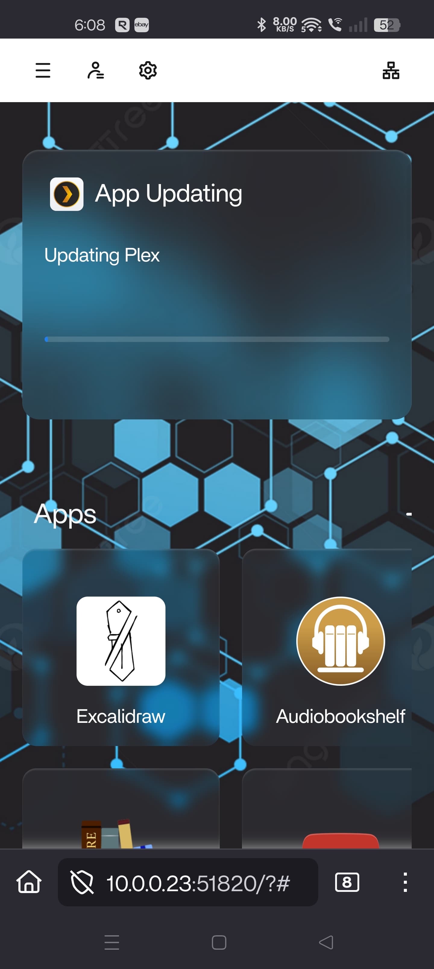

After installing 1.4.2 beta 2 the system was very very responsive. I went to install a new app and the apps will not install, they will quarry like they will install but then just stay like that possibly indefinitely (it’s been like that for about 45 minutes)

Yeah mine gave a strange login screen once but I was able to log in over local ip. Fast forward to this morning and the install process have not moved and are still hanging there

I copied the commands in and the download query disappeared. I was able to install a program from the app store and even update a container that was not previously attempted but when I try to update the Plex container (the one it was trying to update yesterday) it still hangs at the update (10 min as of now)

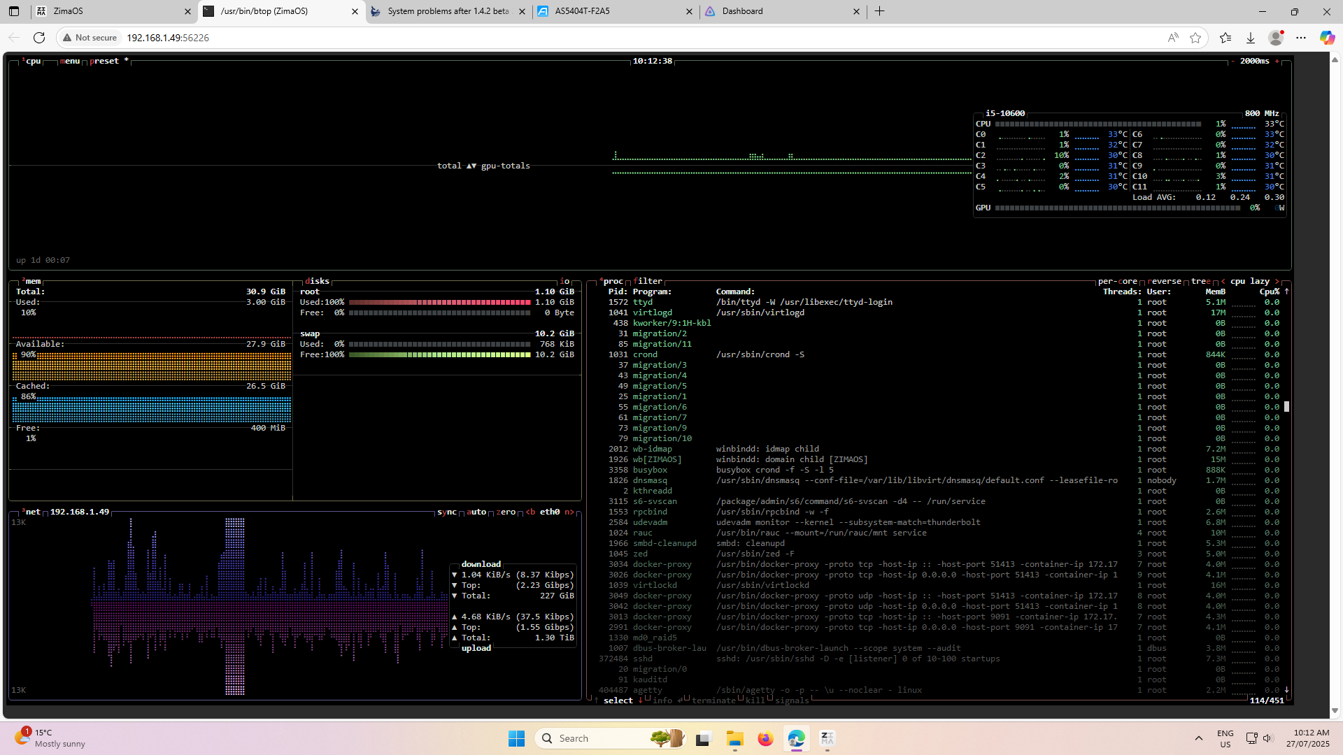

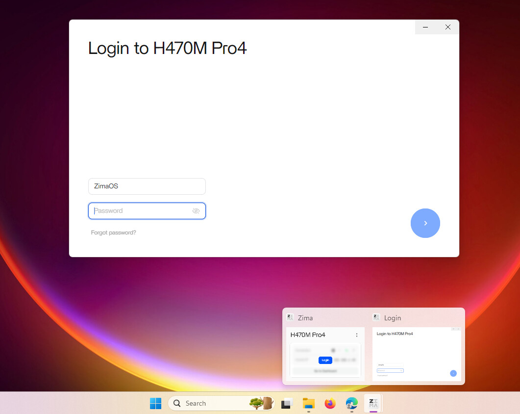

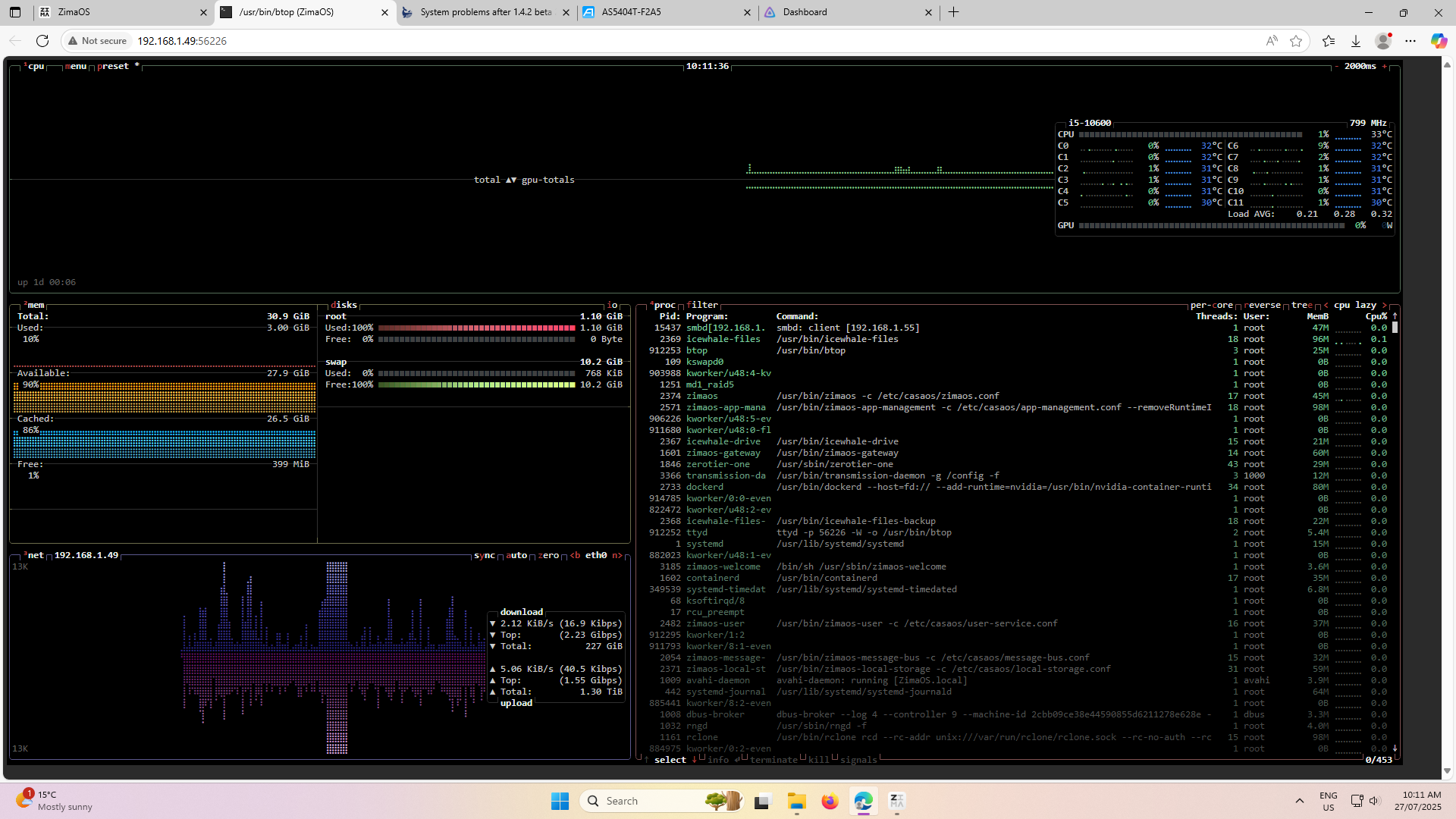

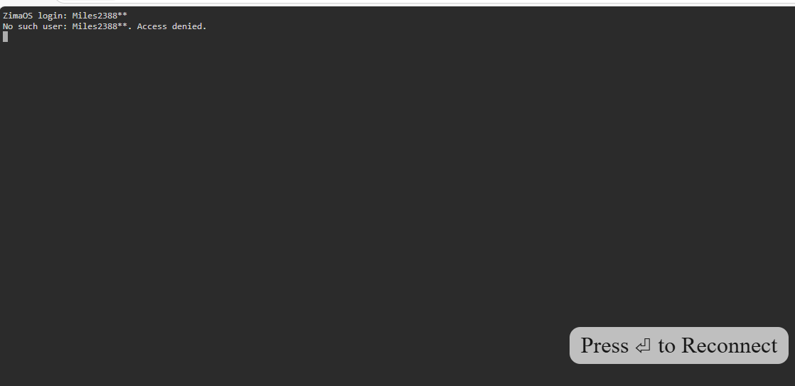

Thats were the problems start, I can’t log in to CLI, Zima app in windows won’t log in and going to change password won’t recognize my old password. As suggested I have rebooted my system and logged in OK with my old password. I’m from a windows back ground and at a loss as nothing has worked.
I think I have found the issue, here what I have done,
on reboot ZimaOS is logging in to my password
Rebooted to image B - back to 1.4.1 (no ZIMA client login)
Uninstalled the client app and reinstalled (no Zima login app)
Last thing is tried upper case and lower case on known name ZimaOS and password
On that its logged in, not shore its droped the uppercase in the saved password
