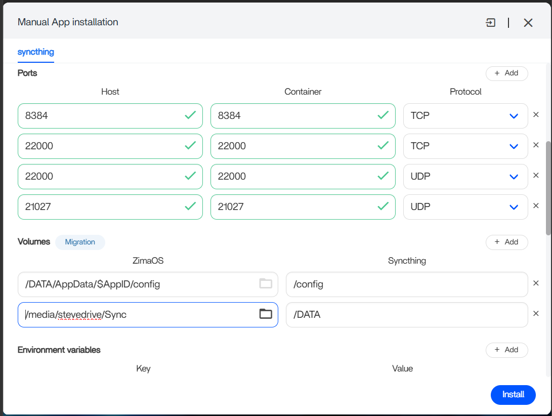

Once that is done, you will need to give access to the individual app. As mentioned previously, I’ll use Syncthing as my example. From the CasaOS main page, hover over the Syncthing icon and click the three dots, then choose the “Settings” option. Scroll down until you see the “Volumes” section. Here, you can change the permissions of which folders the Syncthing container is allowed to access and specify where it should store it’s data. To change this to your external drive, look for the field that contains /DATA under the “Container” column. Then on that same row, change the “Host” value to be the path to your external drive (or whatever path you want Syncthing to have access to).
Finally, click save. From there, you should be able both read and write files within the specified folder. Keep in mind that the “Host” column specifies where the files are actually stored on your device, while the “Container” column specifies where that specific container will think they are. So, if you have a documents folder in the main directory of the external drive, Syncthing will think it’s located at /DATA/Documents , rather than the full path you would see in the files app.

For the first one, could you send a screenshot of the “Volumes” section in settings? Getting that folder stuff right can be confusing. It certainly took me multiple tries for the first few apps.

The folder structure used anywhere in the syncthing app needs to follow what you set in the container column of the settings. Sycnthing can’t see your whole folder tree and thinks that the filesystem starts at the first slash in the Container field. In your case, you should use /DATA/Documents in the folder path.
Syncthing will also usually prefill the Folder Path field. You can use the prefilled “~” as shorthand for the /DATA folder. So, you could also put '~/Documents` and that should work as well.

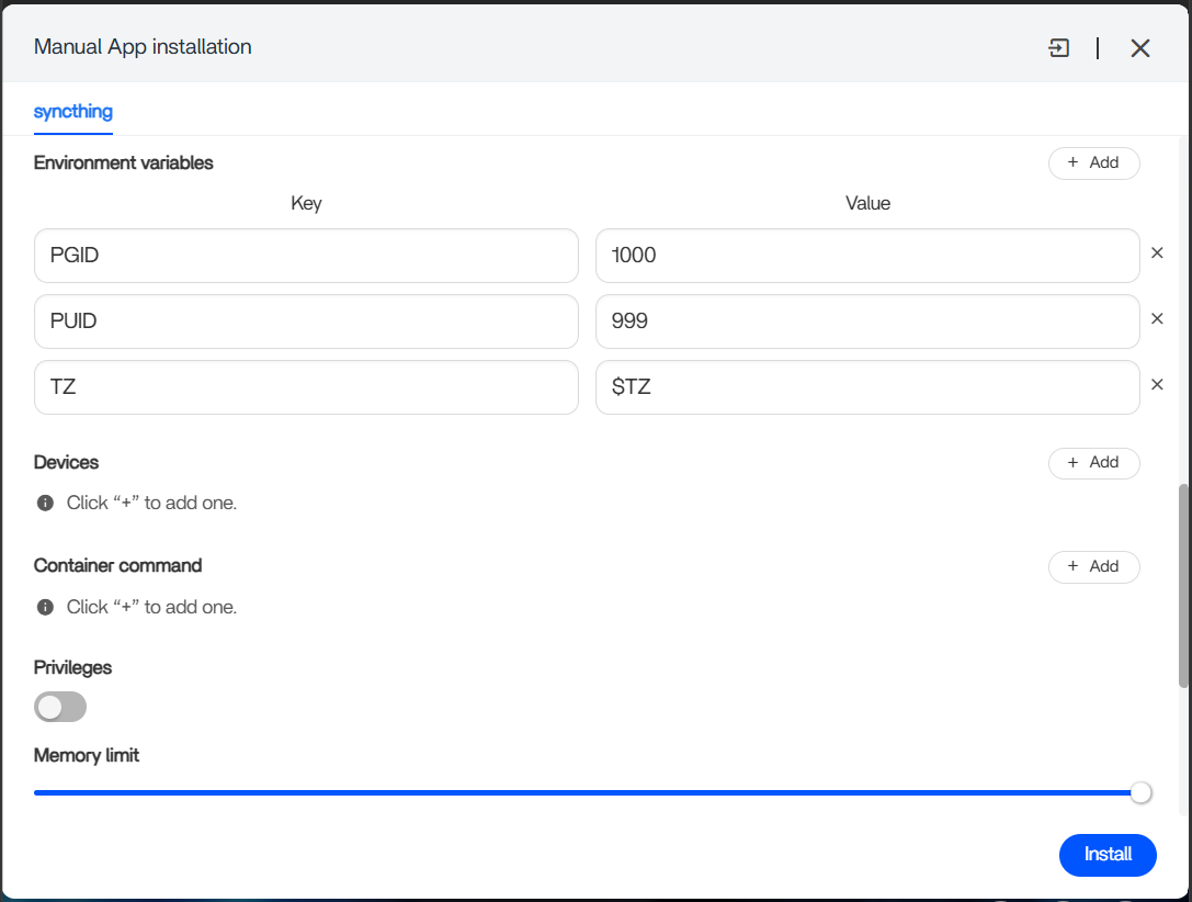

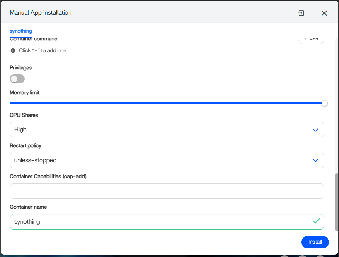

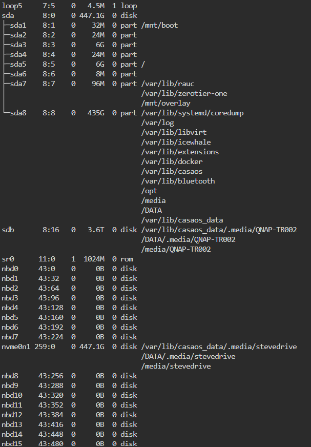

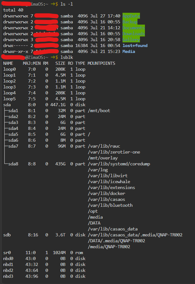

Hey I’m new to this and I would some help.
I’ve tried installing this a couple of times now. I don’t understand what’ve done so any help well be grateful. I’ve installed on a mini pc and on the latest OS.
I’ve done lsblk and ls -l commands and I don’t if I’ve understand this. Here are some screenshots of the install and the terminal but Idk if this good or not
