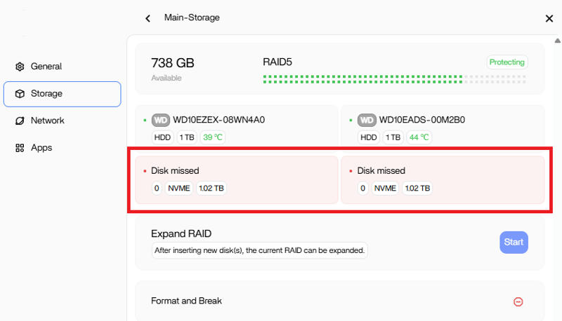

Storage shows NVME missing after updating to ZimaOS v1.4.1
PM u~

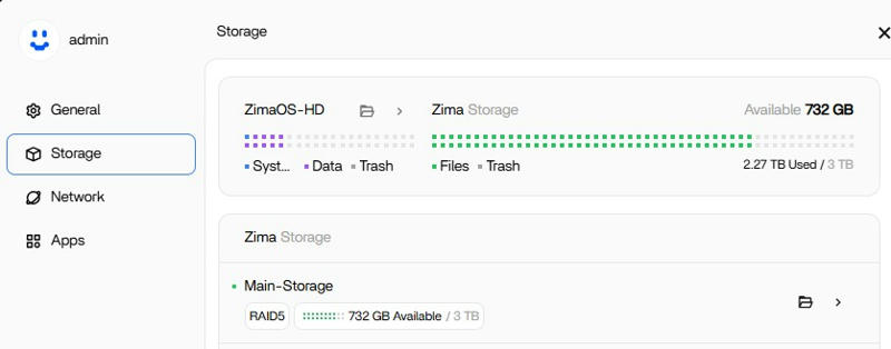

NVME seems connected and data / storage size ok as before updating to 1.4.1
only showing missing were every thing seems to be ok
System has 4 drives: 2x hardisk 1 TB and 2x NVME 1 TB

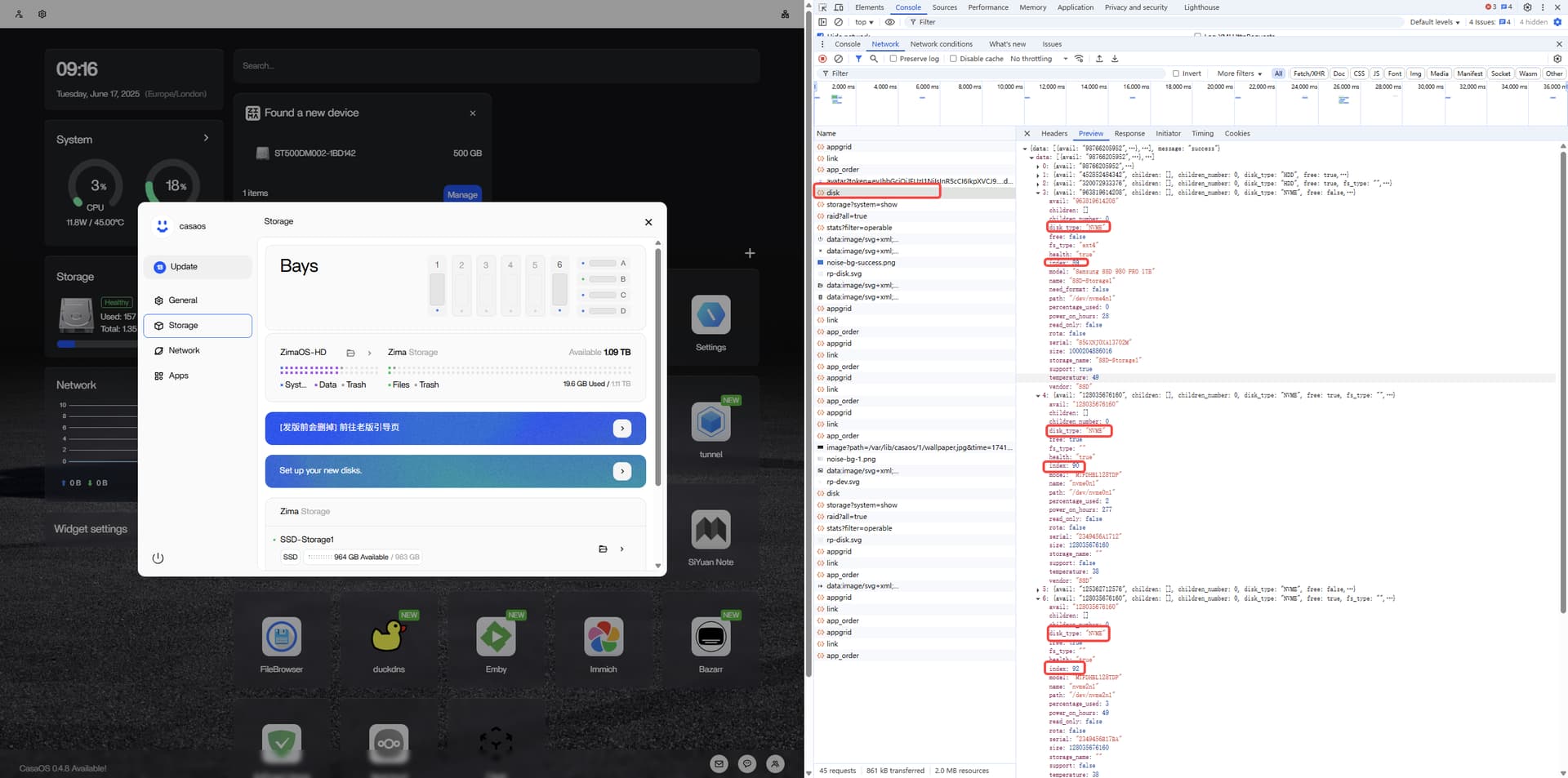

  1. I still need to troubleshoot remotely, or we can make an appointment to chat to help with the issue, but this can be a bit of a hassle due to the different time zones we’re in
  2. If you can, you can post us with the return message of this request on the website, which may be difficult for users who are not familiar with the page inspection function, so it is recommended to provide a remote message for troubleshooting
You need to check that the disk type returned in the disk request is the corresponding index of NMVE

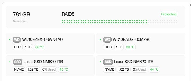

Problem solved after updating to ZimaOS v1.4.2-beta2 :+1:
