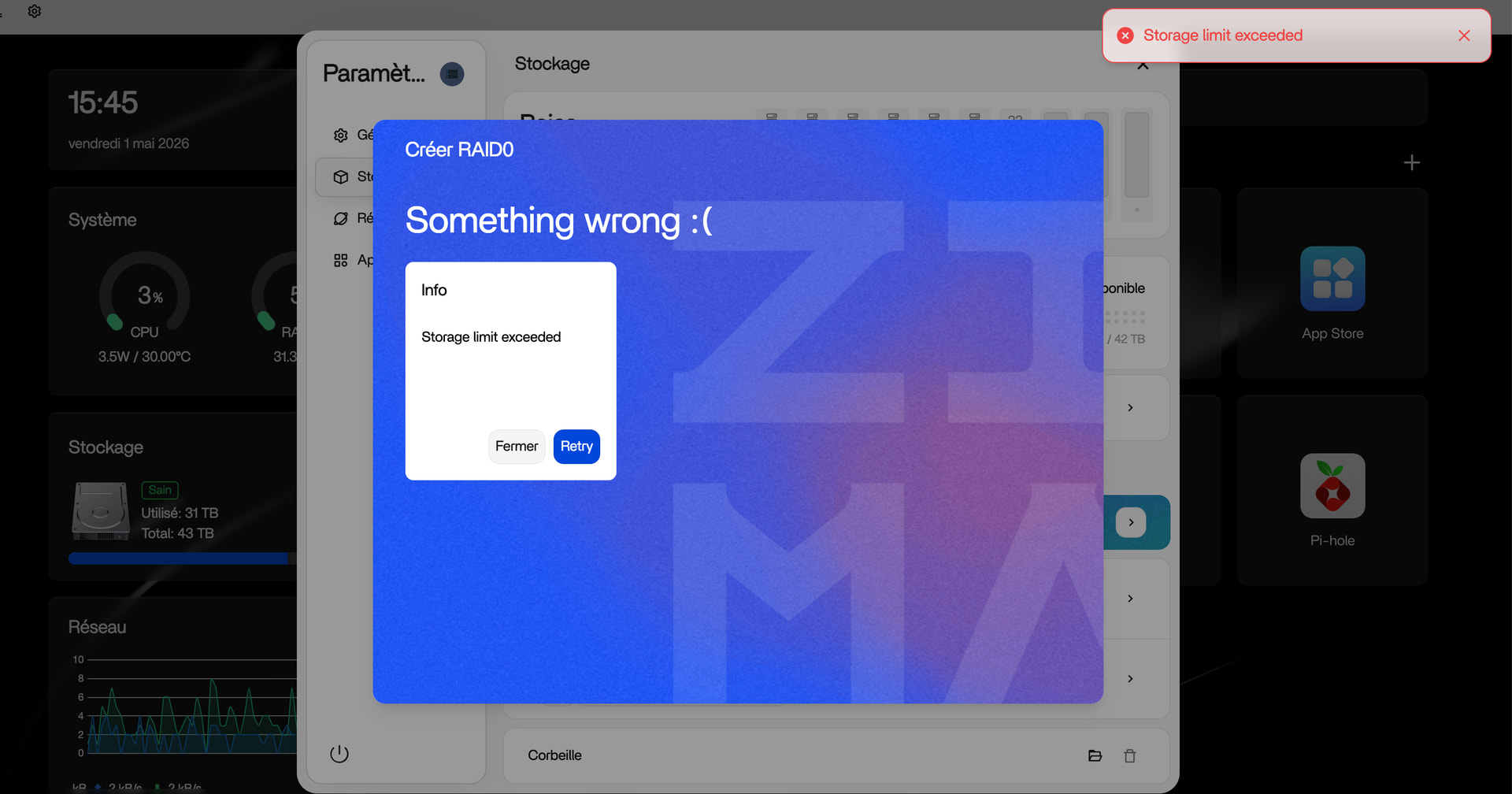

Hello,
My configuration is as follows: I am in ZimaOS+, v1.6.1
I have six disks in RAID5, one 22TB single, two 4TB singles.
I disabled the two 4TB singles to create a single volume of 8TB in RAID0 Result:
I then decided to put the two 4TB volumes back into singles… Same message: Storage limit exceeded
If someone has a solution…
Thanks

I’m already in ZimaOS+
Ahh ok, if you’re already on ZimaOS+, then yeah this isn’t the license limit.
This looks more like the system still “holding onto” the old RAID allocation after you switched things back. It can leave the storage accounting in a weird state, so it still thinks you’re over the limit.
You didn’t do anything wrong, it’s likely just not recalculating properly after the RAID change.

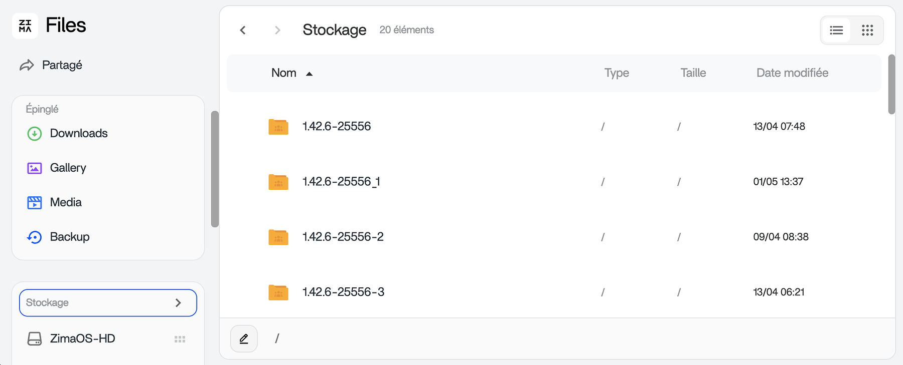

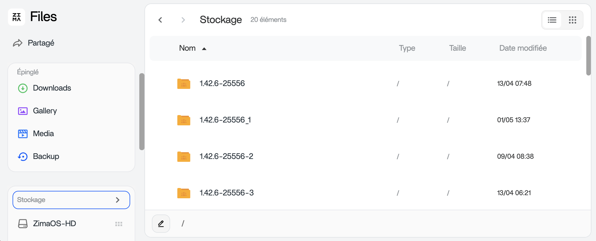

It seems that the system keeps in memory the old connections or samba sharing for volumes or usb disk that no longer exist.
In the FILES/STORAGE/ browser I have 20 volumes in memory?? 13 are no longer present…
Yeah this explains it, those extra _1, _2 folders are leftover mount points from old disk/RAID configs.
Zima is still counting them as active storage, even though they’re not real mounts anymore, which is why you keep hitting “storage limit exceeded”.
Reboot won’t fix it because it’s not just memory, it’s stale mount + metadata.

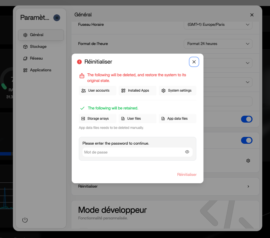

Maybe I should do a factory reset…
